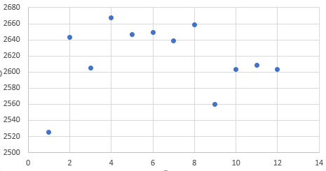

I have a JP CTR-02 in 223 with a 20" barrel. I shot some Fiocchi 77gr factory loads through it as I have heard good things about the load. Chronoeing it, I am a little surprised at the results I got. This is from a Magnetospeed V3:
1) 2525
2) 2643
3) 2605
4) 2667
5) 2647
6) 2649
7) 2639
8) 2659
9) 2560
10) 2603
11) 2608
12) 2603
This is an average of 2617, with an S-D of 42.2. What I am surprised about is the 2525 fps reading, and maybe the 2560 reading too.
A plot of that looks like this:
Just seems like the 2525 shot is pretty far off from the rest. So - do you think that one was a bad reading from the chrono, or does that seem realistic?
If I drop the 2525 shot the average increases to 2625 fps, and the S-D drops to 32.2.
If I drop the 2560 shot also the average increases to 2632 fps, and the S-D drops to 25.0.
In the end I am trying to figure out what to use in my ballistic calculator, and whether I should look for a different load.

While I have not chronographed any Fiochi ammunition, I am not surprised by your results. It shot very poorly in my rifle- though this is a sample of 1 rifle and one box of ammunition. I've not read anything abysmal about Fiochi, but nothing stellar either.

I'd definitely look for another load. I've had decent results with Prime. IIRC, SD's were in the teens. The 77g load is slow, but accuracy is decent. The 55g is the appropriate speed and quite accurate, but I rarely shoot 55's due to the low BC.
I have a JP Ultralight that I never could get to shoot to my satisfaction with handloads. I ended up running Prime 77 in it for matches.

Thats about the consistency of it that I have found. Ran it through 2 rifles with magnetospeed V3 and had ES up in the 125 - 150 range and high SDs to go with it. Shot ok on steel out to 600 yards in both rifles though for some reason. Not great, but better than I expected. Didn't try it beyond that.

If you are looking for a really good production 77 grain round, look at Norma. I have seen SD's in the 10-15 range and is extremely accurate.

I also would suspect the ammo is at fault.
IMHO... most Fiocchi ammo isn't really known for outstanding across the board / multi rifle accuracy... ( not trying to stir the pot ) ... for me, it is actually better known for having off center flash holes.
