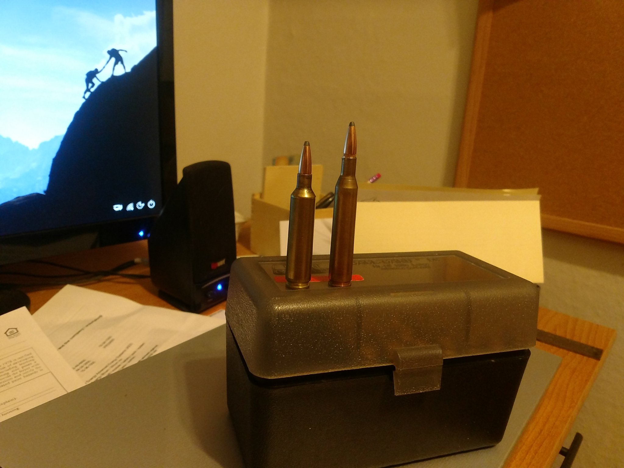

So I had some spare -06 rounds and thought I would make a dummy round for comparison. 6-284 on left, 6mm-06 on right. I found I had to "three-step" the neck as the brass wanted to crumple with that big of a size change.

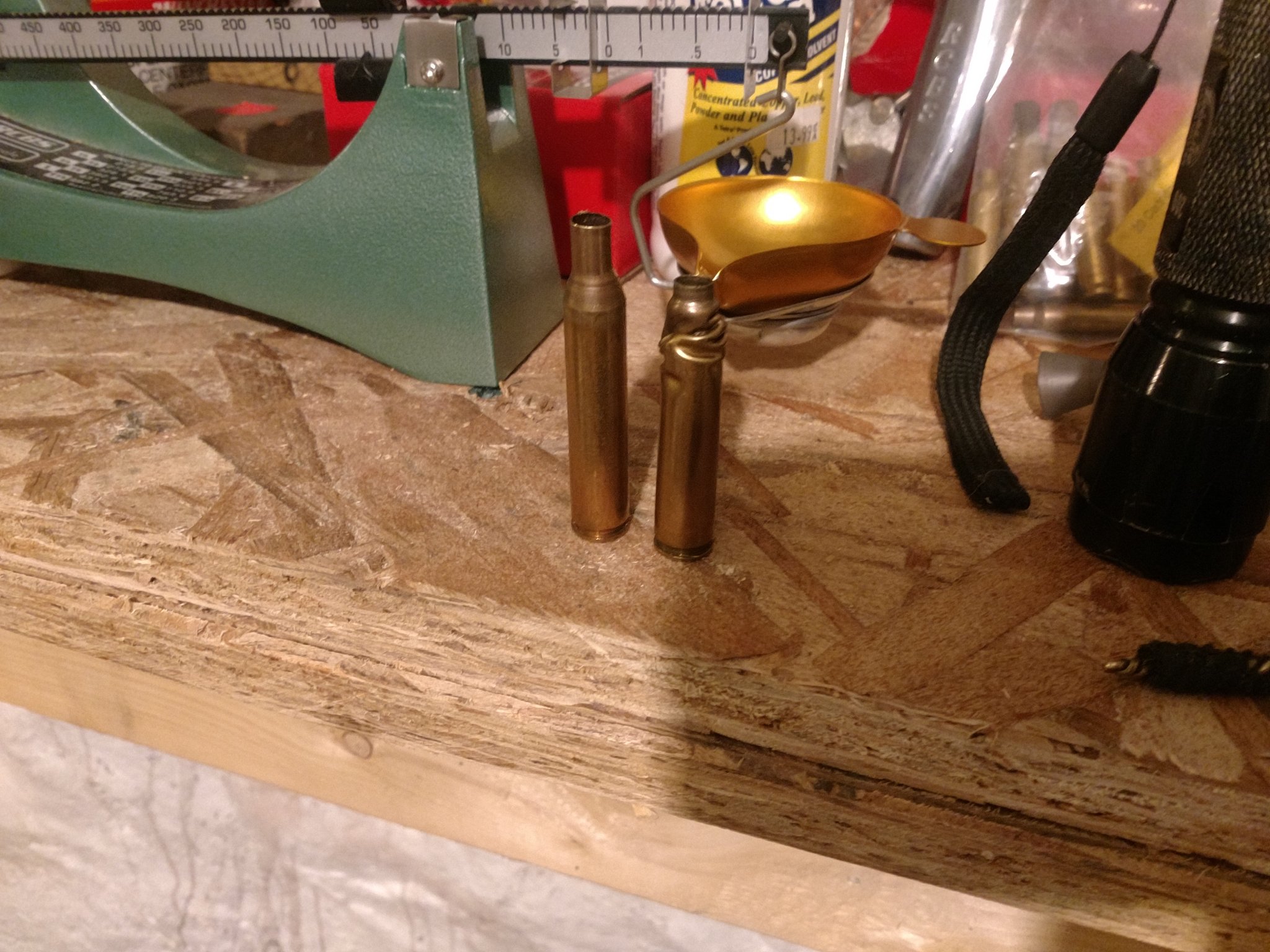

Have you tried running the case through an empty 6-06 seating die first?.
If you have a set of 270/280 dies around, they make for a great intermediate step.
Of course, starting with 270/25-06 brass is easiest.
That's the success story on the left. I ran it through a 7mm first, then the 6mm seater, then the 6mm sizing die.

The speed that the case goes into the die makes a big difference also.
I resized some 22-250 back up to 250 Sav and the first ten cases had crooked case mouths. When I went slower, the mouths came out visibly straight.

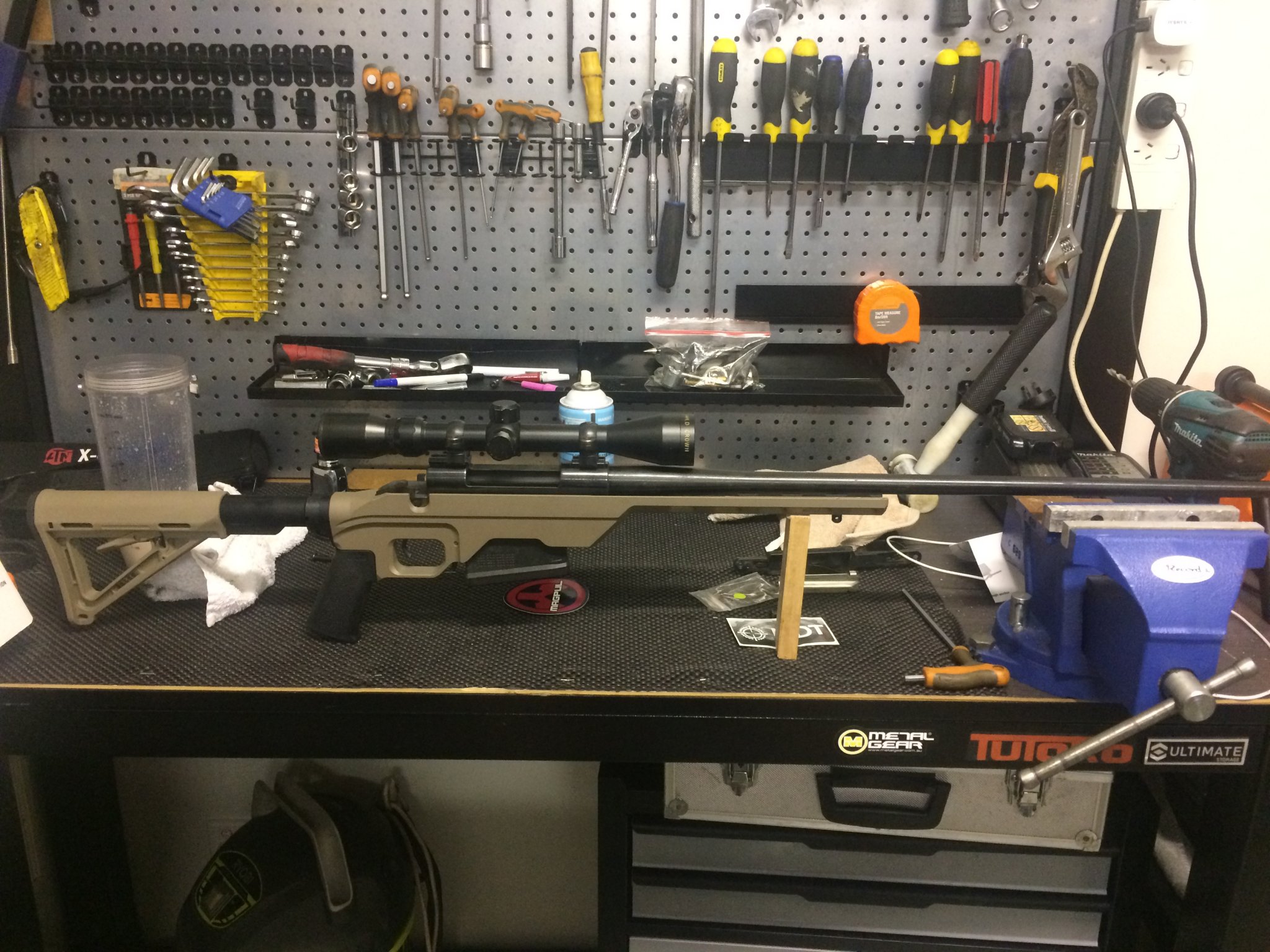

So I bought a barrelled action in 270 yesterday and an MDT LSS-XL chassis, and a magazine to start the build. I did some ballistic calculations and a 270 with a 28" barrel is verrrry...verrry... close to a 6mm-06 in terms of drop with a 90 grain pill (270) vs a 70gr pill doing 4100/4200. 270 I could potentially push a 90gr pill at 3850... Might be a cheaper option I can run with... saving 90USD on a set of bushes and 150usd on a reamer... Hhhhmmmm talking to myself out loud...
Keep that thought and see how it works out for you. Shoot it 'til it goes south on you then decide if you want to keep that route, or go a different route.
Like many on here I would advocate for a tighter twist and heavier bullet in whatever you choose. But, speed is it's own special thing. Anything based on the '06 case can give you that.
Keep an eye out for whats new in the shooting world and if you can get it. Can you get .25 cal? Reason I ask is there are now 131 gr. bullets that take a tighter twist and can be pushed from a 25-06 at 3200. You could shoot from one side of "Straya" to the other.:p:cool: shooting is a lot of fun to me, I just wish you guys had less limitations on you down there.

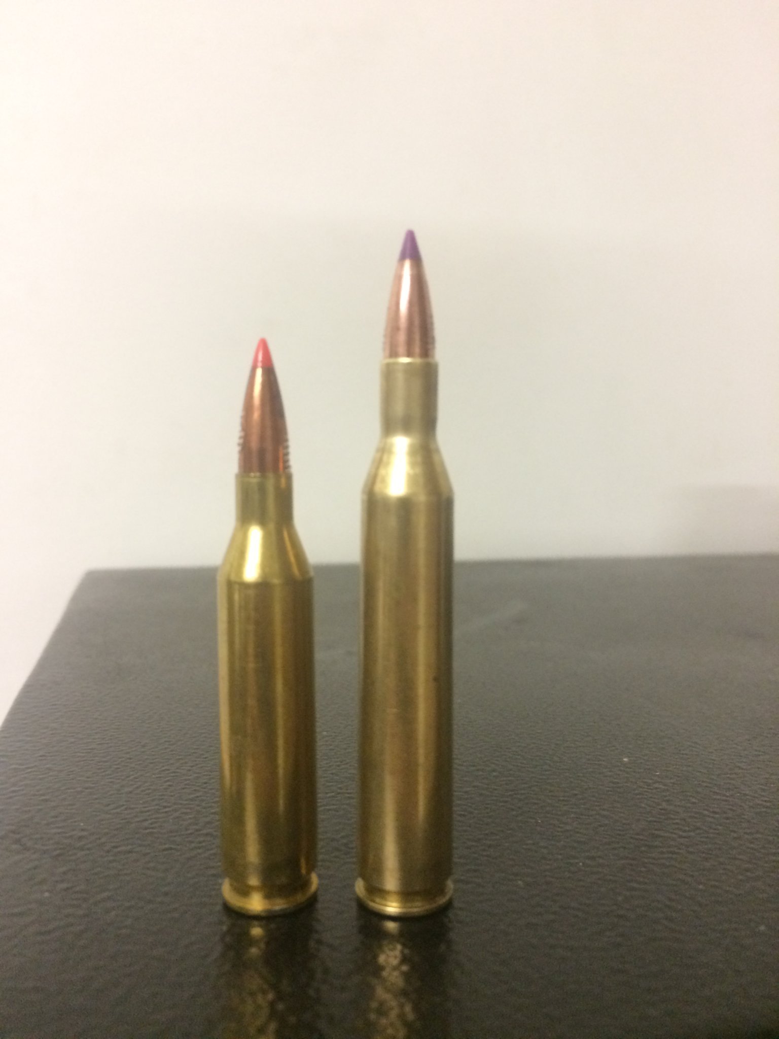

Haha holy moly.... I just did a mock up using 270 and 243 die... right is the 6-06... OMG lol... so excited for a laser beam!46434EED-98F5-489C-AB27-344E052C9ED5.jpeg

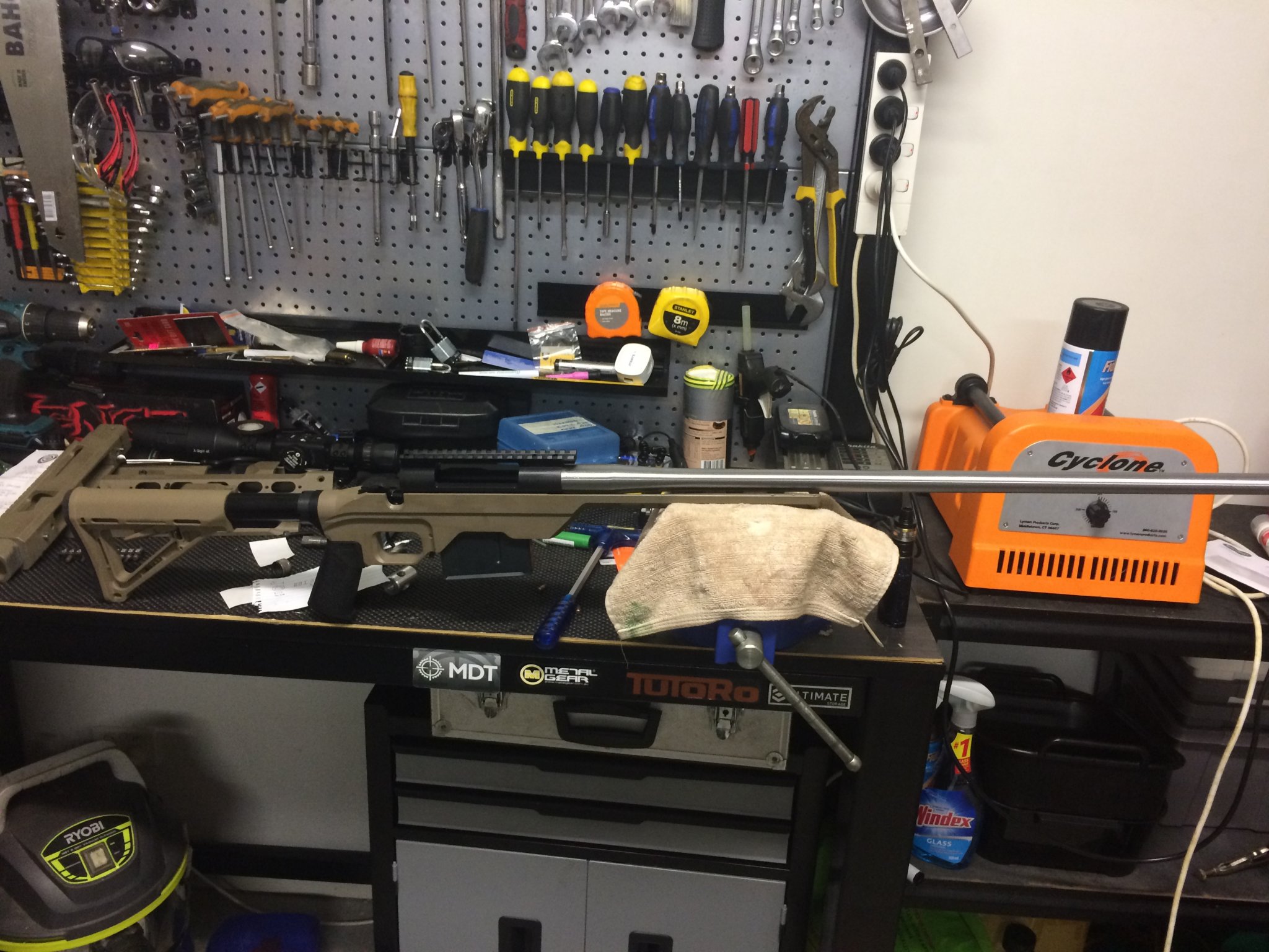

Finally got my 6-06!!! Still chasing some load data! However I am getting some 70gr pills and heading to the range on Monday. I can have noslers, hornady or Speer tnt. Not sure if I should run boat tails or flat bases. Out to 400 on dogs. ANy recommendations?

Nice looking rifle Jim.
