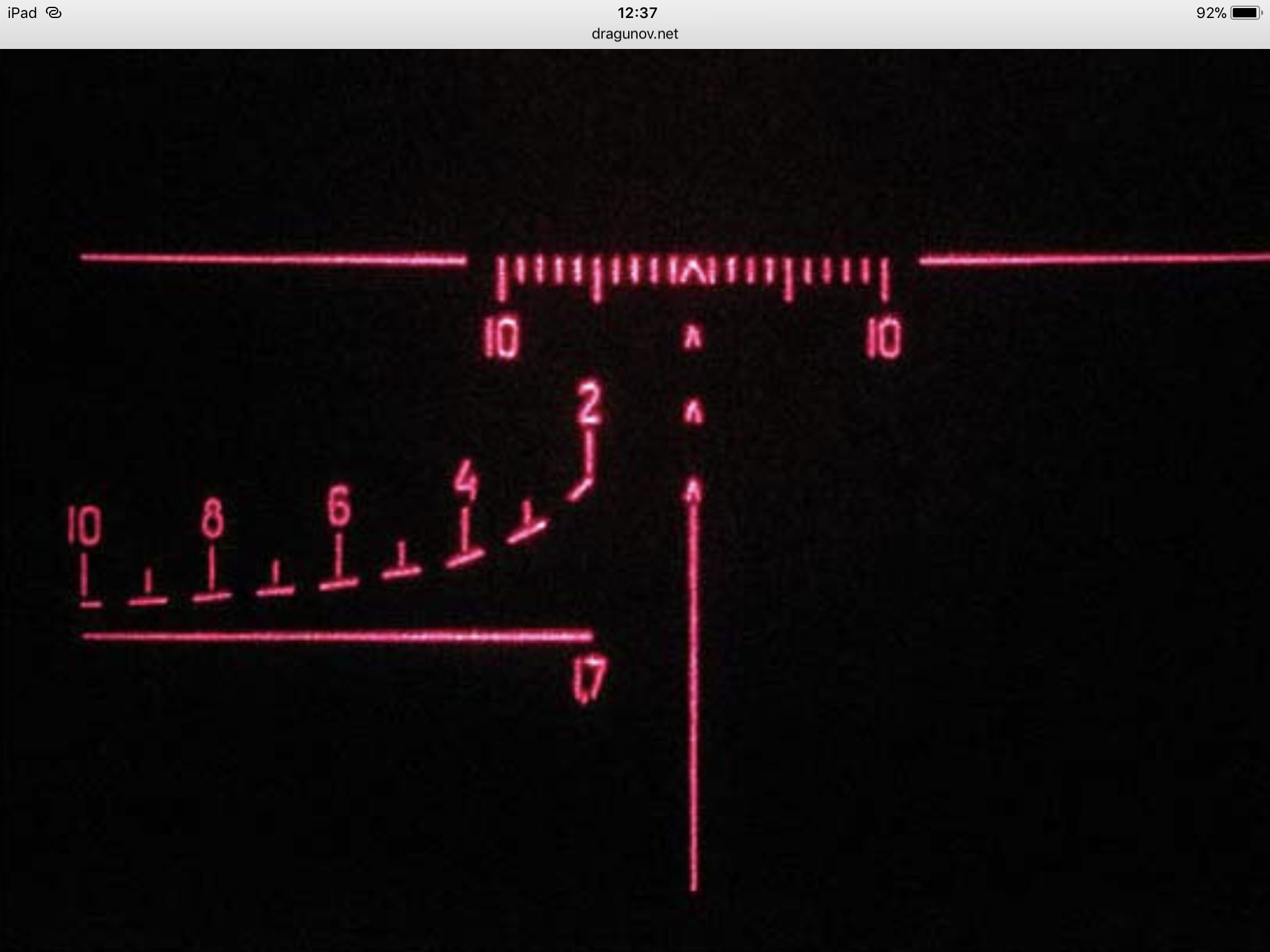

Clearlight: Hertel&Reuss had a proper FFP christmas tree reticle as an option in their 2.75-10x45 in the middle of the 70'ies.

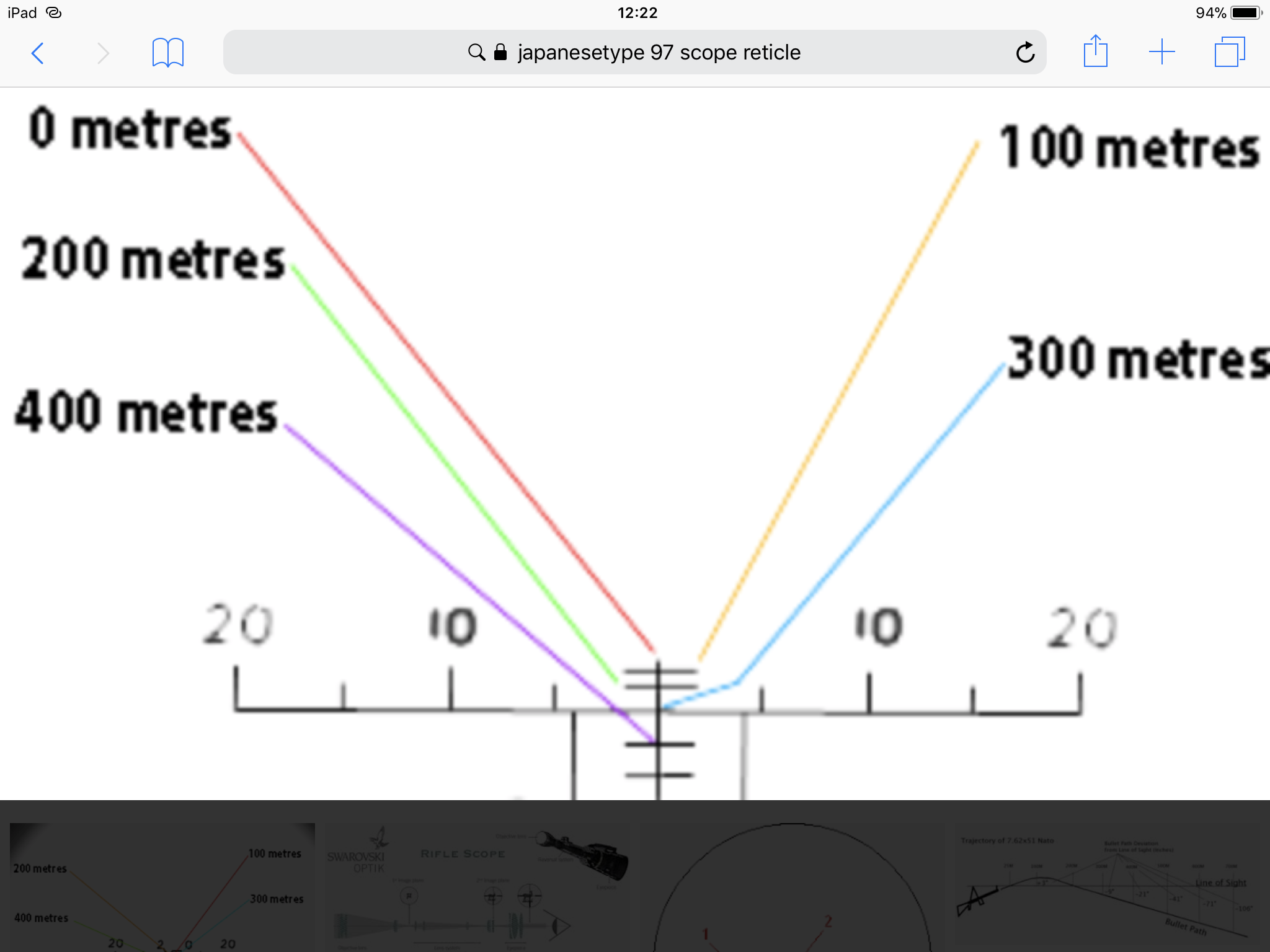

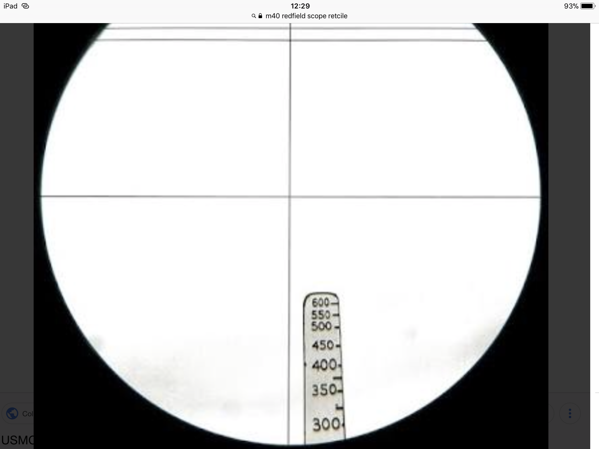

Thanks TorF , had a quick google and couldn’t find it . If you have an image of the Hertel & Reuss
reticle you mentioned , we’d love to see it . Seems a few folks rated them better than Zeiss optics
of the day .
