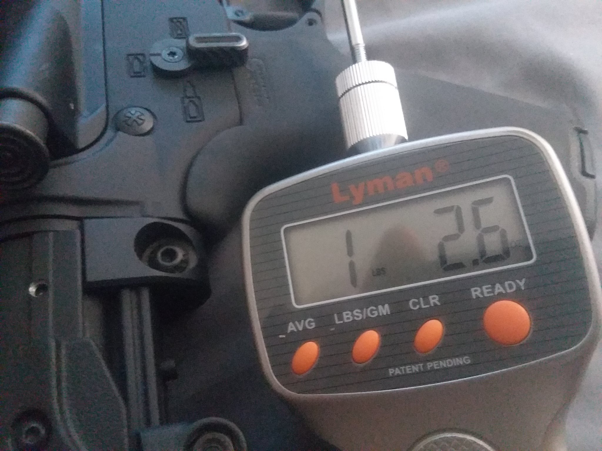

Update with a rimfire related test this past weekend with the CE posted above.
Some may have seen I have a .22wmr upper and it is a little finicky in the trigger dept. Anything under a 4lb weight and I will get light primer strikes. It ran with a 3lb but lps were intermittent. I tried a few things to make the 3lb work reliably, lighter firing pin spring etc, but to no avail. I kinda pulled a go figure when lps was more prevalent in the cold of winter.
Anywho, tested it with the CE and it was flawless, absolutely set off every single one of the 400rds I cooked off.
I really want to double down on another for my wmr lower, pretty much all my scoped ar platforms, but wanted to double check if Timney gives the nod up for running the 1.5lb CE on ar fcg rimfires? During my research I came across some literature that stated your CE has a 5lb hammer spring, seems about plenty of umph to set things off?
Oh btw, put me down for CE for a 452 please. 😁
Reactions: Basher
Shouldn't be a problem! Go on our new website and place the order, or give us a call 1866-4Timney. Remember they are lifetime warrantied!
