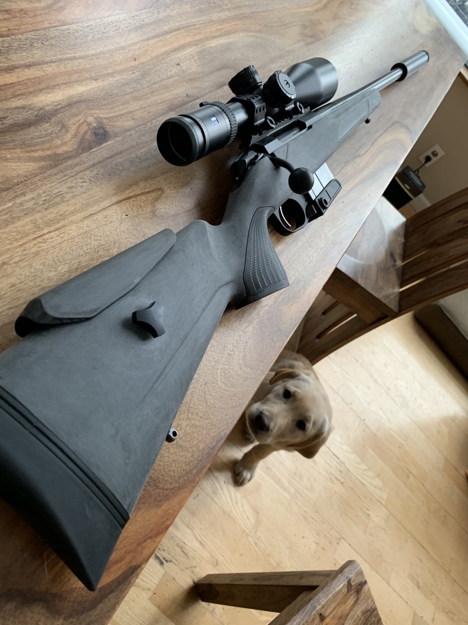

Quick question for Tikka users.
Have any of you experienced slam-fires after adjusting the trigger? On my T3X CTR, it is possible to adjust the trigger weight low enough to where the gun will slam-fire when the bolt is closed or smacked hard enough, and that's with the factory spring in place. There's no way I could use the Yo Dave spring safely in my gun.
Obligatory picture:
#3,967.

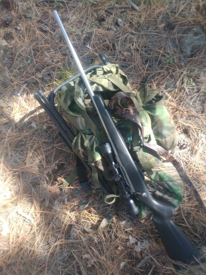

Guys, about to pull the trigger on ordering a T3X CTR 24" 6.5 Creedmoor. Will be my first long range precision rifle. At some point will upgrade to high end SS barrel, may or may not shoot out the factory barrel. Only question I have is what metal to get. Can get it in blued CM steel or stainless. EIther way, planning on cerakote at some point action and barrel. Not that concerned about corrosion resistance, i'll maintain the rifle well either way. Uses will be range and maybe some hunting. What grade stainless is used, is there any accuracy benefit in the factory SS barrel over the factory CM barrel? Is the action smoother and/or stronger either way? The SS model is $100 more than the CM, is it worth the $100 to get the SS model?
I got the stainless and synthetic for moisture and temperature resistance. while in the field I cover alot of ground on foot Ill be out in whatever weather mother nature throws at me.

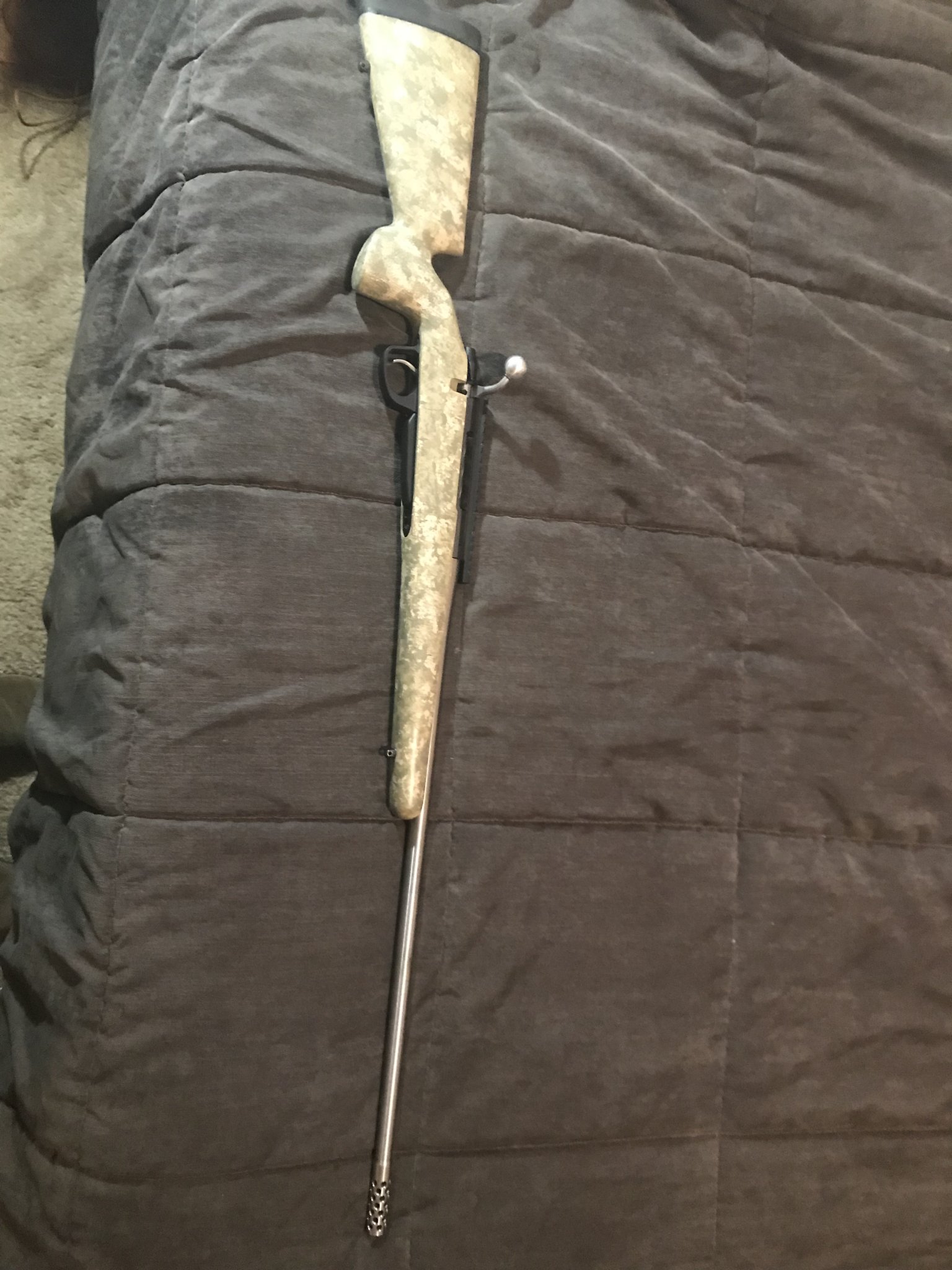

Took this in on a trade. I don’t hunt so I’m trying to decide if I want to sell it or rebuild it.
Mountain Tactical 6.5 Creedmoor
Mountain Tactical Brake
Mountain Tactical BM
Spiral fluted Bolt
Swept Bolt Handle
McMillan Game Scout
Yo Dave spring

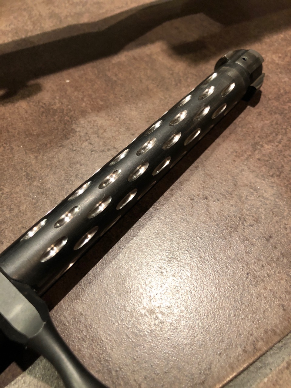

Can you post a pic? Id like to see the flutes if there's not much surface between the flutes the fluting could be the culprit?
I don't think the flutes are the cause. It happens with the bolt all the way to the rear when the flutes aren't even in contact with the action channel.
I gave it a good cleaning and its definitely a bit better, but still not perfect.
