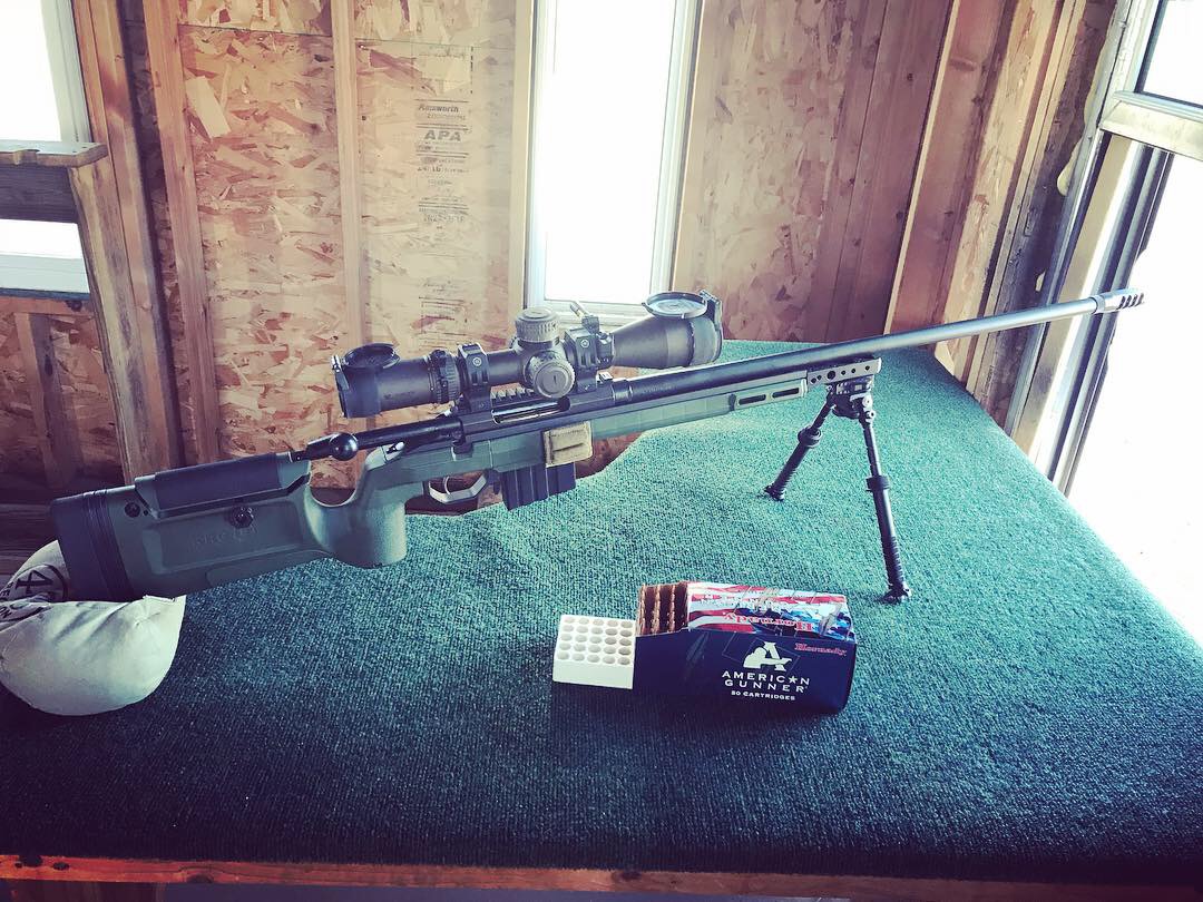

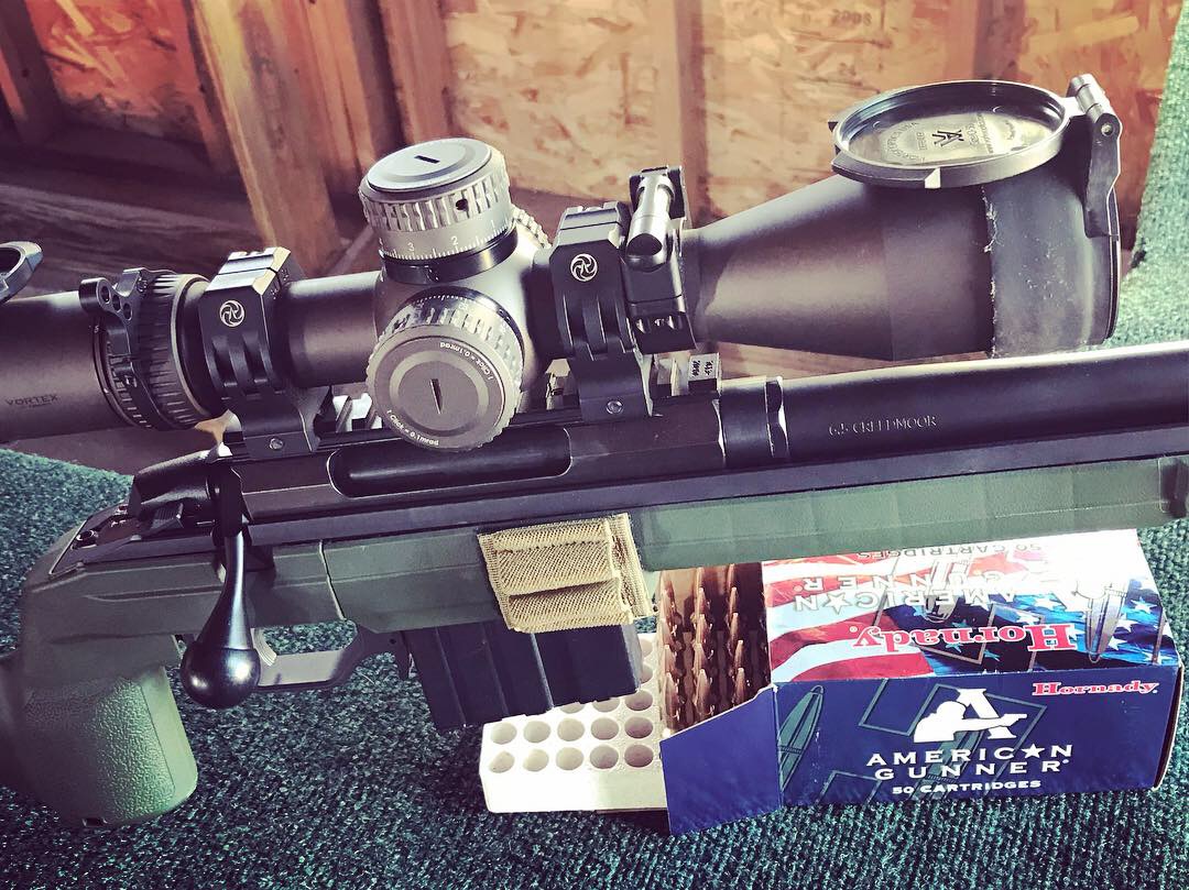

Just have to show off the newest member of the family. Bought off another Hide member...Specs are:
Tikka T3X action
26” PVA Prefit Rock Creek barrel (light palma contour) & Barrel Nut from PVA
Seekins Precision ATC brake
Elay Precision trigger spring (1.3 lb pull)
Sako green KRG Bravo with spigot mount
Atlas/ADM with HHC Talon feet
20 moa scope rail
ARC M10 scope rings
Vortex Razor HD Gen2 3-18 with ebr 2c mil reticle & SV-3 throw lever
Flatline Ops bubble level
So far it shoots awesome, but I’ll probably chop the barrel to 22” to make it a little less cumbersome for hunting. Next up is a titanium bolt shroud and bolt handle from Sterk.

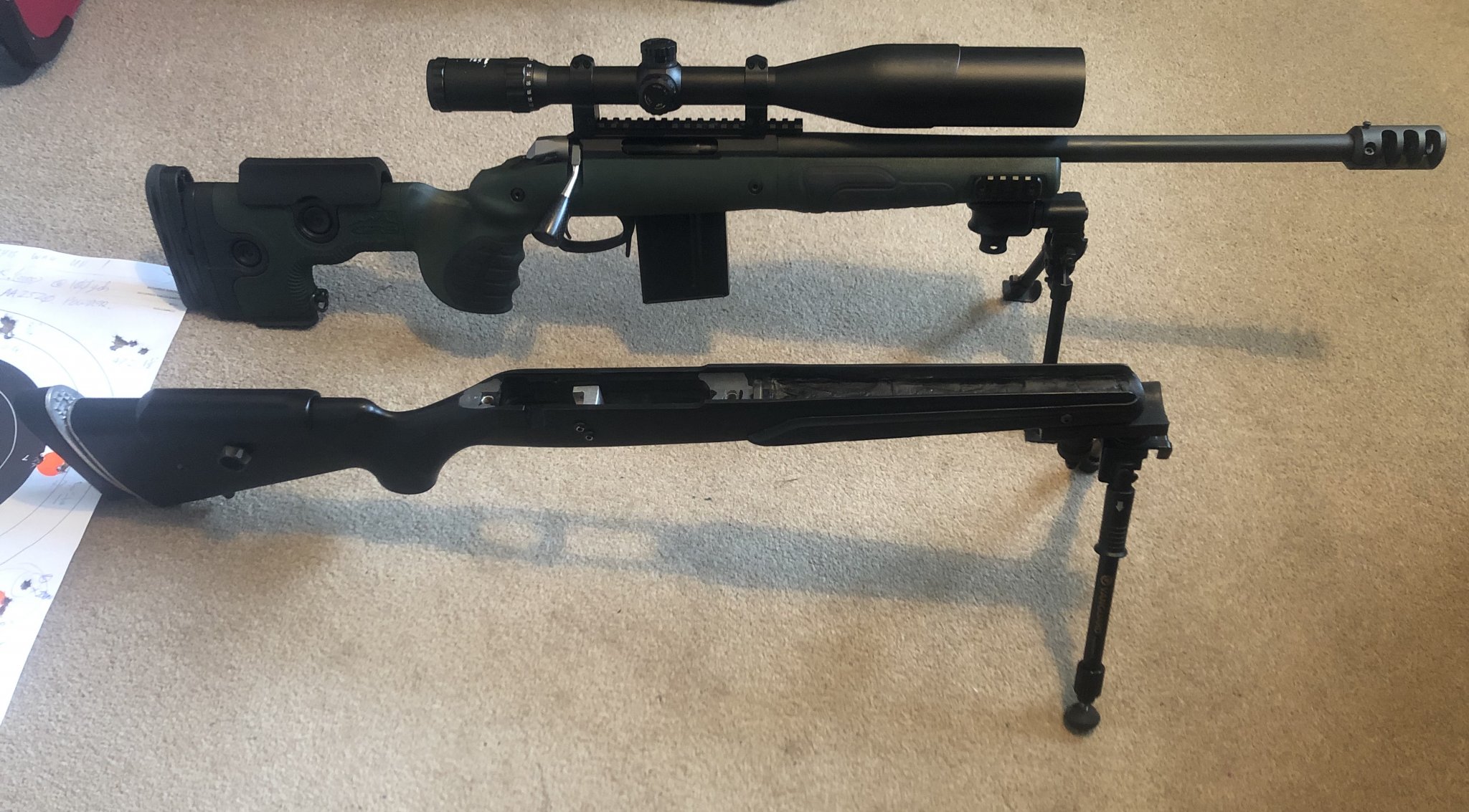

I’m new hear but I’ve been shooting a Tikka T3 Tactical 308 for a long time. I reinforced the standard stock & inlet it for an AICS mag bottom metal. It’s been that way for a few years now & shoots really well with the right ammo.
I have considered a chassis kit for sometime, but they are quite expensive here in the UK & I chose the 20” so I could use it in the field as well as the range. So I liked the look of the GRS stocks & finally got to try one in the flesh a couple of weeks back when another shooter brought a Berserk to the range.
Whilst doing some research on these I came across the new Bifrost which seemed a better stock from the info available, so after acquiring one & inletting it for my AICS mag bottom metal, here is the result.
Feels great, hope to see how it shoots tomorrow, but the weather is looking bad ☹
Enjoy
