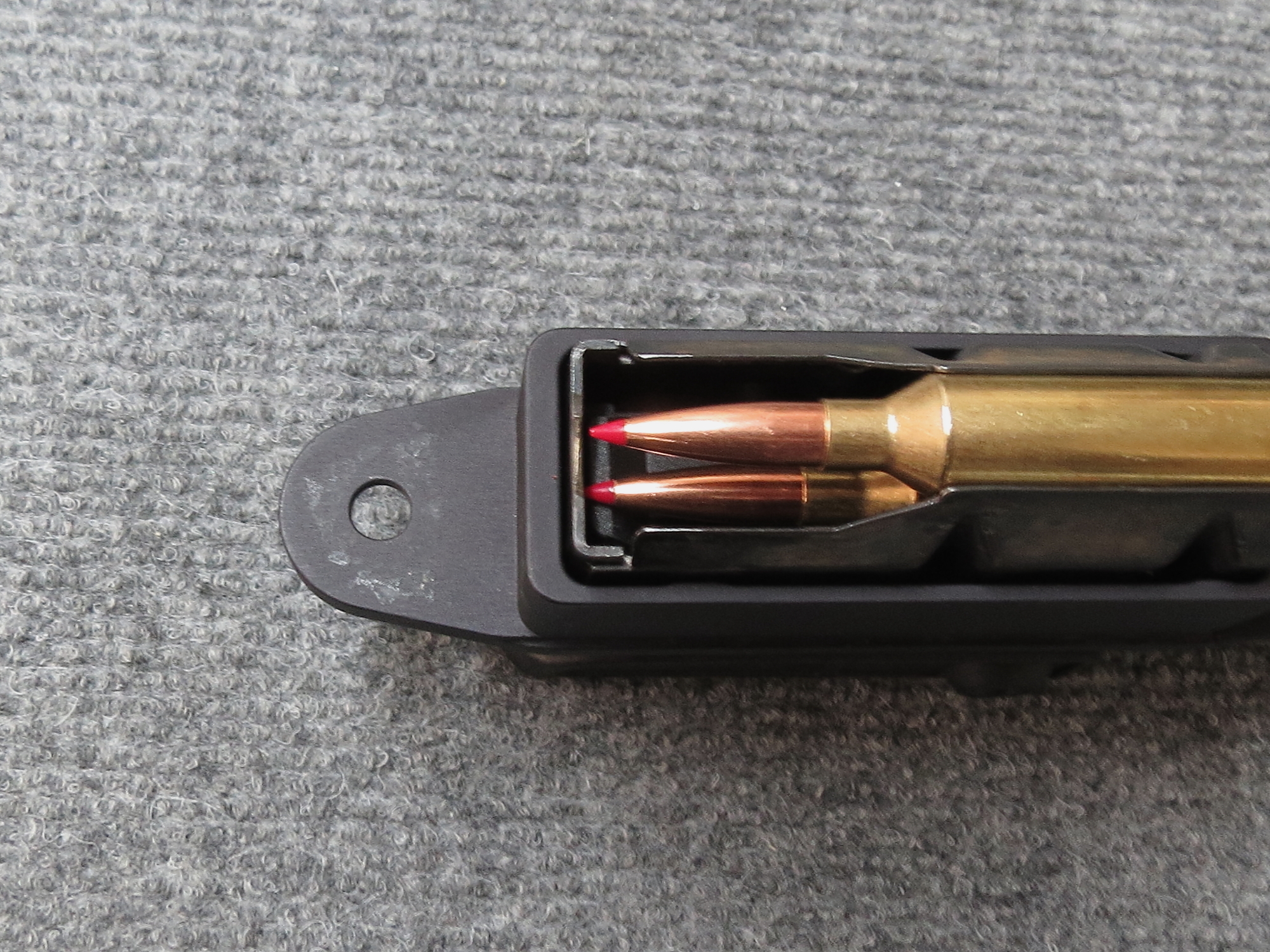

I've got a build in the works turning a T3 in 300WM into a 7suam. Still waiting a few months on my Proof barrel but trying to get components lined up. Was planning to use the factory trigger guard/mag... but it is looking like there aren't many options for after market stocks for the long action. Mostly appears everything is designed for the short action CTR. This is going to be primarily a hunting rifle so don't really need a large mag sticking out the bottom. Also guess you could say I'm more of a traditional guy, not really warming up to the rifle chassis.
Thoughts/comments?
Thanks a bunch!

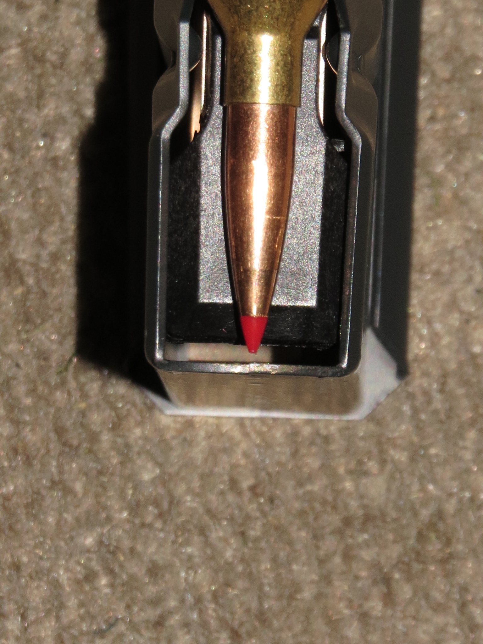

All of the standard (non CTR) Tikka bottom metal (plastic) inlets are the same for long and short action calibers. Any stock that is made for a Tikka will work as long as it isn't a CTR bottom metal inlet. Not sure if anyone makes aftermarket AICS bottom metal for SAUM or WSM rounds for the Tikka though.

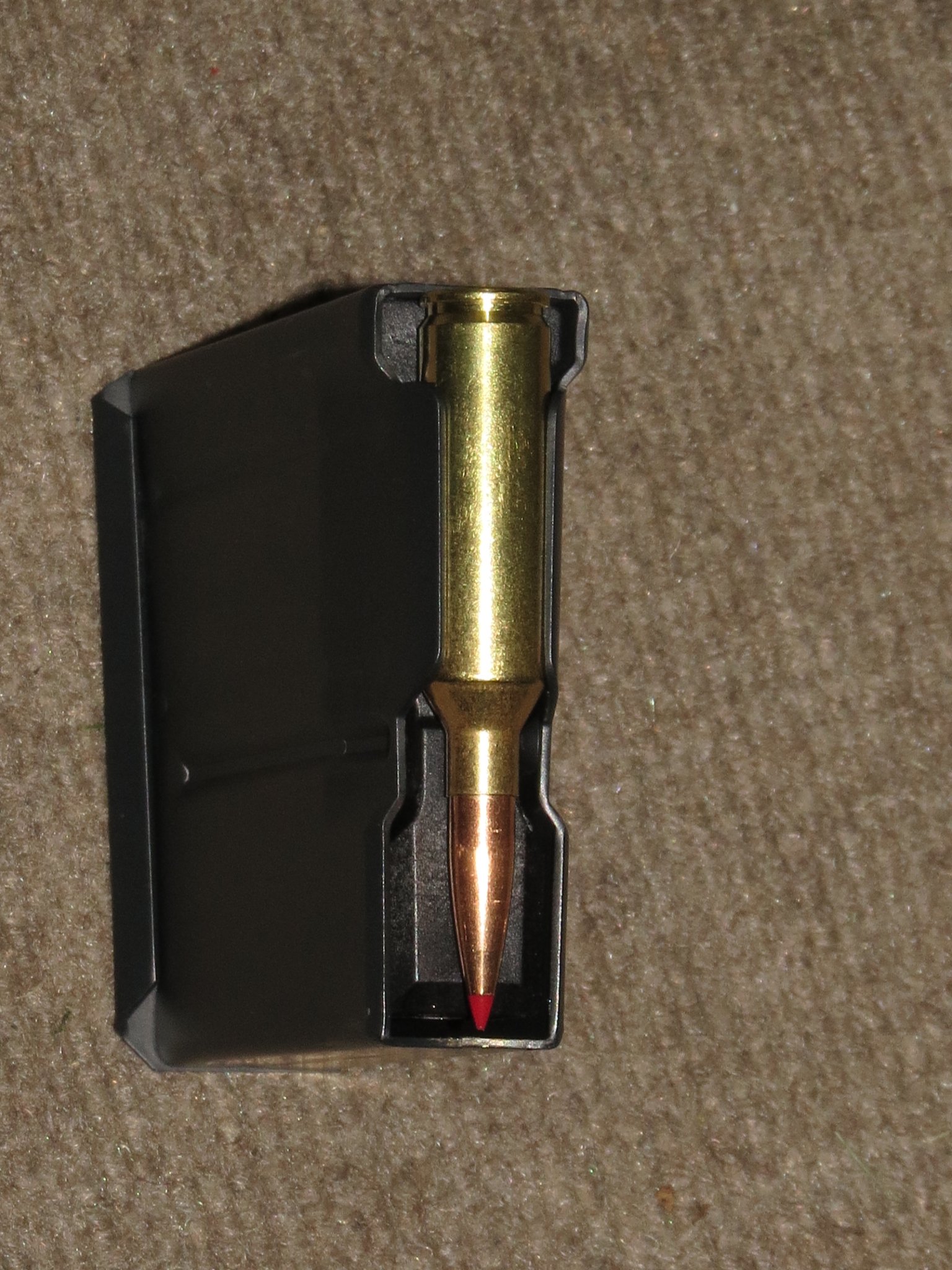

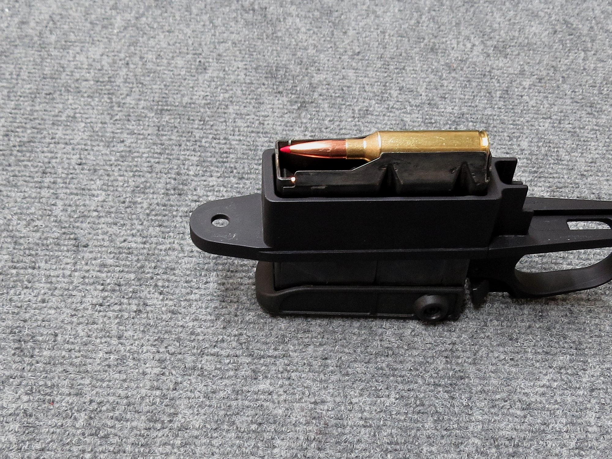

There are quite a few companies that make aics bottom metal for standard tikkas
Most people are using the 308 metal magazines without the binder plates and are able to load the fatty's with coal's to 2.95
You can also use the CTR factory mags with the short fatty's if you tweek the feed lips....
Now that you say that, I do remember seeing a guy running the 6.5 saum in slightly modified CTR mags. I believe he was getting 6 rounds in it.
