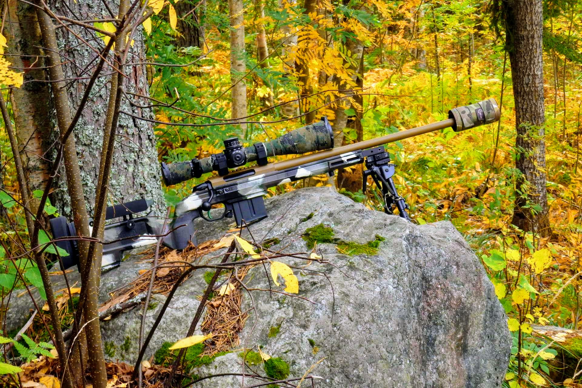

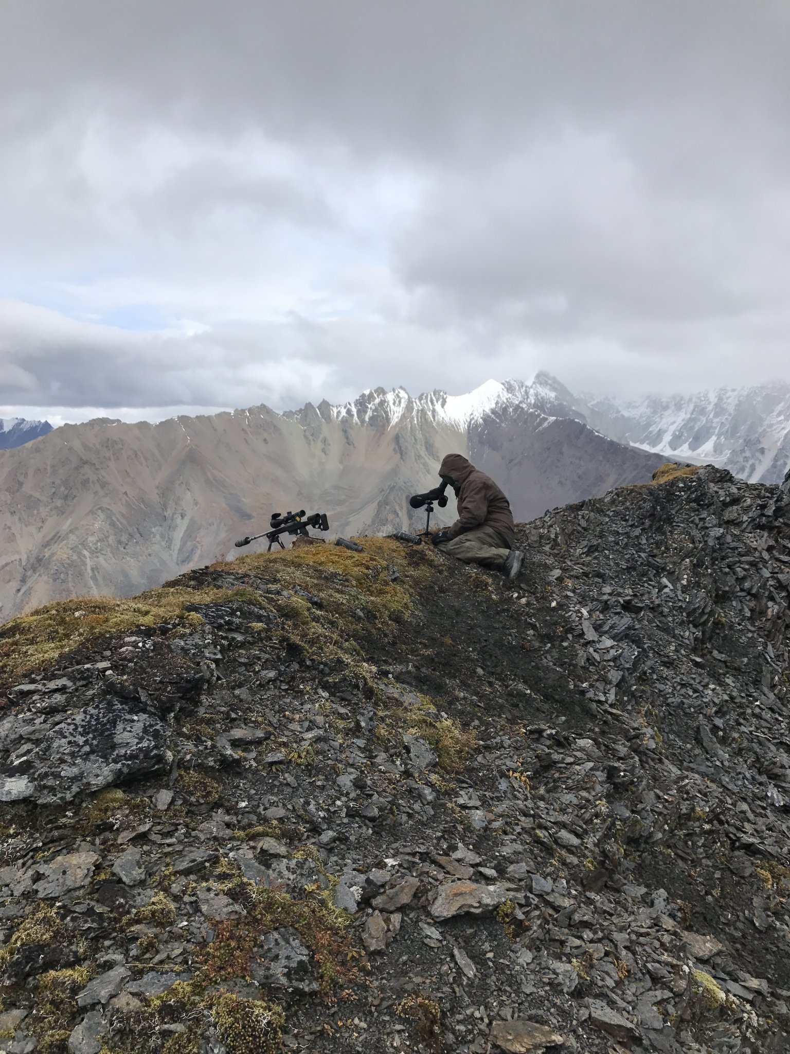

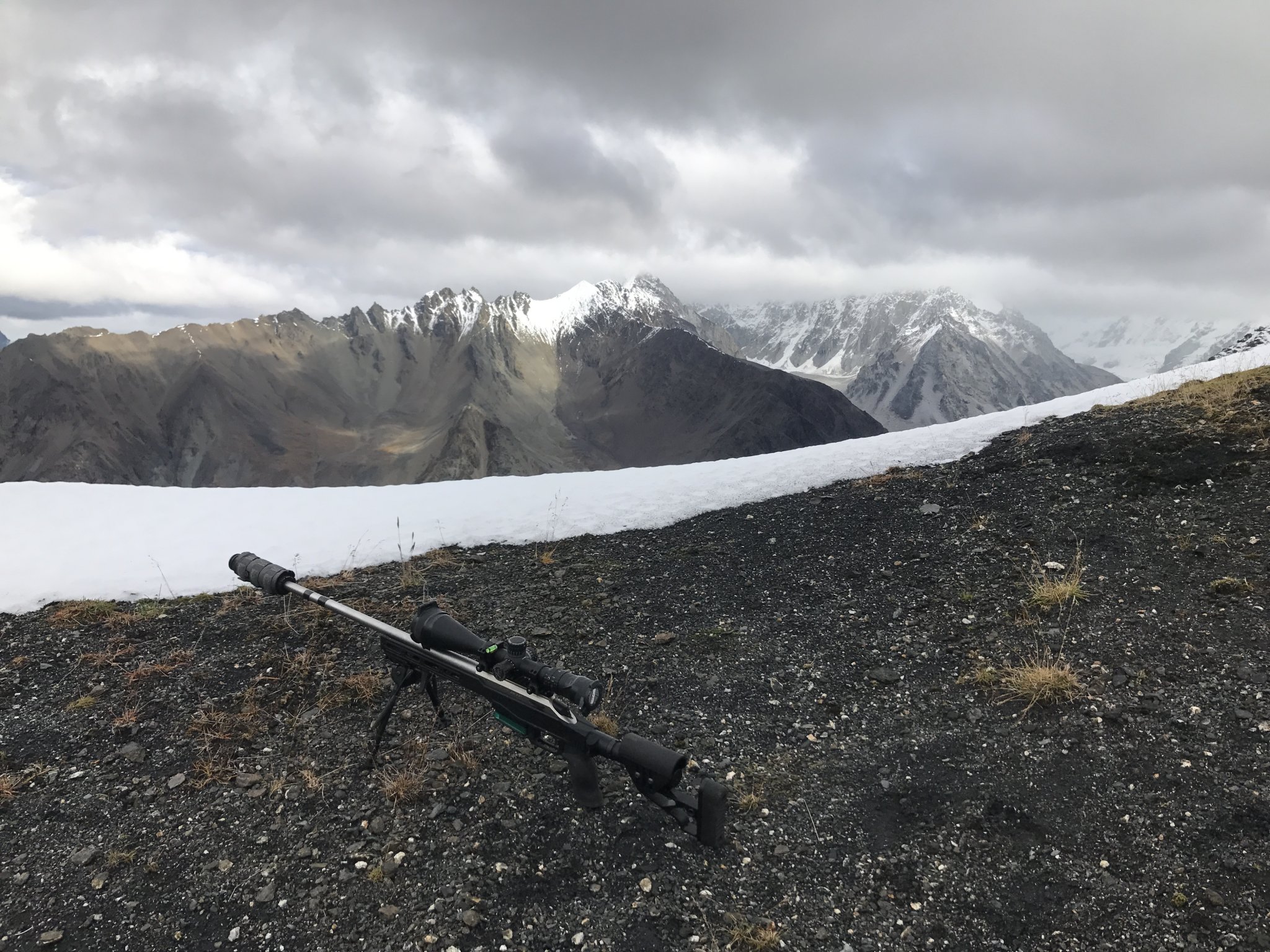

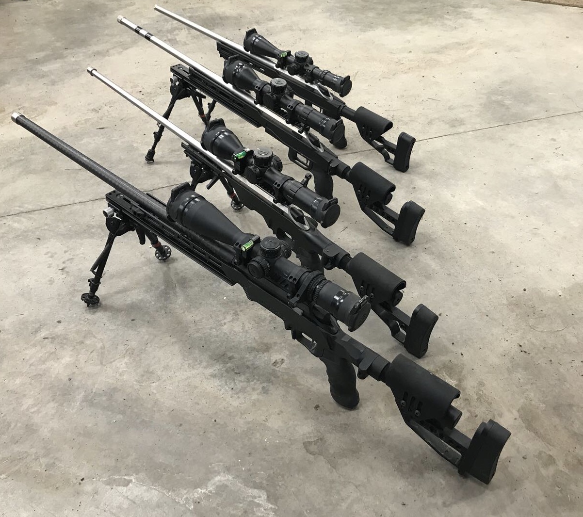

How do you like the XLR's?
I like them a lot. In the pic above with the 4 rifles 2 are MDTs (skinny barrel is a 300 WSM T3X lite in an MDT LSS). Carbon barrel is an MDT LSS-XL Gen 2 long action so I can load the 7 WSM to nearly 3.2" COAL :)
The end two are XLR elements both 6.5 CTRs with 24" barrels. Big fan of the folders especially for backpacking. Will load a pic of my wife's 20" CTR 6.5 CM with a folder on it. We both shared the rifle on our annual kodiak deer hunt this fall. (BTW 147s out of a 20" barrel at 2720 fps work just fine ;) ).
alaskalanche
Belligerents
Dec 22, 2017
397
178
49
Sweet collection at the bottom, specs? :)
Need to copy your taping of the lens caps, Vortex Defenders right? Find they slip and wobble alot, especially the rear.
Yeah its cheap insurance for sure need to get "tactical matte" electrical tape I guess to be less obvious. ;)
The 4 rifles is the 4 my buddy's and I used on our hunting trip. 2 were mine and 2 were my buddy's. My other two Tikka chassis rifle (wife's 20" CTR and the 22-250 T3 Lite) weren't pictured.
Rifles from left to right (closest to far away):
Carbon barrel, 7 WSM, Vortex AMG, MDT LSS-XL chassis and XLR Tactical buttstock, new style MDT folder on buttstock (Used it on a moose at 150 and caribou at 490 2 weeks ago).
300 WSM T3X Lite, Bushnell DMR 2 (though I am trying to convince him to go back to the LRHS 4.5-18X44 for that rifle as its was just over 10 pounds with a folder on it when it had the LRHS on it.), MDT LSS chassis, XLR Tac Lite buttstock, XLR folder. Used it on a dall sheep at 810 and a moose at 330 2 weeks ago and 2 caribou (one at 610 and the other at 210) last week.
last two are clones with only real difference is one has a folder and Bushnell DMR 2 on it in the pic (swapped to a NF 4-16 F1 right before we went on the hunt and right after I took the pic. The other doesn't have a folder and has a LRHS 4.5-18X44 on it. On of them killed a grizzly at 550 last week.

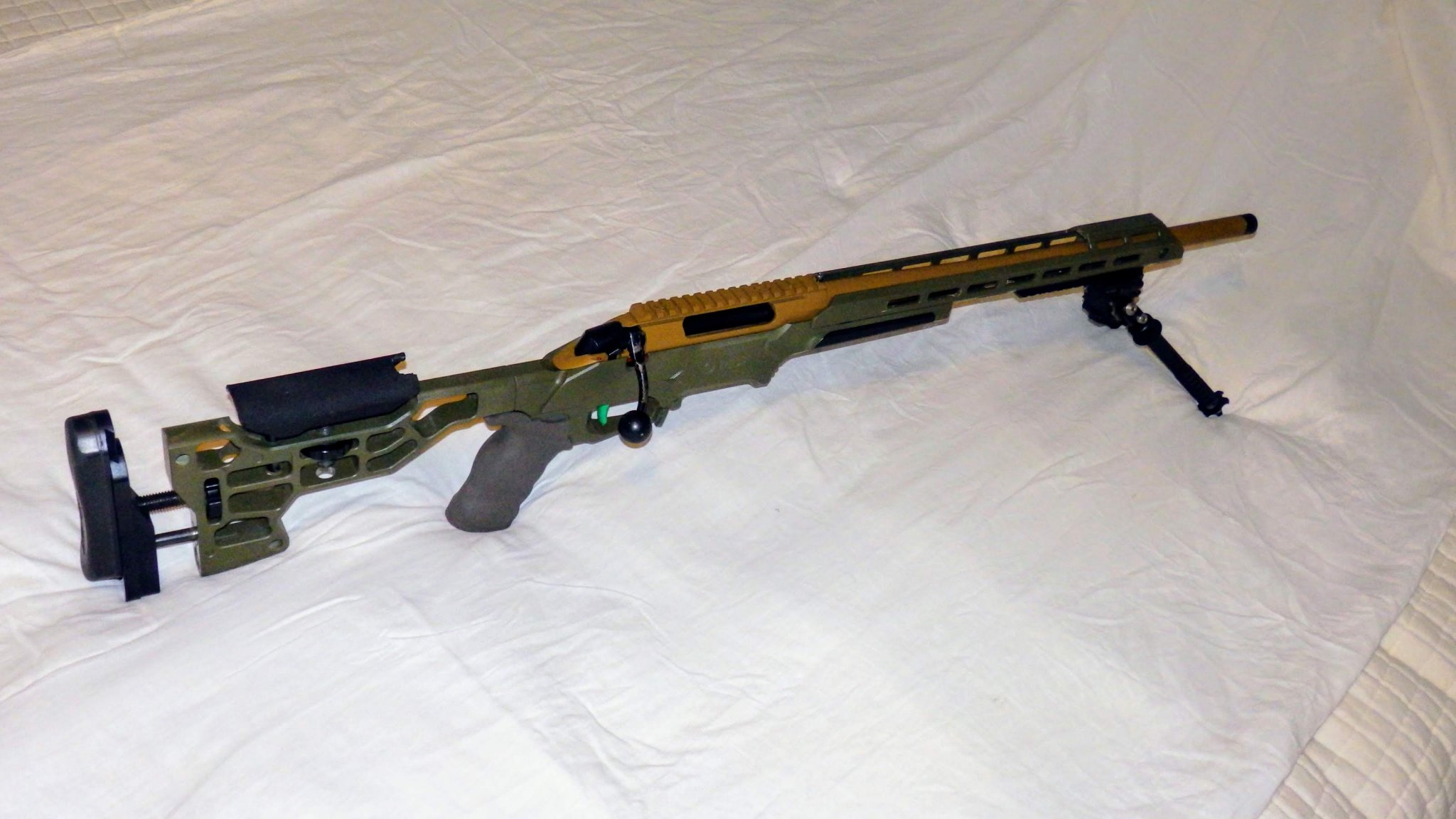

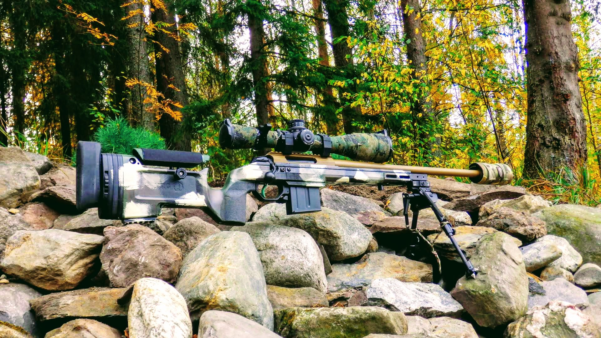

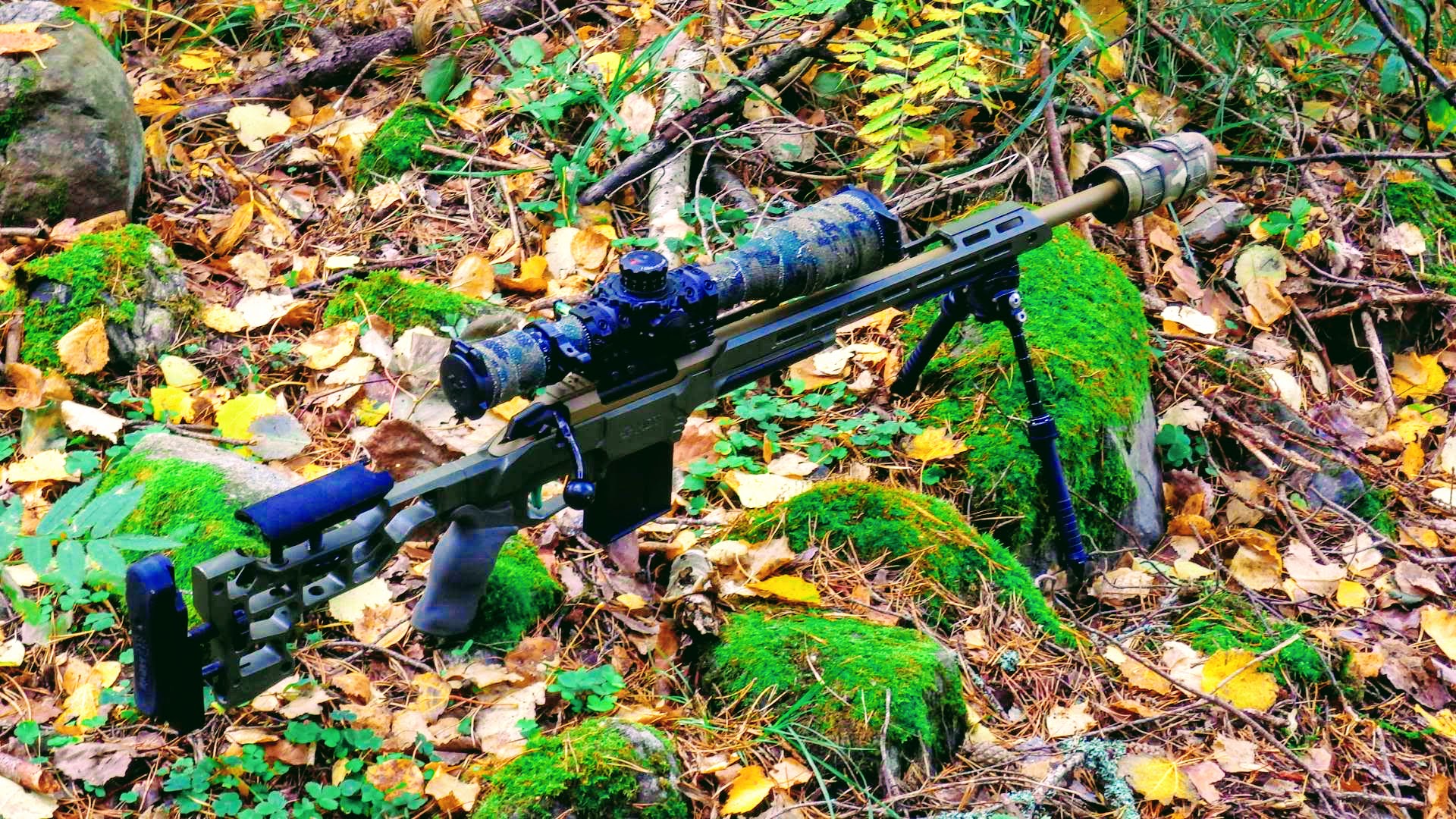

Thank you guys for all the likes (y):love:.
Here´s few more pictures, maybe i should start to be camera trigger man, than rifle :ROFLMAO:.
Der Trooper.
The Predator.
Viking -

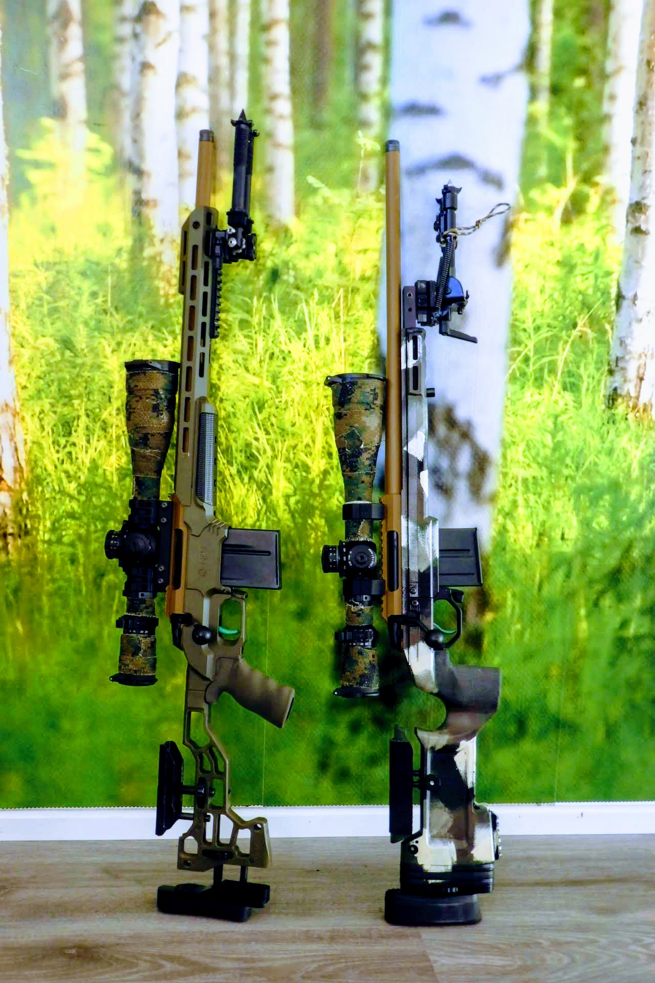

Great looking pair of rifles, congrats!
I am very interested in picking up a Tikka CTR in 223 when/if they come out next year and I must ask:
How would you compare and contrast the two stocks? Bravo/MDT ESS? is either better for use in a particular application, (hunting, table top shooting, prone etc) and do you prefer one over the other?
I am 6'2" with a longish neck, maybe one would be the better fit and looking for clues.
Appreciate it and I would welcome others to share their thoughts on either chassis as well.
viking78
Belligerents
Jul 6, 2011
542
574
99
41
FINLAND
Viking -
Depend what you want and what you shoot?
MDT ESS is full alloy chassis, KRG Bravo has only alloy backbone, it is 3lbs lighter.
ESS has more adjustment in your fingers, Bravo does not.
If you like to shoot more AR style rifles, ESS is your choice, but if you are more familiar traditional bolt action guy, Bravo is better.
ESS is more versatile straight out of the package, but Bravo ain´t bad, and you are able to get folding stock for it later on, where has all the goodies, if you want to upgrade it.
Wont go wrong neither you ever choose.
I like them both, and when i got some more cash, i have a vision to get this folder, or fixed, i am not that keen on the folder, even though it is handy.
