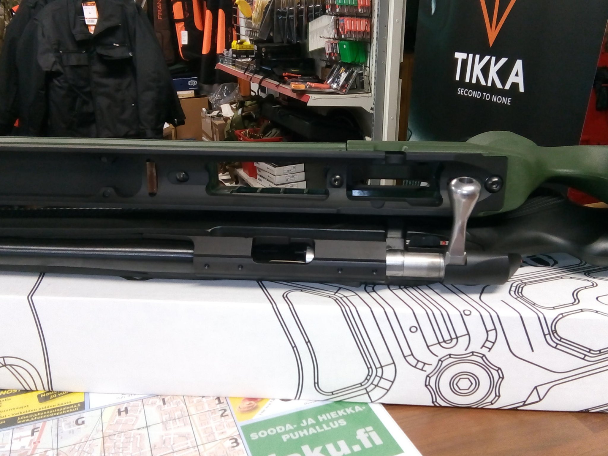

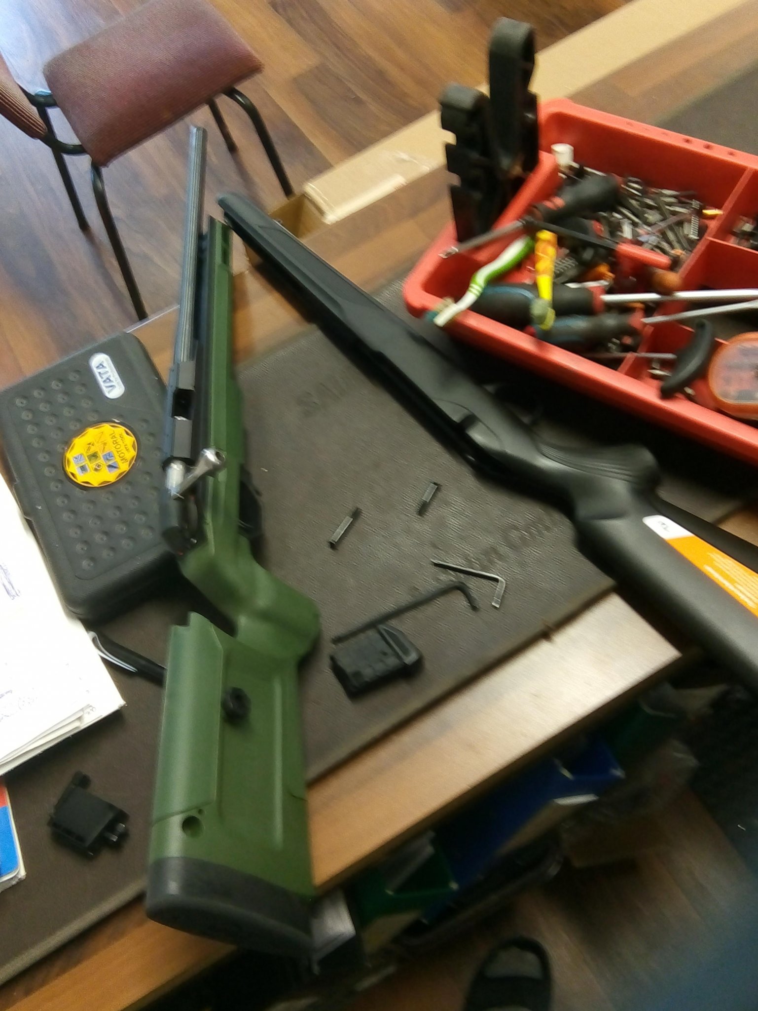

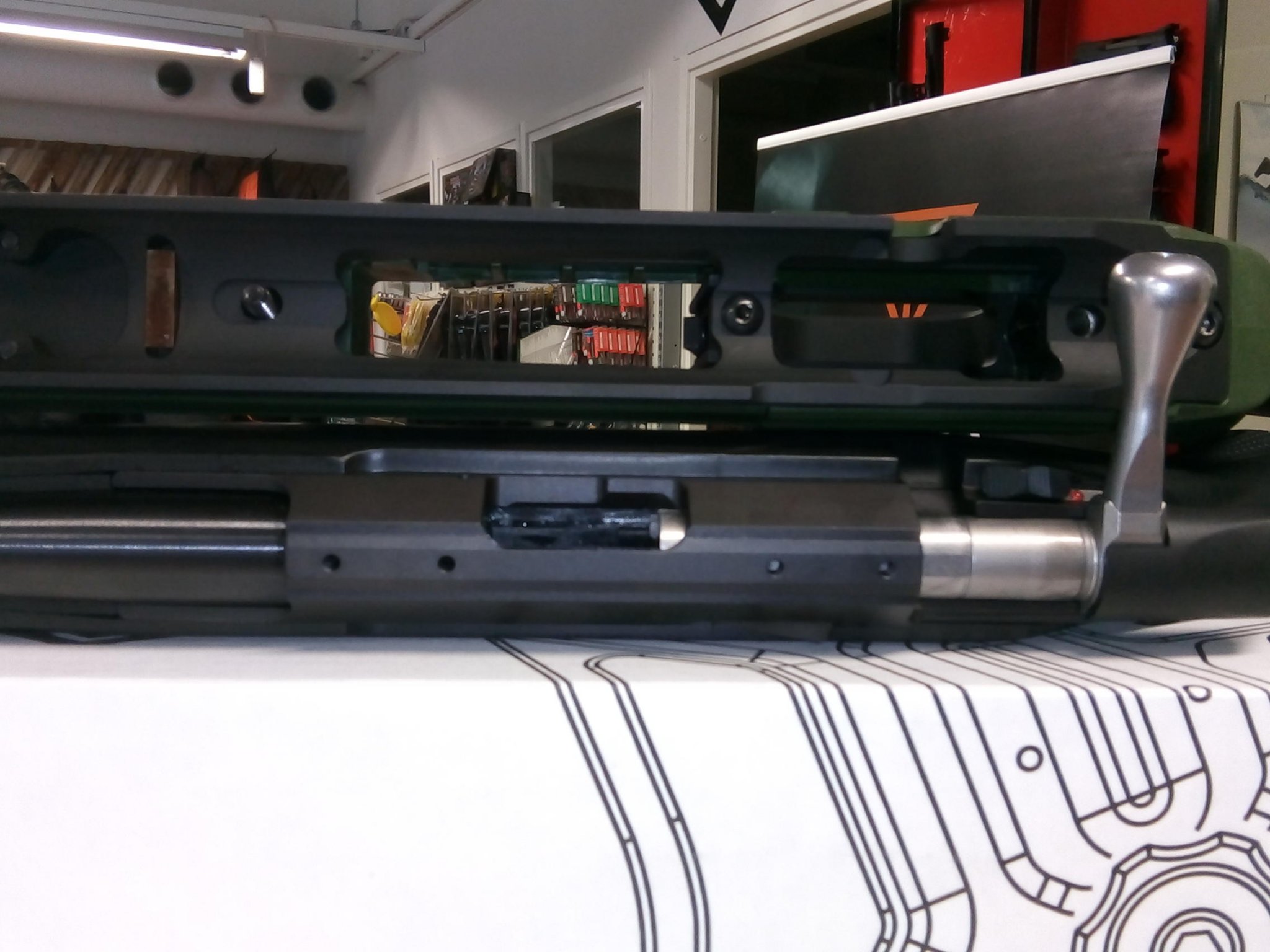

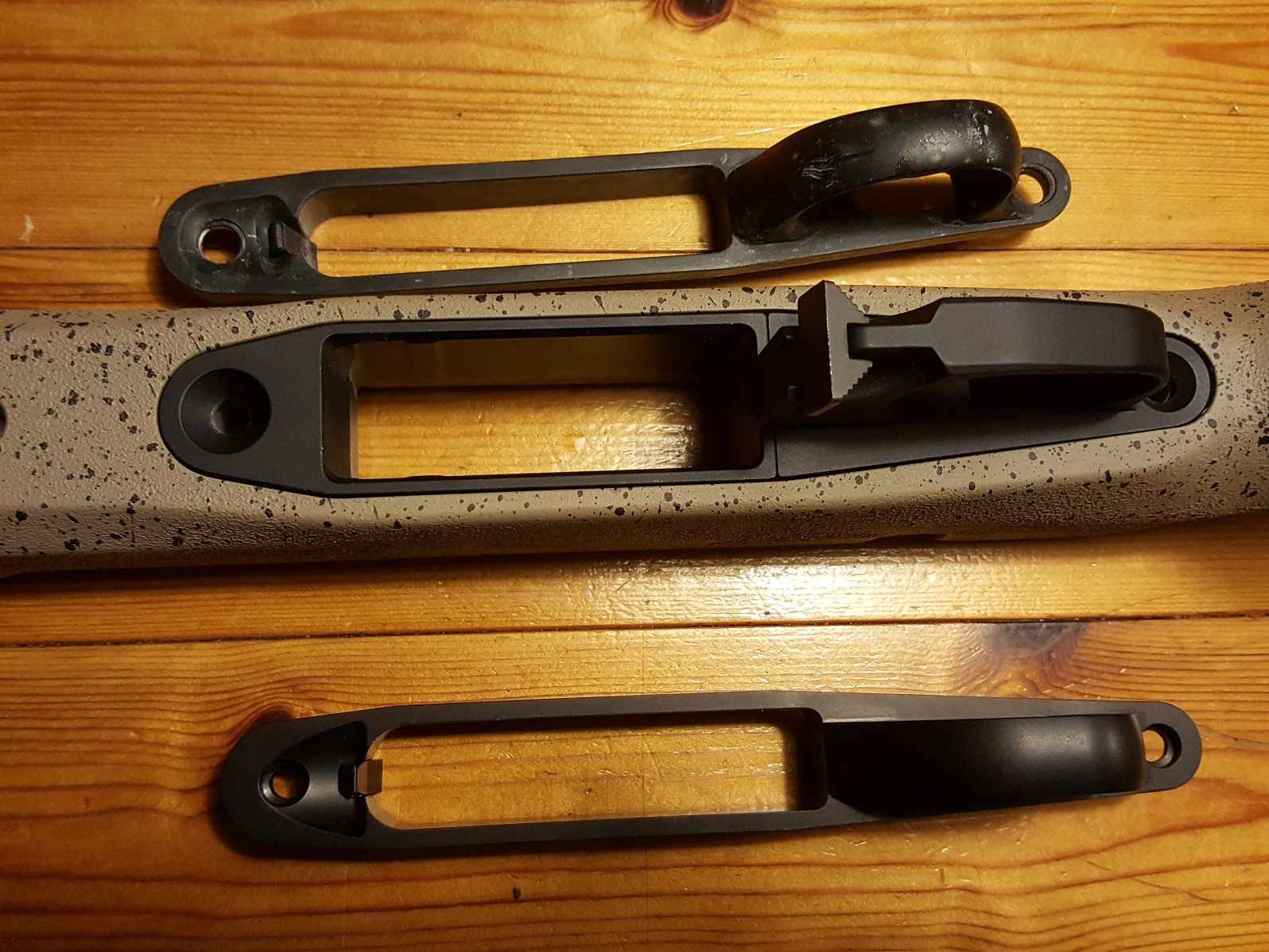

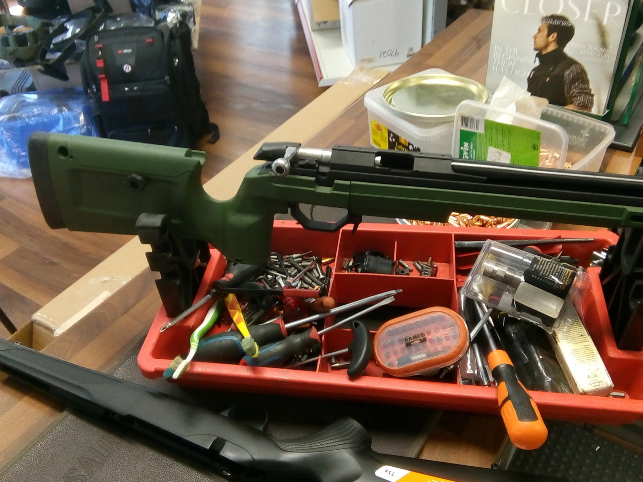

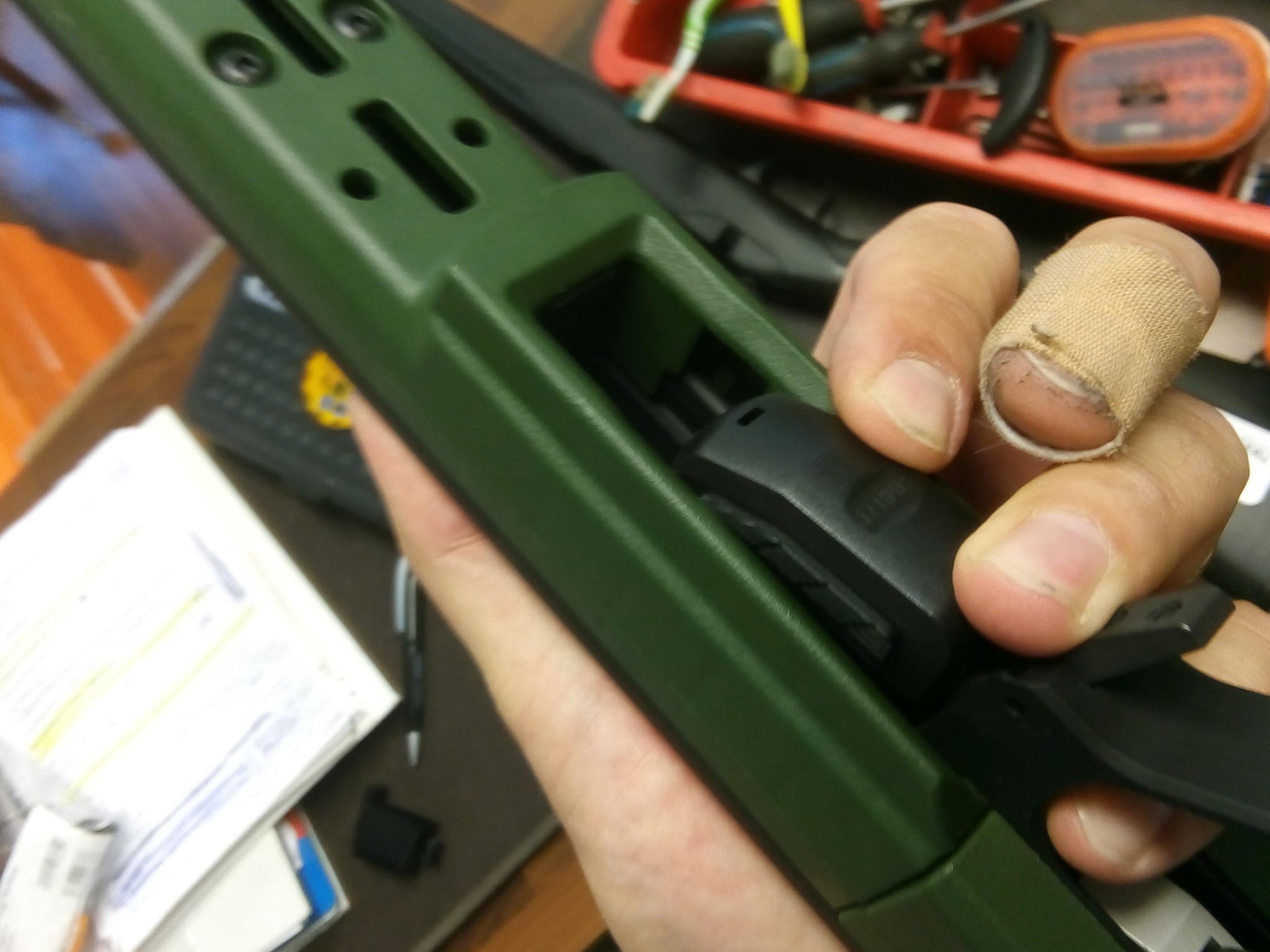

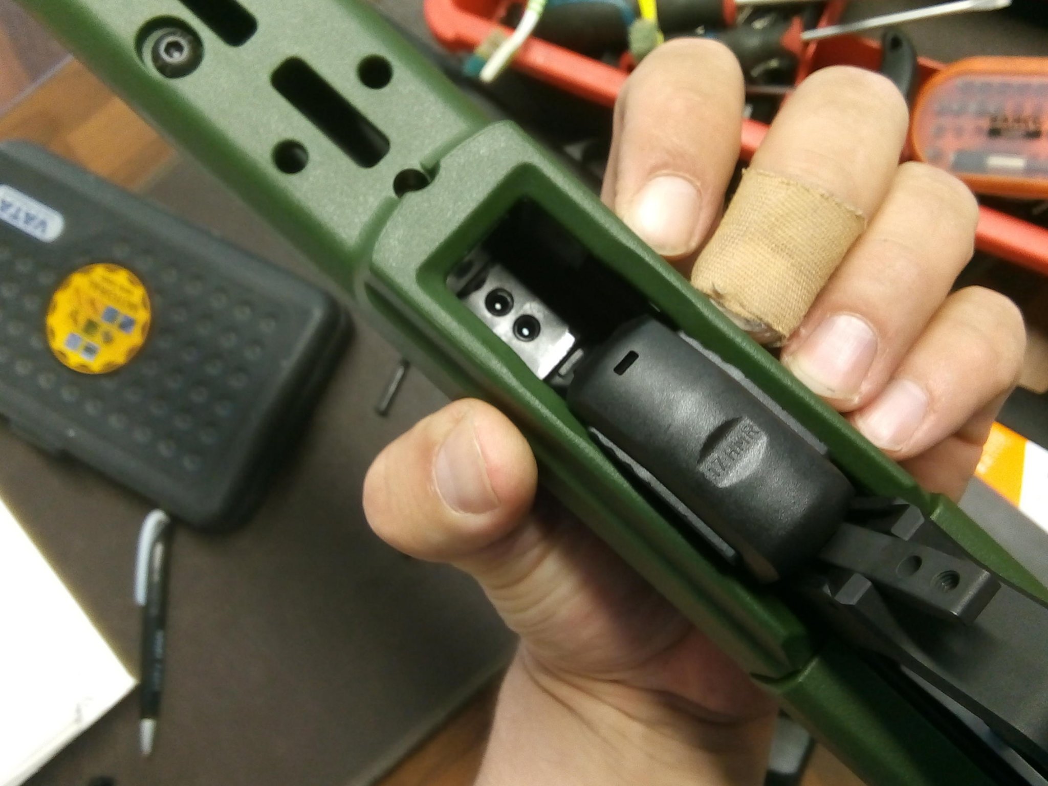

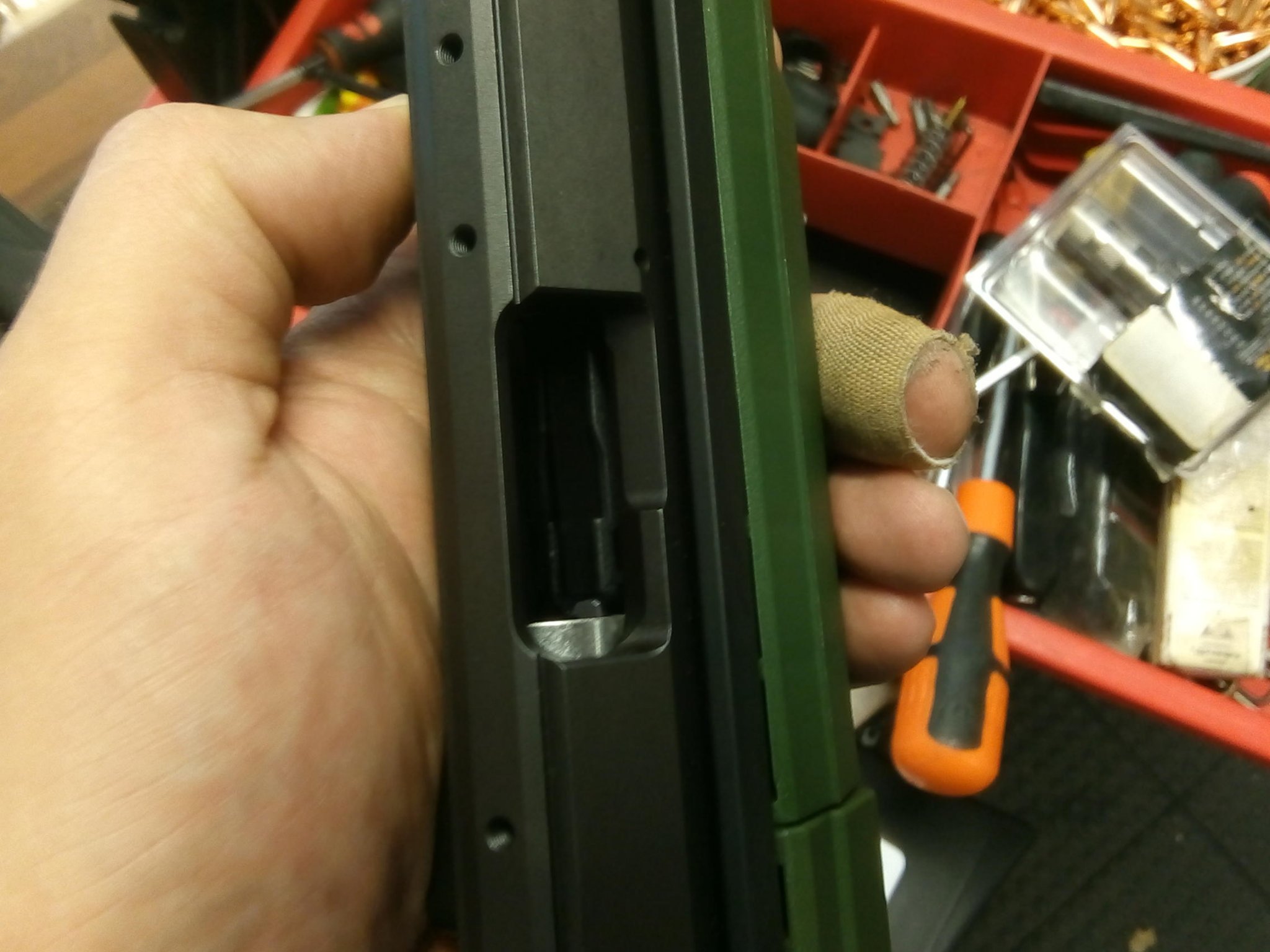

Hello guys.
This is not my setup, i was just playing with these two great items in the work today.
Tikka T1X trigger is super sweet straight out of the box, i did add a YoDave´s trigger sping on this one, and it did came ridiculous light, maybe 200g the pull weight, are even less, and it´s brakes down like a glass, very very nice, since there are not that much drag weight on the rimfire bolt, the feeling with the stock trigger is suberd, i bet you like it in the factory mode.
Bolt is smooth, no friction on the movement, but if you want to make it even better, i would do polish the bolt areas, to make it silky smooth.
I took more pictures how the system work with the T1X action and AICS magazine working rifle chassis.
Like you all know, there are no magazine for Tikka T1X yet, since there are no T1X in the USA yet, so no one who makes custom chassis and parts for rifles, have not get these rifles on to they hands, and take a look, how the feeding would be done.
But i did discovered when i mounted this Tikka T1X action to the KRG Bravo chassis, that you could get it work with the factory magazine, but you deffo would need some kind of adapter to hold the magazine in the magwell, but i just drop these photos here, and you can look the way it sits there.
There is magazine follower in the action, same type like CZ 455 has, that must be remove, well i had to remove it, or the action did not fit in to the chassis.
Here´s 7 pictures.

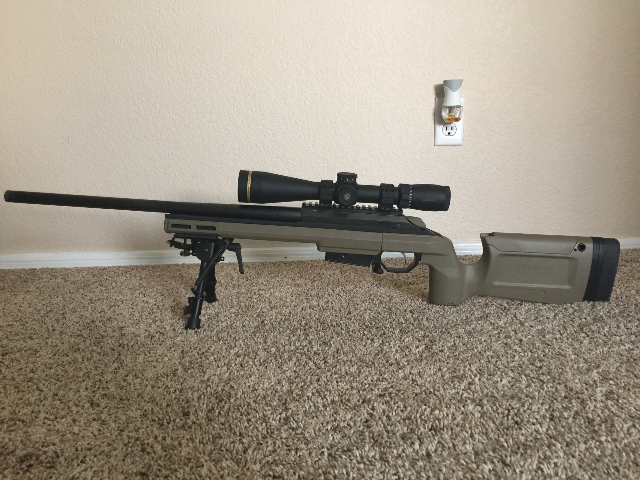

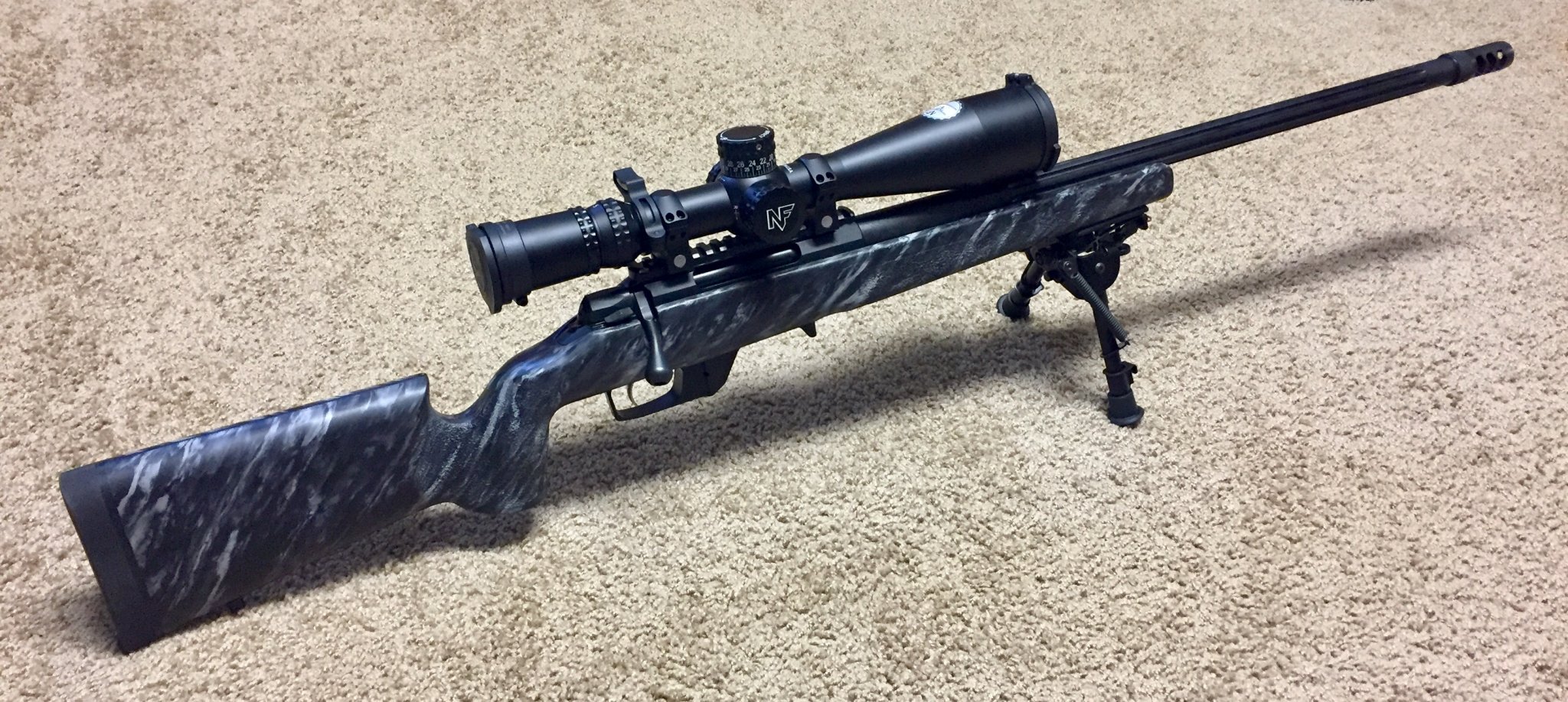

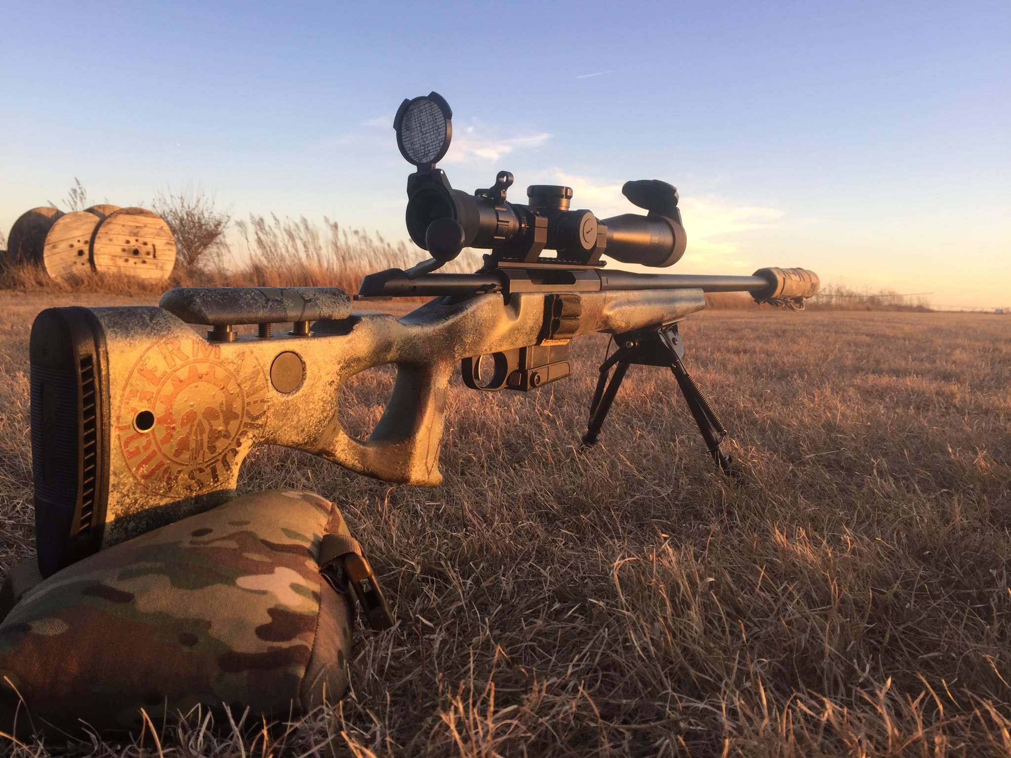

Tikka T3 Action with 24” 6mm Bartlein Heavy Palma barrel with 1:7.5” Twist chambered in 6mm Creedmoor, threaded 5/8x24, fluted and nitride coated finished with Area 419 Hellfire Brake. Pillar and epoxy bedded McMillan A3 stock with Mountain Tactical AICS bottom metal. Mountain Tactical Gen II 20moa scope base, Nightforce Ultralite 34mm rings, Nightforce ATACR 5-25X56mm F1 Zero Stop .250 MOA Digillum PTL MOAR C545 scope with Accuracy 1st Scope level.
Are you going to do adjustable cheek rest on this beauty?

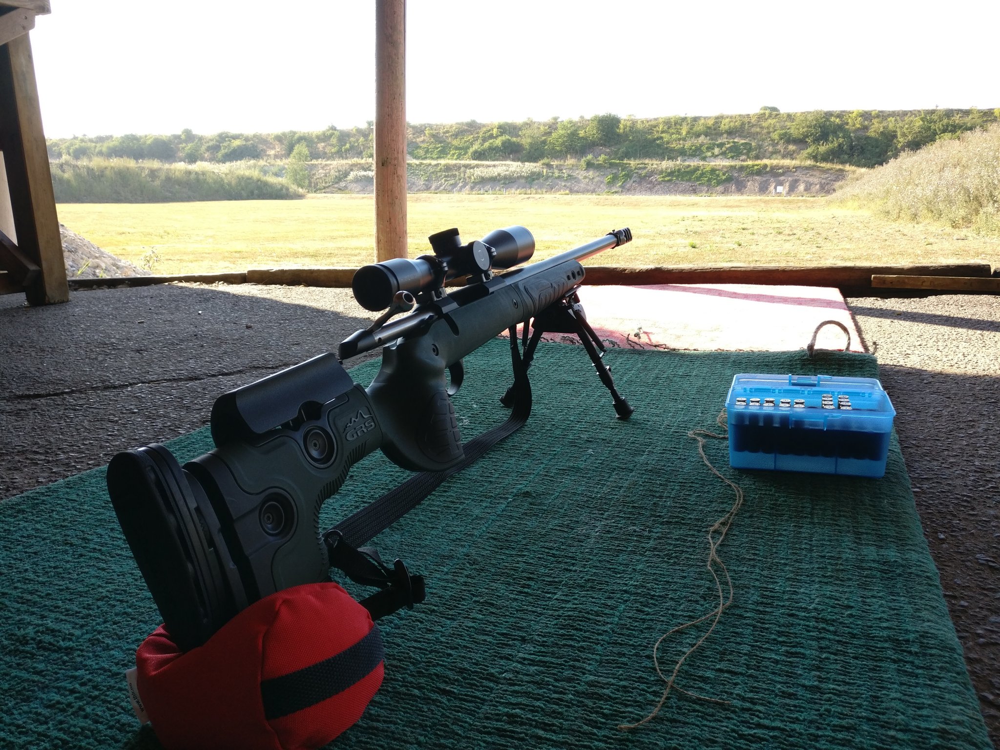

How do you like that new GRS stock?
I had the Berserk, and that was very nice to shoot, but it was not rigid, i tryed to make it stiffer, but still was not able to make it.
Though it shoot very well.

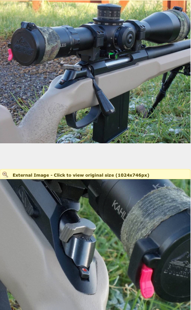

A friend sent me this Web image. If you google ASH tikka 3 position safety you should find some info. I had an action made by ASH and it was very good.
The rifle in the picture was mine, the ASH safety is a great feature but not the easiest to install. No Problem once understood how a Mauser type safety works but can be dangerous if fitted wrong or borderline. ASH has a little video on his website. https://buema-hochwang.de/Tikka-T3-Schlagbolzensicherung-links
Roedale in Germany also carries the ASH T3 3 pos safety as far as I know.

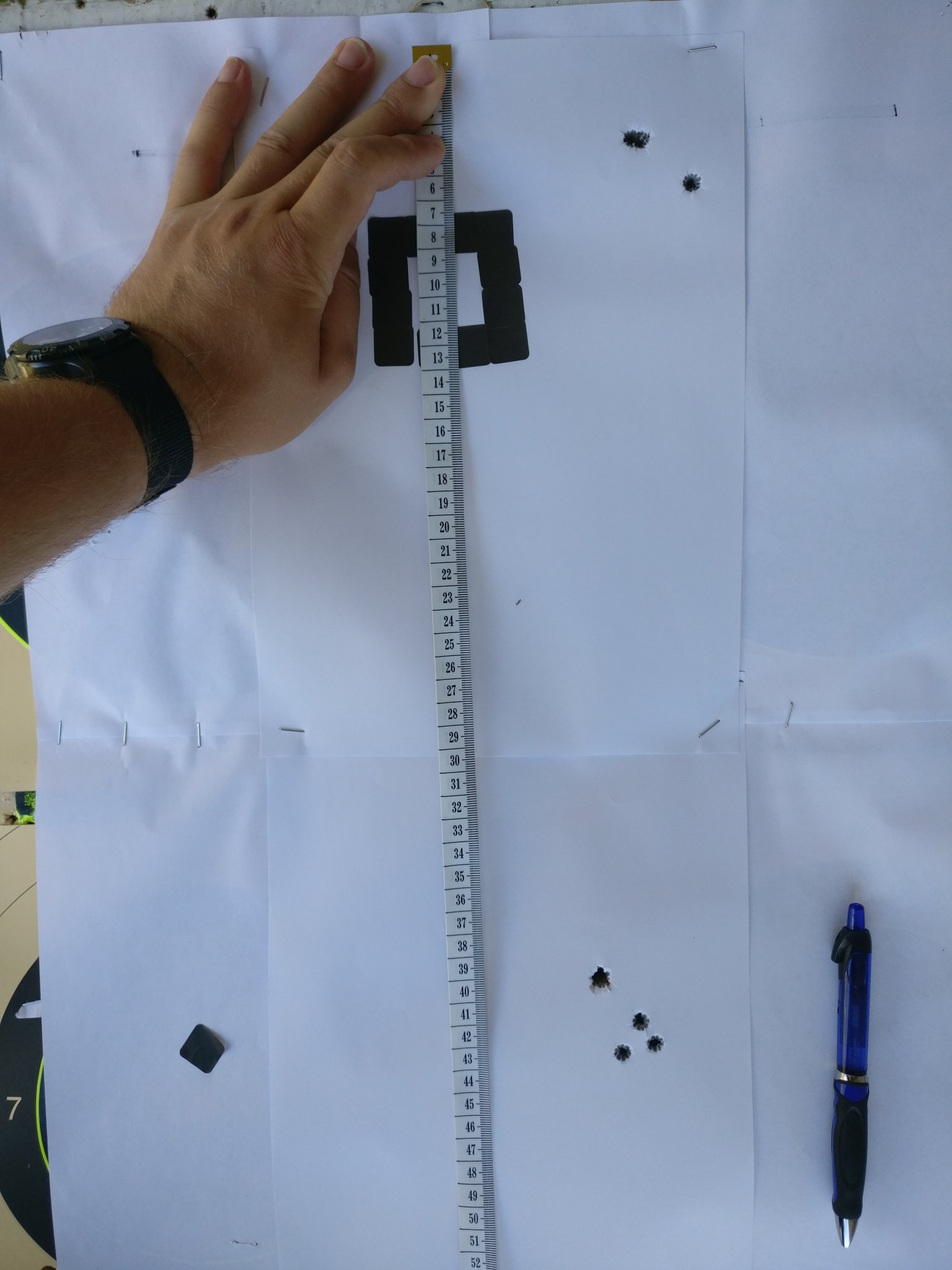

Just back from the 300 m range. Tried to figure out what speed my hand loads dish out. Will plug the information I got by shooting today into JBM when I get home. Only shot 7 shots today (what was left of my hand loads). I will have to load up some more, so I can hit the range again. IMG_20180715_145144.jpg

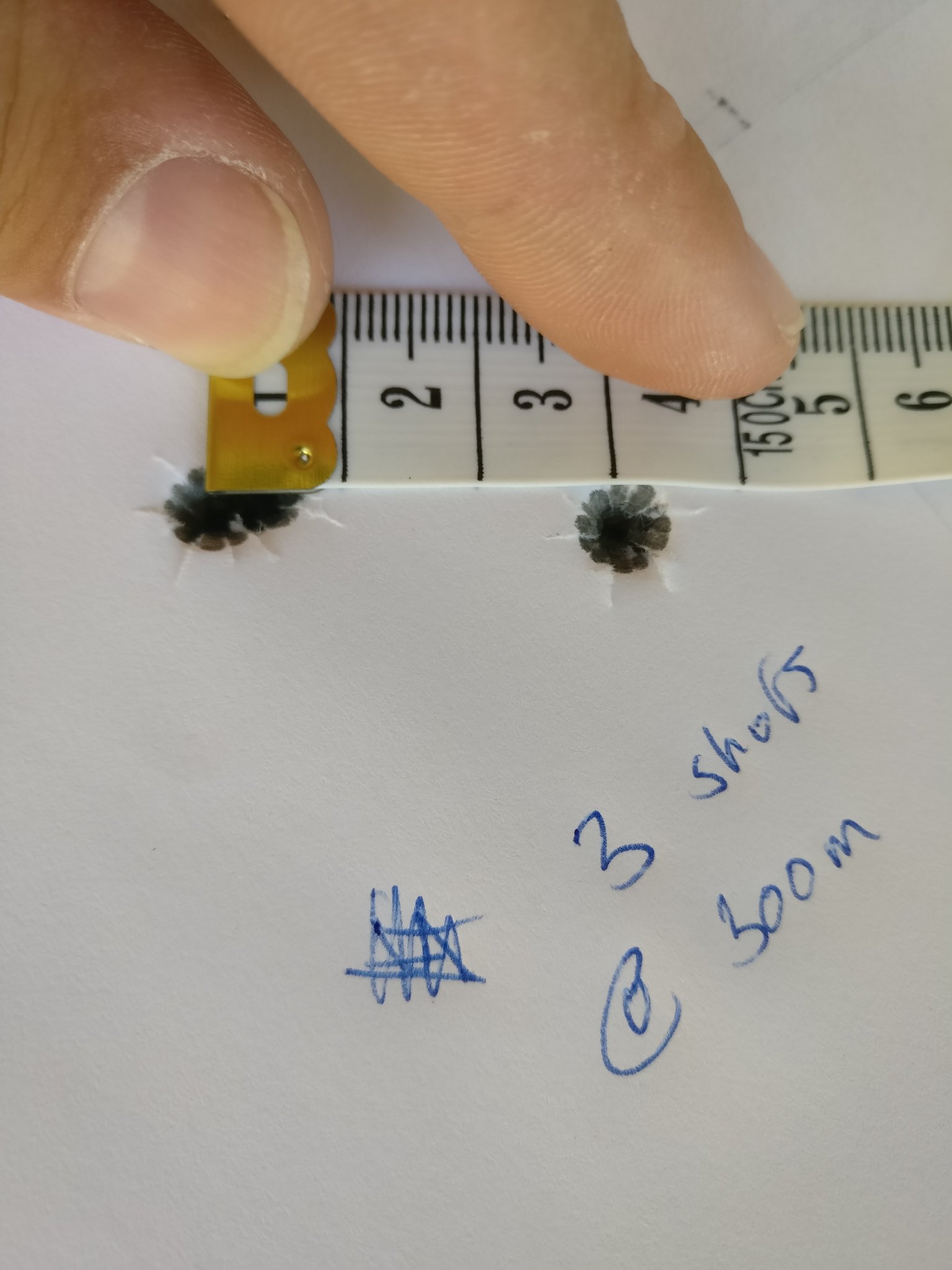

Just back from the 300 m range. Tried to figure out what speed my hand loads dish out. Will plug the information I got by shooting today into JBM when I get home. Only shot 7 shots today (what was left of my hand loads). I will have to load up some more, so I can hit the range again. View attachment 6922413
Do you have 6.5CM?
I shot this 3-shot group last summer from 300-meters with my ctr, 260rem, Norma brass, resized from 308win brass, VV N150 2,50g, CCI lr primer, colt 72mm.
I did not take the bullet diameter away from this, so it is 6,7mm smaller.
Just dont like to shoot the paper that much anymore, do it too much in the past, but you never know, maybe with the new brass i might test the new load accuracy, but when, i dont know.

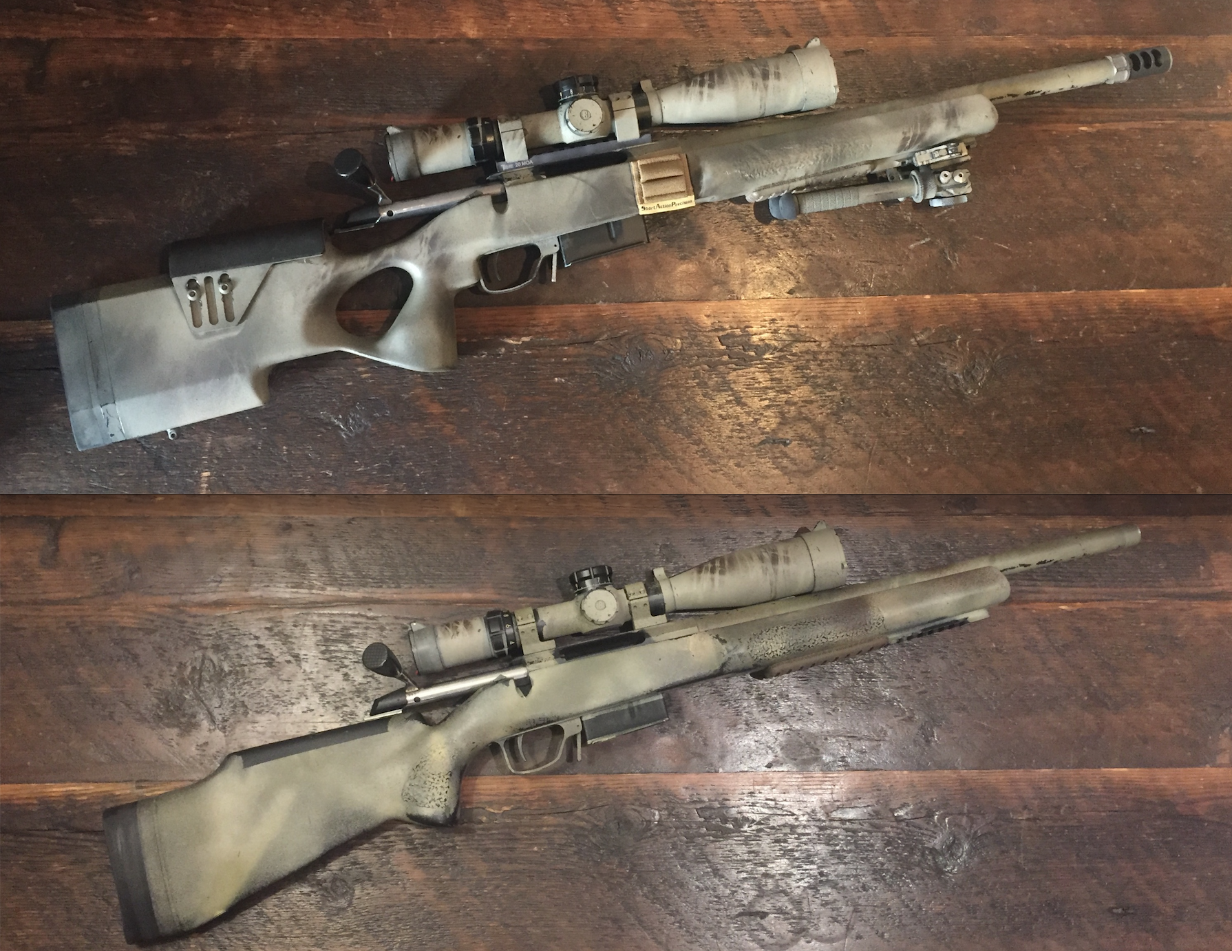

Posted this in the shorty thread - thought I'd add it here. Same Rifle in two different configurations. Tikka Varmint .308 chopped 17.5' - this thing is a laser with my plodding 155smk loads.
This at 500m
The only thumbhole stock Ive ever liked is the ai. I remember when the T6 came out and I thought it was hideous looking. After seeing your rifle in this thread a few times, I have gone 180 the other way, aesthetically speaking.
How do you like shooting and handling the T6? Seriously considering one for a tikka. Hows the balance and weight?
Awesome looking gun dude.

Thanks, it's actually the T5 I have. It's easily my favourite rifle stock but then stock preference is completely subjective - I recommend getting behind a stock before building anything, it won't take long to work out what works for you and what doesn't. I float my thumb for 90% of shooting, but during unsupported, offhand or seated/kneeling stages with a sling the thumbhole assists greatly. The cost of utilising the thumbhole grip is speed, it's definitely a fraction slower to run the bolt - but again, given one can opt to float the thumb I feel the thumbhole is a nice feature to have.

That's what I get for going off memory instead of checking Manner's site :-(
Do you wish you had the T5A? What Cheekrest are you using there?

The GGS Predator and Ranger come with the adjustable cheek riser. They are similar to the T5 and have a mini-chassis. My Predator is 3.5 lbs, the Ranger is less.
Very nice! Is that the DMRii? How do you like it? What height rings are you running?
