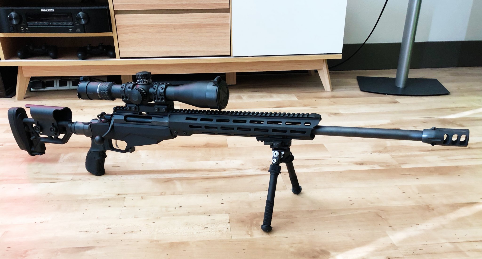

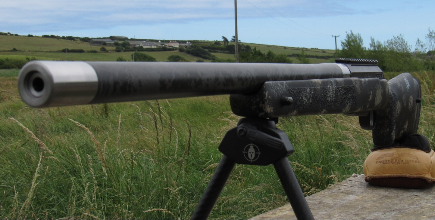

What didn't you like about the "stock" bolt handle?
Are you referring to the bolt handle you find on the lite models or the CTR/Tac A1 models? The CTR bolt handle didn't really allow me to get a firm grip on the factory handle, it wasn't comfortable and the Sterk allows for a quicker bolt cycle and it some of my rifles made my bolt lift feel lighter. Aesthetically the factory knob just looks terrible as well.

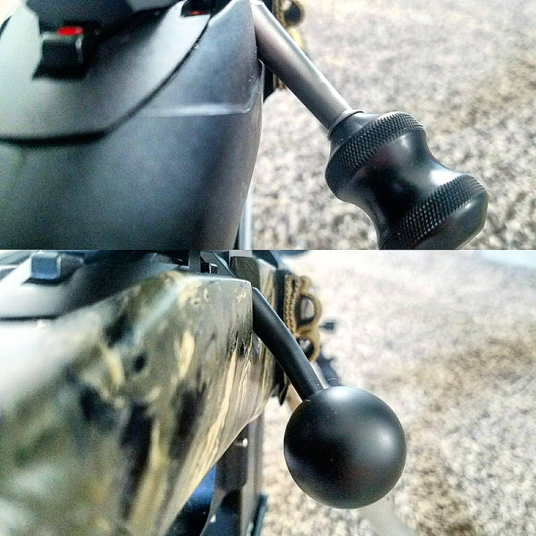

The T3x TAC A1, I've purchased everything I need except the rifle. Placed a deposit so when the left-handed A1s are shipped I'll defintely get one. Now I'm being told it's Aug/Sep. I thing the stock bolt handle looks terrible also. Unfortunately, they are out of stock. Thanks, I appreciate your input.
If you want a left hand sterk handle I might have one in stock.

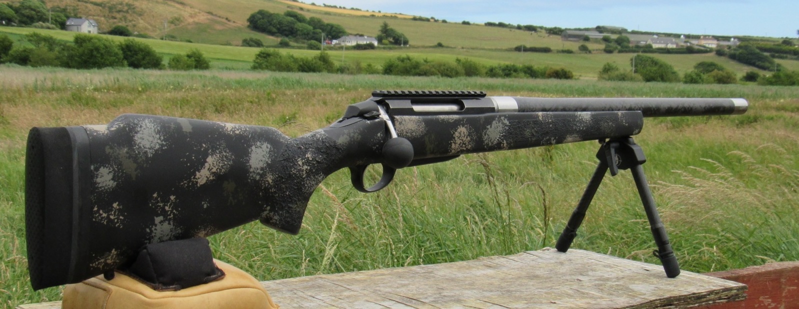

@sommers great rifle!
@tevan0707 thanks for posting the photo and giving your input

I hated the plastic bolt knob as well. Just looked chintzy and out of place on a $1,000 rifle. Some bonehead at the factory not only put the grub screw in mine, but epoxied the knob in also. So it broke the plastic knob when I finally got it to turn loose and left epoxy and part of the knob down in my bolt handle. I had to remove the bolt, then remove the bolt handle, and heat it with a butane torch and carefully scrape out the epoxy and bits of plastic with a pick. I'm starting to think Tikka should remove the Finlandia from the cafeteria vending machines. :)

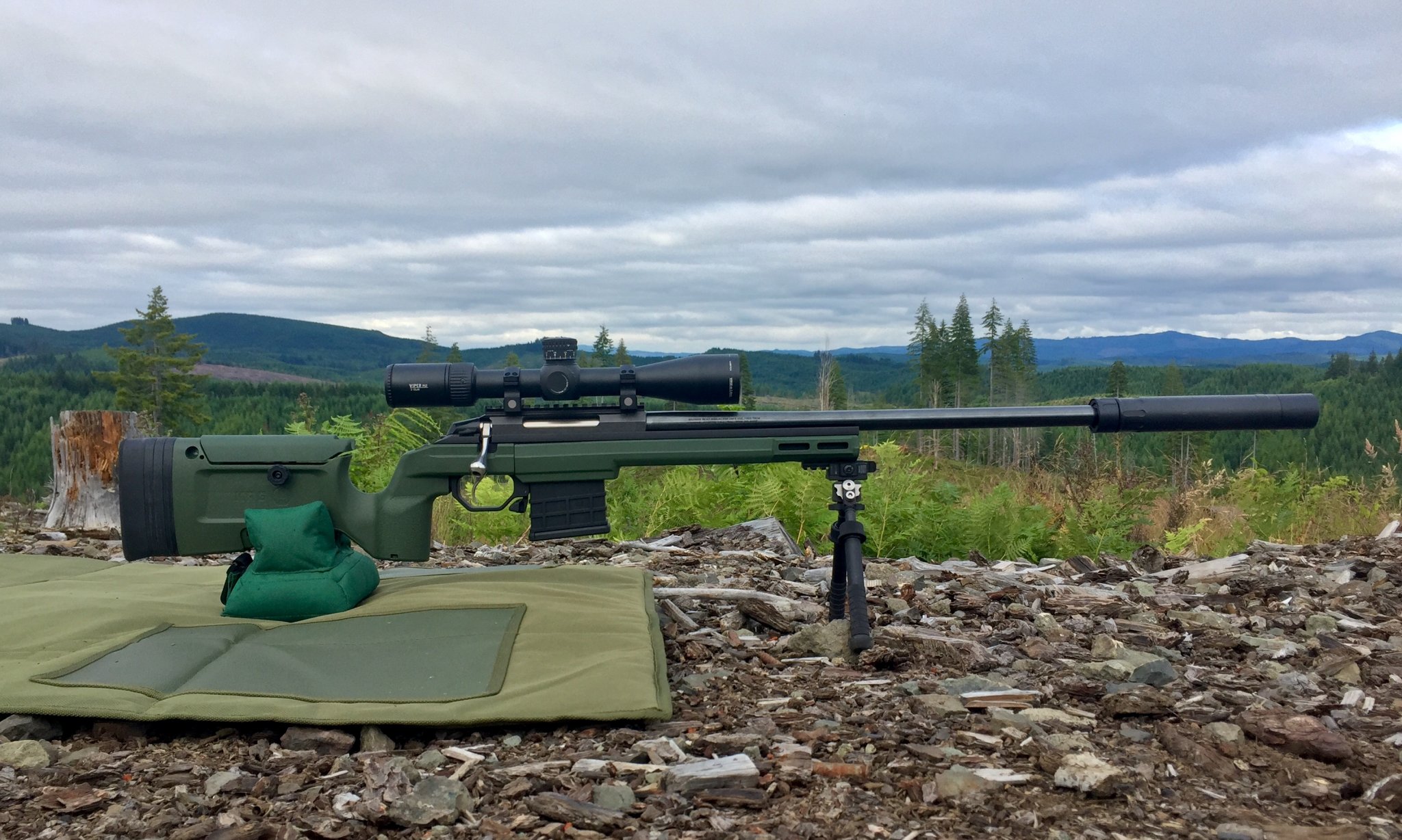

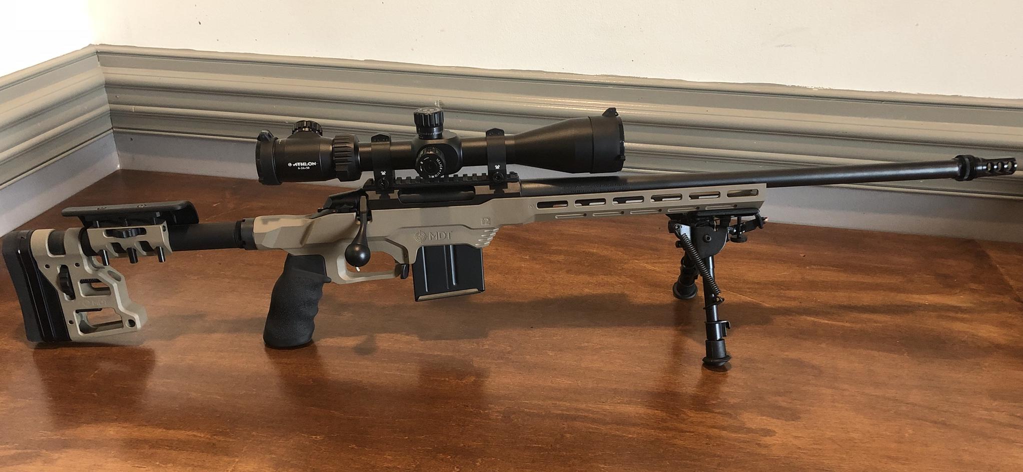

Just finished putting my T3 build together. SS T3 lite, .223 8 twist, in a Bravo chassis. Sterk shroud and handle, NF SHV F1. Ran out and tested it tonight while the light was fading. I stuck to 3 shot groups, since the barrel is so skinny. 5/8" groups with 73g Federal Bergers. This is my first precision bolt gun in .223. I always thought they were kind of dumb, but I put this together as a starter centerfire for my daughter, and figured I might use it for some varminting as well. It is pretty awesome, and the Sterk stuff really makes it nice. Kind of like having an AI action in a more traditional stock. Makes me want to get a 6.5 and .308 version too. I'll get a pick up tomorrow, but its nothing you guys haven't seen before.

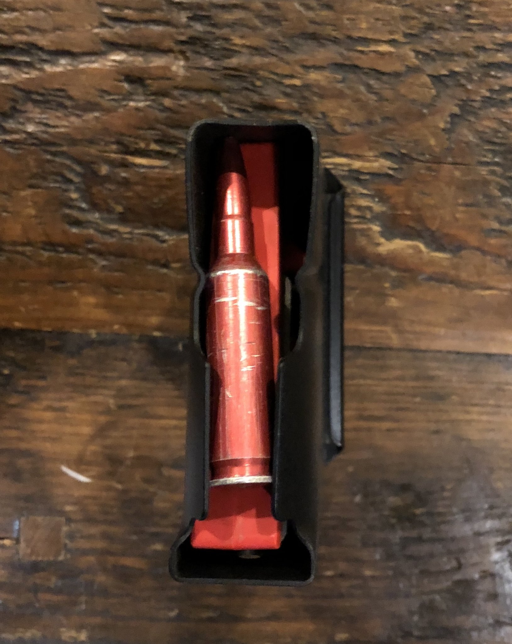

This is as far as my experiment with Tikka/ARC mags has gotten. First round off the top was fine, second round repeatedly nosedives.
FYI, this with CDI bottom metal and 6.5x47 snap caps - same results with live ammo
Yup, I wont be purchasing.
Fwiw... I’ve read the LRI followers are the better fix, over the MK.

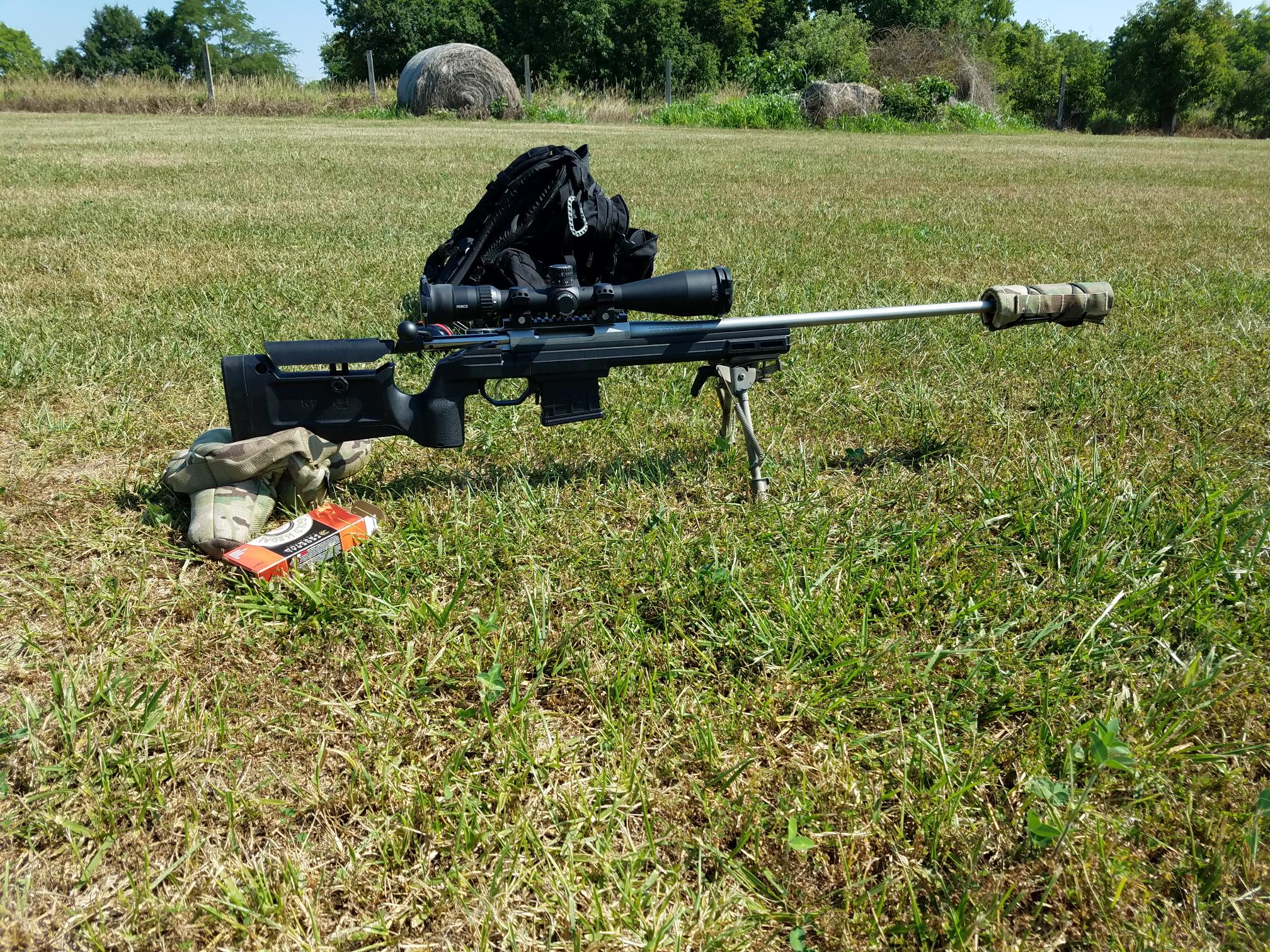

Here she is. Cheapest precision build I've ever done, but extremely precise, and a ton of fun to shoot. Hard to put down. Ever since I shot my first Tikka, I've been saying they are the best set up for the money, but this is the first I've owned. From a pure dollars and sense standpoint (which I know doesn't usually apply much around here) it is hard to say that anything besides a Tikka is needed. Very impressive setup, easy to work on, tons of fun to shoot. My barrel is giving me 2735, with the 73g federal Berger load. All my other .22's are 16" or shorter, so this is the fastest I've ever seen a .223 go. SD was 4.
I like almost everything about the Bravo, but the warning they give you about feeding issues if you touch the magazine is no joke. Kind of limits the setup to backyard playing, as I would never take this type of issue into a match, let alone anything more important. Maybe KRG is working on a fix for the issue? Anyone else have a solution to it?
Nice! I’m so tempted to ditch my Rem700 223 and pick up a Tikka 223.
ive had the complete oposite with my tikka the only mag its feeds well out of is the arc. also using the ark with my 6.5x47 nucleus build.
Yea, the ARC mags have proven to be very hit or miss, there's pages and pages of numerous customers running into issues and now a few companies are producing aftermarket followers. It's a great design in theory but has a very high failure rate. I'm gonna keep mine and figure out how to get an improved follower into Australia
mine ran like hot dog crap in my rem 700.
SLG,
What did you start with for this build? Is that action off an older T3 you already had or did you get a newer T3x to use the action as a donor?
I had (maybe still am) considered getting a T3x Lite purely to build off the action. This route just seems so inefficient financially and with wasted components (even IF you can resell). With the CTR at a grand and the Tac A1 above 1.5k neither seemed a good starting place either.
Just curious other approaches and if there’s a Tikka solution there for me somehow.

SLG,
I had/have some of the same issues as you. If Tikka made a medium weight barrel in their cheap stock, that would be perfect for me. I don't want to throw out the stock and mags from a CTR, but I also don't want to use them. Don't like the A1 at all.
So, this barreled action is currently a factory stock t3 lite stainless. Since this is more for my daughter than me, I wanted a lighter barrel, even if it heats up faster. I am thinking of cutting it down, but it shoots so well right now, that I may just leave it alone. I'm kind of a short gun fanatic though.
Since I was going to swap the Sterk stuff onto it from the start, as well as ditch the stock, it seemed silly to get a T3X.
Honestly, this gun is so much fun, and so impressive in price and execution, it is really hard to resist just getting another T3 to do "something" with.
You might try playing with the adjustment in the Bravo and how it holds the mag. I had the same issues in one of the two that I have, once I played around with how the mag seats I haven't had any issues when pressure is applied to the base or front of magazines.
