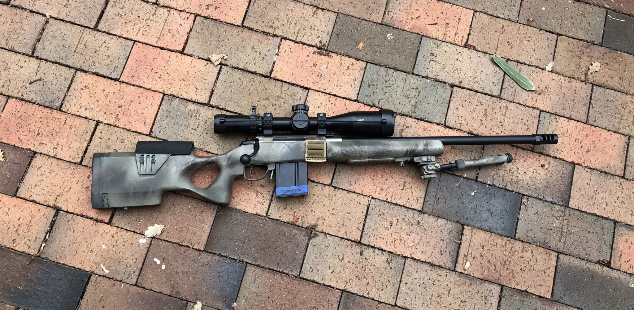

Thanks Edi, still using and loving my PSE stock too. Will have to take some more photos of it, keen to see the Sterk handle on one of your rifles too!
The you go, my carbon E-Tac4CTR stock with the Atlasworx AI mag system MDT Mag and of course the Sterk swept bolt handle.
My friends CTR in his carbon E-Lite stock with original CTR mag. Sterk Bolt handle.
