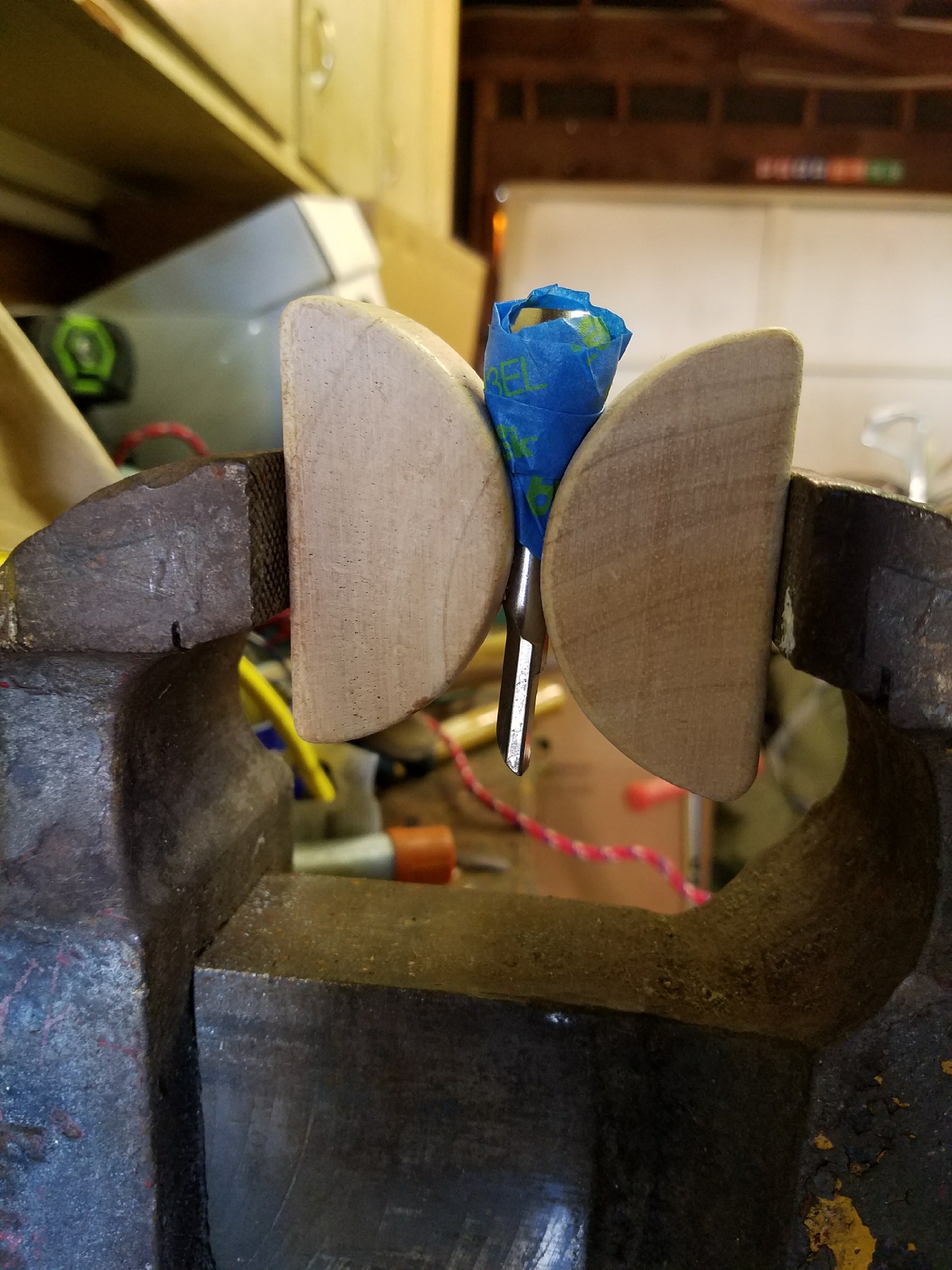

I'll just be happy to get the factory handle out. Do you think it would be okay to put the handle in a vise and tap the body of the bolt with a piece of wood or rubber mallet?

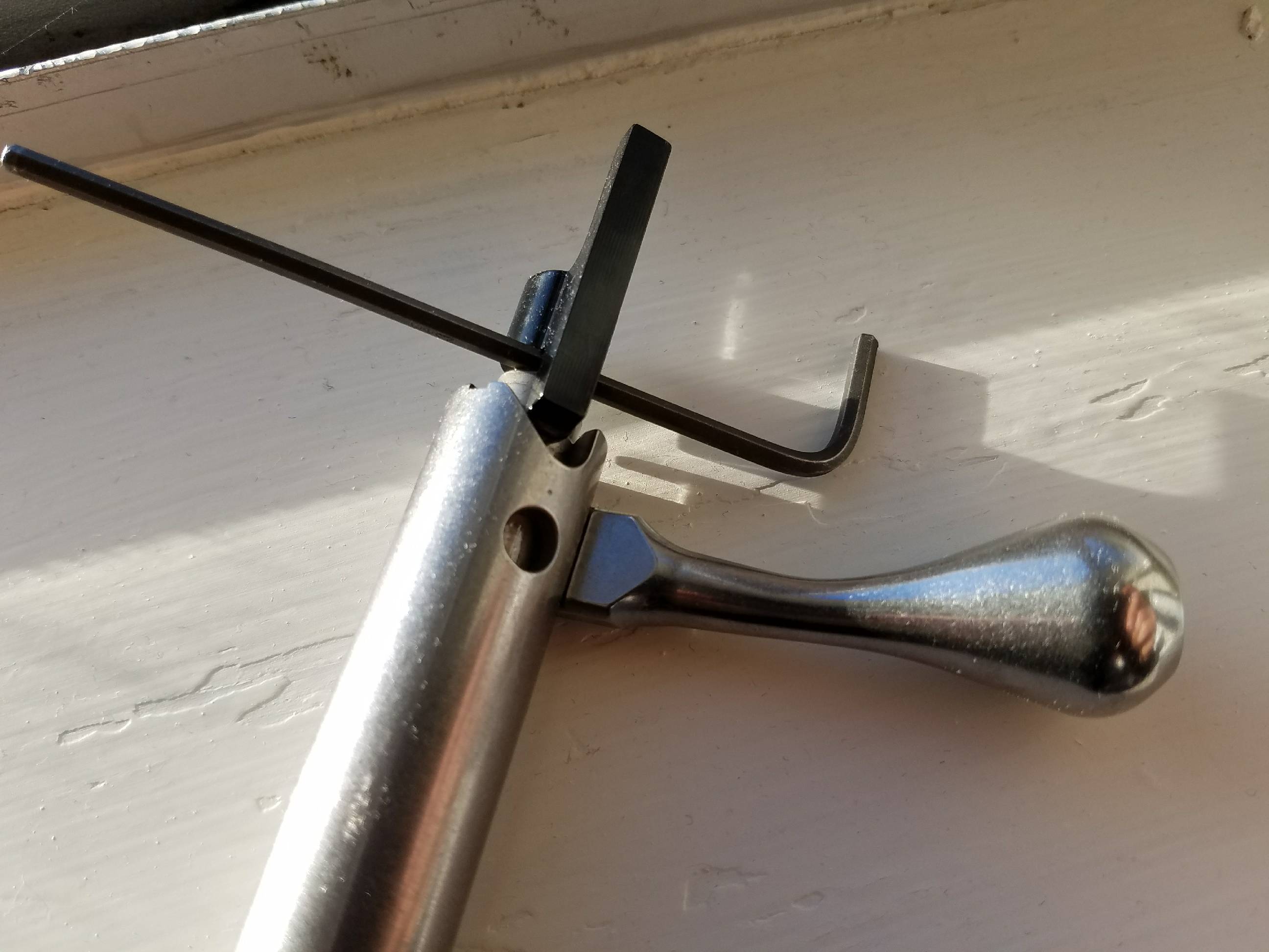

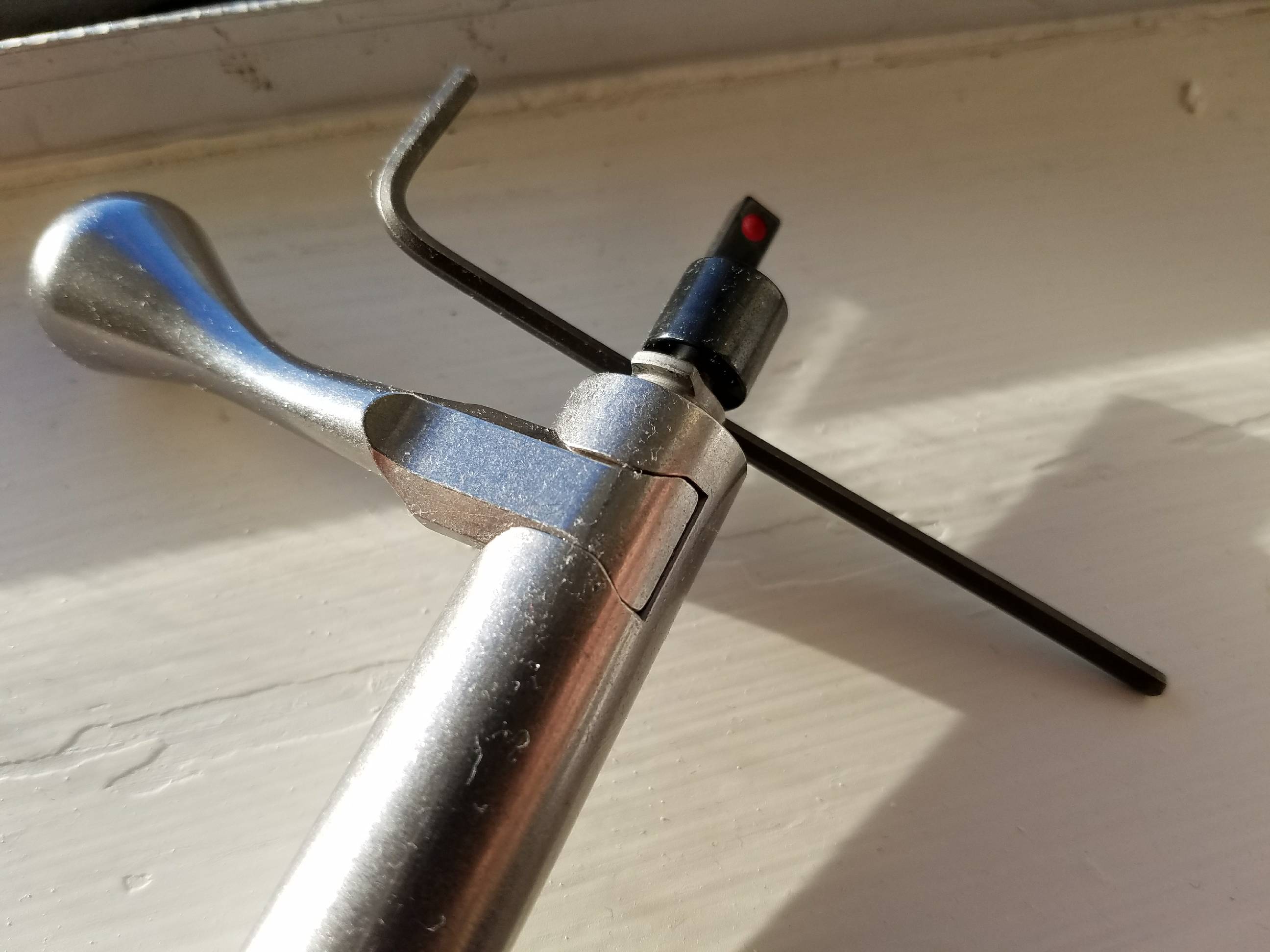

Perhaps I'm missing something. Here's my bolt:
So as you can see, I've got my Allen key in place and can move the tab back into the small detent. Does the size of the Allen key matter? Should I use the thinnest one that'll provide the leverage necessary to turn the firing pin or the thickest one that'll fit?
Look at this video
Smaller will make it worse.
Cock the bolt and find a flat head screw driver that will fit in the notch and keep it "completely" open then twist it to the scallop.
Just make sure your screw driver will stay put and not slip out.

Talk about tight fitting handles! Sometimes wiggling isn't enough. The manual does support hitting the handle with a plastic hammer if it won't slide off, btw. I improvised a little but it worked out. Thanks to all that offered assistance.

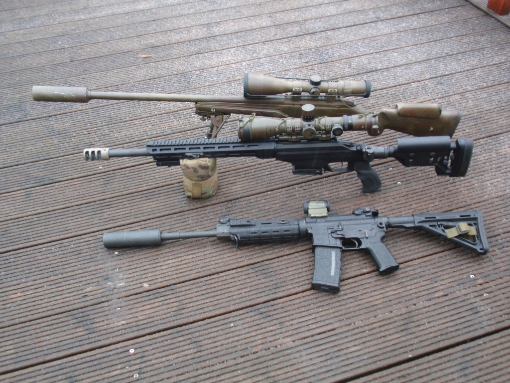

Got my Baby Tictac scoped, but I'm not set on the bipod yet. Which one to go with. Harris, Atlas, whatever. But it is a short little package, pretty much close to a 16 in AR, though a bit on the heavy side. +1 kg with the can, compared to the original Tictac.
