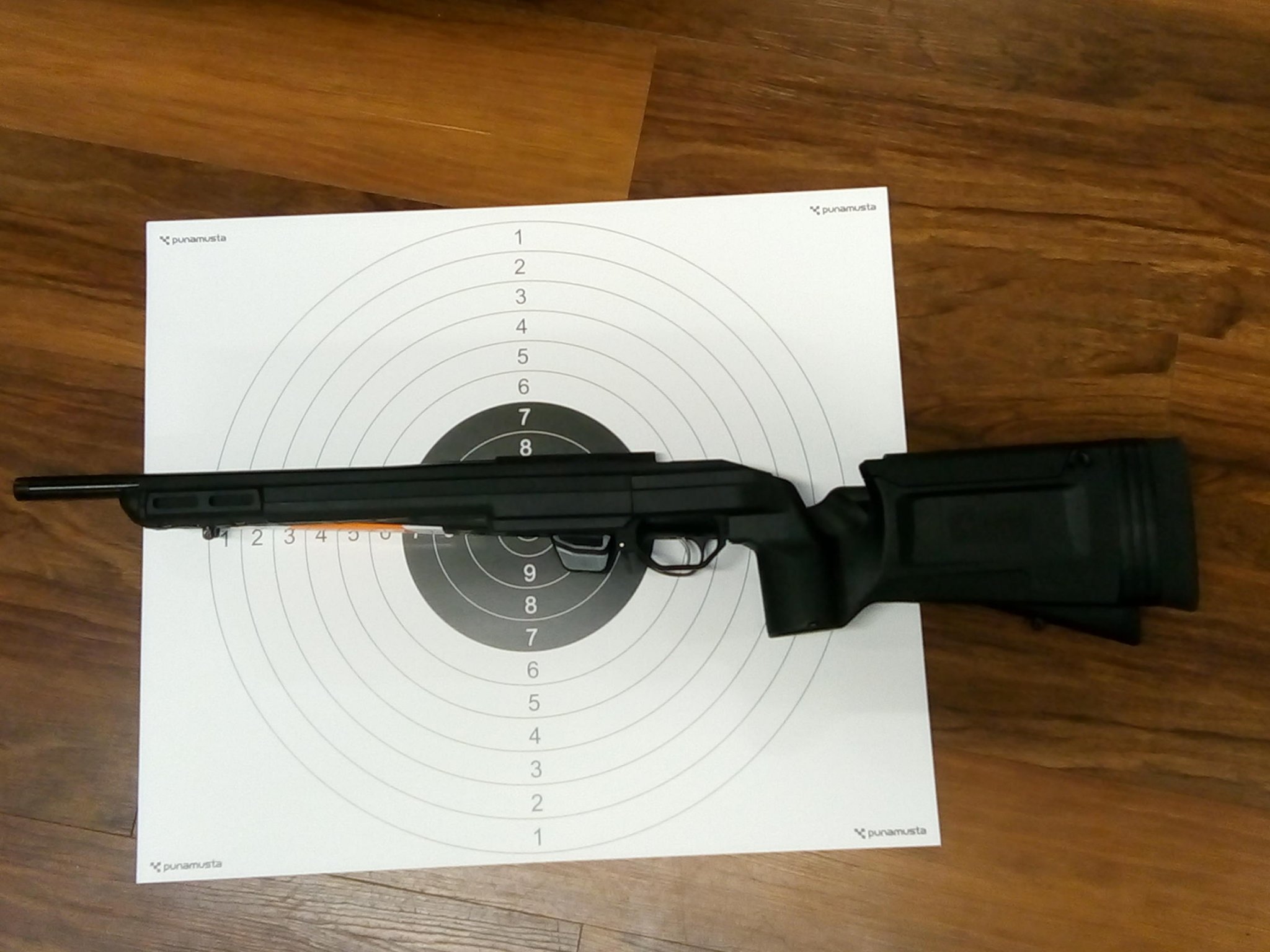

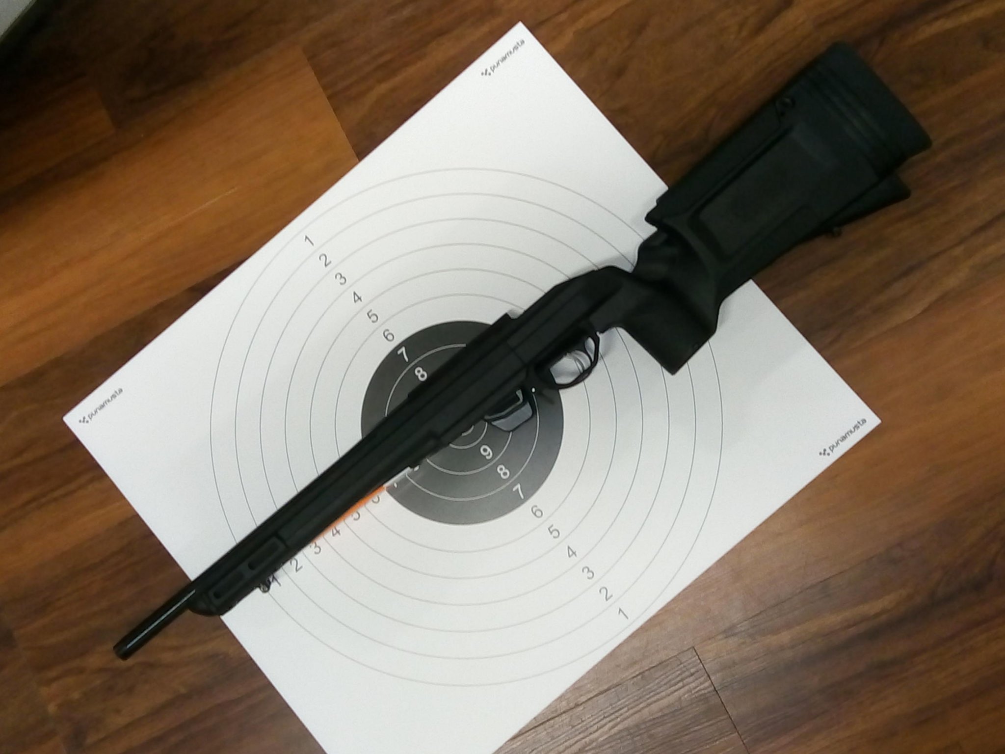

I just remembered that i took this picture with T1X and Wild Boar rifle.
This stock use CTR bottom metal and magazine, so T1X with CTR stock will look this.

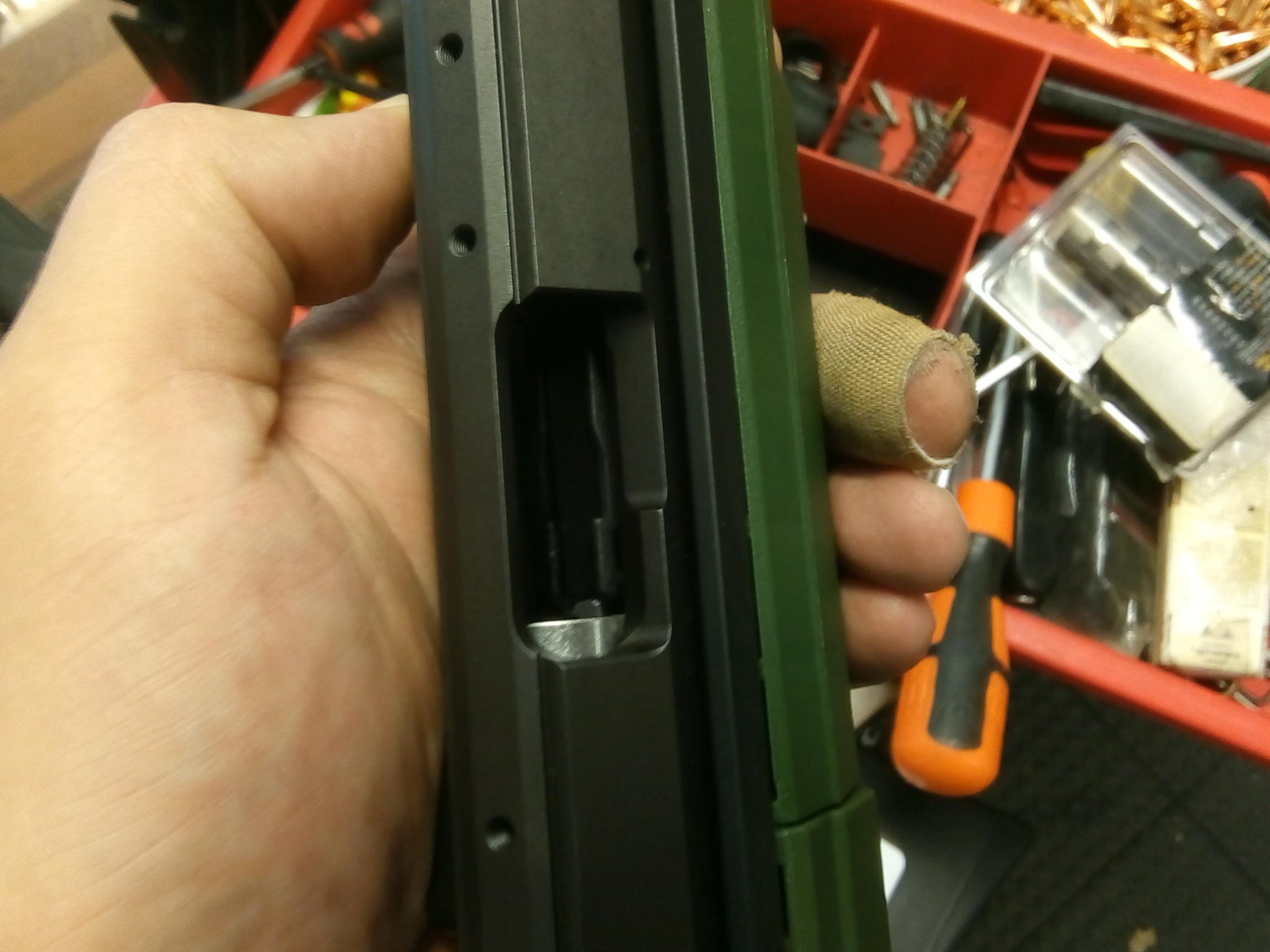

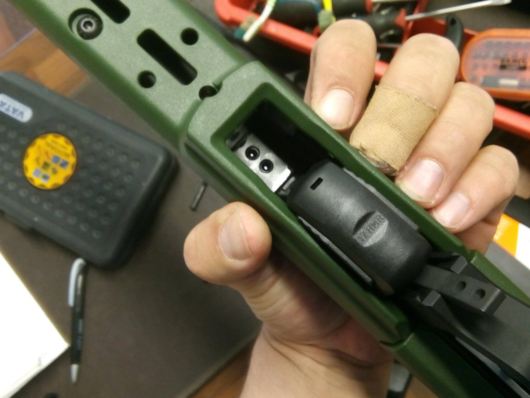

I had some photos here, just like you want now.
But here´s those pictures one more time.
Is that a KRG Xray? If it is, I may have to get the T1x....

The T1X magwell is bolted to the action,so it's difficult to see from Viking's last shots,go back a couple of pages & you'll see more of Viking's pic's & all will become much clearer.
The way I see it( & I stand to be corrected) is the mag release/retention lever for the T1X is in contact with the trigger guard assembly.
All we need is the wonderful boffins from KRG (hint,hint) to develop an add on or new magwell design to accomodate this fact & I predict they'll have a multitude of customers screaming "shut up & take my money".

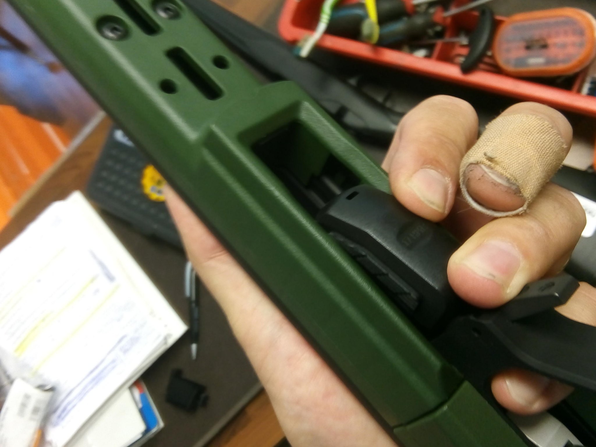

Magwell attached to the action, it does not fit in the AICS magazined action stocks.
I have tryed T1X to KRG Bravo and MDT ESS chassis.
There must be a magazine it´s own for T1X if you use AICS magazined chassis.

Apparently Dolphin Modular chassis will work. KRG Bravo will not (without modification)
There is no room in the chassis for the screw head that holds the magazine well. Maybe it would work to mill it out a bit.
(Read this on another forum)

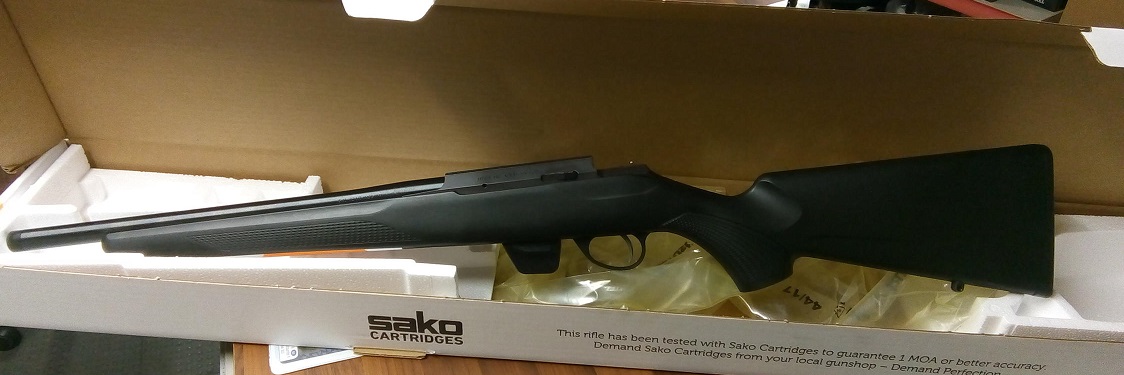

With this 16" barrel, this T1X 22LR is something i would really want buy, really nice rimfire.

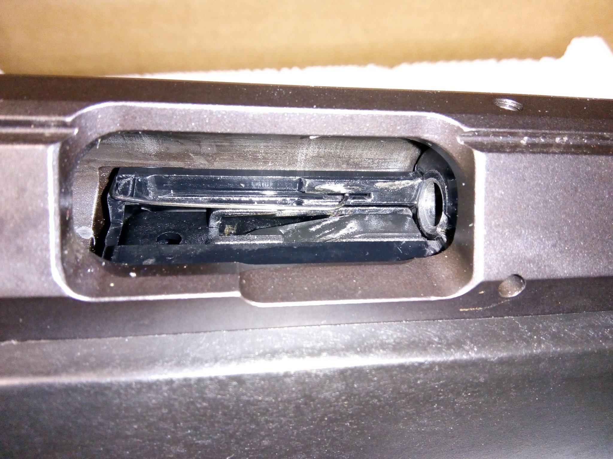

Here is the picture with the factory stock, and what the magazine attached look in the chamber area.
AND a teaser, what it might look if you drop this 16" in to a Bravo chassis.

How close is it to fitting in the bravo? Is it just in need of some sort of magwell adapter?

Same a 17HMR is.
You need a magazine for this AICS chassis, at this moment, there is none yet who has done it for this Tikka T1X rifle.
I do think that none of those 22LR AICS magazines work in T1X, because the feeding in not the same section, as it is in this 2LLR AICS magazine.
https://www.milehighshooting.com/vudoo-gun-works-22lr-magazine-10-round-aics/
T1X will need magzine of it´s own, or adapter, that would feed from the factory magazine.
But if you use chassis, that use factory, plastic bottom metal, or CTR metal this trouble is not there, only AICS magazine chassis has the magazine issue.
Let´s see who has the first Tikka T1X AICS magazine.
