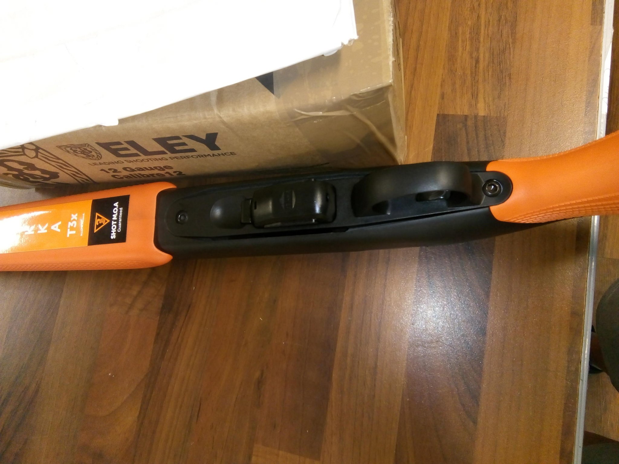

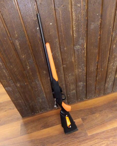

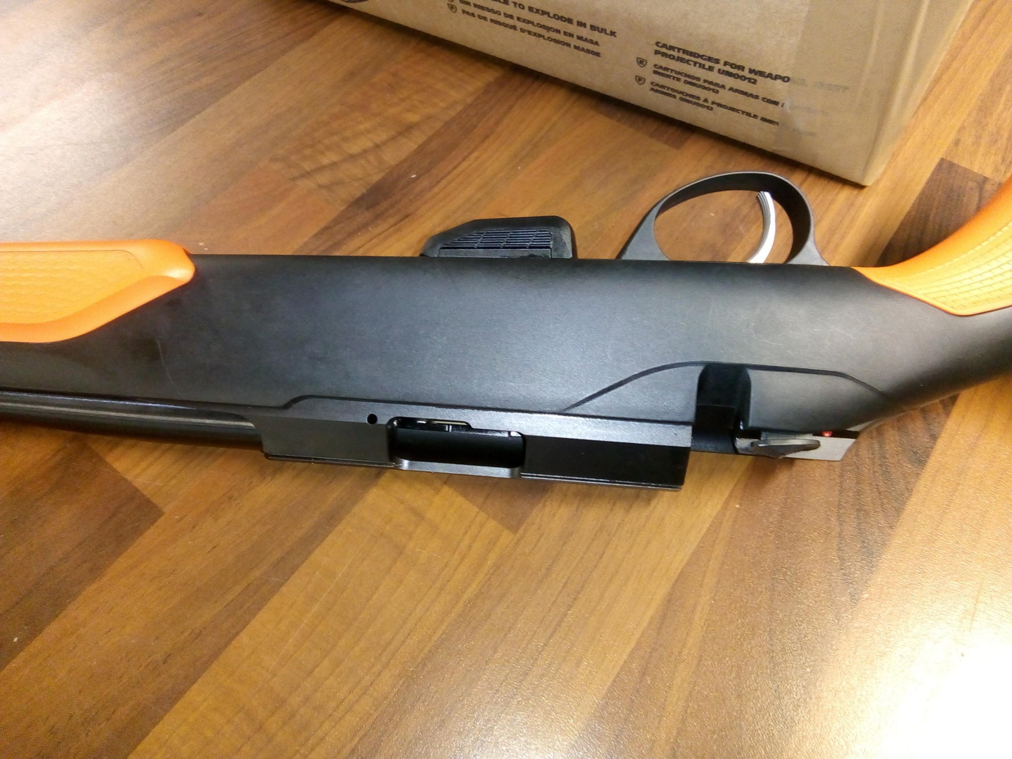

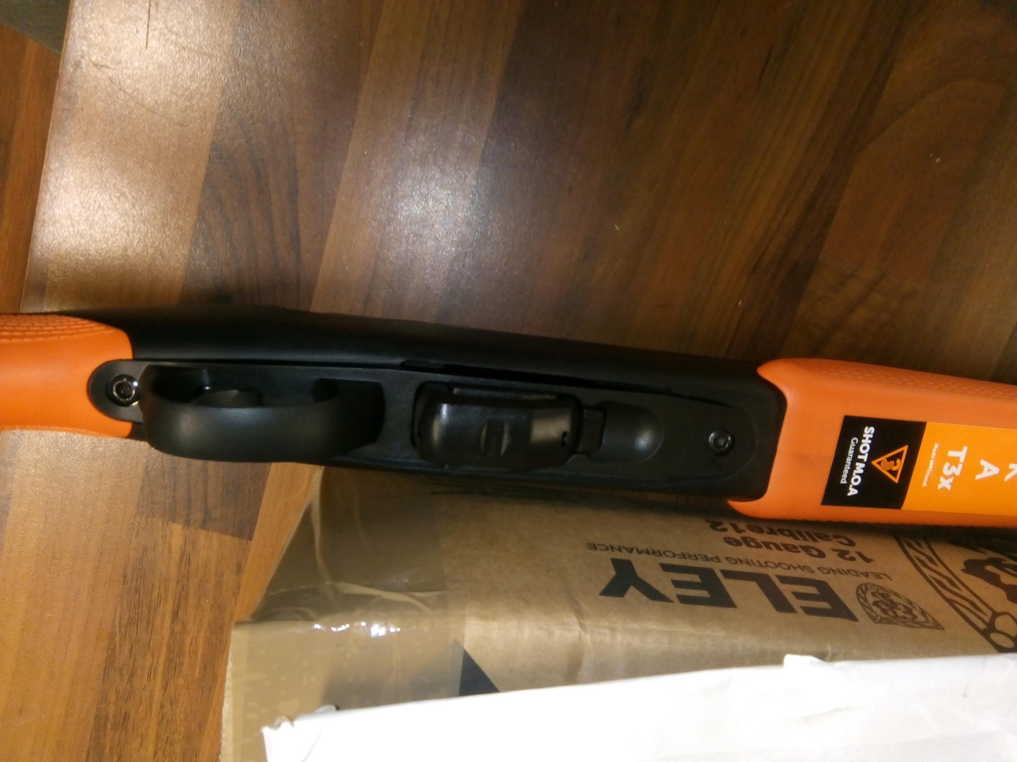

Tikka T1X wild swine trainer, only available in Finland :) .... just winding you up:p....
That what the rifle looks in 1/1 Tikka T3X stock.
Very nice balance, and i like that "adulta" model rubber pad, gives 1" more LOP to the rifle, im about 6,5", so that T1X stock with that hard plastic butt pad is a bit goofy to grown up man, but for the child and small size people that might be good, these dont have recoil anyways.
