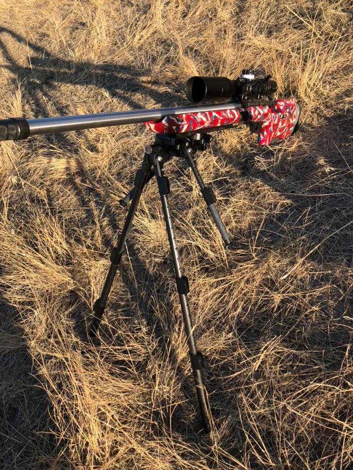

Shot the JC Steel Blue Ridge PRS Match this weekend. Over 100 of the best shooters in the country and easily the best individual 2 day match ive shot all year. 90% positional which is fine by me... And man was it tight. This was literally the tightest match Ive shot. I was shooting a 308 built by Kelblys and my scope was a 4-20 Burris XTR2. And it was hammering. I dropped 2.5 pts the first day and was clean the second day. That put me in 4th place, 1.5 pts behind first. ARRRRGGGHHH my prone long range stages are still eating my lunch. Still as a 308 shooter my goal is top 20...a top 5 is wet dream material. Cant be happier.
Also, if you havnt already, check out the new CKYE-POD. It may be more $$$ than a Harris, but it is quickly becoming my favorite piece of gear.
Just giving notice - THE 308 IS BACK!!!!!!! :ROFLMAO::ROFLMAO::ROFLMAO:

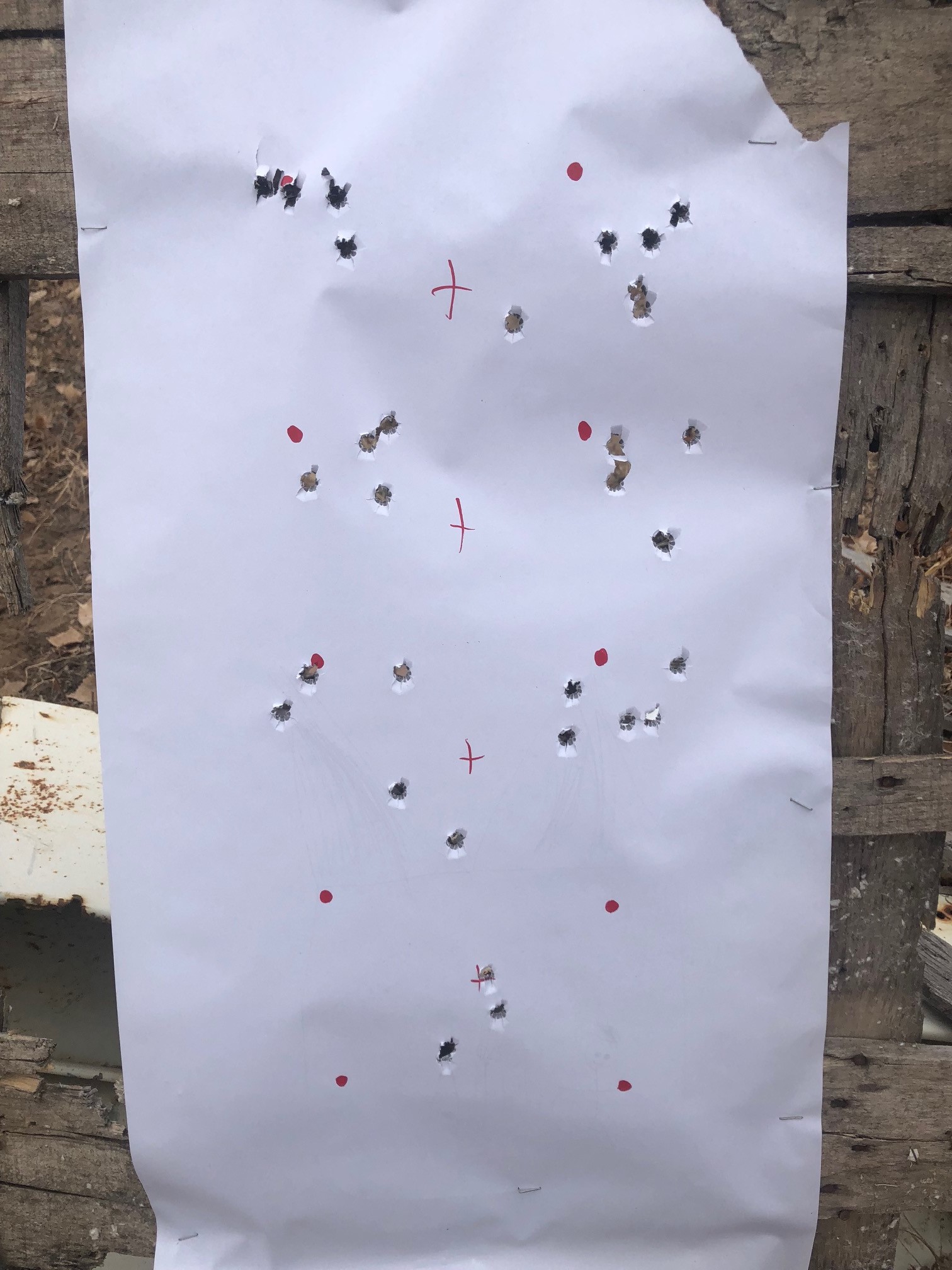

My load work up with Berger 168 gr hybrids and VV N140 powder. 43.9 gr gave me 2790 fps with single digit sd. (speed limit 2800) I cant decide if I want to go next node lower as its so close to the limit...
Jumping on top row was
0.000 0.020
middle row
0.030 0.040
3RD ROW
0.060 0.080
looks like a shotgun group but was shot at 300. best vert was right at 1" on the top groups. and it was cold and dark out. kinda want to do again.

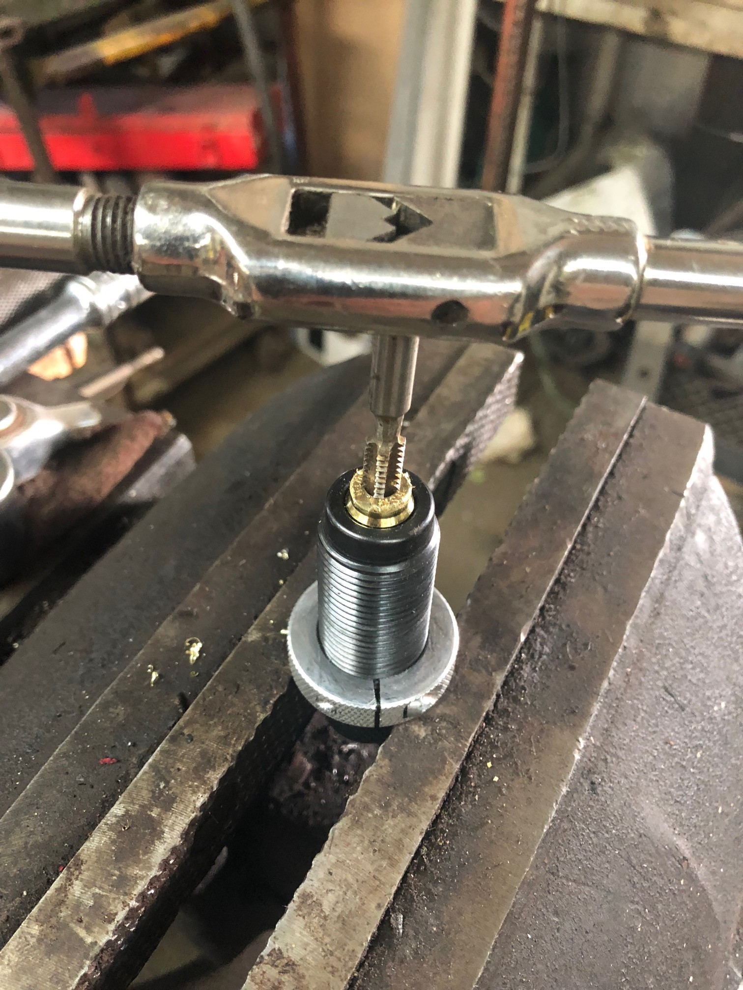

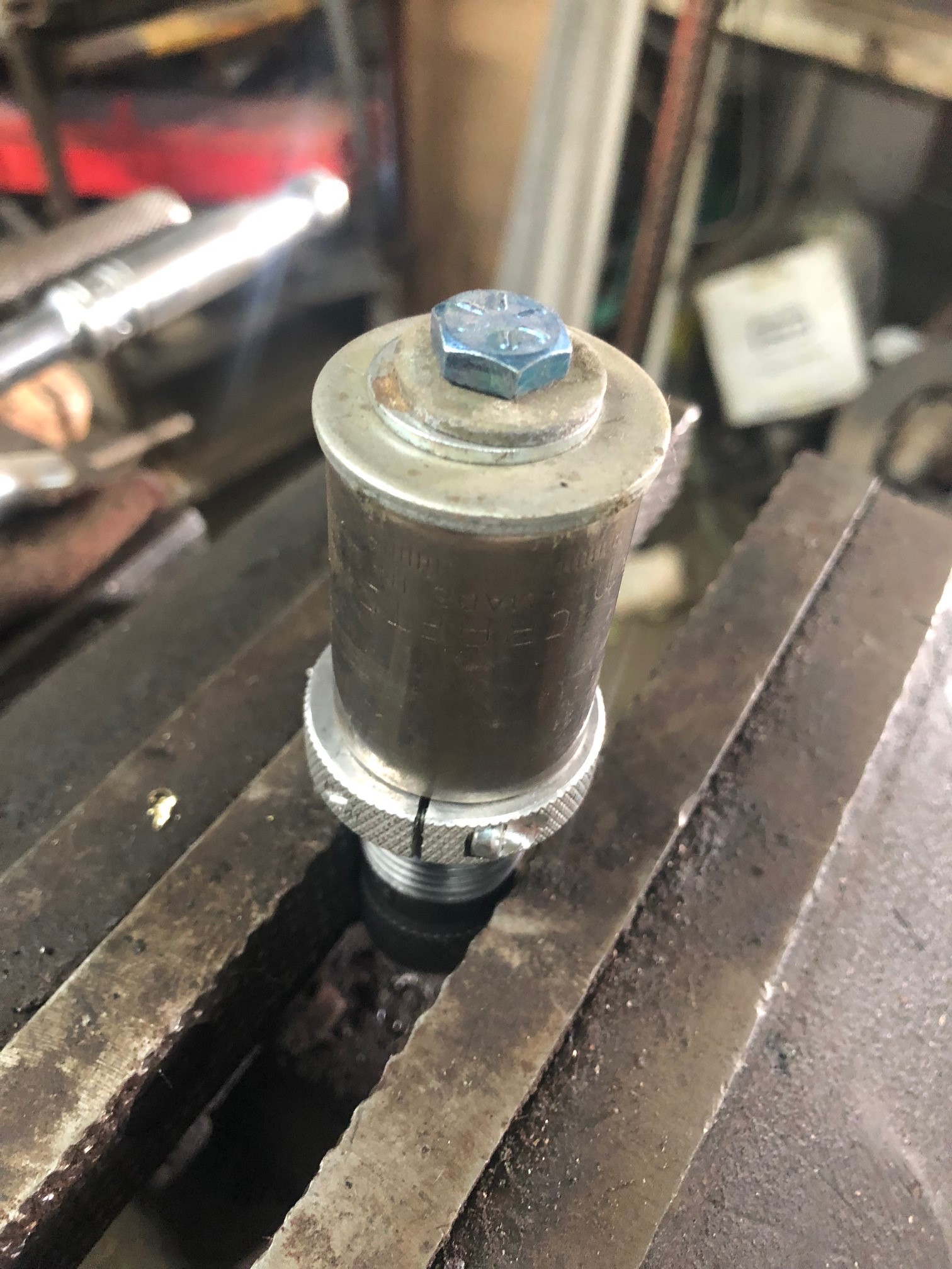

also got a case stuck. that was fun. tap it out, put a socket on it and used a 1/4" bolt to pull it out. lame oh.

What the he'll did you do to that die. None of these CM Crips know that and afraid to ask.
