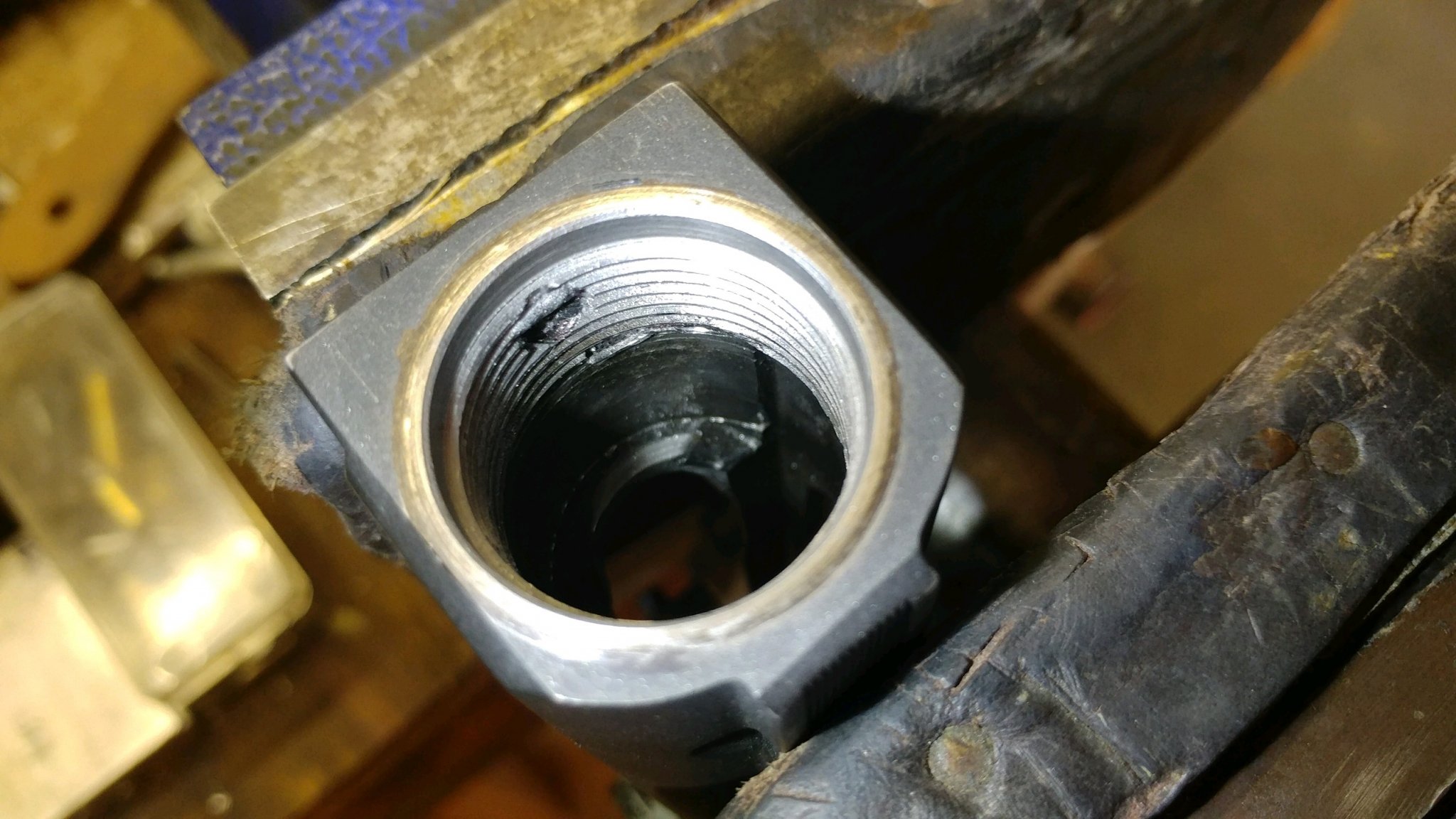

#21
Yes, the barrel unscrewed by hand. As far as the cause, I have heard a few things, many amount to this is why some gunsmiths will not work on this model of gun in particular (something with the way the receivers were made and not very strong, especially for a round like this). Regardless, it a paperweight now and some of the parts are now for sale.

#24
I had second near miss with this "gunsmith" where a barrel wasn't properly put on after having it threaded. The barrel unscrewed by hand and luckily I caught it. Thinking is maybe what happened with this rifle too (maybe not that loose but loose enough to become dangerous over time ie backing out). The gun was a 22-6mm before I rebarreled it.

#29
OP do you still have the Ruger receiver? Looking at the picture with the hole in the threads, is that due to the front action screw being too long and maybe punching through the receiver.

#30
From a barrel spinner who has done some builds on M77's.
Looking at your pic I don't see anything that alarms me. No crack on the face of the receiver. If I had it here in the shop I might have a different opinion.

#31
I don't know many guys who regularly work on the Ruger M77s, but always thought it was mostly due to prejudice based on a lot of BS being floated around about investment cast receivers. This sort of thing kind of makes me wonder though...

#32
Likely more due to the special jig it would require, can't remove the trigger hanger,
