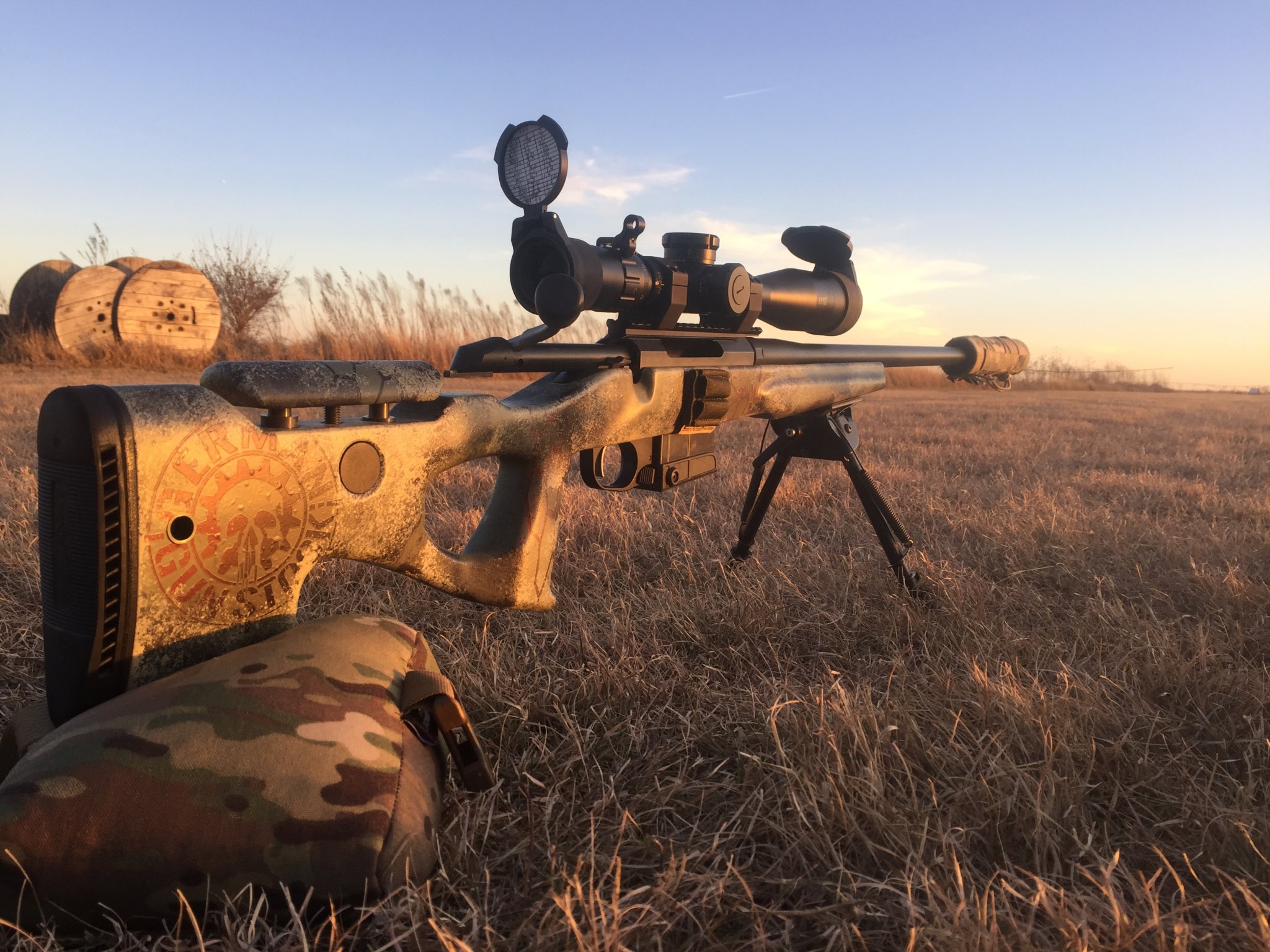

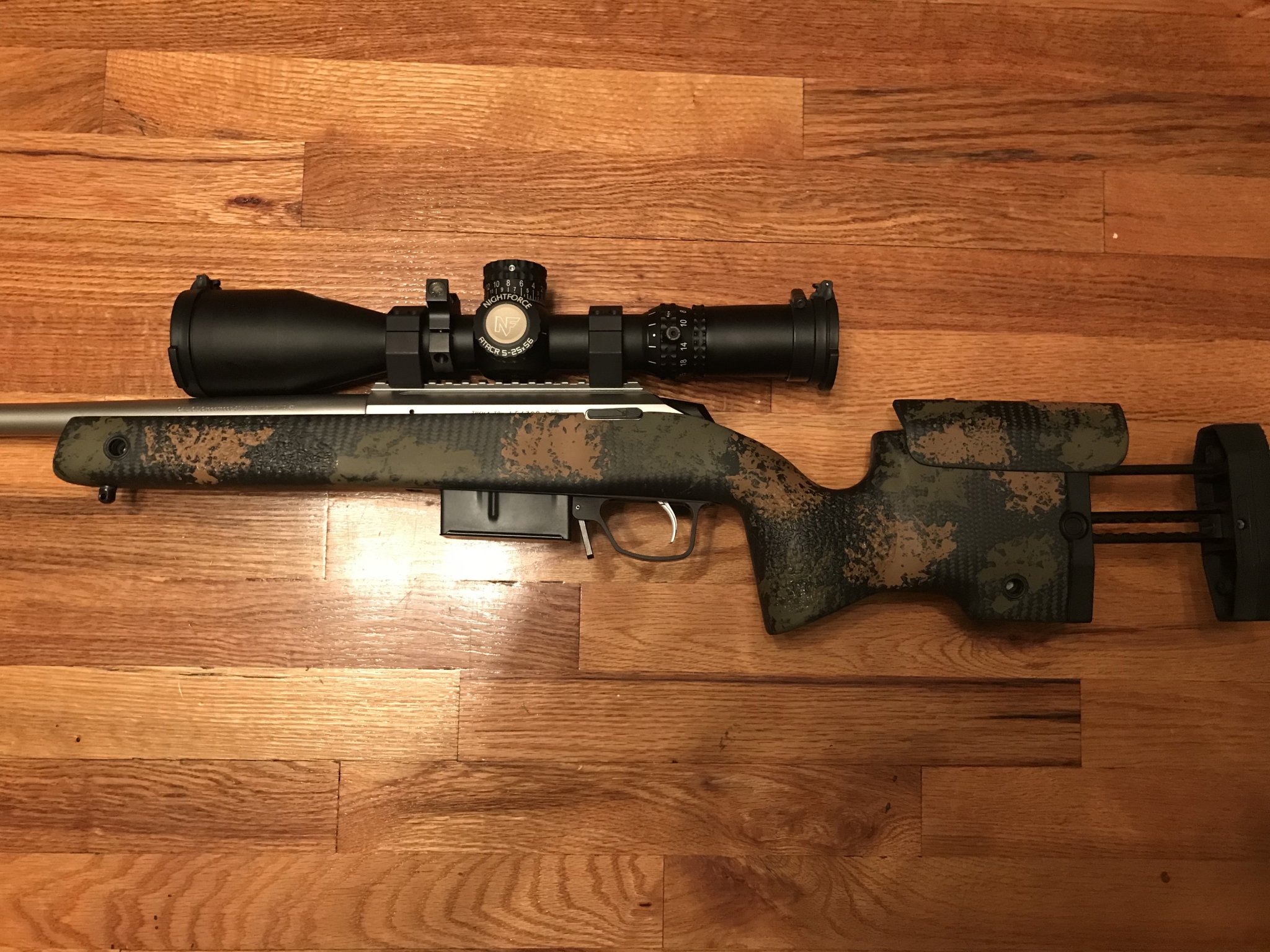

Below is my Tikka CTr that started as a 20" 260. I have always run it suppressed and the 20" is handy for hunting. I went with a 24" medium Palma 6.5 Creedmoor when I rebarreled due to the vast availability of factory ammunition over the 260. I hunted with the new barrel last year and it wasn't too bad, but I only hunt about 1/2 mile from the truck. If you are going to shoot matches, weight and velocity are your friend. The German Gun Stock is a great value as it has an aluminum mini-chassis in it and you can use the CTR magazines. If you want to go AICS, look at the KRG Bravo. I have a 20" 6.5 factory barrel that I will switch to for deer season this year, but I wll definately go heavier on my next match rifle. This is 12.5 lbs without a magazine with the 24" barrel, bipod, and suppressor.
