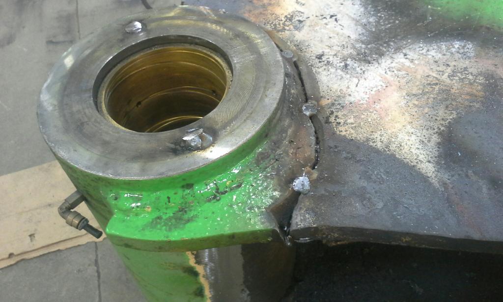

Did an interesting repair job recently. A metal recycler broke the main bushing off one of their crane booms. Wish I would have been there to see it. Laffin. Have a few pics on my S3 mini, but it doesn't do internet worth a damn. I can text them to one of you fellas if you're willing to help an e-tard out.

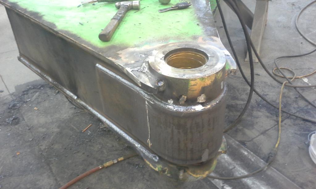

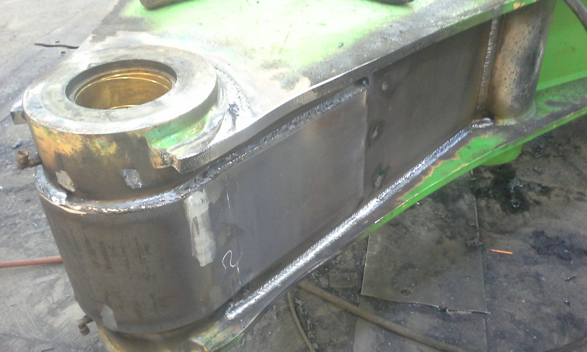

Thanks again for posting the pics, Geno.
It took a few hours to get the stretched material trimmed back and get the bushing tacked back into place.
Also took a bit of heat, as you fellas can see on the top plate.
I did the vertical up welds with .045 dual shield and the flats with .052 metal core. I tried to keep the flipping around to a minimum as it was an awkward bastard to roll.

I have no experience with the metal core wire. Is it considered FCAW, or GMAW? with it having a "core" my thought would be FCAW, but those beads you laid down look much more like Mig.
Hey Bogey,
Metal core is some awesome shit if you can position your work and it's thick enough material to take the heat. Fast with very little cleanup.
We typically buy it in 60lb spools and shield it with 90% argon and 10% carbon dioxide.
Some of the drawbacks are that it's limited to horizontal positions, fairly sensitive to contamination, and is prone to severe porosity if the shielding gas gets blown away by a breeze from an open door etc. Undercut can also be a problem, but that normally becomes a non-issue once a guy gains experience with the stuff.
I love the shit and run it whenever possible.

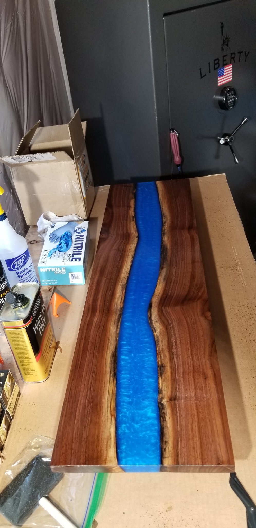

I think I'm going to pick up a furniture project, mostly wood but I'll try to throw in some metal accents. Currently in the design phase, I have three specialists lined up for some details to take it to the next level and I'm trying to get something a little special for it from another person.
I may have even lined up a wood shop so I'll have more specialized tools available than just my table saw, router and hand tools.

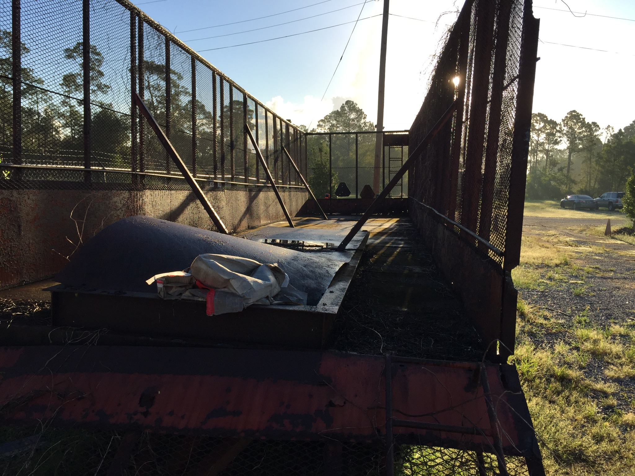

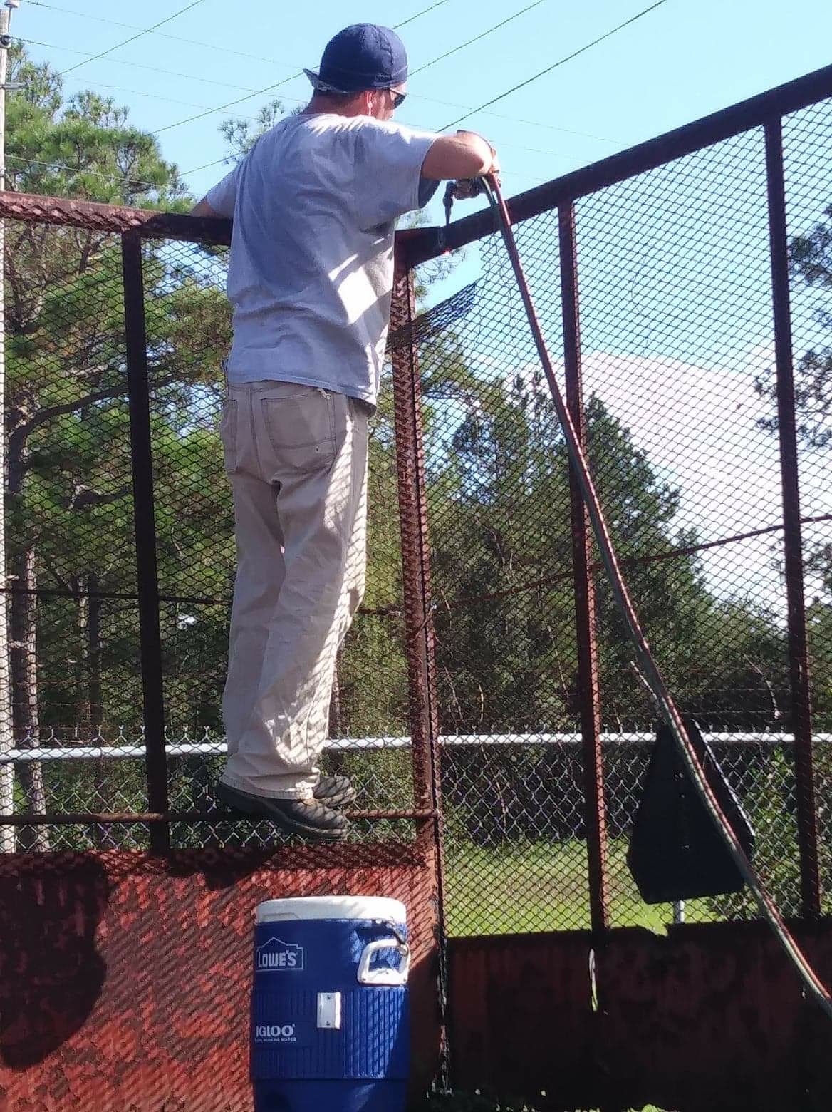

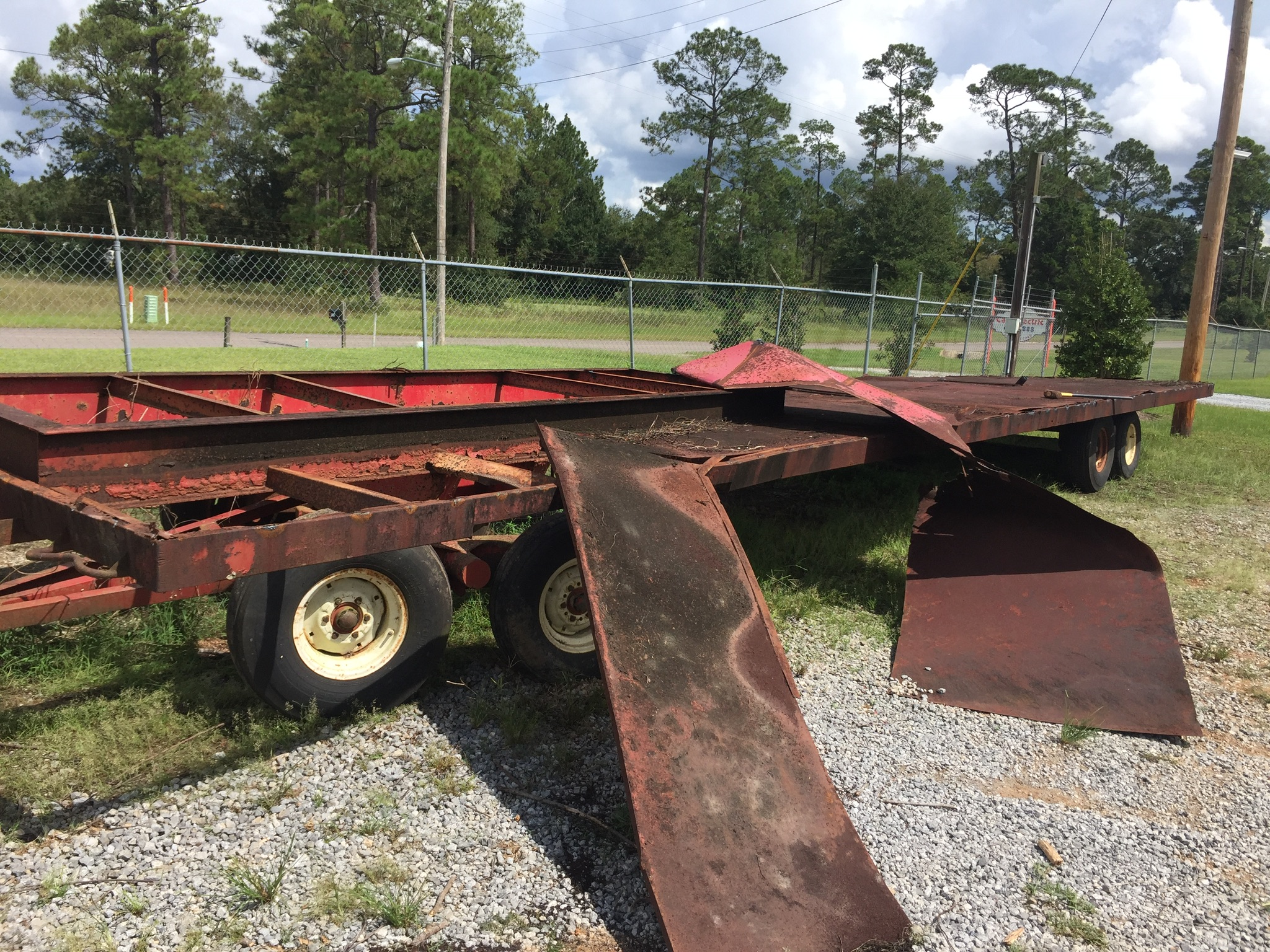

So the trailer/ float conversion I was helping on yesterday ended up being a shit show. I'm going to bitch for a bit and then ask for some guidance from those of y'all in the business.
It was a 40' cotton trailer with 8' sides that needed to be torn down to sub frame for a conversion to a Mardi Gras float. Through a convoluted multi-party deal my buddy got the job and got permission to bring me on as his helper for the demo on-site and the two of us were supposed to help the fab shop do the rebuild.
The demo was figured (by the Client and our boss) as about 4 days of work paid hourly. We got there and figured out an efficient way of doing it and realized we'd probably have it done in a lot less time and conveyed that and let them know we were going to be able to get it handled in less time and asked for some consideration on our pay since neither of us is the type of guy who's going to milk the clock but didn't want to get totally shafted by getting done in way fewer hours. The Client even doubled the amount of shit he wanted removed from the trailer mid day based on us pointing out some serious structural issues and we were still able to keep a great pace going. At this point we found out that the Client had a buddy with a fab shop that rode in his Mardi Gras Krewe that was going to do all of the rebuild for him, so we were essentially just the demo crew and weren't going to be a part of the real money job of rebuilding it.
We plugged along and got about 80% done yesterday before my buddy had to go grab his kids from school and the heat index was comfortably 105* so we showed the Client where we were at, had already made some cuts and prepped it for completion and that even with the extra work he wanted we'd be done with it today. My buddy got a call last night from the client's son (who actually hired us but wasn't the guy paying us) to tell him that he just used a skid steer and ripped the rest of it apart on his own and that we were done and that he'd told his dad to just pay my buddy and me $100 and $70 respectively based on our hours worked yesterday. This was the same fucking guy who had told us to get it done and he'd "make it right" on the pay since we weren't racking up hours on him.
My buddy was fucking gutted. He knows all the people involved in this deal and is taking on these side jobs to literally keep food on his family's table while his own business that he's had for over 20 years is struggling and his wife has had to take a job. We're both old country boys who basically only know how to give a solid day's work and would be lost if we had to scheme and connive to make an extra dollar off of someone. I ended up feeling so guilty that I might have cost my buddy the extra time and money on this job that I gave him my share for groceries. I figured at least one of us should have walked away with a fair day's pay for what we did.
I think we've both resolved to only do these jobs for the old timer who runs the shop if we're paid by the job vs the hour, but that's my question to those of y'all who have been in this business for a while:
What have you found to be the fairest way of working fab jobs where you know you're being compensated and still being fair to the boss and the Client? Keep in mind that we're fairly skilled middle-aged "labor" and are currently working for someone else. We are however looking into picking up our own mobile rig to be able to act as true subs for the shop owner while taking on and costing jobs ourselves.
Pics of the trailer to follow

Note the OSHA-approved cooler we used as a ladder. The decking was so rusted out in that corner that we couldn't trust a ladder, so I set it on top of a rib and balanced on it to make some cuts before stepping over to some cross tubing and hanging on for dear life while cutting the tops of the walls.
