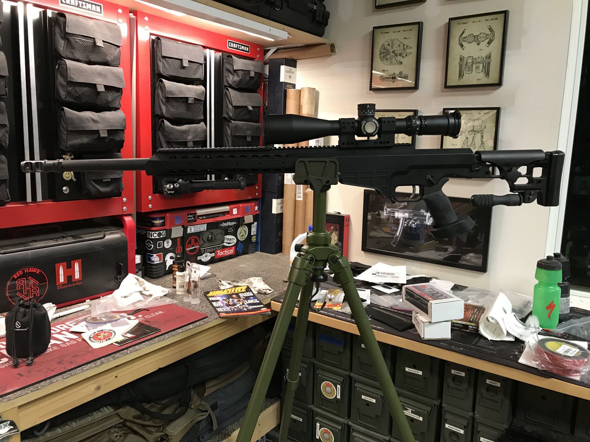

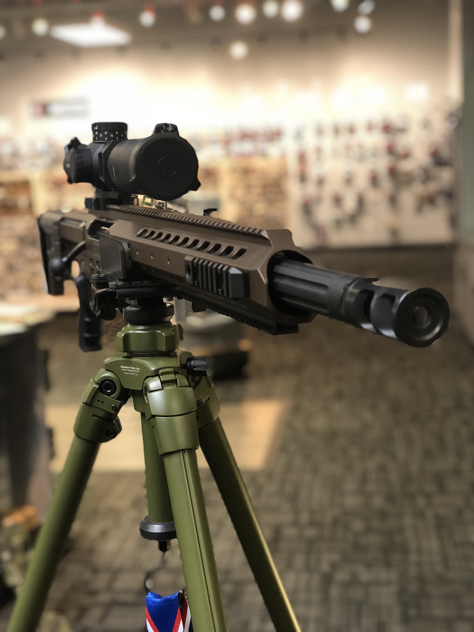

Quick PSA, and forgive me if this is common knowledge unknown to me, but if you have an older "large breech" MRAD, new production magazines (marked "A") will not work with it. The catch on the magazine is substantially further down the mag body and will not activate the mag catch of the rifle. I had a phone conversation with a CS rep at Barrett and purchased some older mags marked "338Lapua". They are not making them anymore but have some laying around. The newer "A" mags will work with your older rifle if you're using the small breech conversion kit, which is required to change calibers if you have the gen 1 rifle.
He went on to give me the following compatibility info:
"A" mags: 338LM, 338NM, 300NM
"B" mags: 7mmRM, 300WM
"C" mags: 308, 6.5, 260
I'll post up some pics of my new but old MRAD after I get the ATACR in the Spuhr that just arrived today. Stoked! Now if I could get the cows off my range...

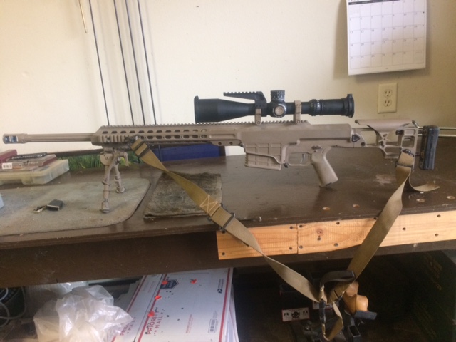

Have not seen any accuracy results with this rifles yet...anyone have any 100yd groups with a 300 win or 338Lapua?

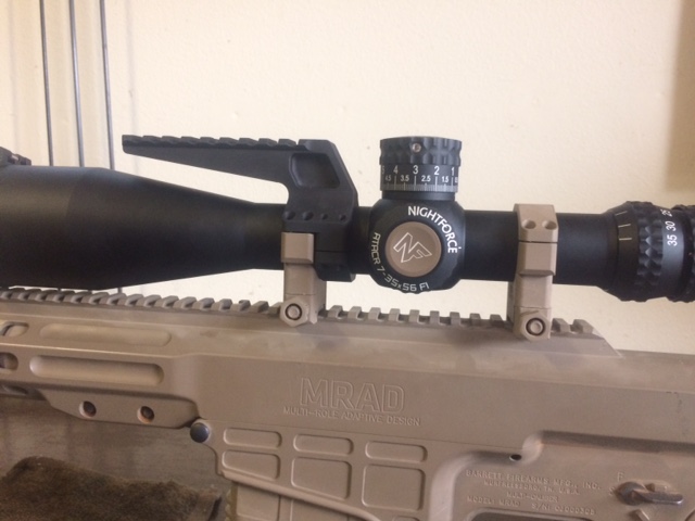

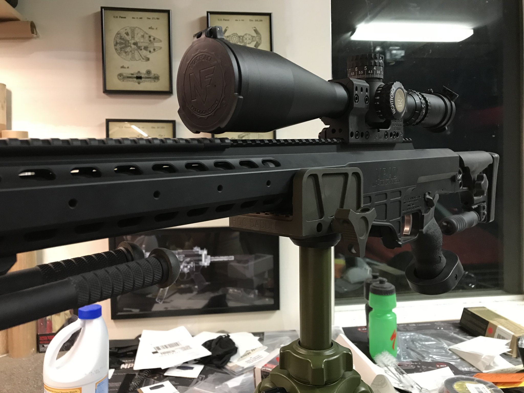

I'm jealous of your 7-35, I felt like I broke the bank when I got my 5-25. What are you planning on attaching to that top rail?
