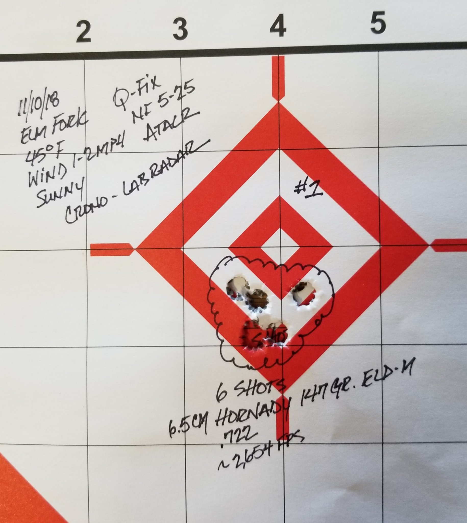

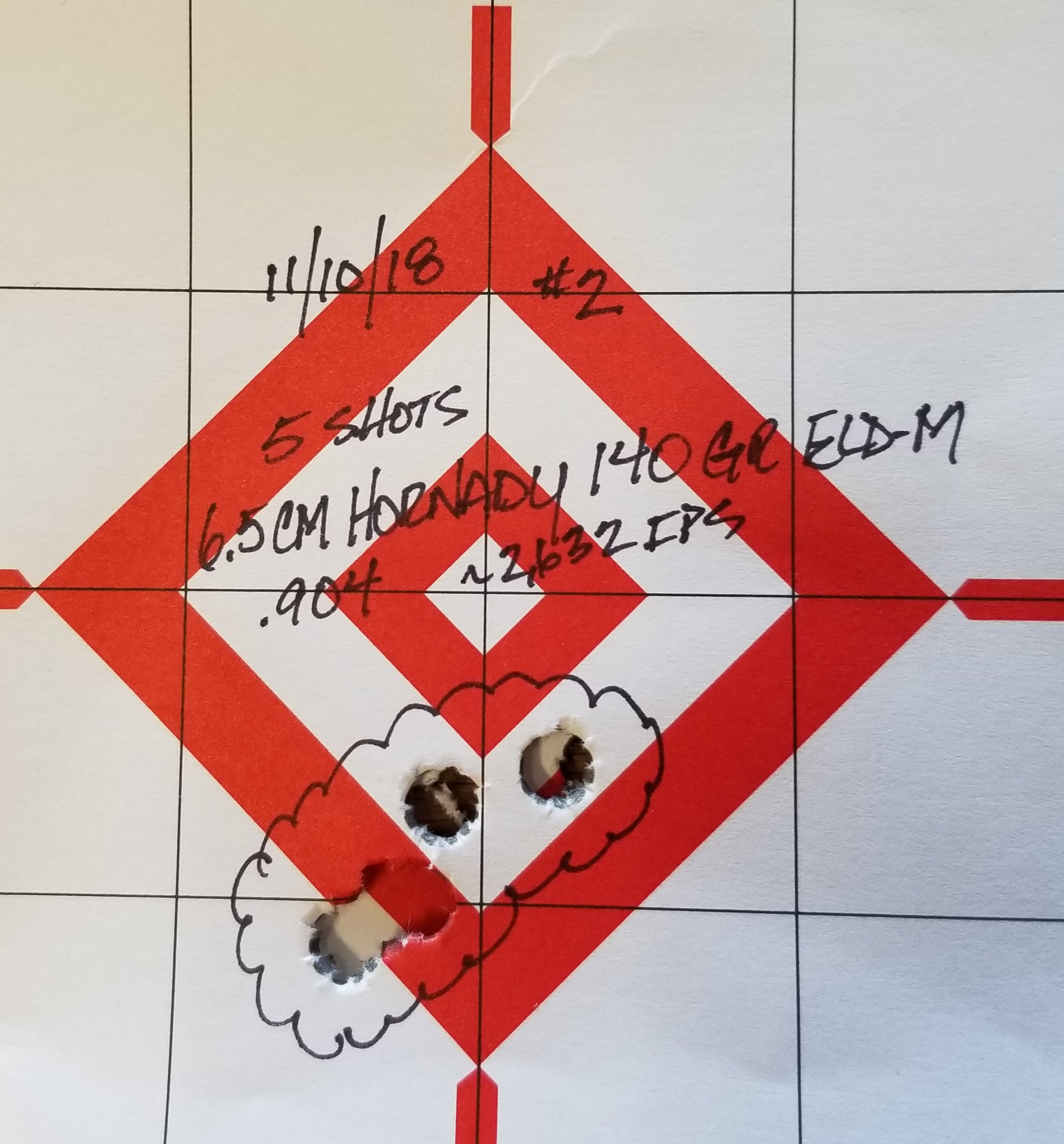

I had hoped for better, but I've only started to work up a load. I'm going to try Fed Gold Metal Match next outing. That is pretty much the standard to compare apples to apples accuracy I think.

Even with decent ammo it should be shooting under an inch my stock CZ 527 6.5 grendel heavy barrel with. Wood stock and hsm match shot .7 inch groups at 100.....
The 16" 308 barrel is an extremely light profile. You can't expect it to shoot every load as well as a heavy contour would. I don't care who made and chambered the barrel.

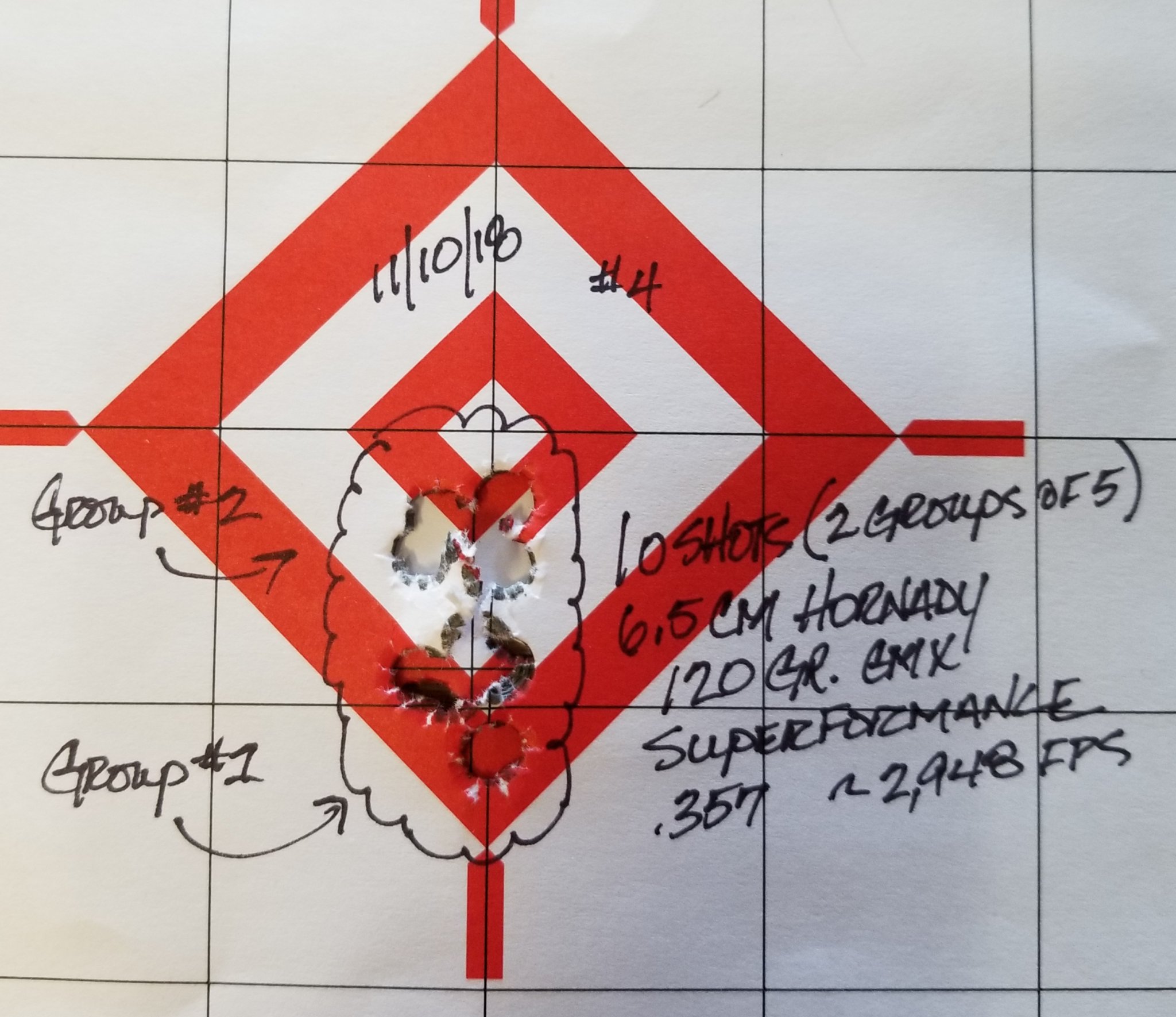

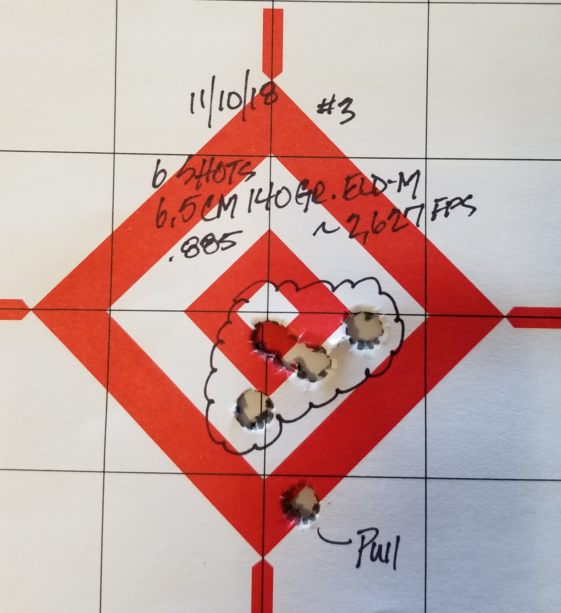

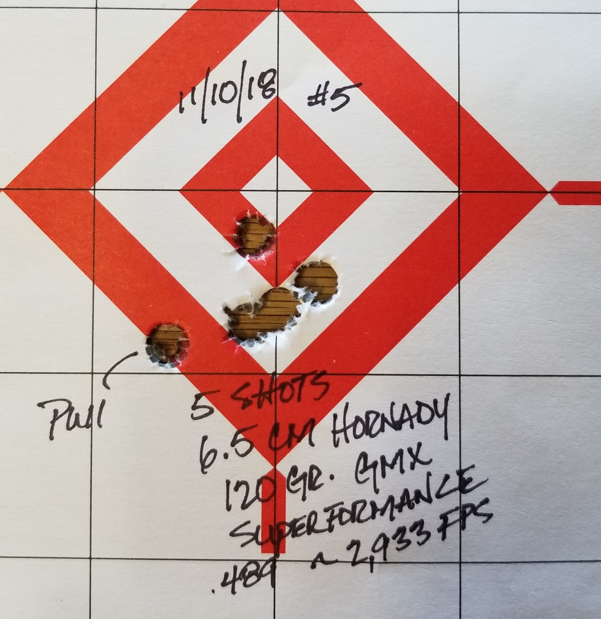

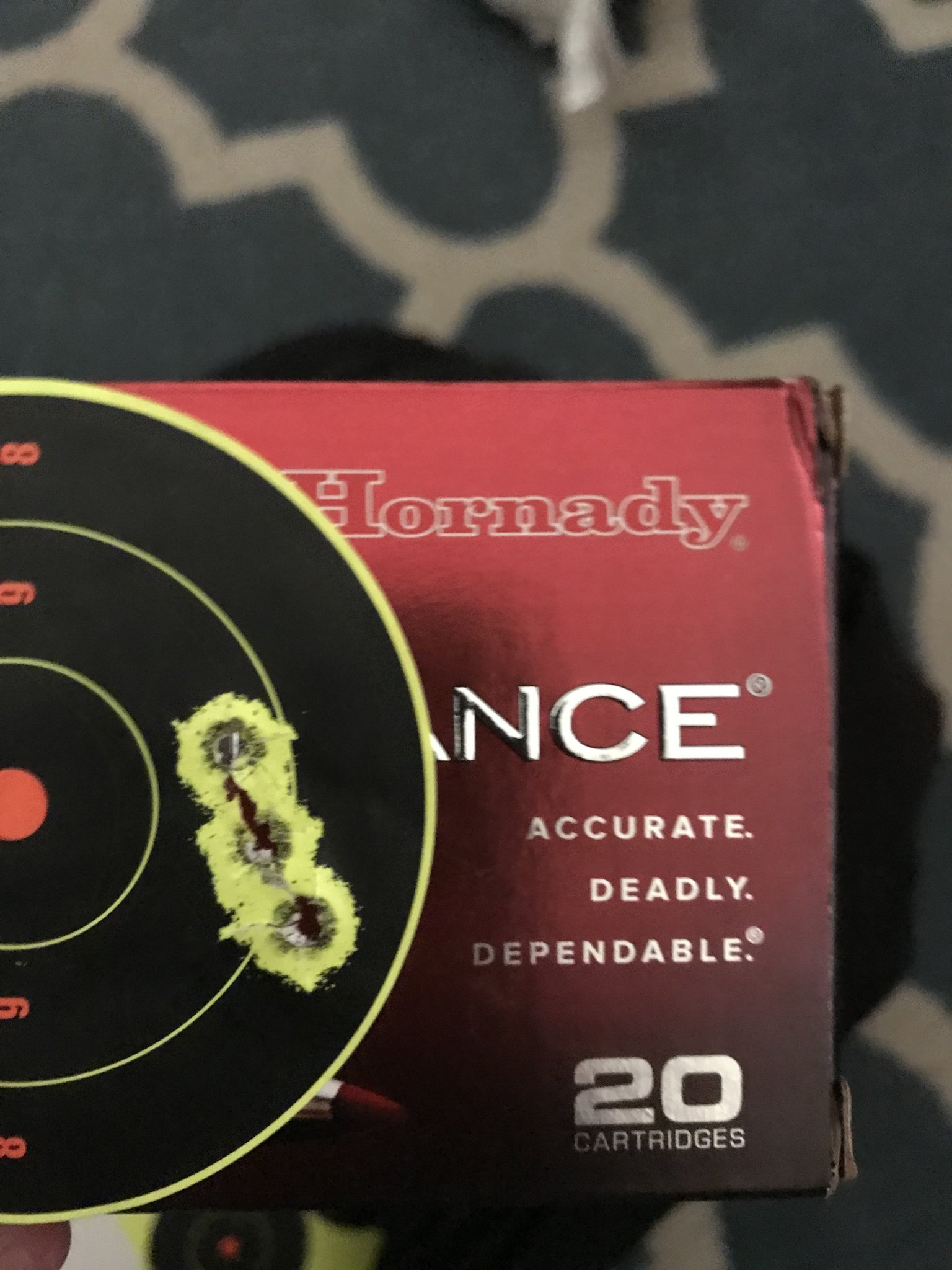

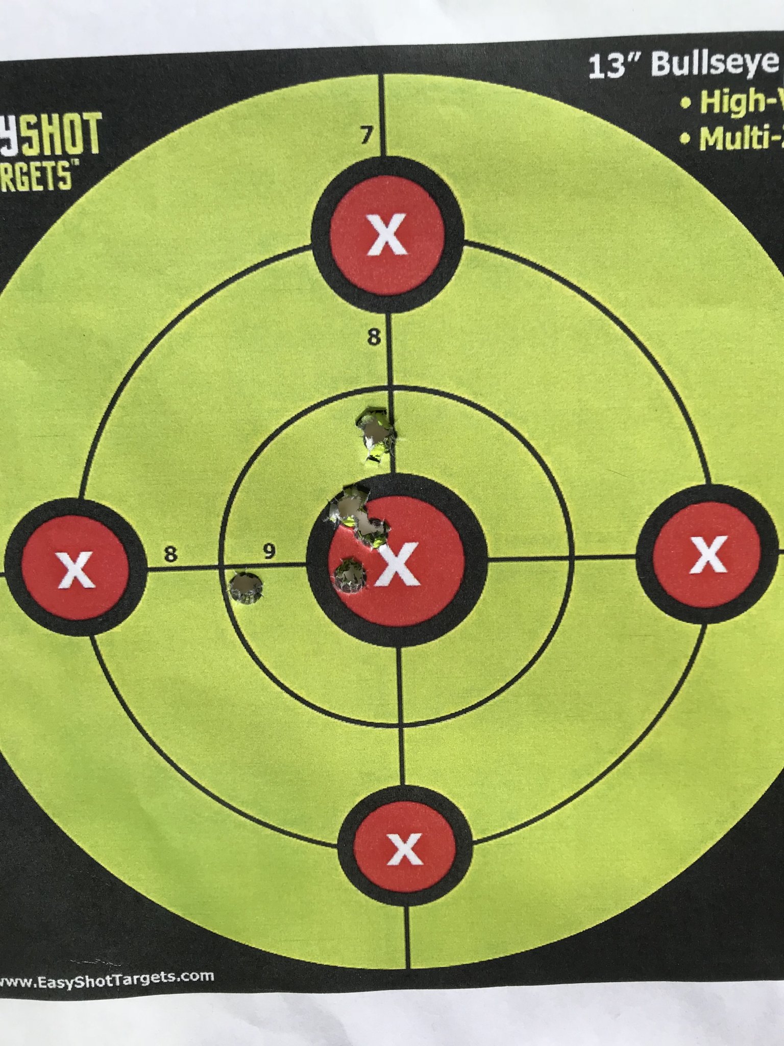

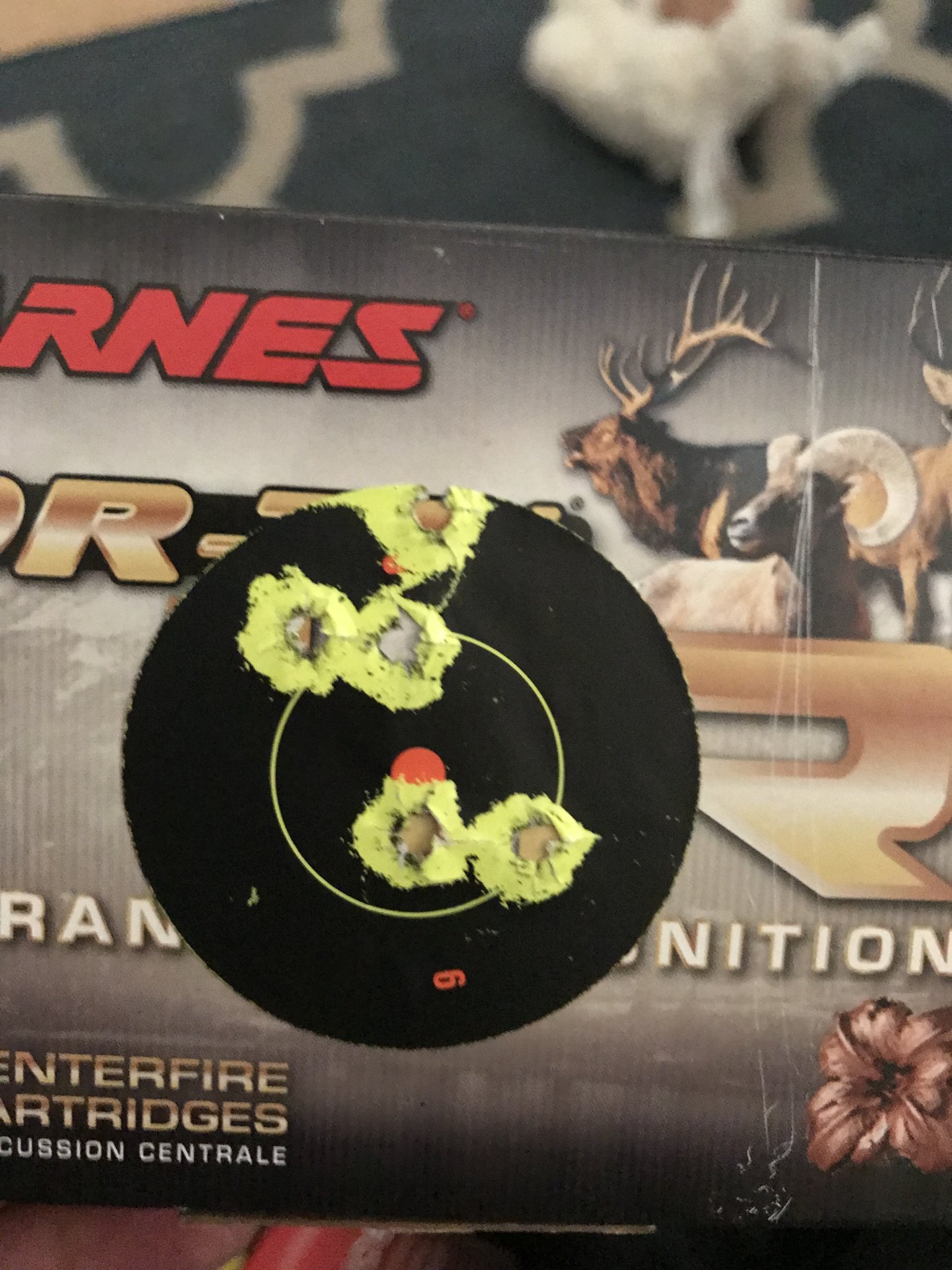

My first post on this thread. I’m shooting a 6.5 bartlein barrel. The pictures with the ammo box are fairly representative of my groups at 100 yds with those rds. The green/red target was a “qualification” target on a bench with a bipod at 200 yds. Keep in mind that I’m shooting with a magpul bipod and it is definitely not as stable as I would prefer on a bench/precision gun. I expect it to work fairly well in the field.
I am by no means a master marksman. My goal has pretty much always been to shoot within 6in (kill zone on a deer).
The only problem I have had is with shooting “cheap” ammo, that it doesn’t feed and created a strange “heavy bolt.” Looked into it and i think it might be due to the spec of the ammo and barrel. (Definitely not an expert).
No problems feeding with the magpul mags.
I’m happy with the purchase so far.

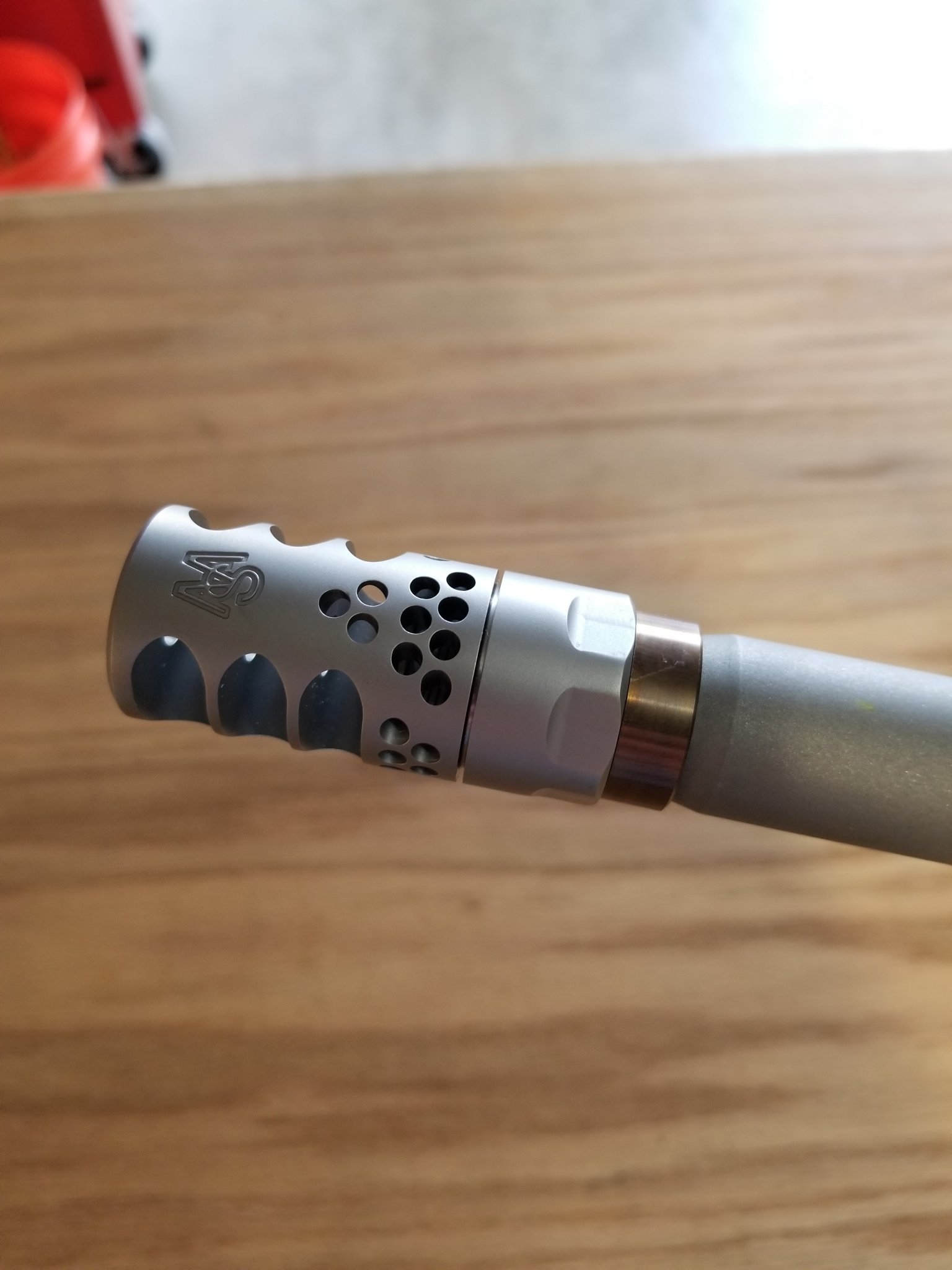

@TXGunner308 What brake is that? It looks good on the Fix. I assume it performs as a brake should.
MB made by Scott Weichel - Live Oak Accuracy
I have not fired my rifle with this MB yet but plan to over the Thanksgiving Holiday. I did fire someone elses rifle (not a Q) that had one and it performed just like a MB should. Kept me on target to allow for quick follow up shots. We shall see how it works on mine. Comes with install tool. Installs with box end wrench. No timing required.

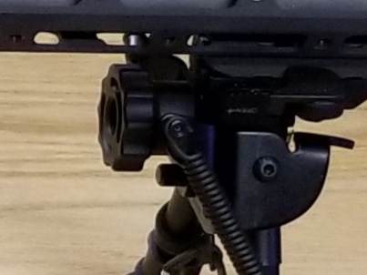

Question for the group- what’s a good option to mount a Harris bipod on this thing, either an adapter to the rail or a sling stud that will attach to the hand guard? I bought a cheap rail adapter off Amazon and it was junk, looking for something solid. I have an Atlas that I will use primarily but I want to have the option to use my taller Harris. Thanks.
This is what I used on my Harris. they have another one that will pan also. The only problem is the rail section that ships with the rifle is one slot short of using all three cross pins so I just removed one and it works great.
https://zrodelta.com/product/dloc-s-kit/
cleric
Belligerents
Nov 13, 2011
308
80
34
38
Dallas, tx
I would advise against a sling stud for the Harris. Had one on another gun and it wears out over time. Truth be told I think the atlas is awesome but my plan is to go to the magpul on my other guns (ars and such)
