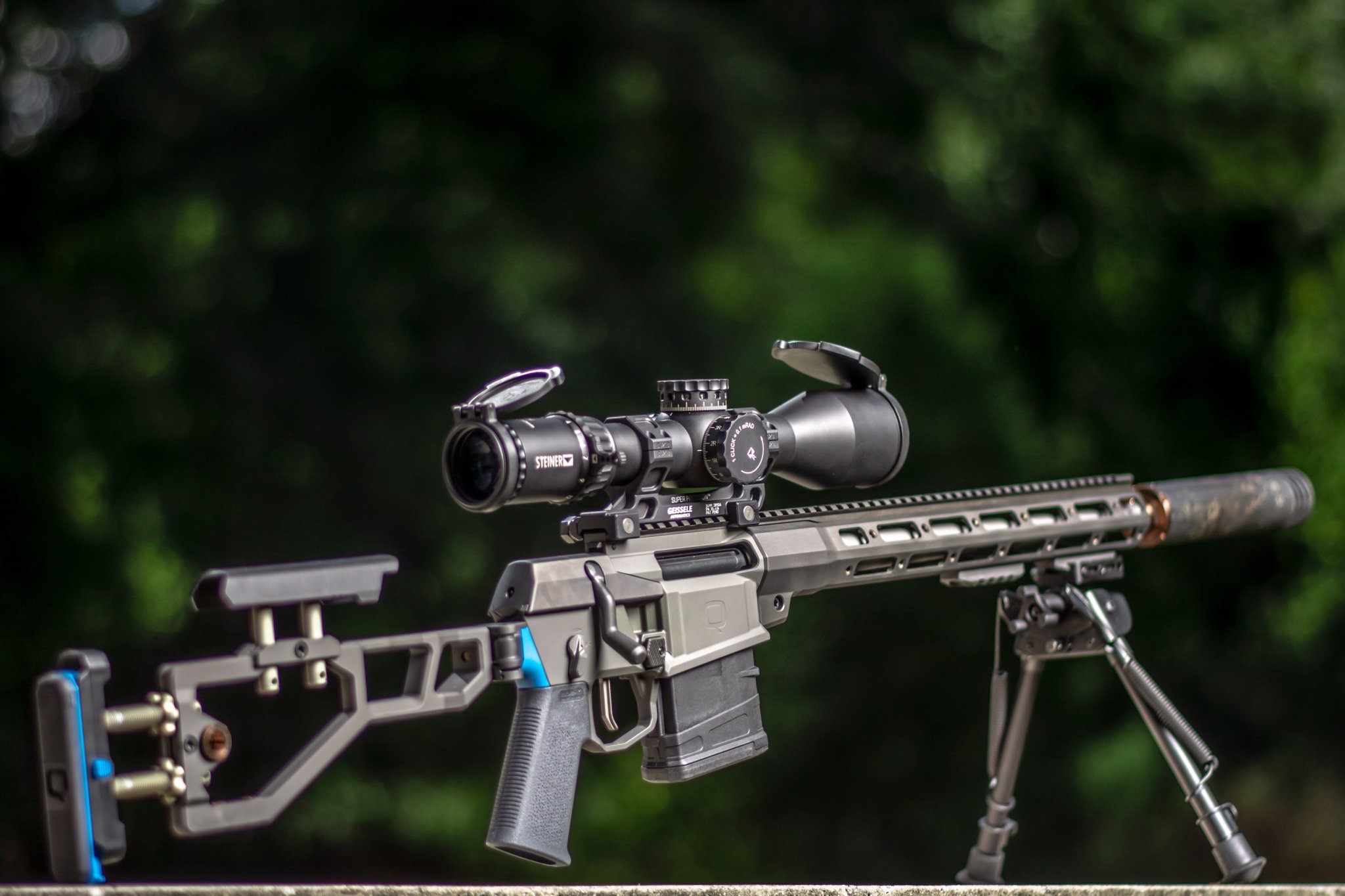

Had Billy Goat Machine build me up a 16" creedmoor shorty the other day. We did away with the lock nut and just put the extension on a shoulder.
I went with a Bartlein 2b and reused the muzzle break. Barrel with extension and break weighs 2.13lbs. Chamber end can be turned down as well as fluted and that would probably get me close to the 308 light wt barrell (2.4 lbs)

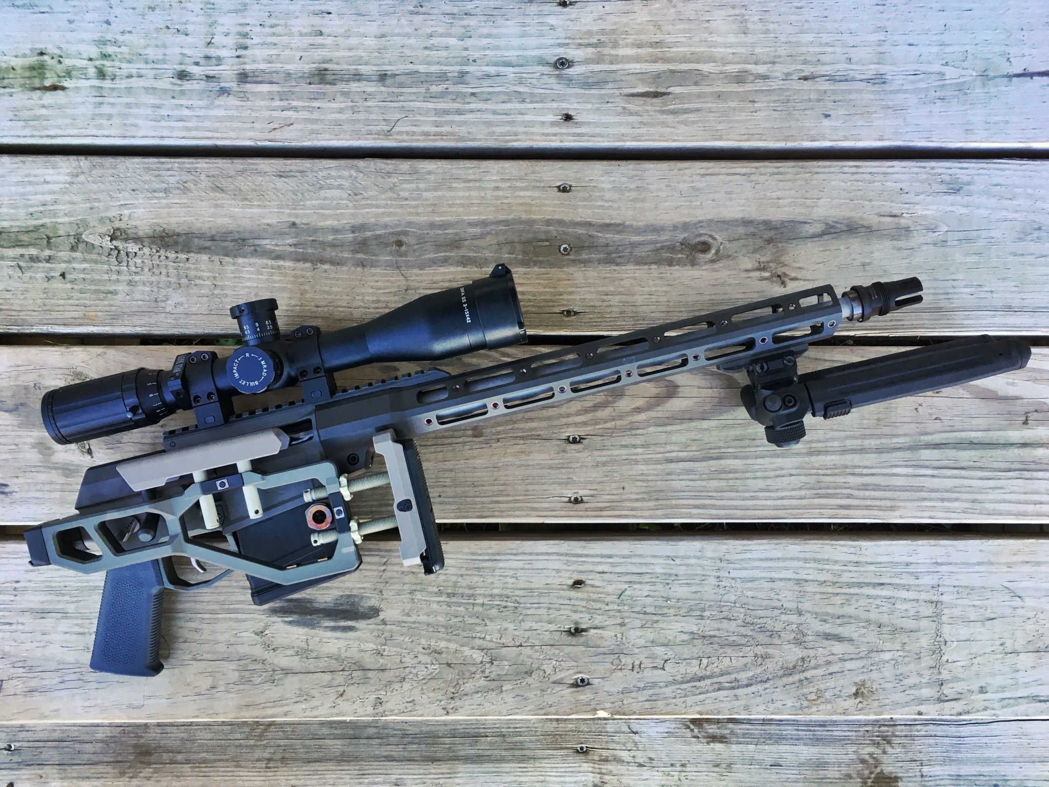

Here’s my setup with the 16” .308 barrel. I’ll be hitting the range this weekend and switching over to my proof barrel and will try to get a picture of that too.
I bought the short top rail, didn’t like the look or feel of the full length plus it makes barrel changes quicker. I have 3 QD sling mounts currently installed to test out where I like them installed best, will take 1 or 2 off when my mini-Fix arrives. I’m running the Nightforce NXS 5.5-25x50, this was my first venture into high end optics, Vortex rides the rest of my rifles, so I feel that it may be a bit heavy. I’d like something lighter and more compact.

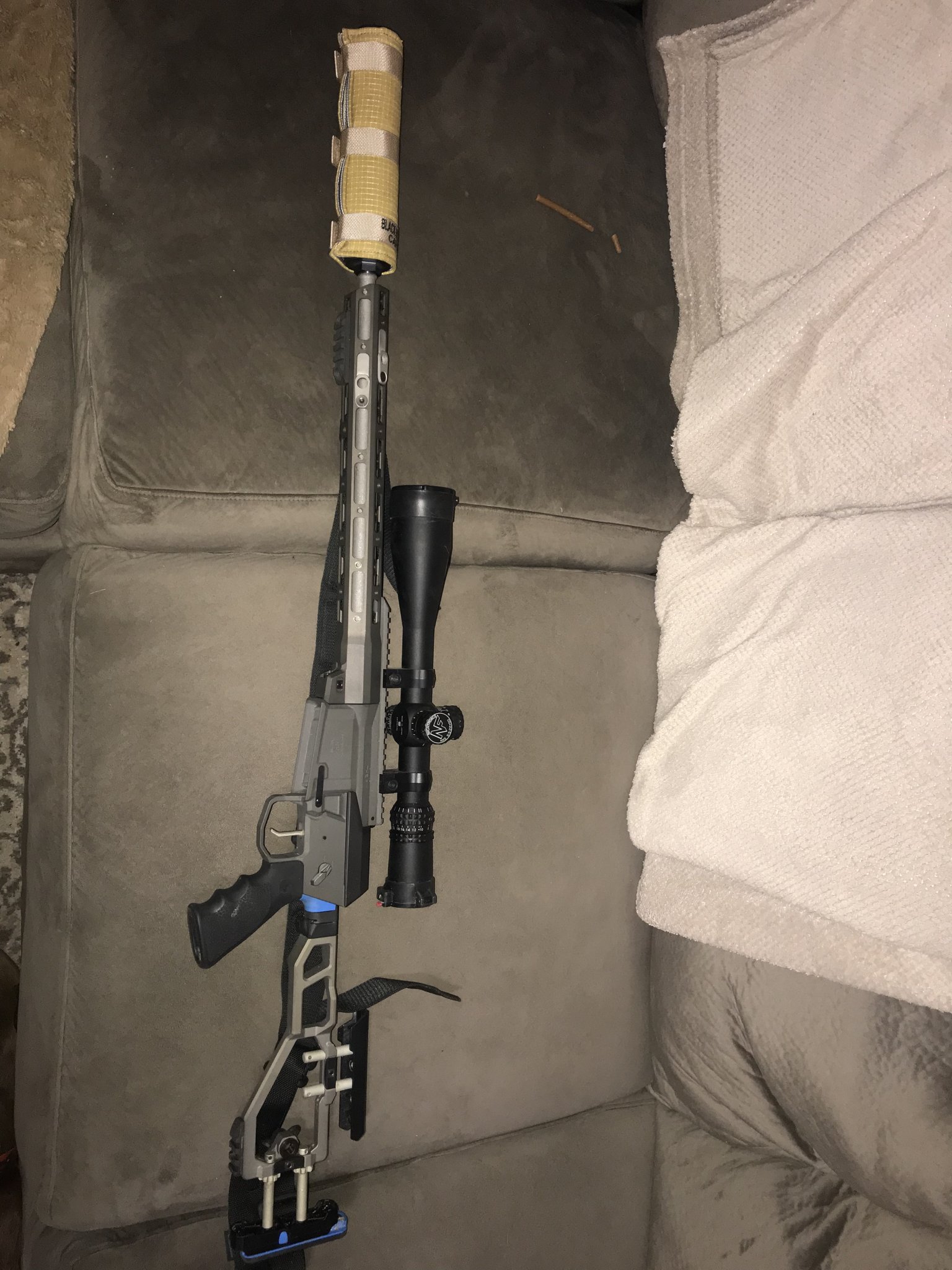

My setup Steiner T5Xi 3-15x50 on a Geissele 20 moa mount. I use a Harris with the a D-loc at the range. I broke down and bought the plan b and it is easier than the ASR but I don't know if it is better since I have never shot any cans downrange.
This past weekend I found my stock was loose at the back of the receiver has anyone else noticed this?

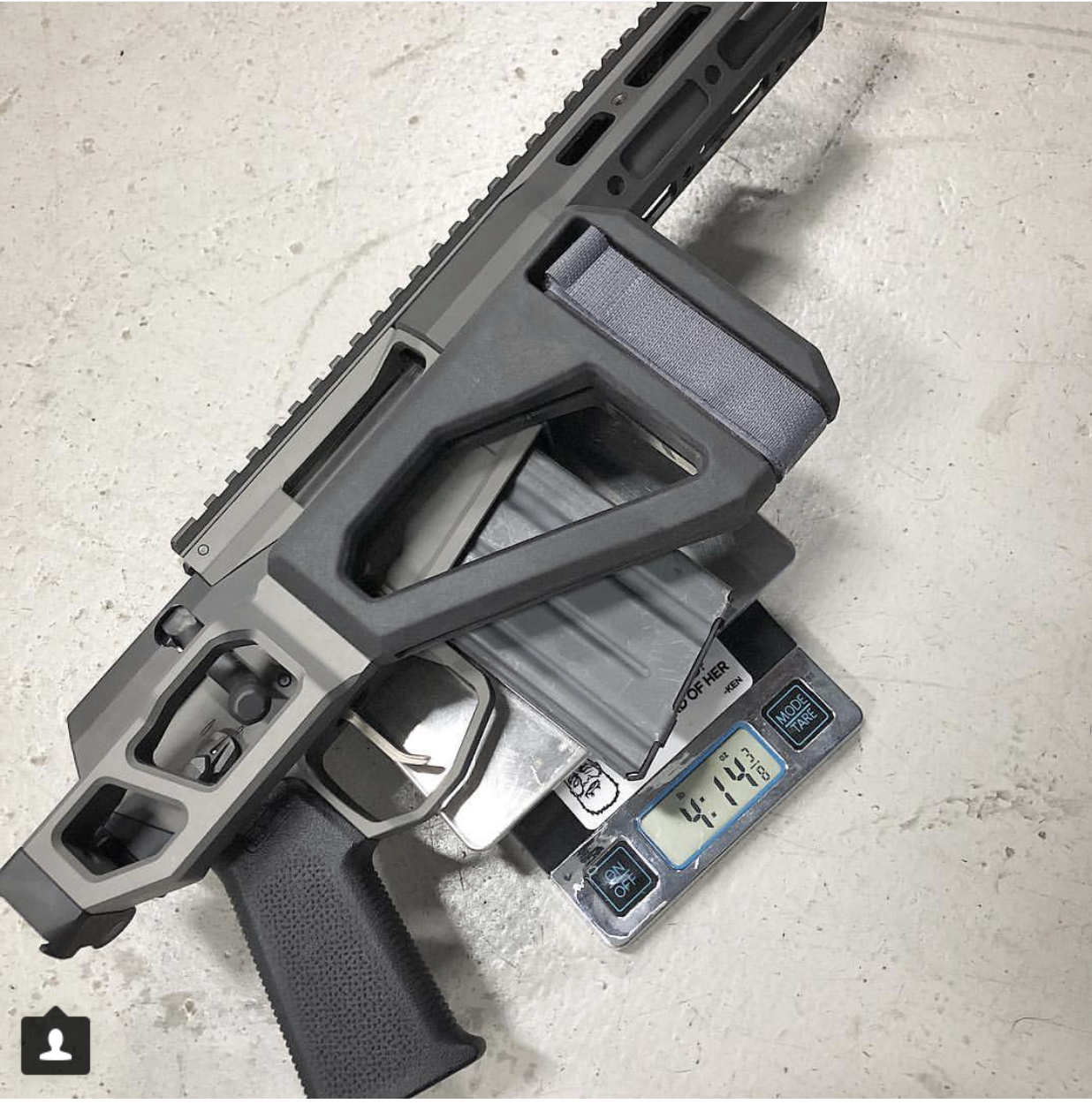

Saw some pretty cool accessories coming down the pipe for those q-sert fans like myself. No Eta. But the prototypes were on the money.
Shouldered the Fix pistol brace. While the Honey Badger pistol brace was spectacular the Fix brace is a head scratcher with its LOW cheek height. One of the guys joked that it was the perfect height for iron sights while I was there. And it is. Similar to the stock on a blaser r8. Or the traditional remington 870 stock cheek height only being useful for a bead sight barrel—and garbage with the higher rifle sights or ghost rings. If you are a nv user like myself I’m sure you could rig up something to work. I just didn't understand why they didnt design something with a more ideal shape. Not an adjustable cheek. Just something that more closely resembles the stock outline with the cheekpiece extended. In all truthfulness it was the first dissapointing thing i have seen from them. This is coming from someone who will likely end up buying one because I NEED the pistol receiver to hunt certain areas.
The 8.6 creedmoor was everything I wished the .338 spectre would have been. I will be grabbing one of the barrels when they become available. I reached out to my Hornady contacts on the drive back to ensure I have my name on some of the first run of brass. Take that however you want to.

Nice to hear!!
Any chance a larger butt pad was “in the works”?
I thought the cheek weld looked low on the pictures of the miniFix brace. Only thing I could speculate at for it being low, is to stay within ATF regulation of it being a brace and nowhere near an actual stock.
Hopefully they will offer a 16” 8.6cm barrel so I don’t have to convert my Fix to an SBR.

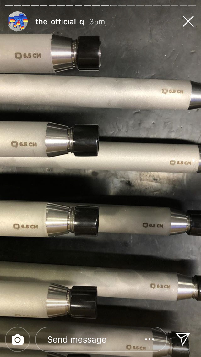

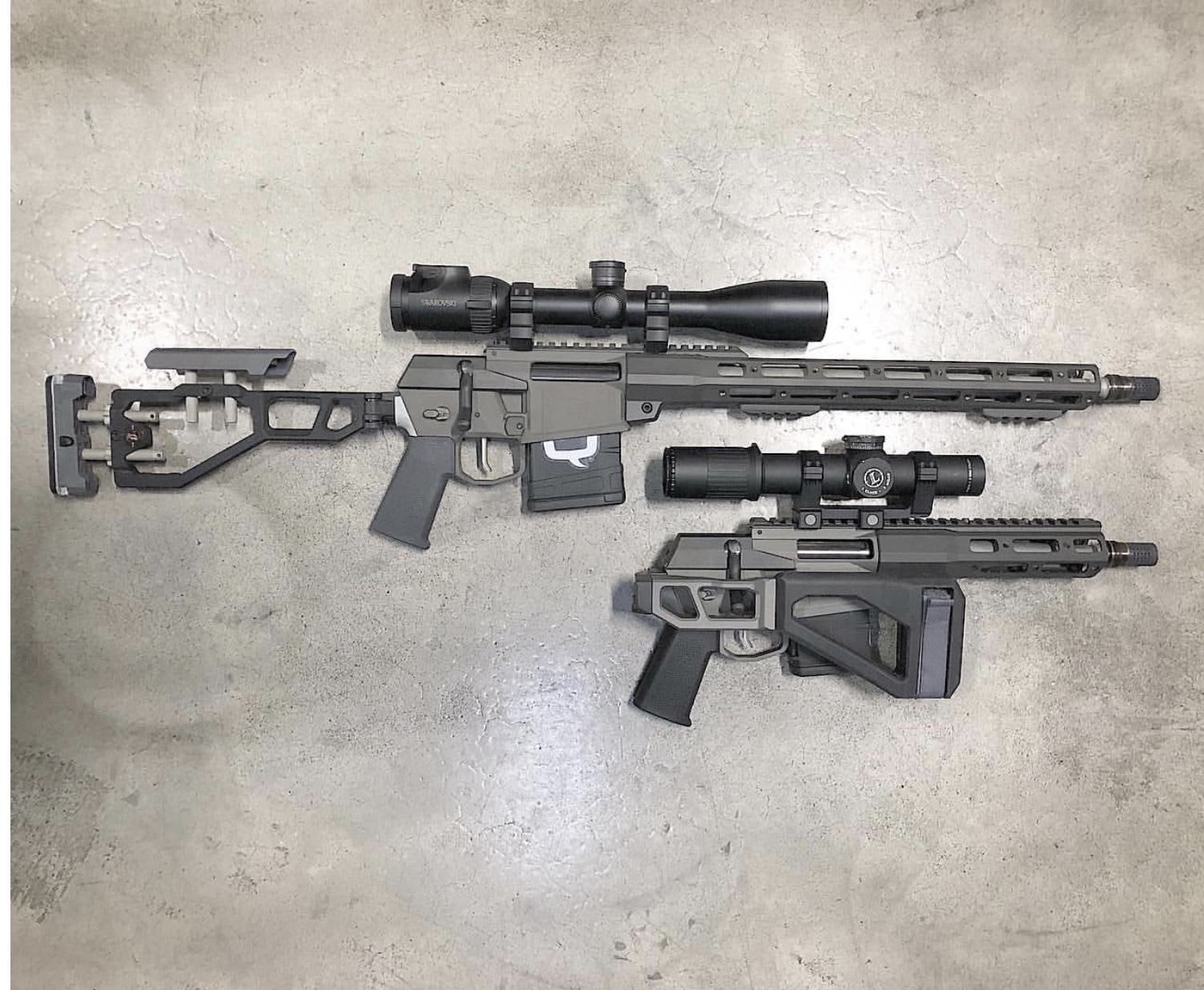

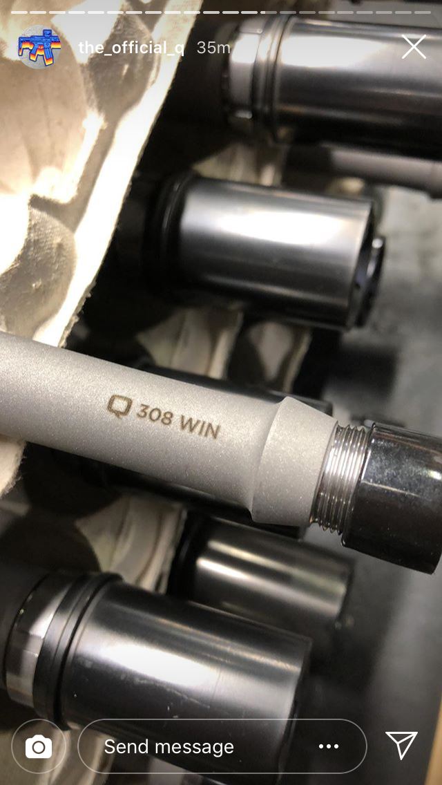

I caught these couple of pics in Q's instagram stories last week - looks like they are officially into non-Bartlein/Tooley barrels for the base Fix rifle. Probably already common knowledge, and I'm not really sure how much it matters, but figured some might at least find it interesting.

I put the 8.5" rail on this weekend after also swapping to the 16" .308 barrel. Feels like a completely different gun than the 22" 6.5. I hope to use this setup for deer season this fall and then swap back to 6.5 for recreational shooting this winter/spring.
My first barrel swap went pretty smoothly, looks like I didn't mar anything and it wasn't too bad to torque the barrel nut down. The most annoying part of the process is probably the T25 that goes into the bottom of the handguard from the front.
Aside from the weight differences, I really like the feel of the slim handguard without the pic rail on top. Has anyone done any testing if the shorter rail has any significant negative impact on accuracy? I believe Q mentioned originally that the full length rail helped stiffen things up.
Special thanks to @TSean @tinytigers and @J-Hon for helping me get to this point guys. Literally everyone I've interacted with here has been awesome and I'm really appreciating it.
I haven't been able to shoot this configuration yet, but I think I can make it out this week if the weather holds off.
