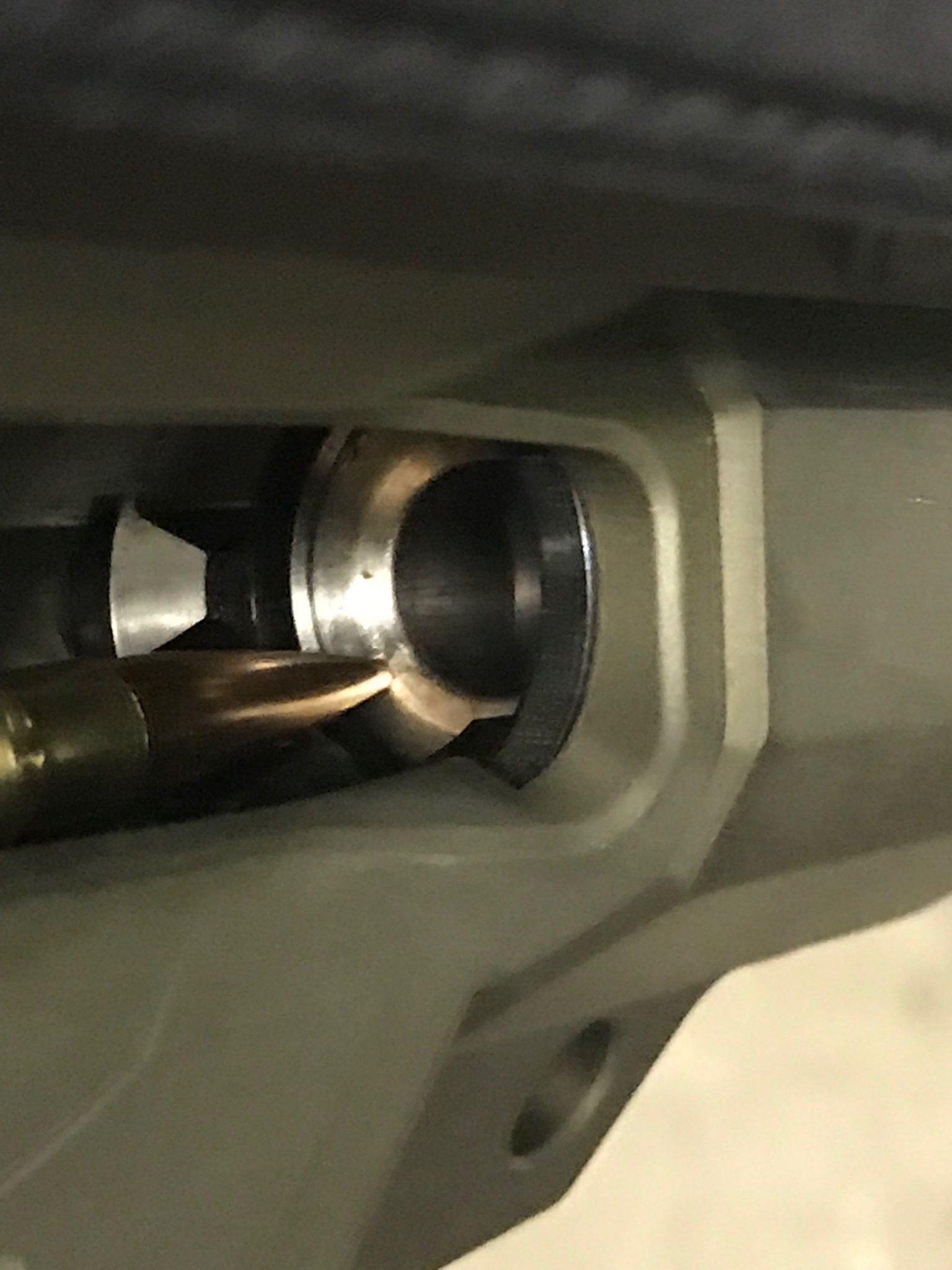

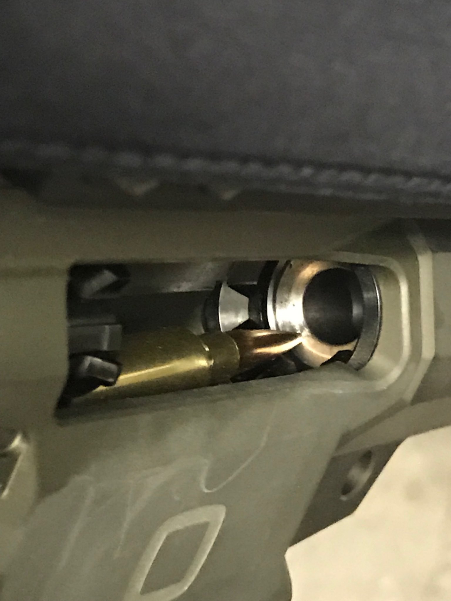

Gentlemen, i have a pretty large surplus of 140 hybrids for my 6.5. Now i loaded some up to mag length using once fired 6.5 130 prime brass. the 130s prime fed perfectly fine. The freshly loaded beloved 140s no matter the seating depth dont have a sharp enough ojive to meplat to make it up the feed ramp and into the chamber. We tried them in my rifle as well as a friends. Attached are the photos. We tried them in magpul mags, a lancer hybrid as well as a hexmag..... Anyone have any ideas or is my surplus of 140s going to have to stay with my DTA?IMG_1455.jpgIMG_1456.jpg

Gentlemen, i have a pretty large surplus of 140 hybrids for my 6.5. Now i loaded some up to mag length using once fired 6.5 130 prime brass. the 130s prime fed perfectly fine. The freshly loaded beloved 140s no matter the seating depth dont have a sharp enough ojive to meplat to make it up the feed ramp and into the chamber. We tried them in my rifle as well as a friends. Attached are the photos. We tried them in magpul mags, a lancer hybrid as well as a hexmag..... Anyone have any ideas or is my surplus of 140s going to have to stay with my DTA?View attachment 6894724View attachment 6894725
Can you rock the mag in the magwell? Specifically the bottom forward? Think opposite of the way you snap a mag into an ak pattern rifle. If you can does it change the feed angle of the bullet enough to work then?

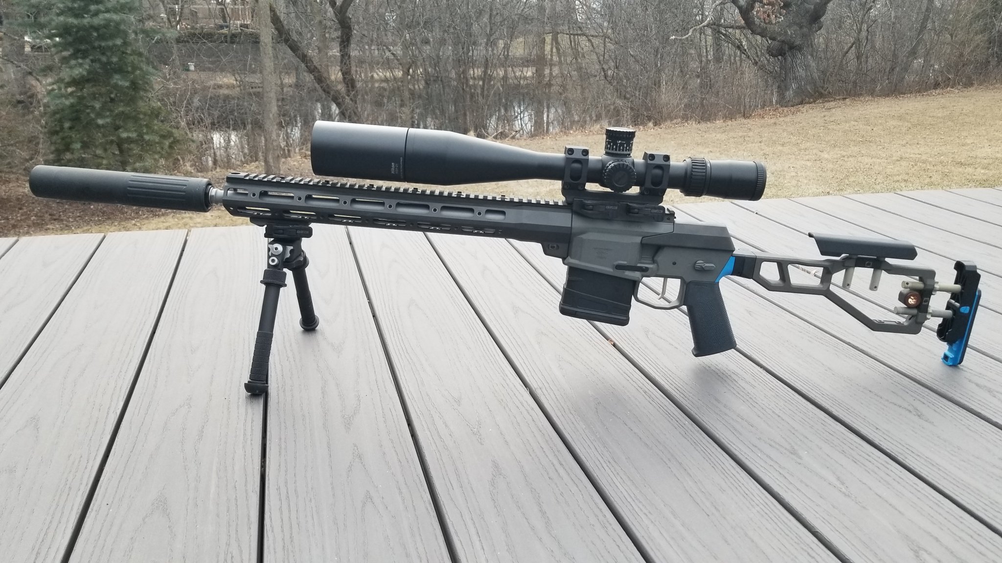

Just thought I'd post an updated picture. My Fix now sports a 24" Proof barrel and a Tangent Theta TT315M in a Gen 2 Aadmount and with Aadland caps. The whole setup unloaded, but with the Atlas bipod is almost exactly ten pounds.
After shooting it for a bit, I finally posted by DTA for sale in the PX forum. I am really getting used to the Fix. DTA is a great heavy precision gun, but I am really keen on using the same rifle for precision and hunting, so I am sticking with the Fix. I might end up selling my 280Rem Tikkad because of this thing also. Who would have thought that getting this gun would be so detrimental to my gun collection?

How do you like the 24" Proof? What caliber?
I'm in the same boat as you. I think the Fix kinda removes my need to have lighter weight hunting guns and heavier weight precision rifles. I've stopped shooting my heavies, and now just shoot the Fix and my .22's. We will see how long this lasts.
It is a 308. I might add a 6mm of some sort eventually, but I am kinda enjoying this one.
With the lancer hybrid and a bit of channel lock modification of the feed lips it would work.... ish but you had to hold it there so it doesnt really work in a practical sense. Wouldnt work with a hex mag or a p mag though.

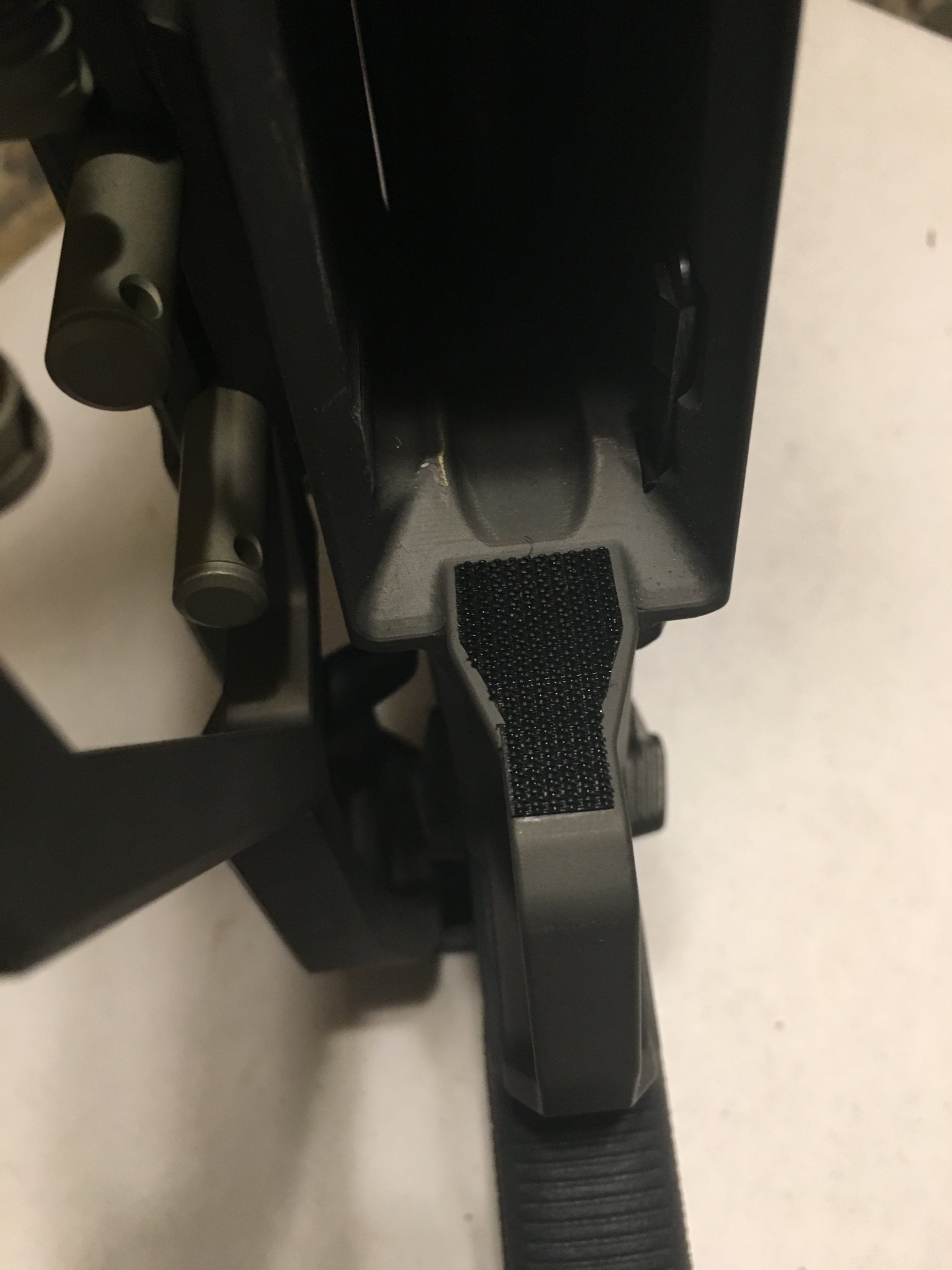

I need to figure out some way to modify a follower so that it will kick the nose of the round up higher but will still grab the rim of the case to run the action.
I decided on Kac mags for mine for the longer oal and more compact size. Mine is flawless with 10rds but 20s sat too low in the front and the nose would jam at the feed ramp. If I pushed the bottom of the mag forward it raised the front of the mag enough to work fine. I put a small piece of Velcro on front of the trigger guard and it shims the mag perfectly to feed right but still drop free.
It may be ghetto but it works. Not sure if my solution would work for you.
I'm shooting 143eldx at 2.85" fwiw
I will need to look into these KAC mags you are talking about. I might try that piece of velcro out. I am thinking i can modify the feed lips on that lancer enough. If it doesnt work then bummer out 40 dollars.... but thats going to be much cheaper than having all these 140 hybrids staring me in the face until i bring my 6.5x47 barrel down to texas.

Can you show a pic of that velcro? My Fix is flawless with 10 round mags as well, but with 20 or 25 it will not feed. Too low in front as well.
Could probably get by with less. That's just what I used. At first I was going to put it on the spine of the mags but figured it wouldn't last as well there. Compared to large frame ar's the magwell is fairly shallow so I guess that is why a mag on the smaller side can wobble so much.
Thanks very much. So the velcro is not specifically shimming the front (I was slightly confused about the placement and effect), it is more taking up some of the wobble slack. Is that correct? I will try it tonight.
Yes.putting the Velcro there takes up some of the slack and holds the front of the mag high enough to feed properly but the 10rd mags still work too. Doesn't have to be Velcro. It's just what I had handy and decided to try.

Tried a small piece of fuzzy velcro. Helped with the higher cap mags, but didnt competely solve the problem. May go slightly thicker and try again. My factory supplied 10 round mags work perfectly with all factory ammo I have tried. I have not tried any reloads.
I used the hook side rather than loop. Should work better.

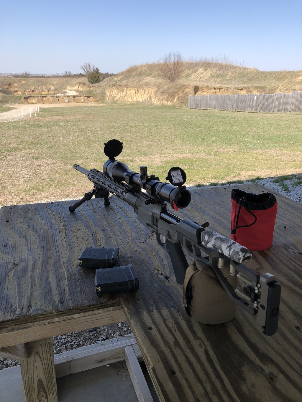

Another great day at the range today with The Fix 6.5CM, shot groups at 200 and dinged steel at 300. I made a little softer cheek rest which is nice for bench shooting.
