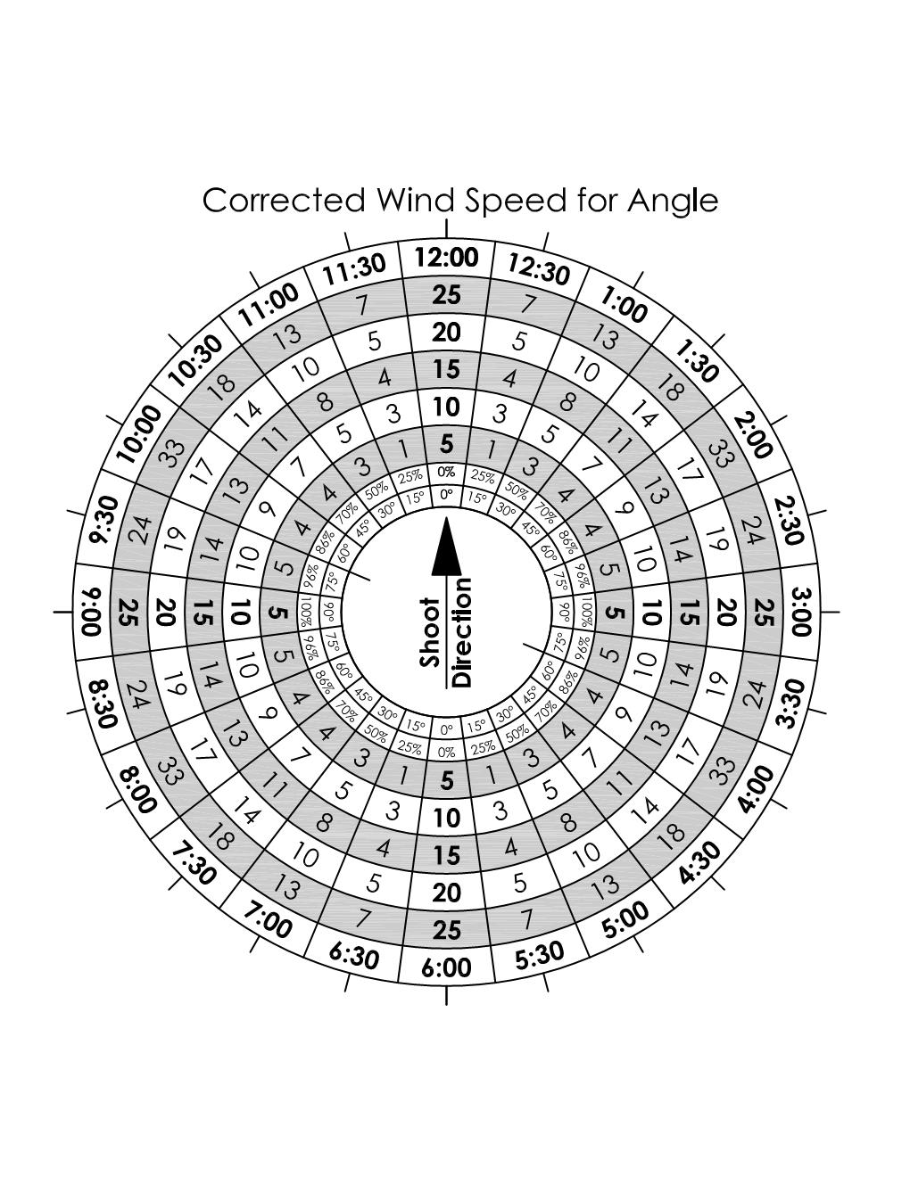

We used his charts during the class and the results were fantastic!
I highly recommend looking into this stuff if you want to be more effective

Can we get a break down of what each number and "zone" represents?

Is this a wind rose that is specific for Ted's rifle? Looks like a 5mph gun.
I know how the percentages and degrees work. He has it stepped out for every 5mph?

I wasnt referring to how wind Rose's work. Believe me, I ain't new to this shit. I was asking if it were filled out for his specific mph gun. I guess I should have asked it that way instead.

The percentage are there, you'd have to it make it for your rifle manually I suppose
This is just a 5 MPH Wind reference. But the percentage of center is listed so you can adjust it accordingly
What you really want is an blank one that you'd fill in yourself,
Or ask Ted to make 4 MPH, 6 MPH, as well as 5 MPH that covers quite a bit, I suppose he can go to 8 MPH for 338 and such too
NO

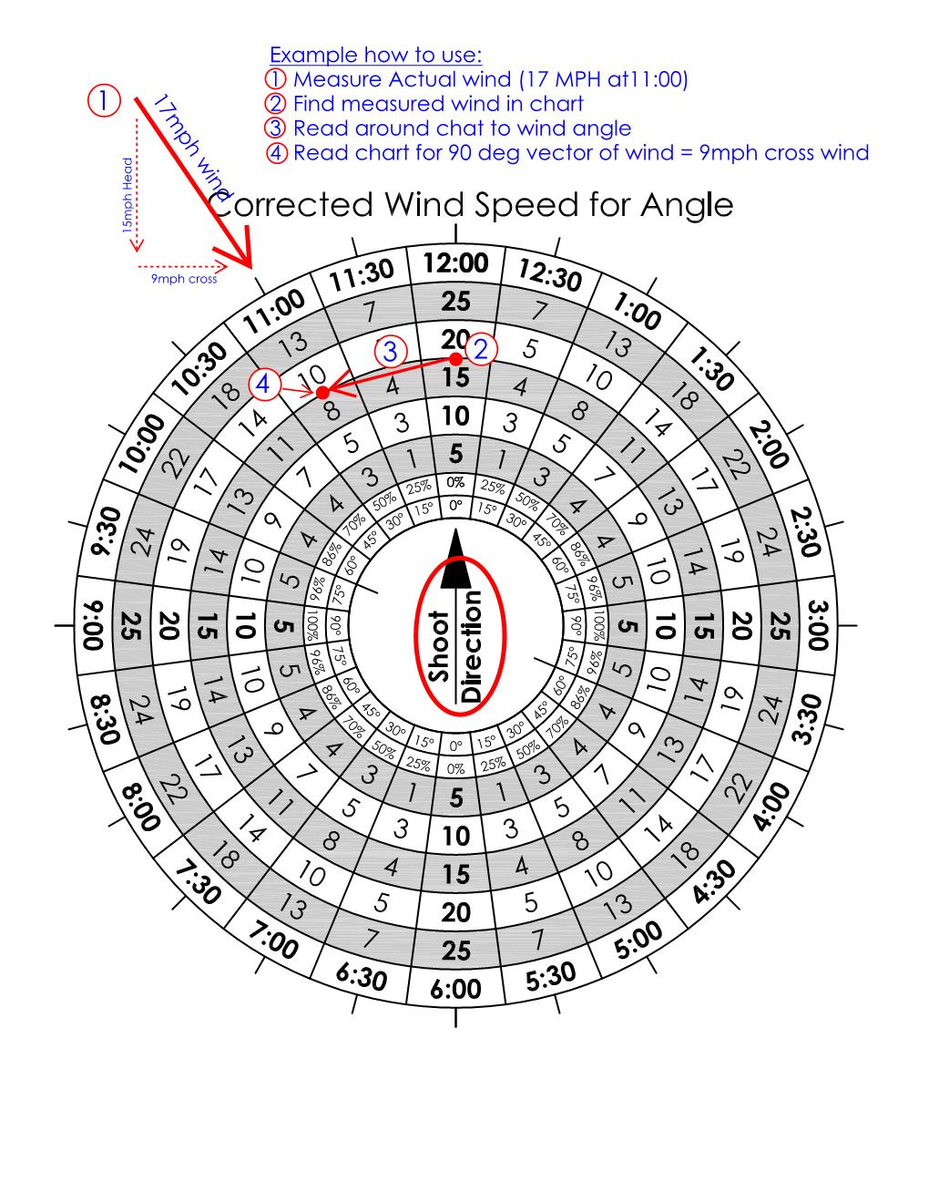

This chart is NOT RIFLE SPECIFIC! It is purely wind speeds and angle changed to pure cross wind value. Once you have your cross vector wind you must dope your rifle to this wind. In the example below you need to hold for a 9mph wind. Using the MPH method works well with this.

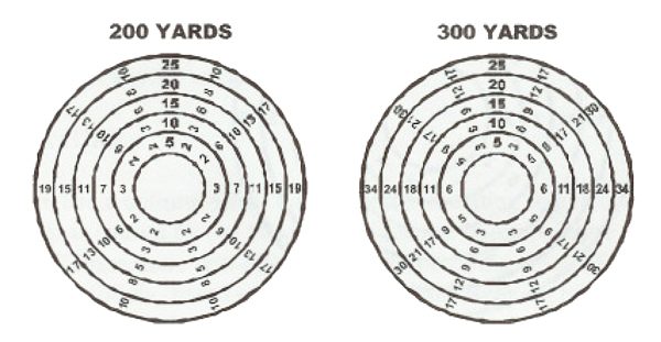

This rose is similar the old era rifle wind hold charts that were made for each rifle at each distance .... but its only wind speed. None of this is a hold value. Its a way to call wind speed more accurately.
Here is a how too
This is what I was getting at. I meant to ask if this particular wind rose was filled out for a 5mph gun. I know it applies to all cals and mph guns. I was asking about this picture in particular.
I'm going to fill one out for my 6 and 8 mph guns. Thanks
If you fill one out for a MPH gun you'll need to incorporate Distance in it somewhere. This chart is not distance related. It can be used at 200 or 2000 yards just to get the wind.
Here is an old style that had to have each one for different wind mph and range. The above chart does not do this. Its only wind direction.

Does that chart apply to all distances.
The percentages do. The numbers he has illustrated is for a certain distance.
This chart does not apply to distance or caliber. It is pure wind speed value.
Example - 20mph at 1:30 is a 14mph cross wind speed
The number in the center are for angle and percentage of used --> 20mph x 70% is 14mph --> 20 x Cos 45Deg = 14mph --> hold wind for 14 mph at 400, 600 or 1000 yards using your gun mile per hour.
Nice work but I believe there is a typo on the chart... Shouldn't the wind speed values corresponding to the 25mph ring at the 2, 4, 8, and 10 o'clock slots be 22 instead of 33?
This chart appears to have a typo on the 25mph 2:00, 4:00, 8:00, and 10:00 positions. Should that be 22 instead of 33?
BTW awesome chart. I’m finally getting serious with learning wind and this is a great tool!
Check this thread out. Its corrected over here
