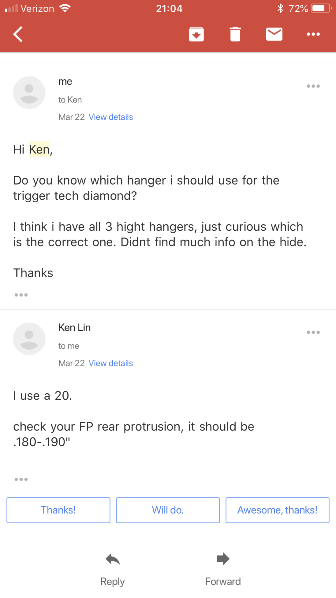

I’ve got a diamond in mine. Using the 20 hanger, no issues so far. Just check FP protrusion, should be between .180 - .190. (Mine sits at .185)
Thanks for the update. TT will not work with any of the 4 hangers in mine. I'll order another set of hangers from GAP tomorrow in case they made changes/improvements. The first hanger that came with my Tempest (very early serial number) is cut very different than the other 3 I ordered later on. As it is now, the firing pin releases when the bolt closes with any of the 4 hangers. Hopefully new hangers will fix this. Thanks for the info again. Glad to hear it's possible with a TT Diamond.

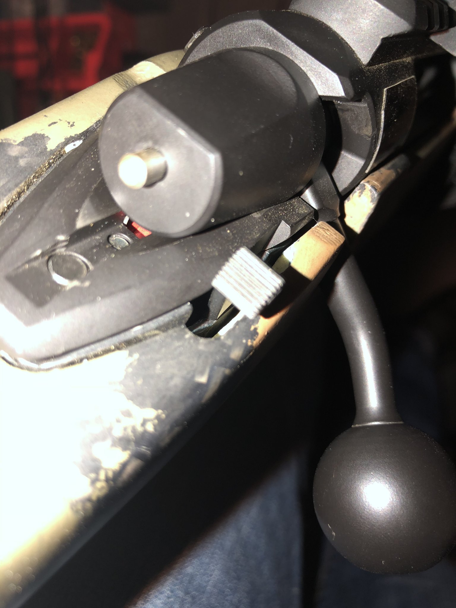

I did have to file on the mini chassis a bit to let the safety travel the whole way

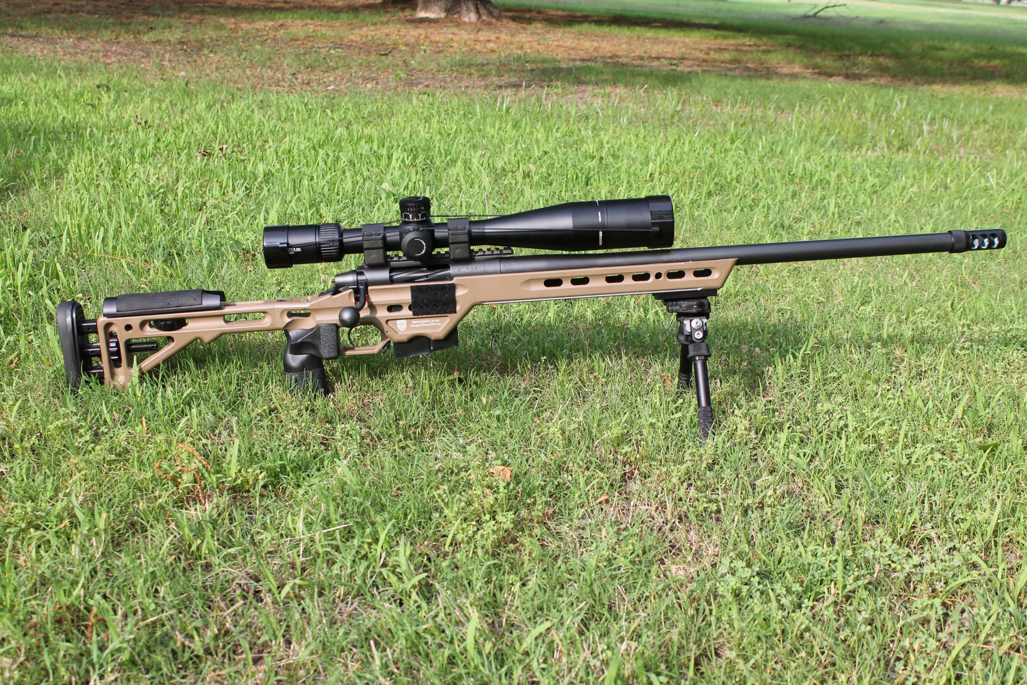

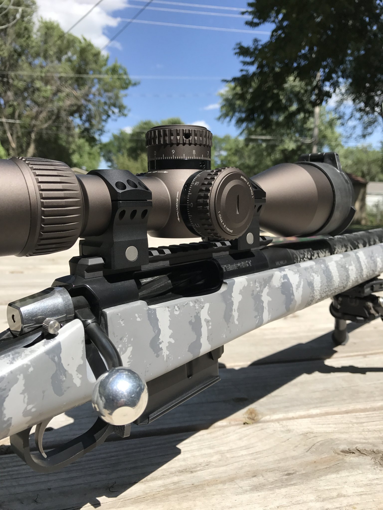

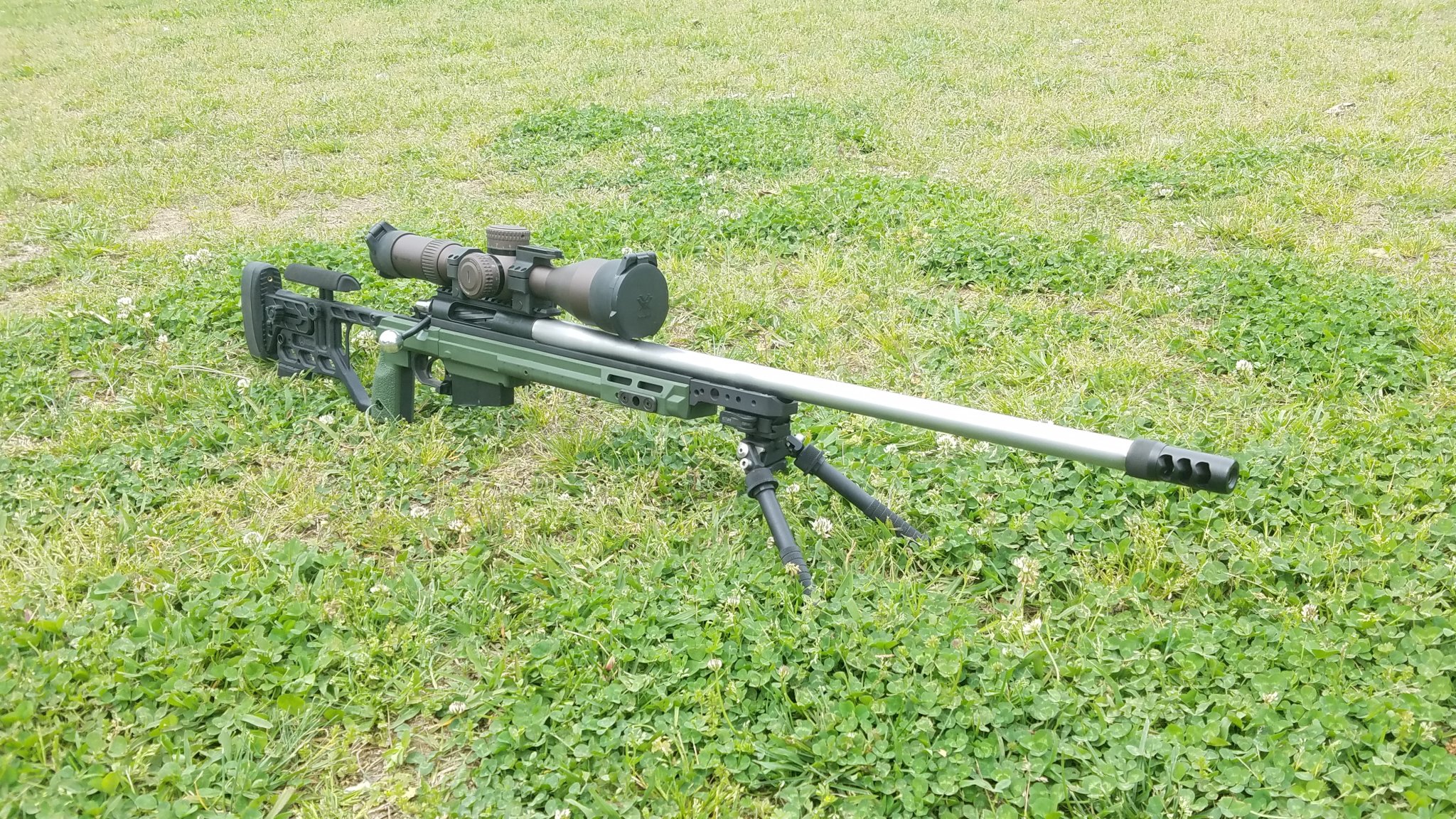

Finally put her together.
26" mullerworks 7.5 twist
6.5x47 lapua .167 freebore
Krg whiskey 3 gen 6
Area 419 hellfire brake
Badger m40a3/5 rings
Vortex razor g2 4.5-27x56
Bix'N Andy TacSport single stage
Only shot 3 test rounds out of her but damn....that hellfire brake is something else. Recoil feels less than my brake 19lb 6creedmoor. Was spotting my hits at 150yrds.

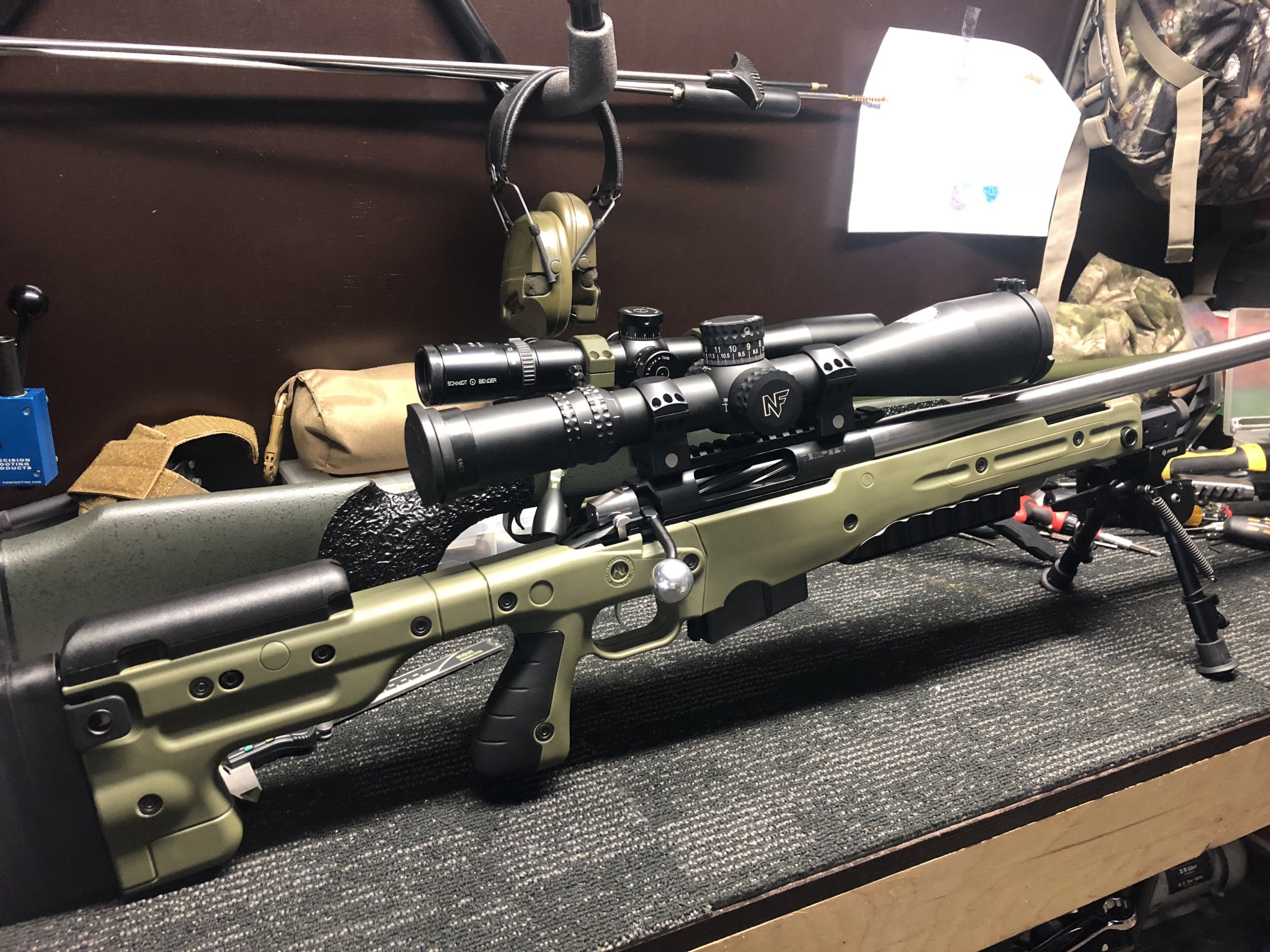

Got off the phone with GAP. After working with several of their guys over the last week (ALL very helpful), they passed it to George. Sounds like I have an early TT Diamond with a .028 sear drop, which they did to mirror the B&A sear drop on early diamond models for increased lock time. The COA's are use the B&A trigger hangar which is basically a .020 hangar with a .028 shim to get the sear to the right height, or to call TT and swap for a current model with the standard Rem 700 sear height. Just wanted to pass along for anyone else trying to run a TT Diamond and having issues. Take it with a grain of salt...have not spoken to TT about any of this. I went with the B&A hangar route since I have multiple triggers in this same boat.

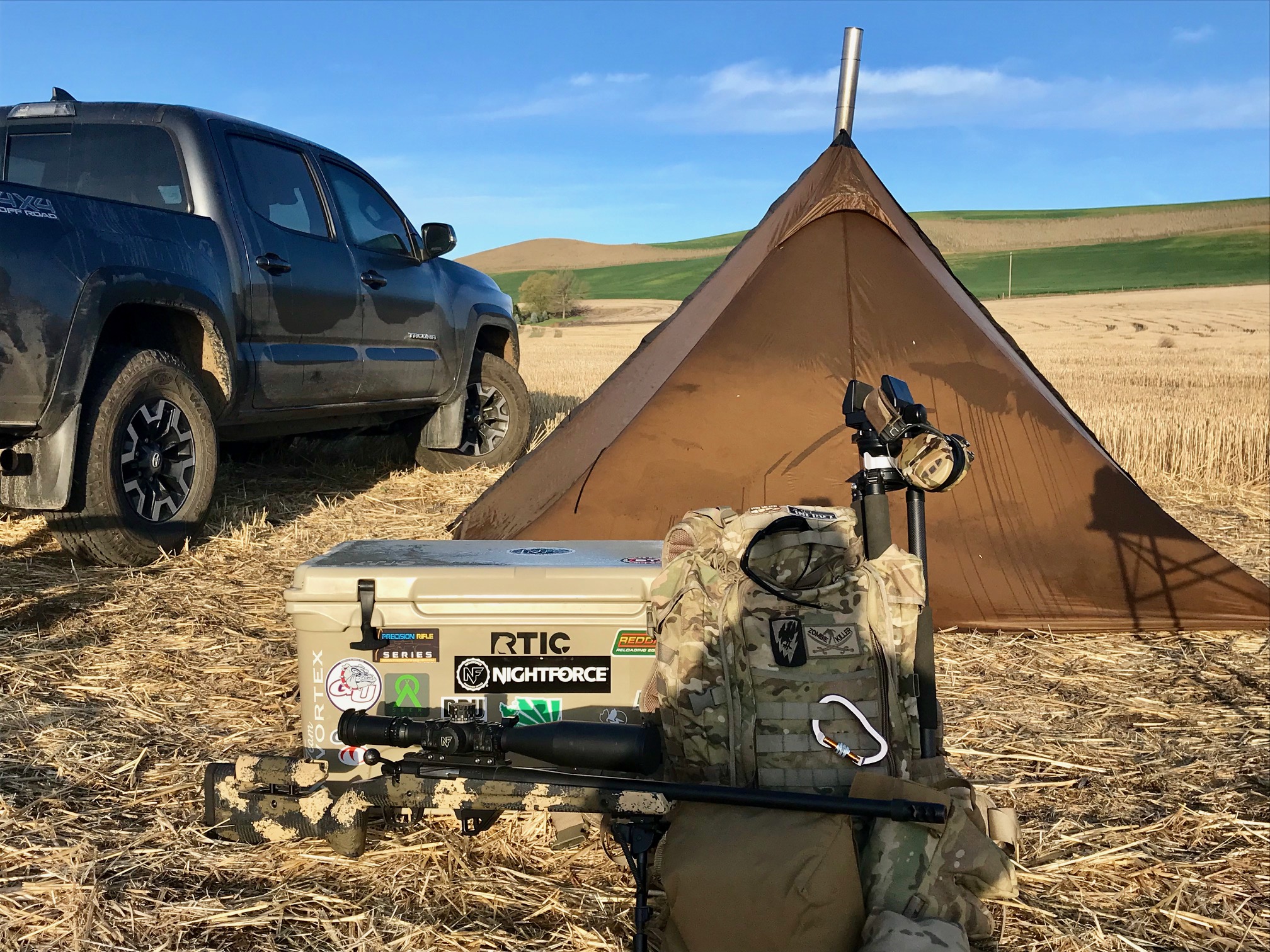

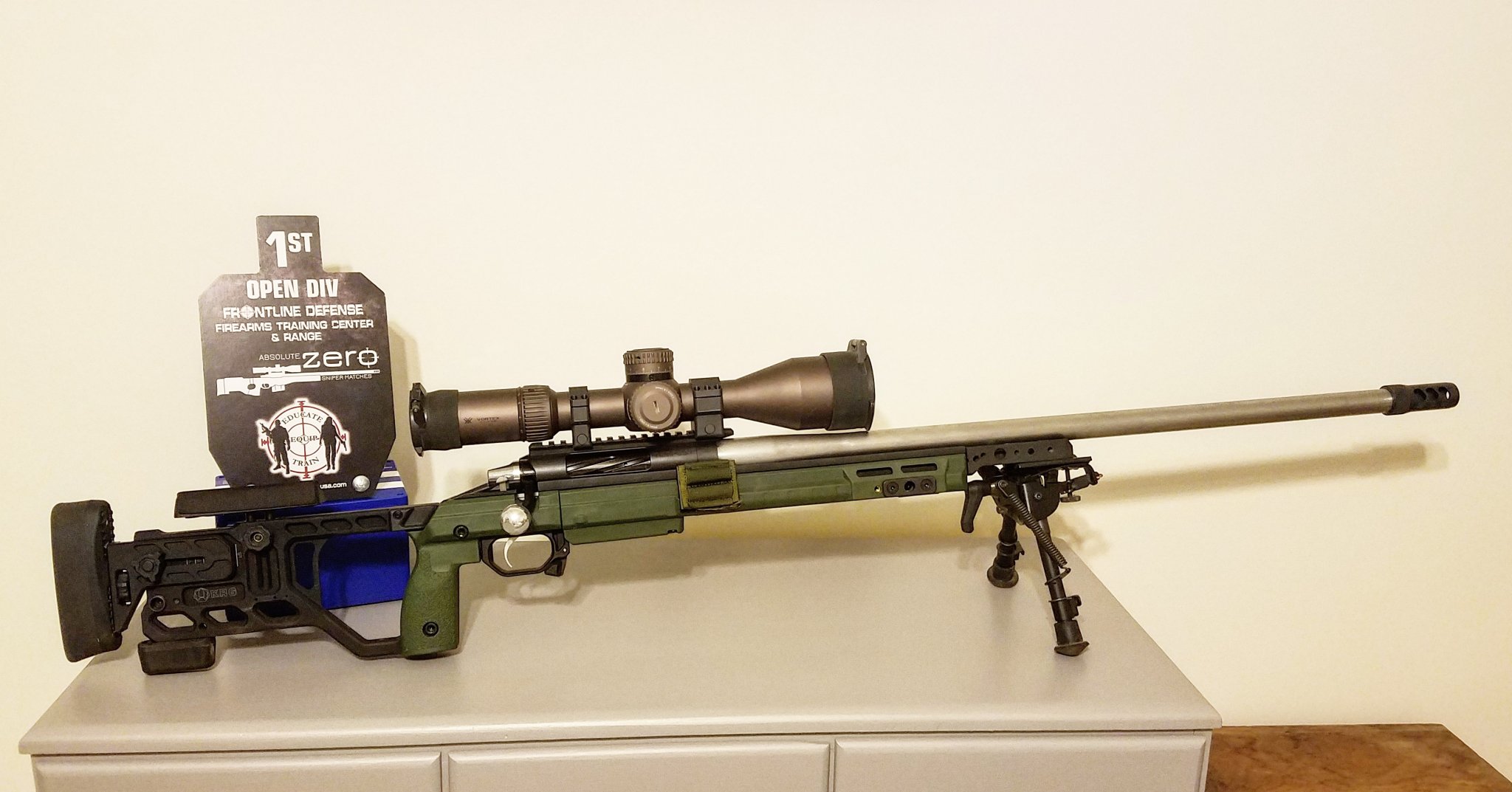

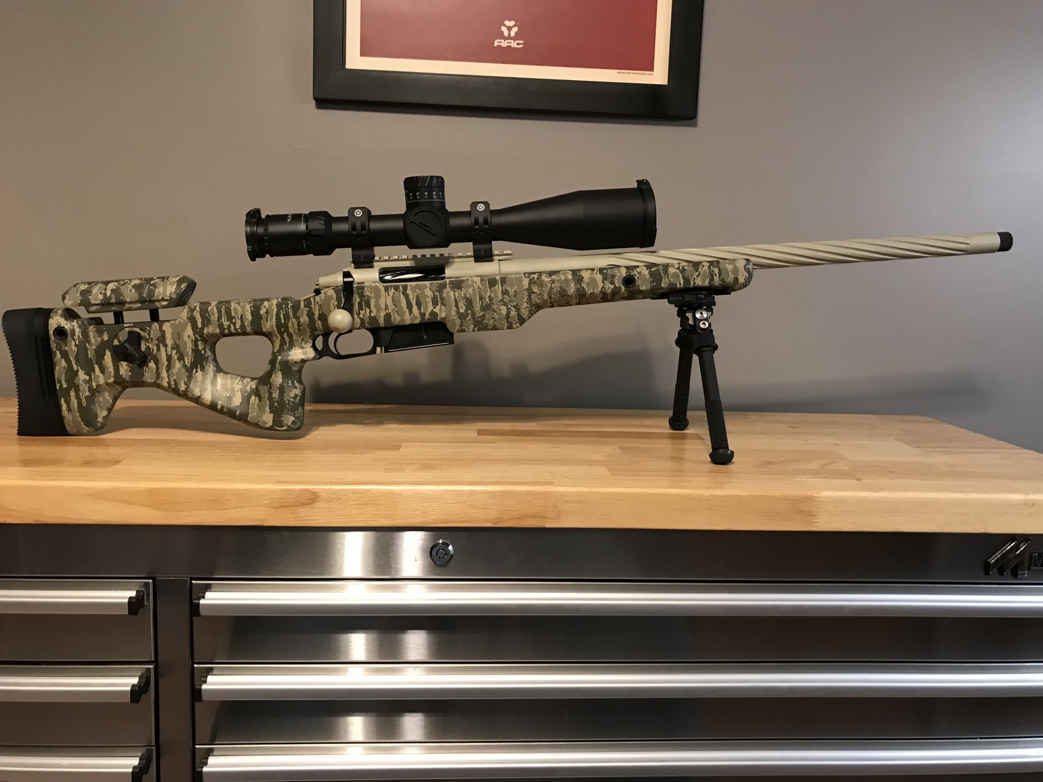

Update to my post above, the B&A trigger hangar was perfect for the TT Diamond version that I had (the one with .028 lower sear). Finally, my Tempest is running the way I want it to.
On a positive note, there were 3 Defiance and 1 Surgeon in camp with me and we all spent a lot of time on each others gun working the bolt, dry firing, etc... and every one agreed the Tempest had a significantly easier bolt lift. It was at least half, we were very surprised. Their smiths told two of them not to get the Tempest because the lift would be so heavy being 60 degree throw. They were frustrated for sure after feeling it. Granted, my Tempest has a lot of rounds, cycles, dry fires, and polishing done to it. We tried to measure the pound lift but batteries were dead on my trigger pull gauge.
Anyway, this thread rocks. Appreciate the help along the way. Tempest picture included. Specs in sig.

George told me you can tell by looking at it on the side profile. It should be basically just above the red aluminum. If it's even or below, it's probably the dropped sear version. But, if yours runs it is probably the rem 700 standard model. Mine would drop the firing pin as soon as the bolt closed until I put in the B&A hanger which is essentially the .020 hanger with the sear offset built in as well.

Mine doesn’t drop the firing pin. Though I’ve just been dry firing it. The barreled action is laying on my bench. Probably let my brother use it in his MPA while we wait on his build and my PRS2 to be done

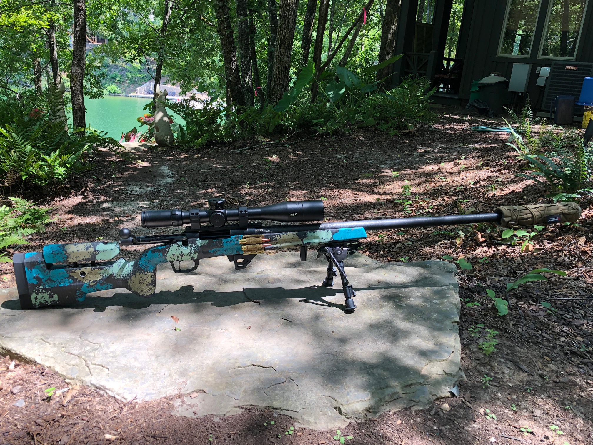

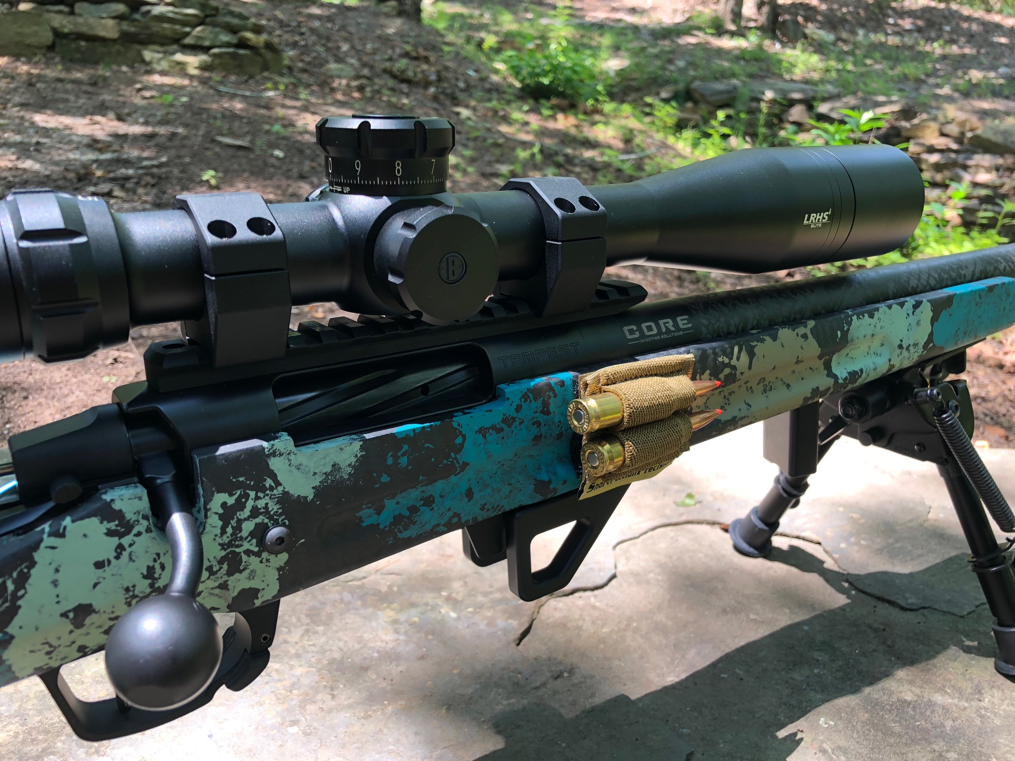

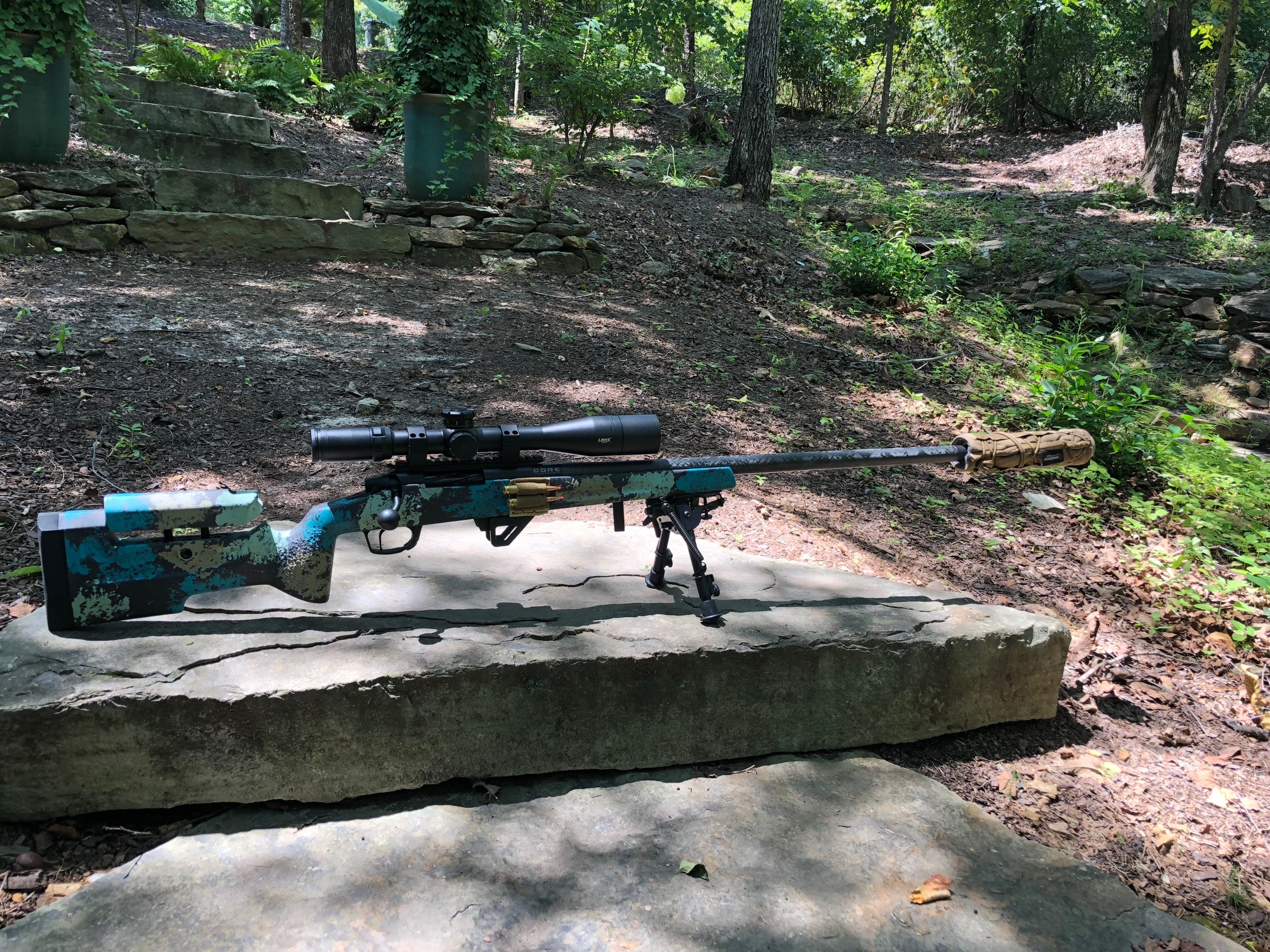

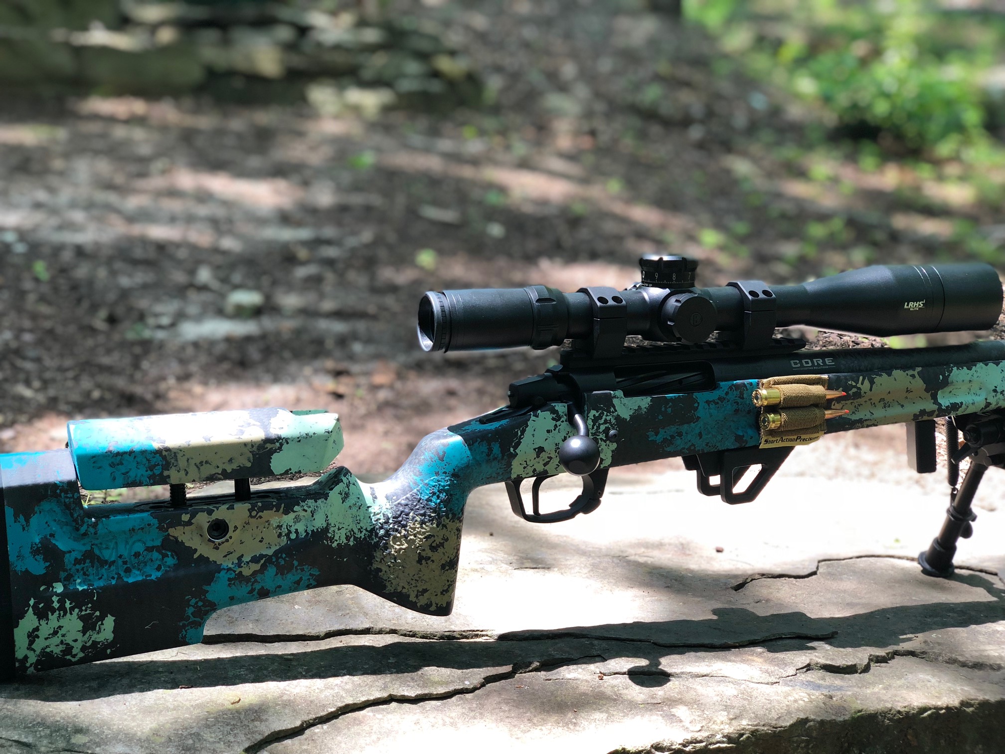

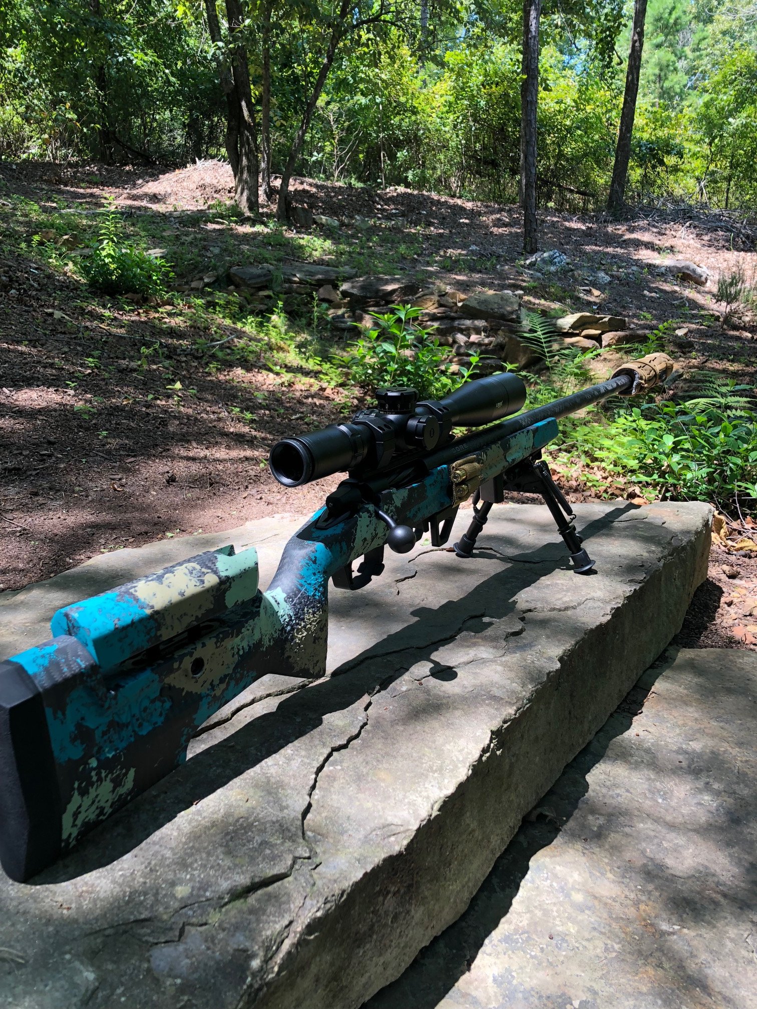

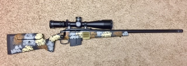

Finally got to the range to run and sight in the tempest!The weather wasn’t playing fair, off and on light misty rain but I’m really pleased it shot some great groups with factory FGMM 168 and 185 jugs.
704885F7-7798-4299-805F-F75357960EE2.jpegB407B1F1-F2B2-438D-B1E7-8965BB7C2B4A.jpeg585FDE3F-60F7-4CFE-A532-585DF7F4CC5D.jpeg
5 shots@200m
