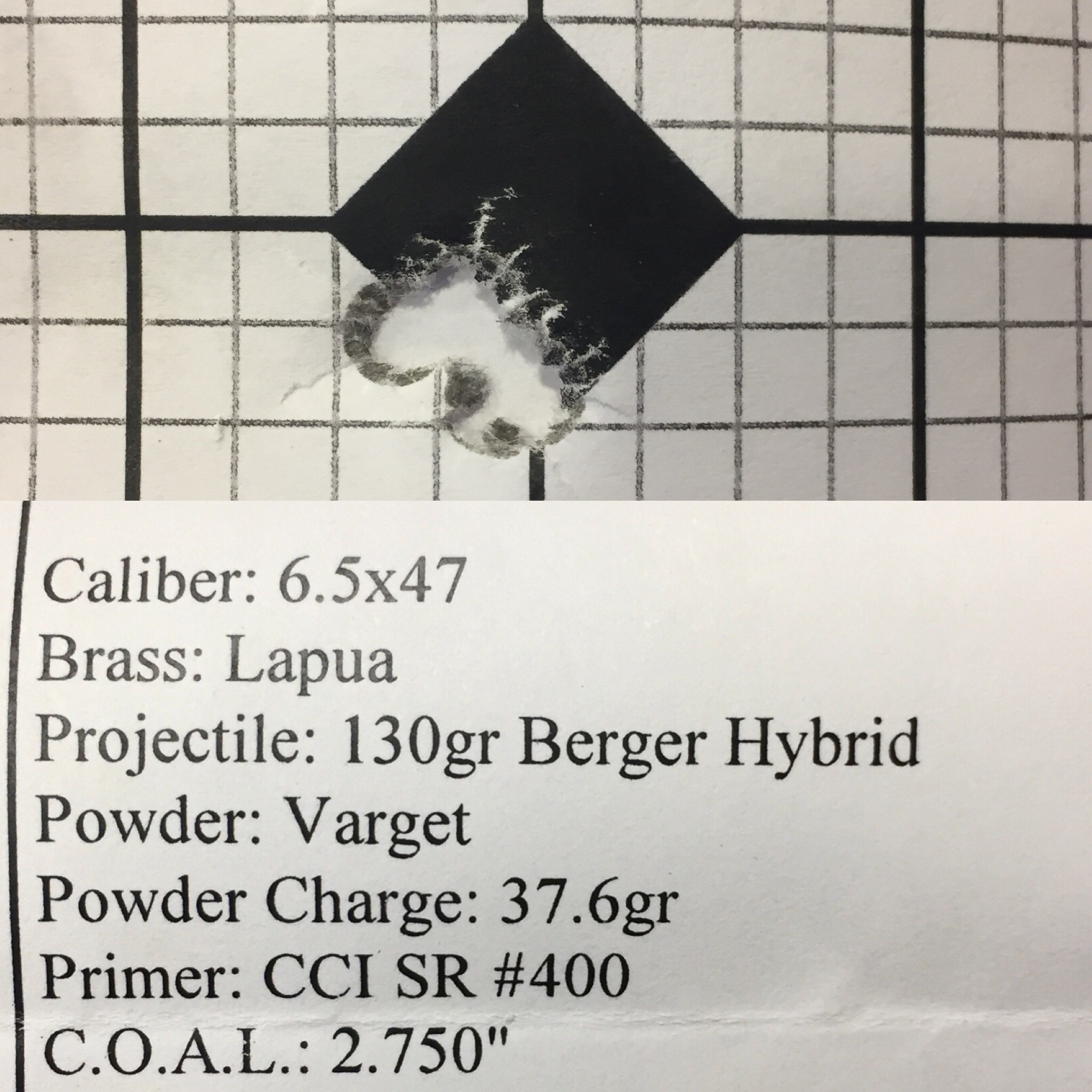

130gr hybrid is no joke. Gun still hasn't missed a beat. Though it needs a thorough cleaning and maybe a trigger change. I like the BnA but been itching to try a Huber.
[IMG2=JSON]{"data-align":"none","data-size":"full","src":"http:\/\/i64.tinypic.com\/ri5bmx.jpg"}[/IMG2]

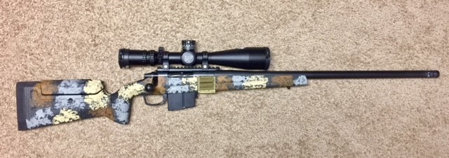

Well...to help the thread out..
Ive decided to sell my AX and build a dedicated match rifle again. Been craving a tempest ever since I sold my first so the decision was east. Im impatiently waiting for my reamer to come in so I can fit this damn barrel and finish my build.
Tempest action
Mullerworks 7.5T .264 cal marksman (cut to 26")
6.5x47 lapua, .295 neck, .167 freebore
Area 419 hellfire brake
KRG whiskey 3 gen 6 (sako green)
Bix'N Andy tacsport single stage
Vortex Razor G2 4.5-27
The waiting is killing me for this reamer........

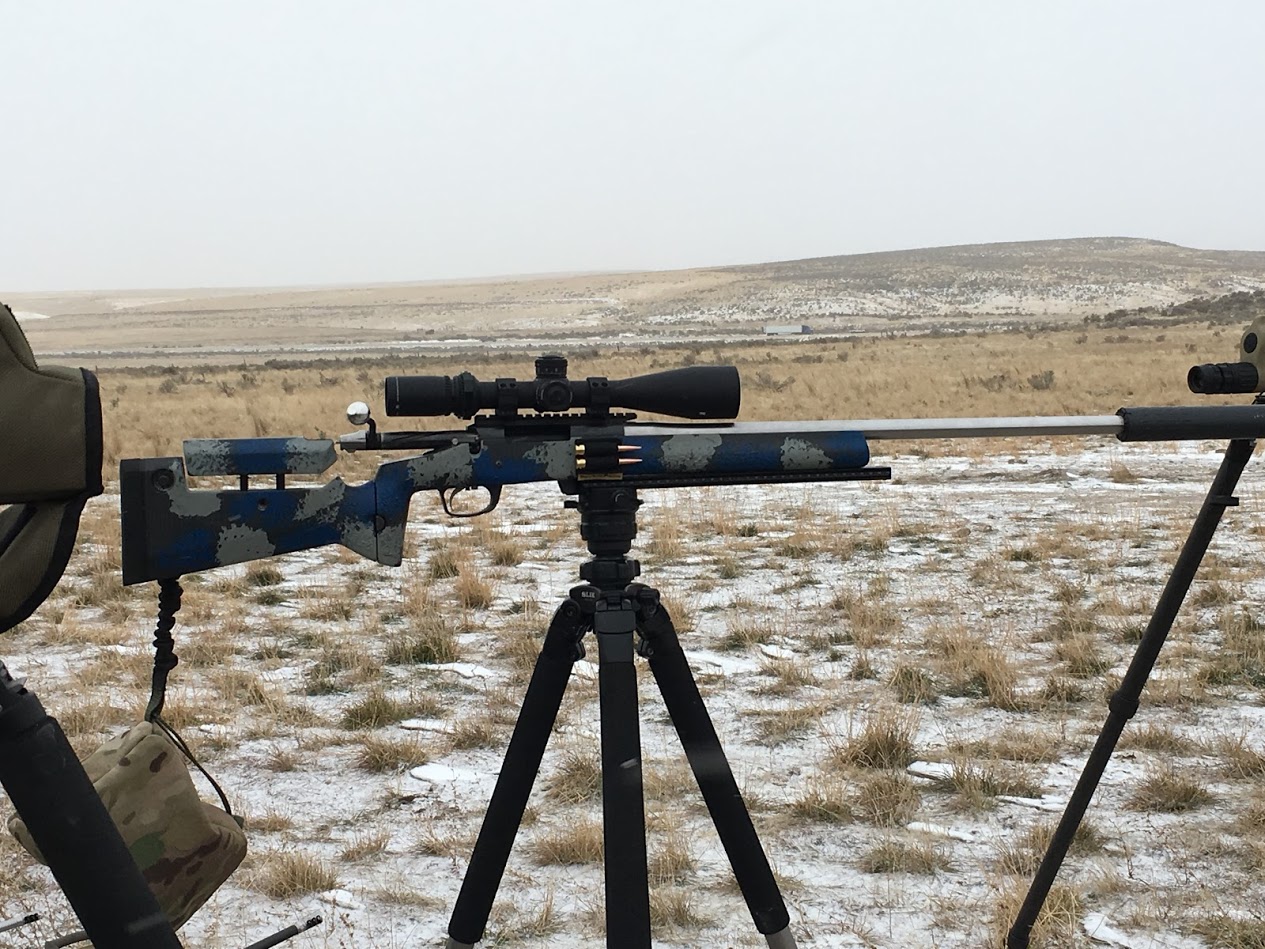

I've had this for a bit, but haven't been on the Hide due to deployments etc.
Tempest Action
24"1:8 Proof Stainless
Jewell HVR @12oz
6 Creedmoor (sorry I'm not a smith, don't know reamer specifics)
Manners T3FA
SilencerCo Hybrid
Vortex AMG 6-24
I might switch to a brake if I can find one I like. The Area 419 threw me off target with each shot so that got sold after the first match. I have a friend that makes one called the BFF and I have tried it a couple times but when I return from NCO Academy I plan on trying it during a match and see how I like it.

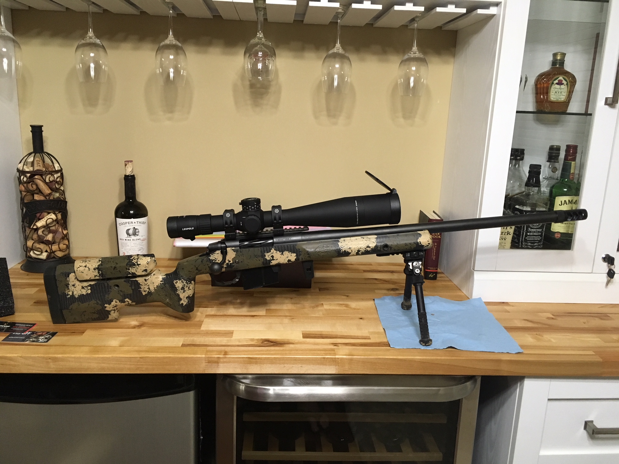

Built by American Precision Arms
GA Precision Tempest Chambered in 6.5x47 Lapua
Manners PRS2 W/ Gen 2 Mini Chassis (AW Mags) Badlands Camo
Bartlein 26" Medium Palma 1:8’ Twist
APA Little Bastard Brake
Timney Calvin Elite Trigger (24oz)
Nightforce ATACR 5-25x56mm F1 MOAR Reticle
Nightforce UltraLite Medium Rings
Accuracy First Scope level

It was the only color CORE had at the time so I snatched it up quick! Very happy with the color choice though. It grows on you!
Certainly does i really like the CORE exclusive patterns. I really like the elite highlands though they don't make DLC in OD green or greenish/brown which is what i thought would've gone well with it. So i'm going to just go black, also have a proof blank for a 7 SS for the same action so black seems accustomed to it.
