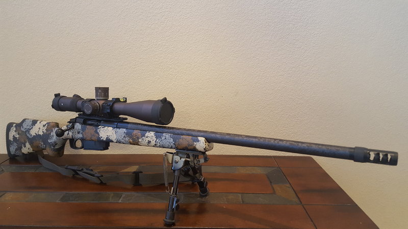

Well now that its back from getting the coating fixed, the action and bolt honed and polished it now runs buttery smooth.
Specs: 24" Benchmark 1/8 spiral fluted barrel with APA Lil'Bastard, MPA Comp BA chassis (most recent version with full RRS cuts) in burnt bronze, 0 MOA rail with 30 MOA Sphur mount and SB PM II.

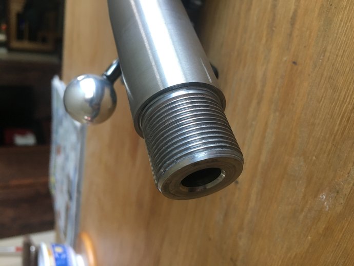

I'm a big fan of generous chamfers on my barrels. Some smiths do seem to go very minimal in general. The tempest print is pretty specific about it though, so i did mine exactly as it shows. Seems to feed fine in creedmoor.
Apr 10, 2017
285
11
18
Here's a pic of my barrel/chamber/chamfer IMG_2048.JPG
Sep 6, 2006
2,166
284
83
Southern California
It looks right to me. On the cases that bind, is there evidence of it on the brass?
The two i've done look the same as yours.
[IMG2=JSON]{"data-align":"none","data-size":"full","src":"https:\/\/uploads.tapatalk-cdn.com\/20170825\/1ff4da6c0054de451a9ce6e6ccf2e185.jpg"}[/IMG2]
Sent from my iPhone using Tapatalk
Apr 10, 2017
285
11
18
No evidence of any markings on the brass since day 1...that's why its taken me forever just to figure out what/where the bind actually is. I just blew up both pictures sideXside, and the only difference i can see is that perhaps you've sanded/blended both inside/outside edges of the chamfer...is that right?
