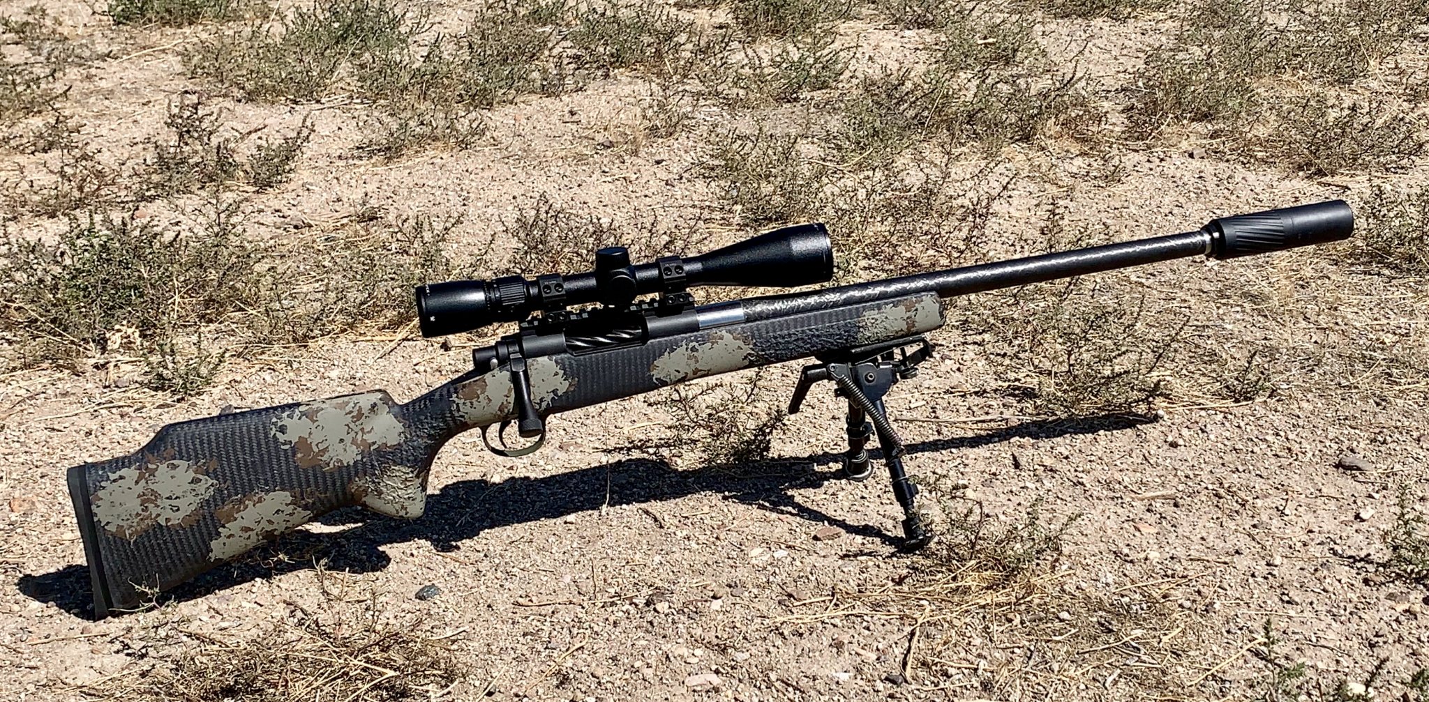

It’s a straight neck down to 6 with no other changes. 21” Krieger.

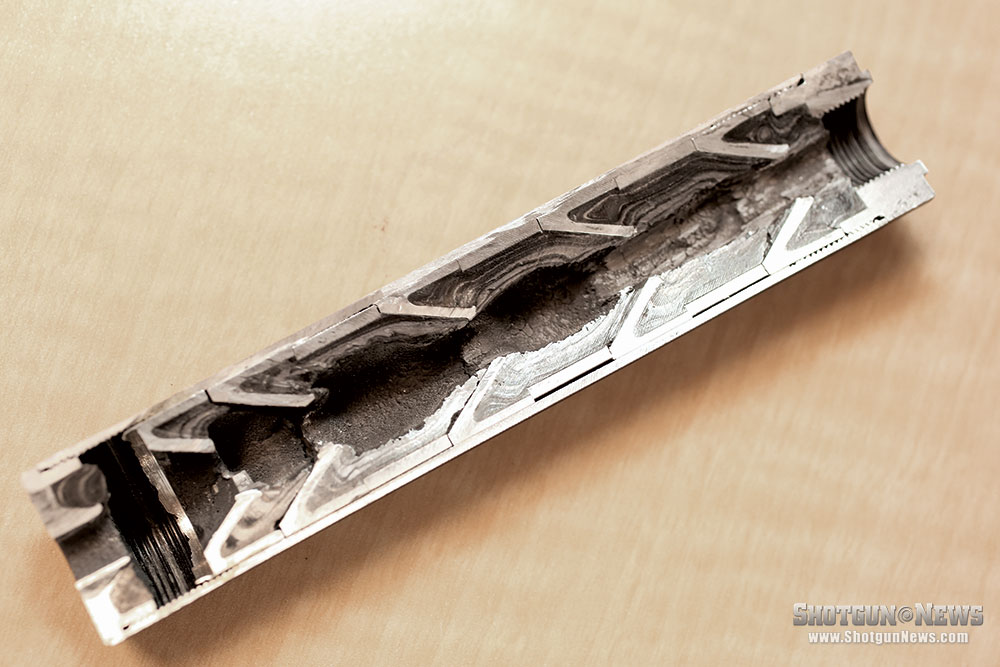

Is the recoil reduction any better with the brake mounts?
When the can is on, the brake is covered. The only difference in the Tbac direct thread cans vs the Tbac CB brake cans is that the direct thread has the CB 'permanently' attached. (Changeable by factory only).
The cans have the same effect when mounted.
Pictures taken from Google image search.
Yes this is a direct thread can but it works for illustrative purposes. The bullet moves from right to left. It attaches to the barrel by the threads on the right side. On brake attach cans the baffles of the brake are inside the can past the end of the threads. All of the gases of the brake are contained in the can and all of the gases go through the front.BOTLRR-8127.jpg

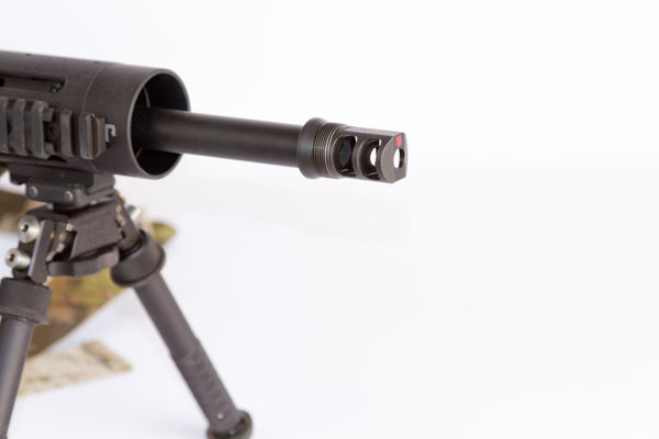

For a more relevant image, a CB brake. When the can is attached it mates and seals up on the taper behind the threads. The baffles are inside the can.

^^^That's not a suppressor, that's a weighty barrel extension!
Did a search for sectioned suppressor. The picture tag said something about cleaning your suppressor. Most sectioned pictures of cans that I've seen are to show how dirty they are.
