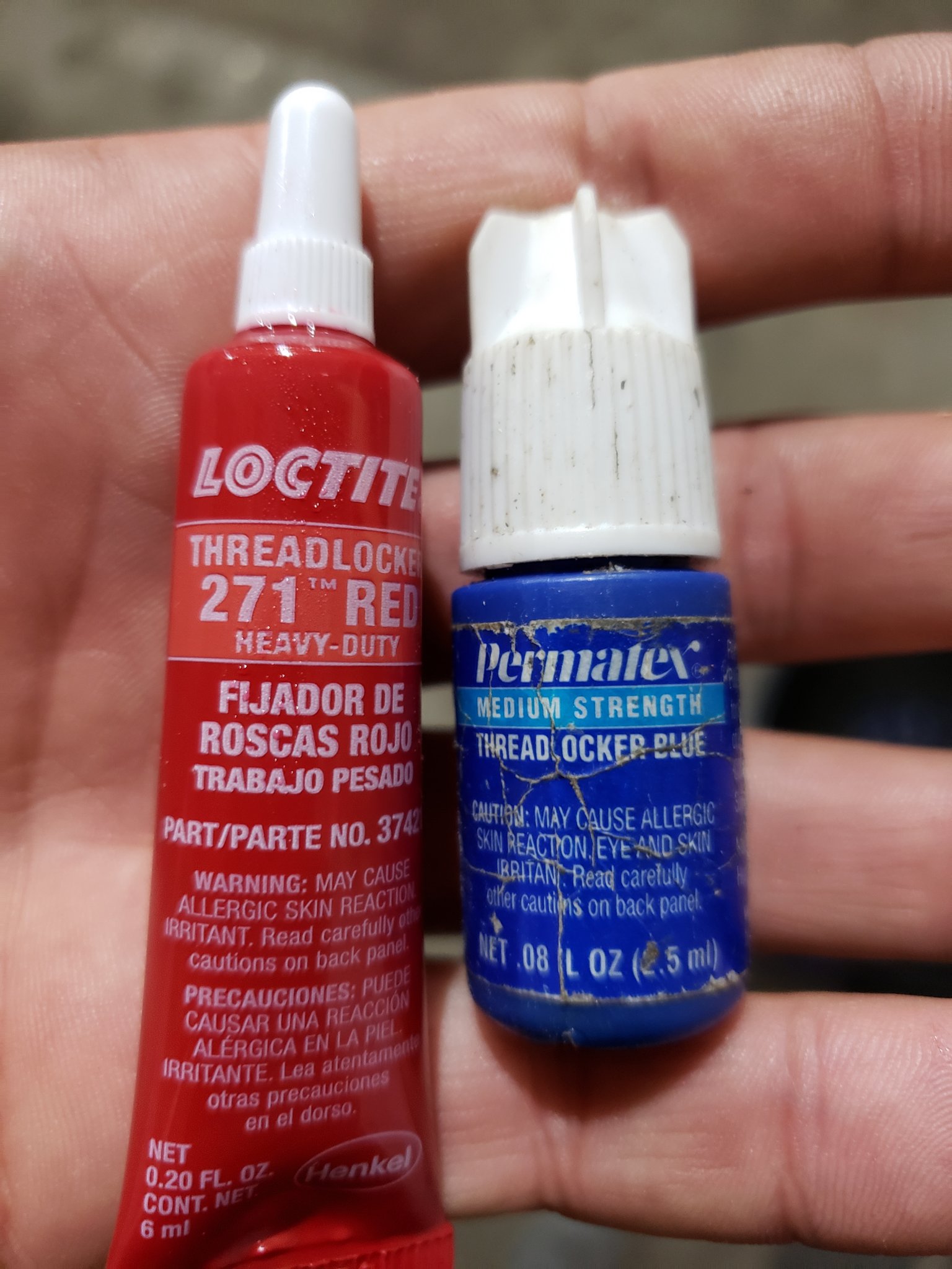

Just as point to OP: I have a TBAC Ultra 9 that swaps between 4 rifles. If you plan on removing brake frequently, make ABSOLUTELY sure that you mount your CB brake properly with Red loctite (271 300 deg stuff or 272 which is slightly higher temp at 450deg) before you start shooting and testing it out.
I tried spinning my can off a bit too early and mounted CB brake with blue loctite (wrong product) and it ended up spinning off brake while can still mounted.
I tried securing again with Rocksett but it still torqued off brake (takes forever to cure). Long story short, I had to remove can/brake, red loctite 271, wait overnight, then can spun off correctly with brake still on rifle. Then I had to retime the brake and remount correctly (which is a bit of a pain with red loctite).
So do it right the first time with all rifles that will have a CB Brake and you shouldn't have issues. If you cut corners (like I did) it will likely bite you when it is least convenient. The red stuff is TOUGH.
Should have followed instructions better (and had better self control over my enthusiasm to start shooting can).
I have used Loctite 242 blue and never had a problem with my breaks coming off with the suppressor? How hard are you torquing your suppressor when you twist it on? I'm just tightening hand tight, basically spin it until I meet resistance and give it a little extra oomph at the end but nothing major.

I have used Loctite 242 blue and never had a problem with my breaks coming off with the suppressor? How hard are you torquing your suppressor when you twist it on? I'm just tightening had tight, basically spin it until I meet resistance and give it a little extra oomph at the end but nothing major.
I do the same, hand tight plus a smidge. But I pulled a rookie mistake and tried pulling off can while it was warmish and holding power of blue gave way. It's a fairly new can (about a month or so) and has about 300 rounds through it.
My guess is that the threads of the brake and/or suppressor were a bit dirty with carbon from the 6.5 bolt gun, and, when mounting to the 224V semiauto, it locked up just a bit too tight. Couple that with a bit of heat (15-20 rounds over 5-10 minutes) and it came loose when I tried removing while it was warm to touch (maybe 90-100 deg?). Same thing happened early on with my 223 but I let cool again and it came off normally.
Also possible that I had undertorqued the CB brake when I remounted it a few weeks ago to add the blue loctite.
My other three guns have held well so far with blue BUT I've let them cool 100% before attempting to remove can. It's more a peace of mind issue than anything else. The can seems to cool much much faster than barrel and brake, so it's easy to get fooled that the system has cooled.
And I just noticed my "blue loctite" isn't actually Loctite brand... It's Permatex. That could be why it failed. Or it was too old.
Now I just know to buy the name brand product and maybe it would have worked better but who knows.

Just now about to install- got a stupid question.....directions say fh may be installed untimed or timed so that flash pattern is minimized to shooter’s view. Is it much of an issue or do most just run it untimed since that seems to be one advantage of the fh?
Also I’m lefty but assuming that would have no bearing upon timing to minimize flash to shooters view (i.e. objective is to minimize flash at 12:00 position so indifferent to righty or lefty shooter)....?
I just add a drop of thread locker and torque to 30lbs. It’s extremely rare that I shoot without a silencer attached so I’m not concerned about the flash pattern.
