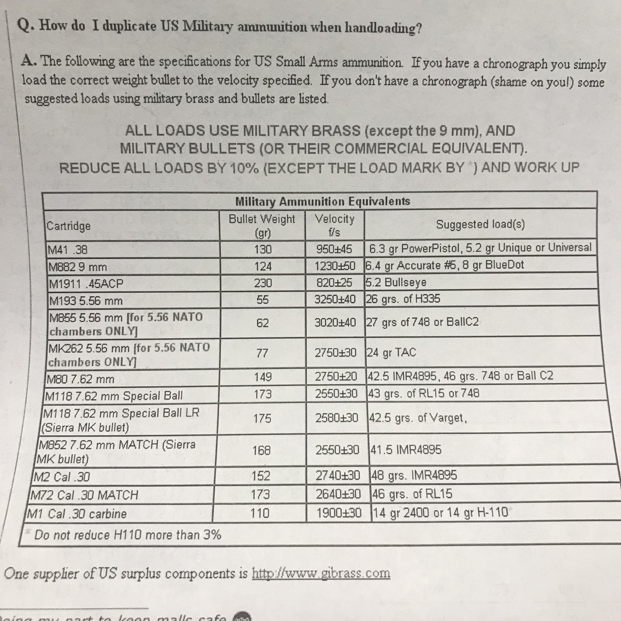

I understand TAC has a load that replicates MK 262 really well. I believe rth1800 loads it and if you pm him he may help you out.

Believe a previously published 262 load was 24.0 TAC and a 77gr Sierra BTHP. I ran 24.0 and 75gr Hornady BTHP with success until I tried 8208, which also performs very well in 308 with 155gr bullets of various persuasions, and an alternative to CFE223 in 6.5 Grendel. Keeping powder inventory as standardized as possible.
