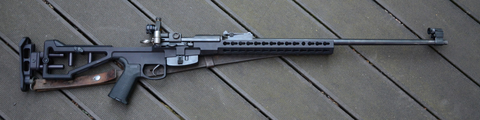

Did any aftermaket 10 round mags come about for the K31?
Not that I know of. Stgw57 mags cannot be easily adapted, as they don't fit the opening in the K31 receiver.
There were a couple of more or less clumsy attempts to make a "Frankenstein monster" by joining the K31 mag top with a Stgw57 body, but nothing even close to market-ready.

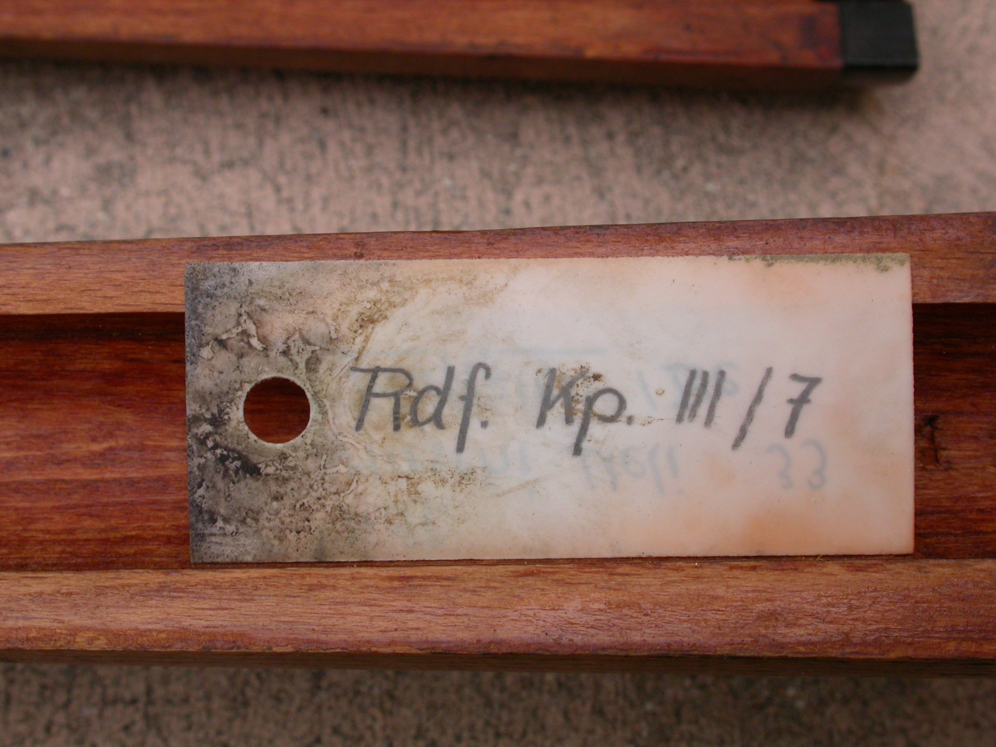

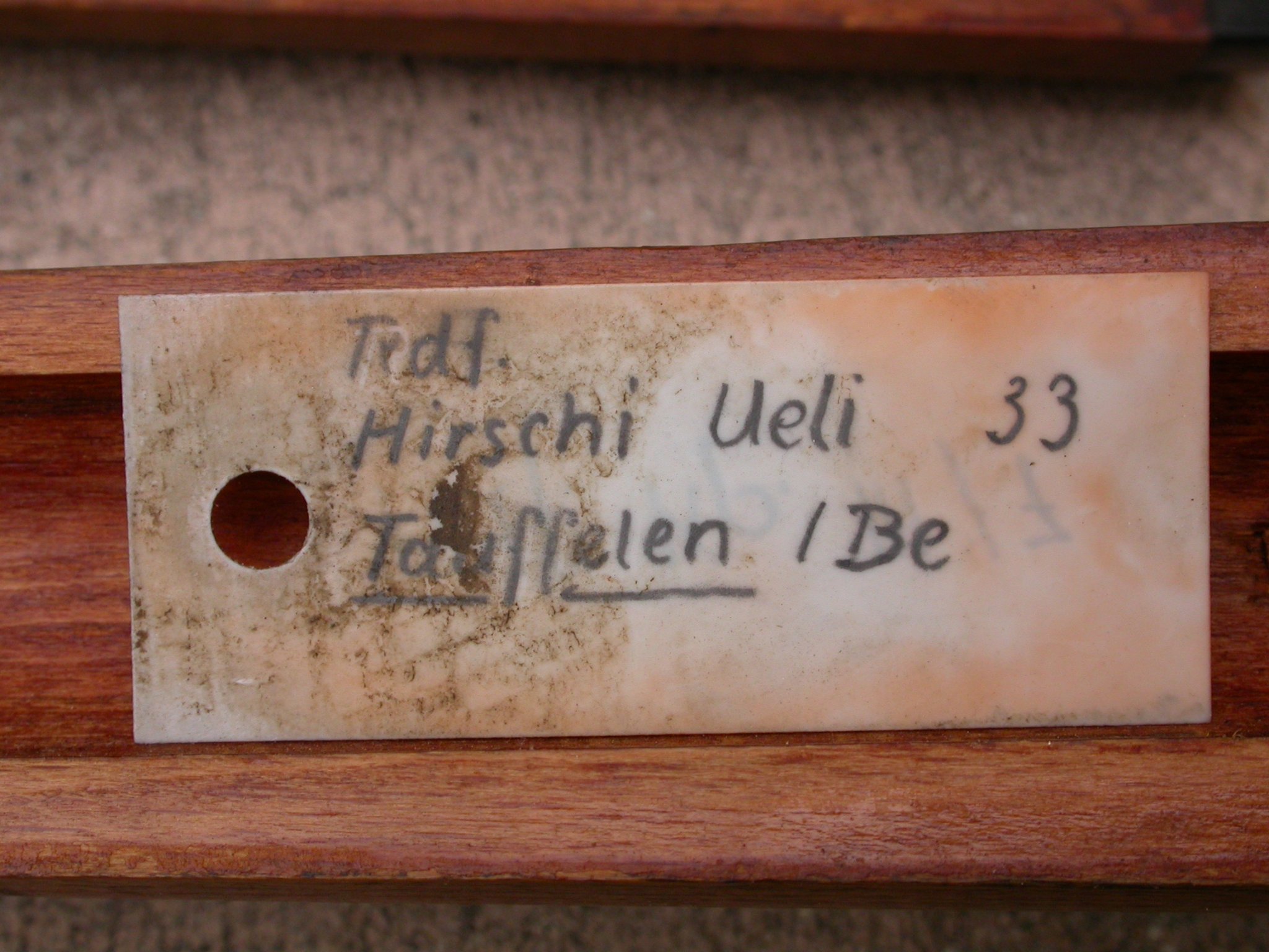

I acquired a K31 back when they were selling for ~150. It had a "card" with the last soldier's information; sent a letter but did not receive a response

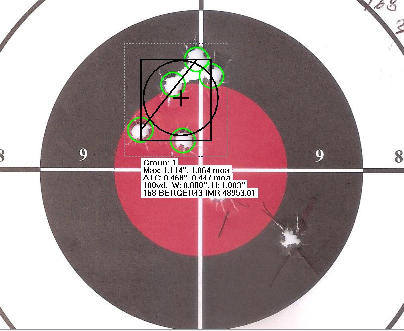

This year I installed an old Bausch and Lomb 4200 6-24X using a no drill mount ST Marie.
It does well with Berger Bullets and 43 Gr of 4895; 2570 fps, SD 6.1 Brass: Grafs; OAL 3.01
As others have commented, once the barrel warms up the dispersion increases.

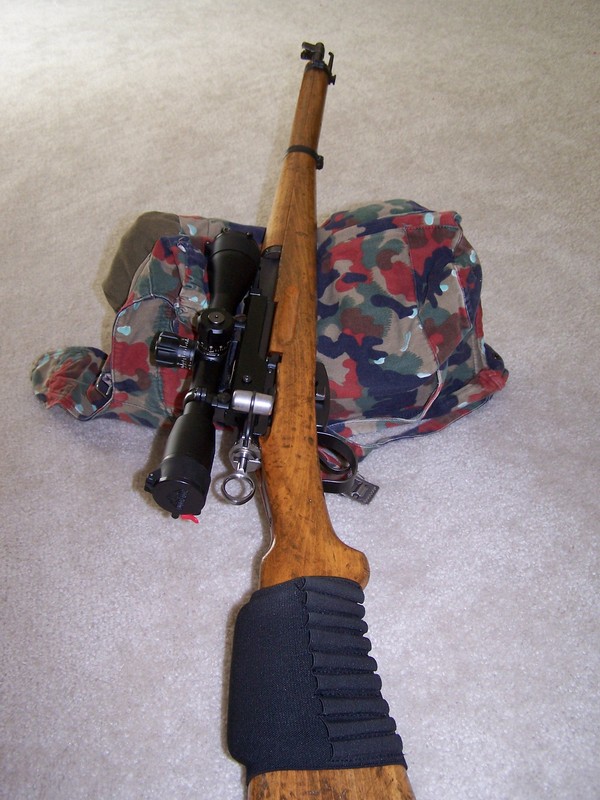

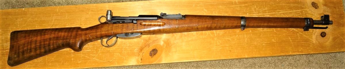

I know this isn't the for-sale section, but I figure it'd be a real 'stars lined up' moment for anyone to catch it on this site's PX. I have taken the Weaver k4w and mount off of my rifle and if anyone is interested in either, feel free to PM me.

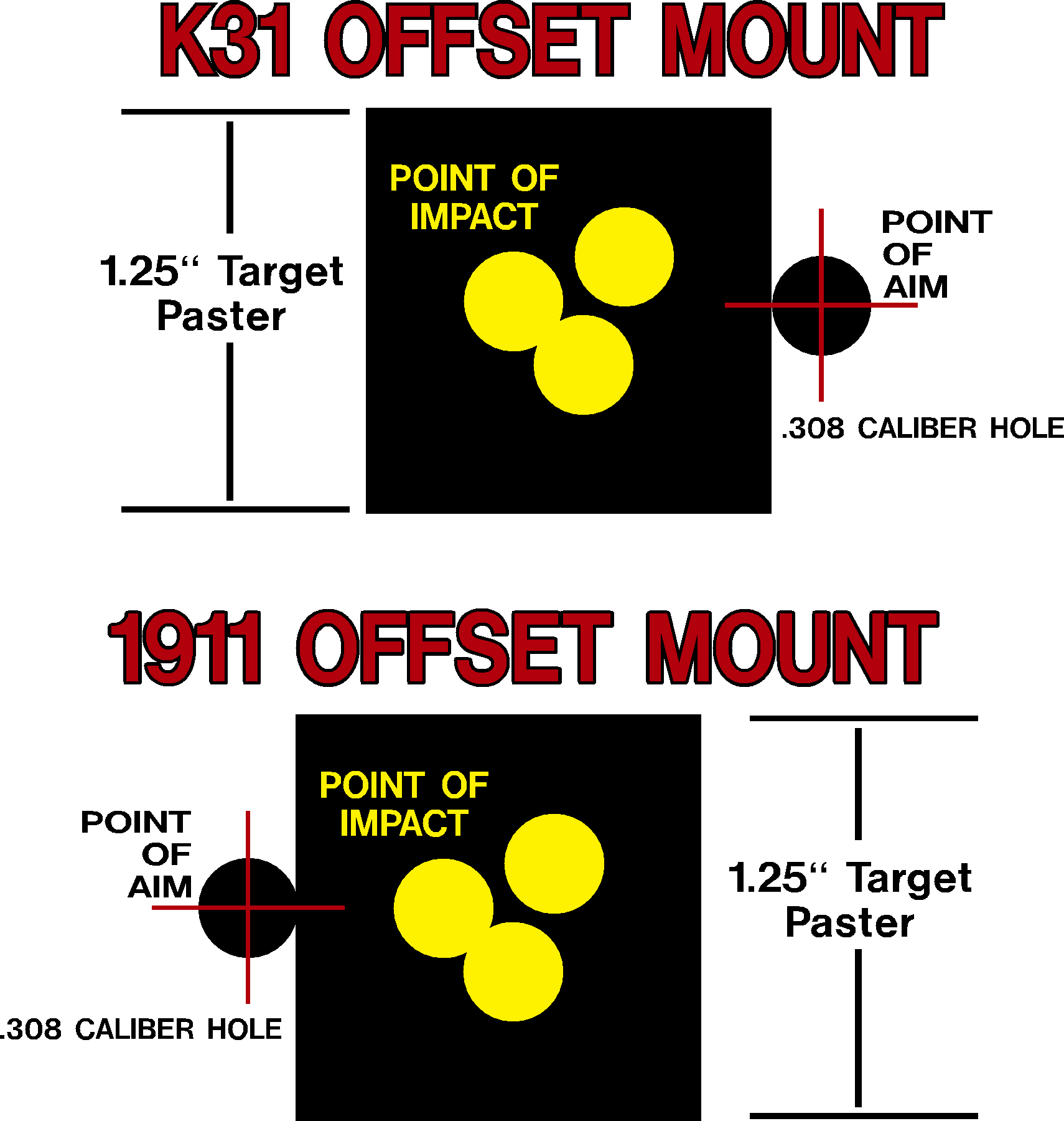

Gents, this is the correct sight picture for an offset scope mount for the k31 and for the G11. Sight it in at 25 yards as pictured, and you'll go to 1,000 yards with no windage adjustment whatsoever. The current Guiness world record for a k31 is held by a friend of mine... Ernie Jiminez at 2,000+ yards with a k31 and a 190gr projectile. He had previously set the Guiness world record at 1,000 and then 1,500 with the same k31.

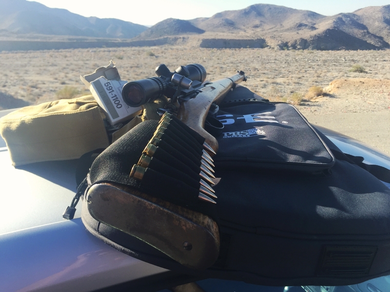

The K31 was my introduction to long range shooting. Back when I couldn't afford much, I could afford a high quality K31. It shot so well I got a second. Then I got a St Marie scope mount and Bushnell fixed 10x mildot. I'd drive out in the desert and place balloons at various ranges. GP11 was plentiful.

Obviously works for you, but for most.........
The attached rendering is the sight picture setup virtually all of us here at SP use for Swiss Rifles as well as for the M1D Garand Sniper.
The offset of the mount is 11/16", so leave it at exactly that POI at 100 yards and it will remain so out to 1,000 yards. No need to zero it on the bullseye. If you do, the POI will change the further out your target is.
If you can tell the difference beyond 200 yards, you're a much better shot than I am, Gunga Dihn.
I also use a fixed IOR Valdada 10 power on my zfk55, but that's an entirely different animal. Whichever scope you choose, remember that the lower and closer to the axis of the bore, the better.
This is the same offset that is used on the M1D Garand Sniper rifle mount.

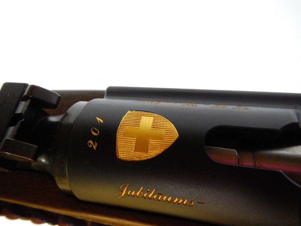

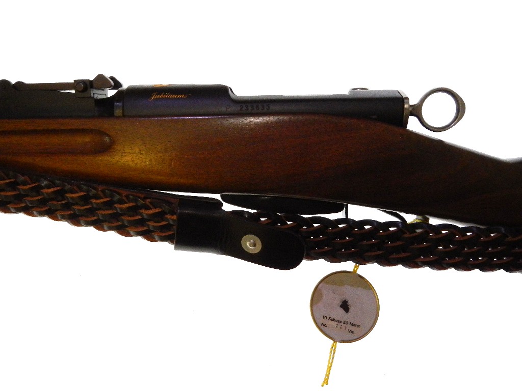

Apparently they still make the K31, not for military use but for civilians.
Never heard of that. In 1990s they did make a very small jubilee run for the 80th anniversary, but it did cost "an arm and a leg".
The hi-end century-plus-old design was not made for CNC, and relies a lot on qualified manual work, which got insanely expensive in the meantime.
Knowing that there's plenty of perfectly shootable K31s left on the market, I doubt anyone would get in the business of making new ones; that'd be just not commercially viable.

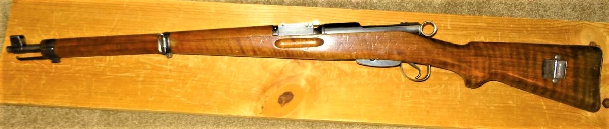

LOL You mean like these??
