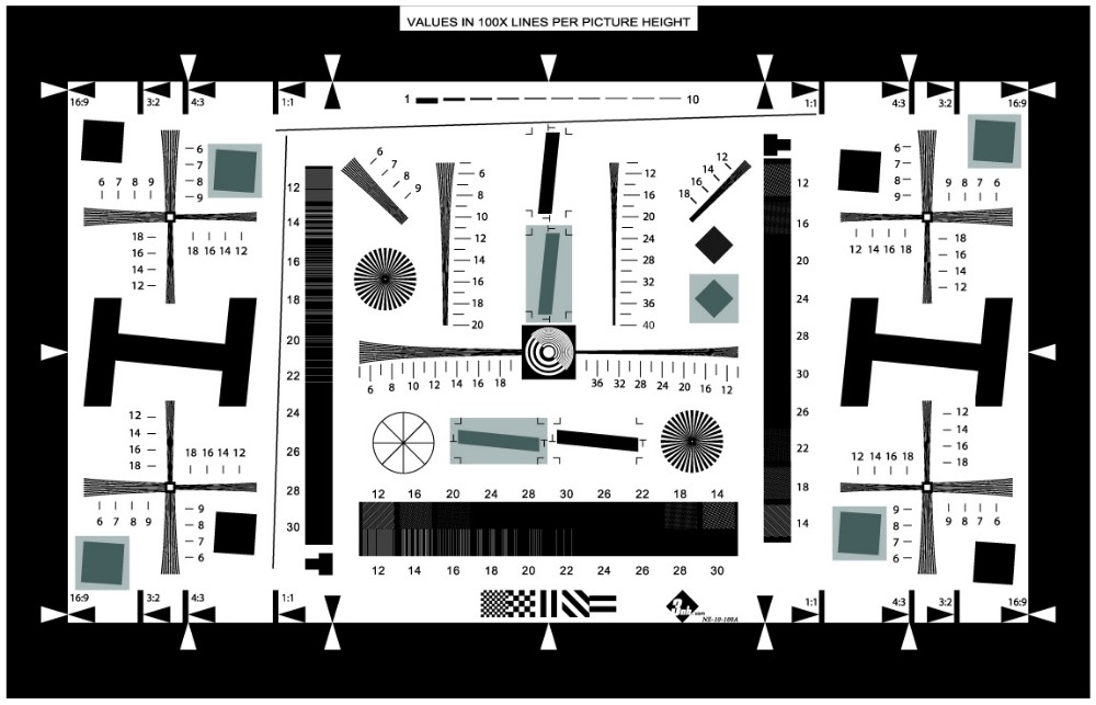

I wonder if it is time to drill in to "glass" ... what do we mean when we say "glass is good" or "glass is better' ?? :D
So what about RESOLUTION. So when I got my NF 7-35x t3, there was a review in this sub-forum that influenced me. That guy was doing 100yds USAF eye charts and the NF 7-35x won by two eye charts? So that is RESOLUTION?
So does that mean NF had the BEST glass in the review?
Two other aspects were mentioned.
CA (Chromatic Aberration) ... this seemed to be a bit more subjective, but the reviewer and several commenters stated they did not think CA would prevent anyone from hitting a target, so perhaps this is a less important aspect, though it is an aspect.
POP. POP was the other aspect and presumably the TT and the MINOX were top dogs on POP and the NF was behind on POP. I'm not real sure what POP is, but since I've never looked thru a TT or a MINOX, I guess I would not know!!!
So what is "GLASS" ... is that
RESOLUTION
CHROMATIC ABERRATION
POP
Anything else?
For me, resolution is #1 probably because it can be more easily, objectively measured by me ... and for that .. while I think the NF resolution is clearly superior to the xtr2, I do not think that resolution prevents me from hitting the targets I want to hit. IPSC-D steel out to 1200yds (with .300WM(24)) or NATO-E steel out to 1400yds or 3/4 inch dots at 100yds. What it does enable is using lower power magnification with the NF so I can shoot out to 1,000 yards with no dial shooting with the T-3 and still see the target really well. With the xtr2, I will be dialing for that target and so can use higher magnification to make up for the reduction in resolution. At least that's how my brain is thinking about this.

... Clarity is not something you see and is really a meaningless term ...
So you don't buy off on the idea of using USAF 1951 chart at 100yds for "resolution" comparisons between scopes (as has been done on some reviews on this site) ??
Why not??

I'd think eye charts would measure acuity (it's a black and white chart), not necessarily clarity...but I have no where near the background that ILya does on these things...
