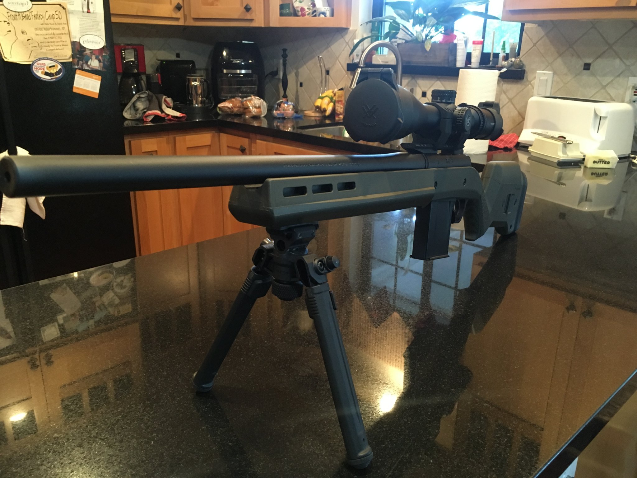

I’ve been contemplating building a 223 off of my my savage/ chassis that’s sitting around
It would definitely be set up for long loaded heavies with a nice long barrel for speed.
