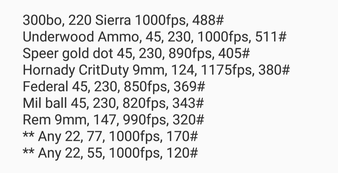

Pistol bullet weight bullets traveling at pistol bullet velocity can be expected to have pistol bullet terminal ballistics. Personally, I would keep subs to archery ranges- which brings in its own set of challenges.

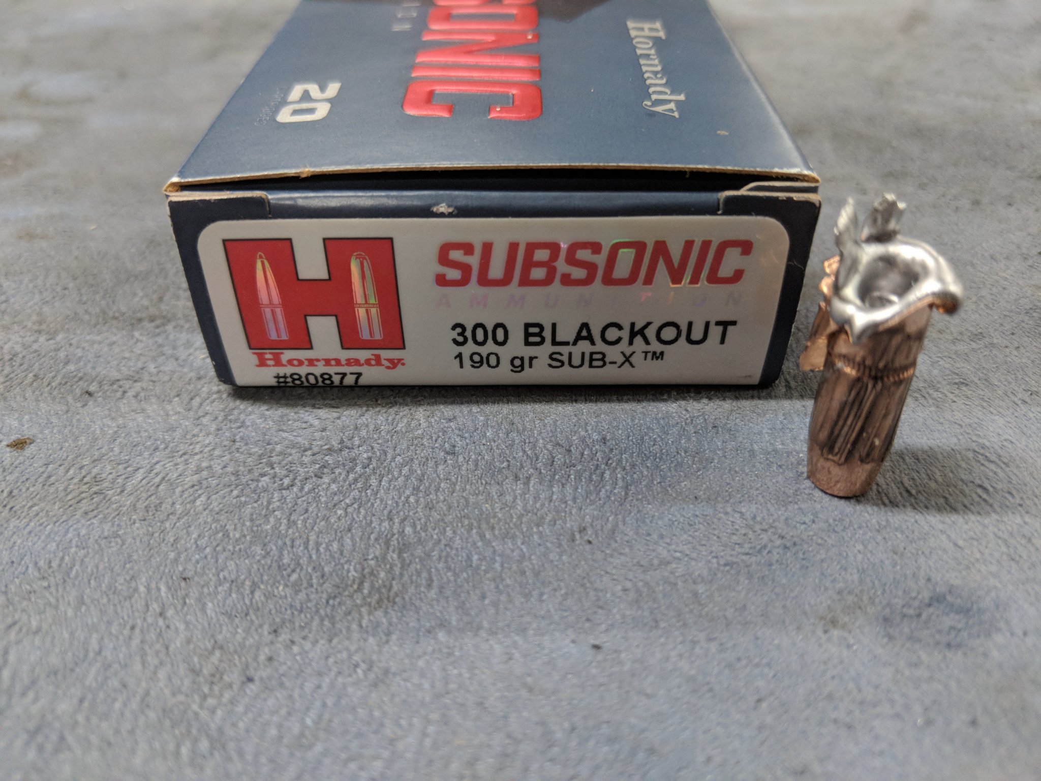

Shot 4 deer so far this year with my 300 blk with Lehigh Defence 194 max expansion bullet. Everything under a 100 yds, they only ran 20 yds and dropped like a rock. The bullet you use is critical for taking game. If it doesn't expand at low velocity don't use it. Of course shot placement is always important.
I’m on deer #7 total kills with the Lehigh 194 ME... it really is devastating at subsonic speeds. I keep my shots to 100 yards max but I have repeatable 4” groups at 200 yards with this bullet. According to specs it will still expand down to about 700fps. At 400 yards it’s still going 888 FPS.
Every deer has gone between 5-20 yards max and dropped with massive bleeding. Avoid shoulder shots, keep in the heart,lungs, liver and it will shred like a massive broadhead.
That's good to hear. I'm heading out tomorrow with a buddy that's shooting that same load so hopefully I can report back with similar results.

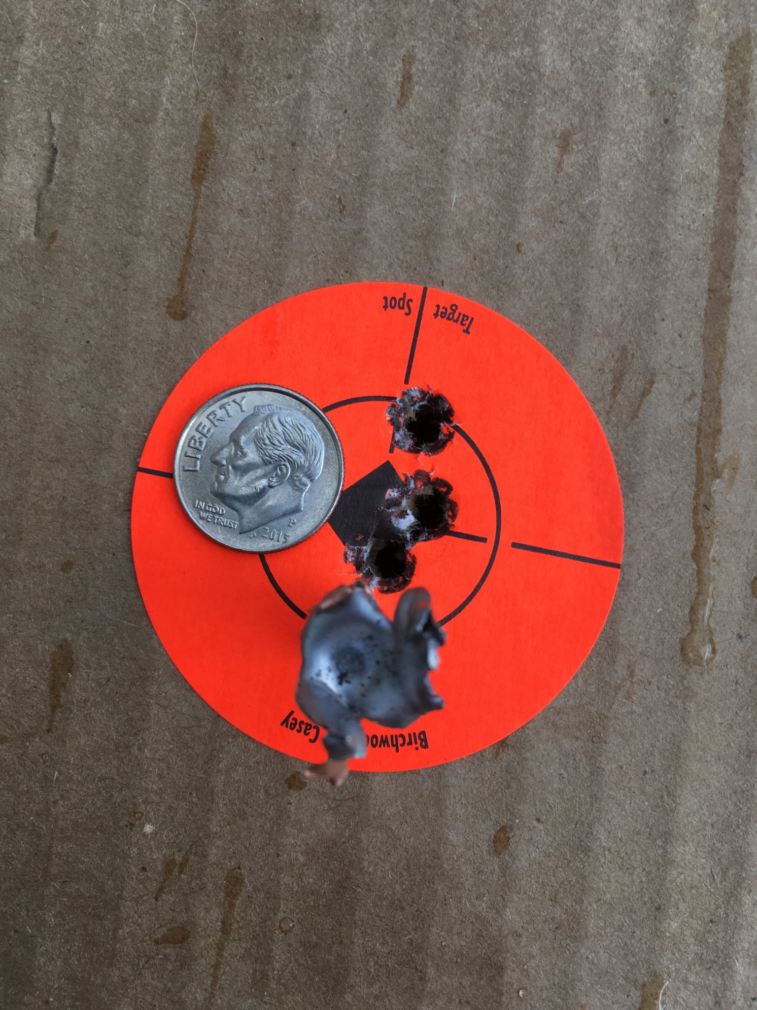

I don't see any problem with head shots at 50-100 yds.
220g fbrn hornady, 12.1gr cfe blk sig brass cci 400 primer. 2.1 coal. Slight crimp.
Rem 700 aac 300blk 16 in aac can. Movie quiet.

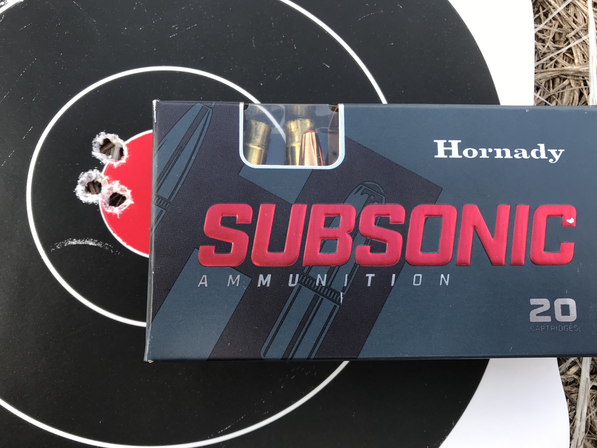

I wish hornady would release those new bullets for hand loading.
Thier price was not the problem for thier new sub loads.
It was that so far no factory loads have out grouped my loads in my gun as
Far as subs go.
I belive most of that to be very touchy on the powder drop.
I think it is because of the percentage of powder as apposed to "target" is narrowed.
I hand trickle each load and dont think any mass produced ammo can hold that tolarence.

I had at best in my gun gotten 1 1/2 moa with factory loads of 207 and 208 subs.
I know the bc in those is crazy good but they measure it at super.
Some bench loader told me to try flat base since I was staying at 100 yd.
Went full on retro and used fbrn, resulting in sub moa in my gun.
Decided it would be fine give a lot of restraint on shot choice.
Have a city employee interested in it for management use.
Evedently fits the bill better than what they use on the golf course.
Very little blood loss if caught just below the ear.
If you were to miss it won't go far.
Won't disturb suburbia like a shotgun.
Those lehigh's are great but at a price and make a bit of a mess.
Spife has helped me with this load, but also does not use it for hunting.
I would only recomend hunting with it at 100 yards and less in light winds,
By reserved well practiced shooters willing to pass on a lot of marginal shots.

Killed plenty of deer with subs. Practice and know your dope. 300 blackout is a great round . Hornady 190 sub-x is the best factory load for hunting . If you reload Trail boss and the 90 gr XTP is a proven killer. Below is the 190 sub x test bullet . Passed through 4 milk jugs full of water and caught it in the 5th. My set up is Remington 700 300 blackout 16.5” swfa 10x HS Percision stock.
To add to this, I pulled a couple of the 190 sub-x, and down loaded to around 750 fps and shot into gel.

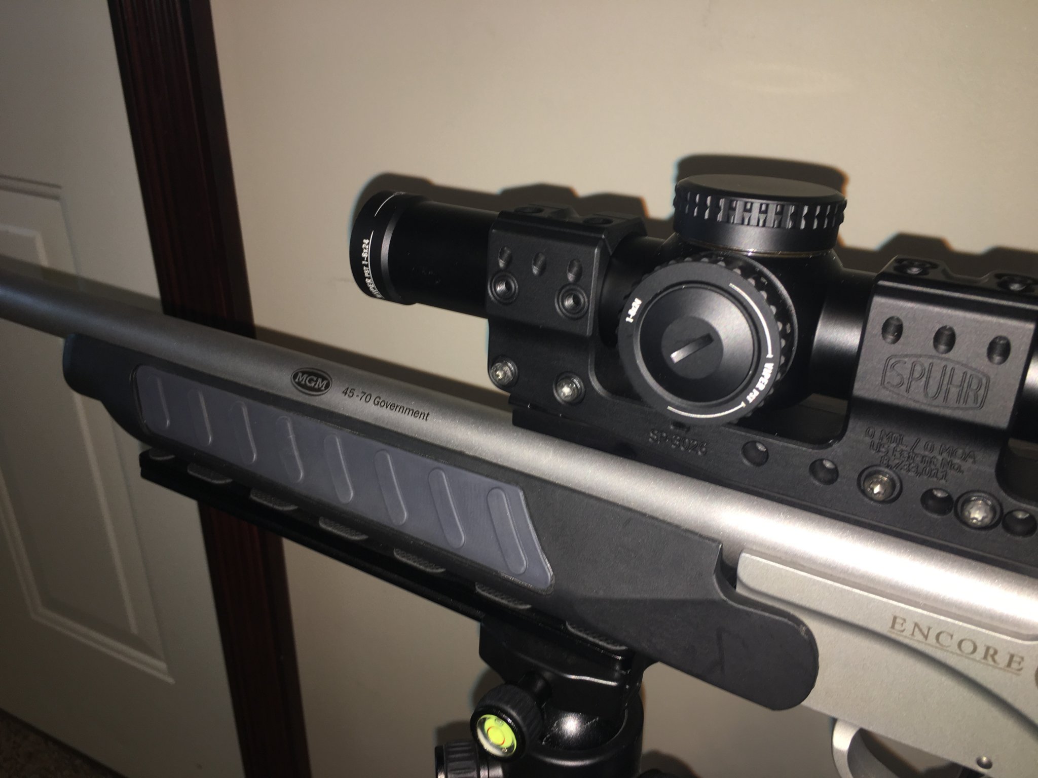

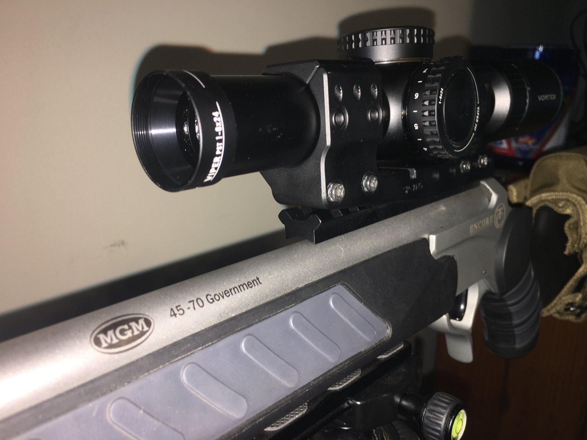

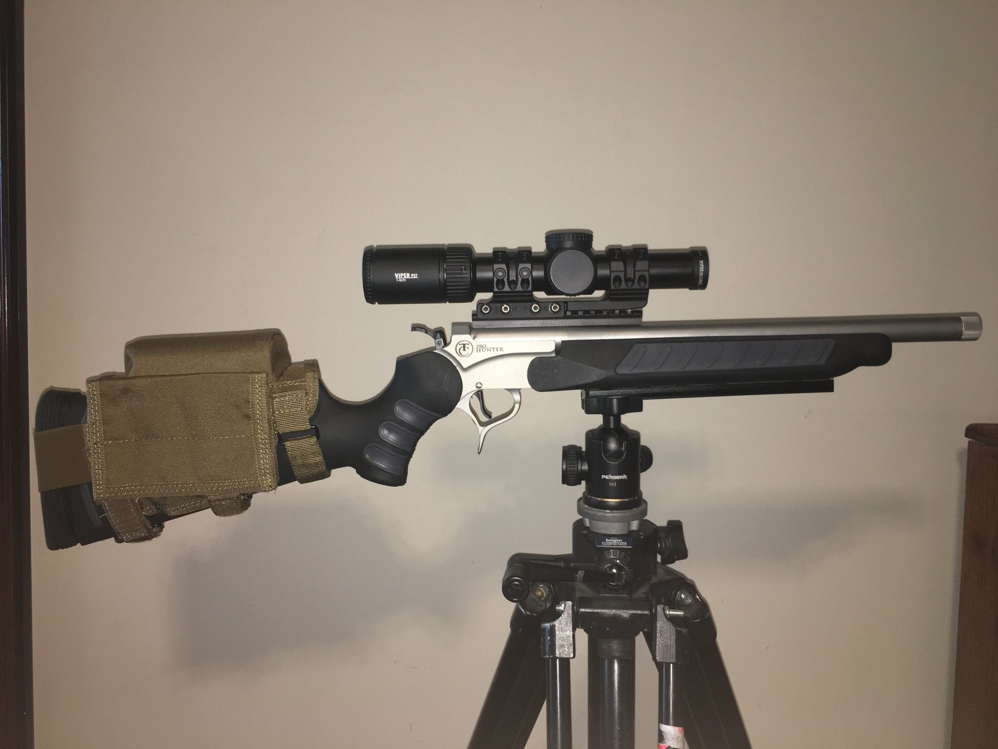

Built me a fast twist 45/70 TC Encore for subs. I have stabilized up to 730gr cast bullets but will likely hunt with 600gr soft cast bullets with a deep hollow point. Was shooting them through the chrono behind the house and left holes in the yard like you shot a bowling ball out of it.
Nothing wrong with using subs as long as you use the proper bullet and know your limits.
That sounds like a neat setup, do you have any pictures? Where did you get the fast twist barrel?
I've been toying with the idea of having a 77/44 chopped and threaded for use as a short range silent deer thumper with bullets along the lines of these:
GT 305gr hp
Can't see how it wouldn't work as long as ranges are kept short.
Barrel is a 16.5” 1:10 Twist from MGM (Match Grade Matchine). Had it throated long for these longer heavy projectiles.
