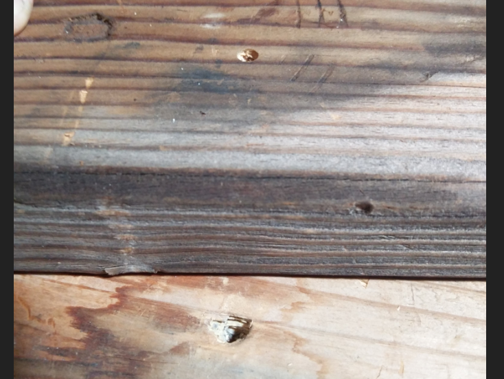

Late but positive update:
With all the technical and loading issues resolved, we have now produced our base prototypes. We ended up with two - one is solid copper 26 gr., the other a lead alloy at 32.5 gr. :
The velocities are now very consistent with the lead alloy averaging 1750 fps, the copper slightly faster averaging about 1766 fps. Our initial penetration testing is complete. The 2x4 test resulted in the lead ally going through 1.5 boards with the copper smoking through both and into about 3/8" of the plywood backstop! We need to document the board testing but I have one picture of early lead alloy penetration:
The wood used is hard, dry pine that's been laying around for years. I expect better penetration with final loads and with the introduction of our proprietary bullet coatings. The attached video demonstrates the rounds capabilities against soft body armor and packed clay.
As with all GDS pistol round technology, the 22lr versions render all soft body armor obsolete. In addition to the video, I have tested these rounds against several brands of level 3A vests with both hard and soft support backing. No match for our product! Next step in the development process will be long range accuracy testing. Based on 5 round tests at 50 yards, there does not appear to be any stabilization issues but I want to test out to 100 yards with a scope on my test rifle to confirm that.
Enjoy!

Holy crap that’s awesome.
Any chance of shooting a 17hmr side by side to explosive comparisons?
I assume this stuff is still loaded hot and needs a strong action to use it?
AZgeek
Belligerents
Sep 30, 2014
313
85
34
Don't own a 17hmr so not possible at this time.
Nope. No special action required. I initially thought that would be the case, thus the reason for my original inquiry and this thread . Testing is being done out of a Savage B series 22lr. Also took a few shots out of my son's Sig 1911 semi auto pistol. No issues. The original high pressure brass problems were self-induced per the commentary earlier in this thread. I think we are approaching 38 special energy out of a 22 lr. Gotta love it!
