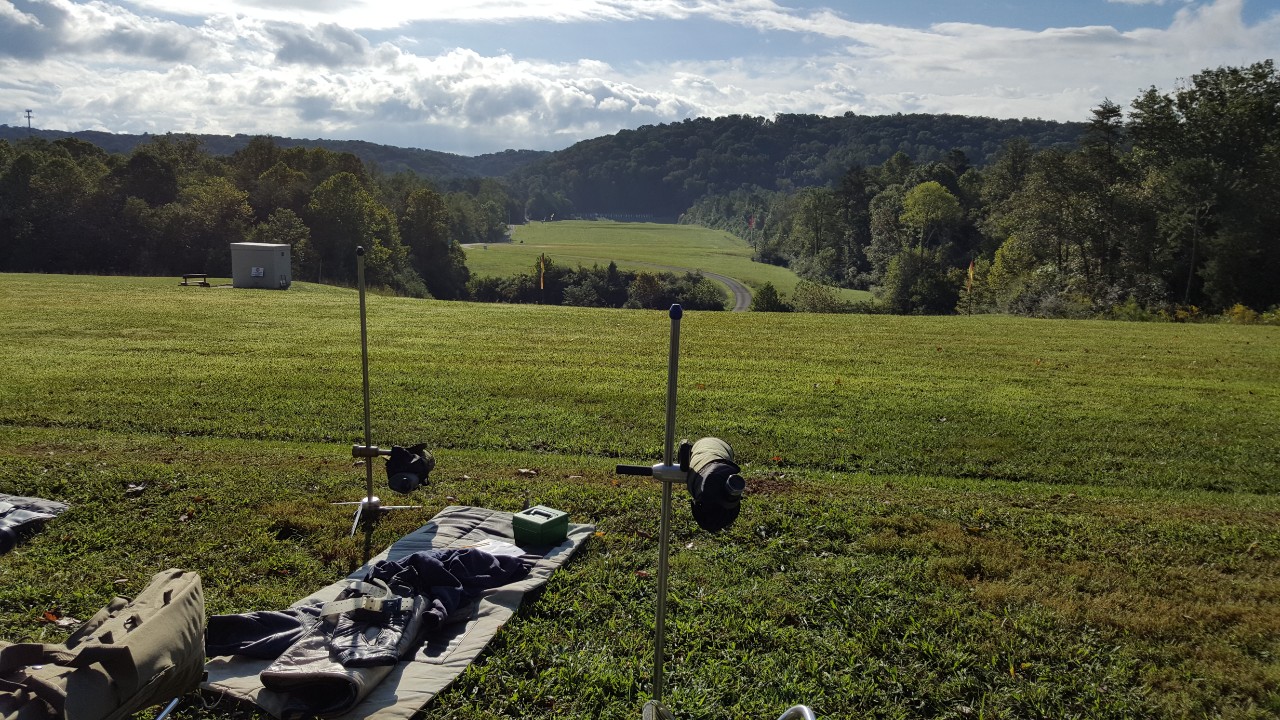

chasing the last shot is something most of us fall for. As Gunfighter said, by the time you get your downrange feedback conditions HAVE changed. Maybe not enough for a correction, but the wind is almost never the same shot to shot.
Chasing the spotter, in the traditional sense, is what chasing your last shot is. For example, I shoot a 9 at 3 o'clock. Pissed, I immediately either hold 10 left, or click 3/4 MOA left and fire without really checking the wind, hoping to catch the end of the X or a solid 10. (LR1/MR1 targets) This means I'm chasing the last condition I shot in. It works 90% of the time, but that means 10% your fucked. Nobody is happy shooting 180 scores when High Master at 1k is 194+ or 197+ at 600.
If you can learn to read the wind on this KD range, you have a damn good chance of being the next national champion.

Jim, that's fine unless you are under a time constraint and the wind is inconsistent, or if you are in a transition like an approaching front or storm.
It CAN work in steady-ish state wind very well.
If a guy spends time shooting under any time constraint (as is the case in a lot of field, military, and competitive shooting), he will very quickly have to learn how to dope every single shot. Only the very, very experienced wind shooter can just look at the range, hear the cartridge, and make a call within 1/2 Minute either way.
But I've seen them and shot around them. Those guys didn't get there by waiting on conditions all the time.
Chasing the spotter, in the traditional sense, is what chasing your last shot is. ... It works 90% of the time, but that means 10% your fucked.
Some good knowledge there. Nice photo of Oak Ridge, too. Mean ol' bitch.

...Nice photo of Oak Ridge, too. Mean ol' bitch.
-Nate
If Hillary did have a testical lock box, that's where she would bury it.... I think most people who shoot ORSA have a love/hate relationship with it. NO other KD range I have been on has unexplained verticle like Oak Ridge. That valley is a motherfucker.
