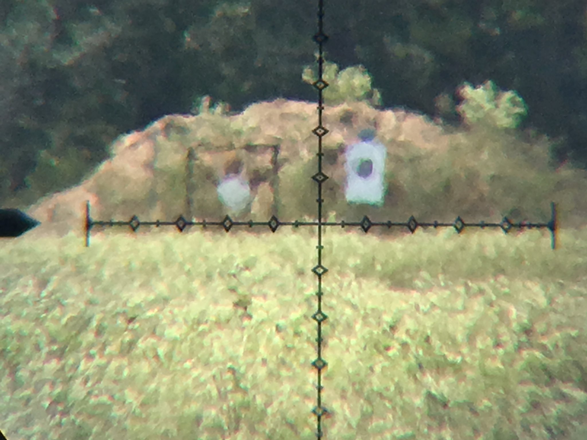

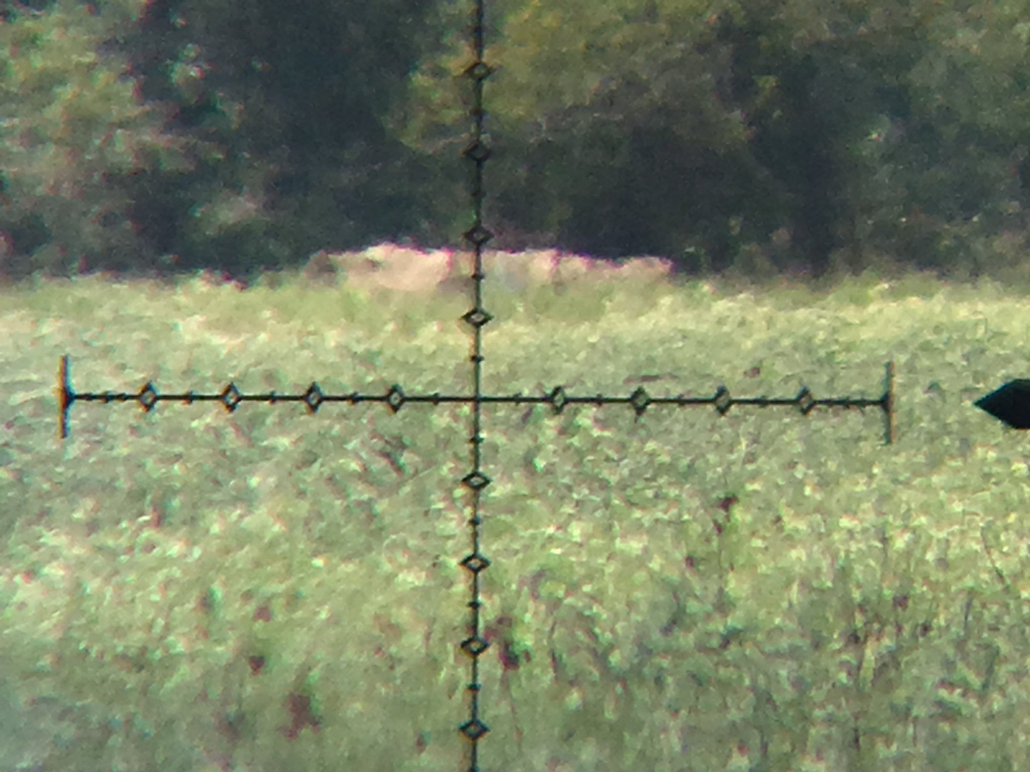

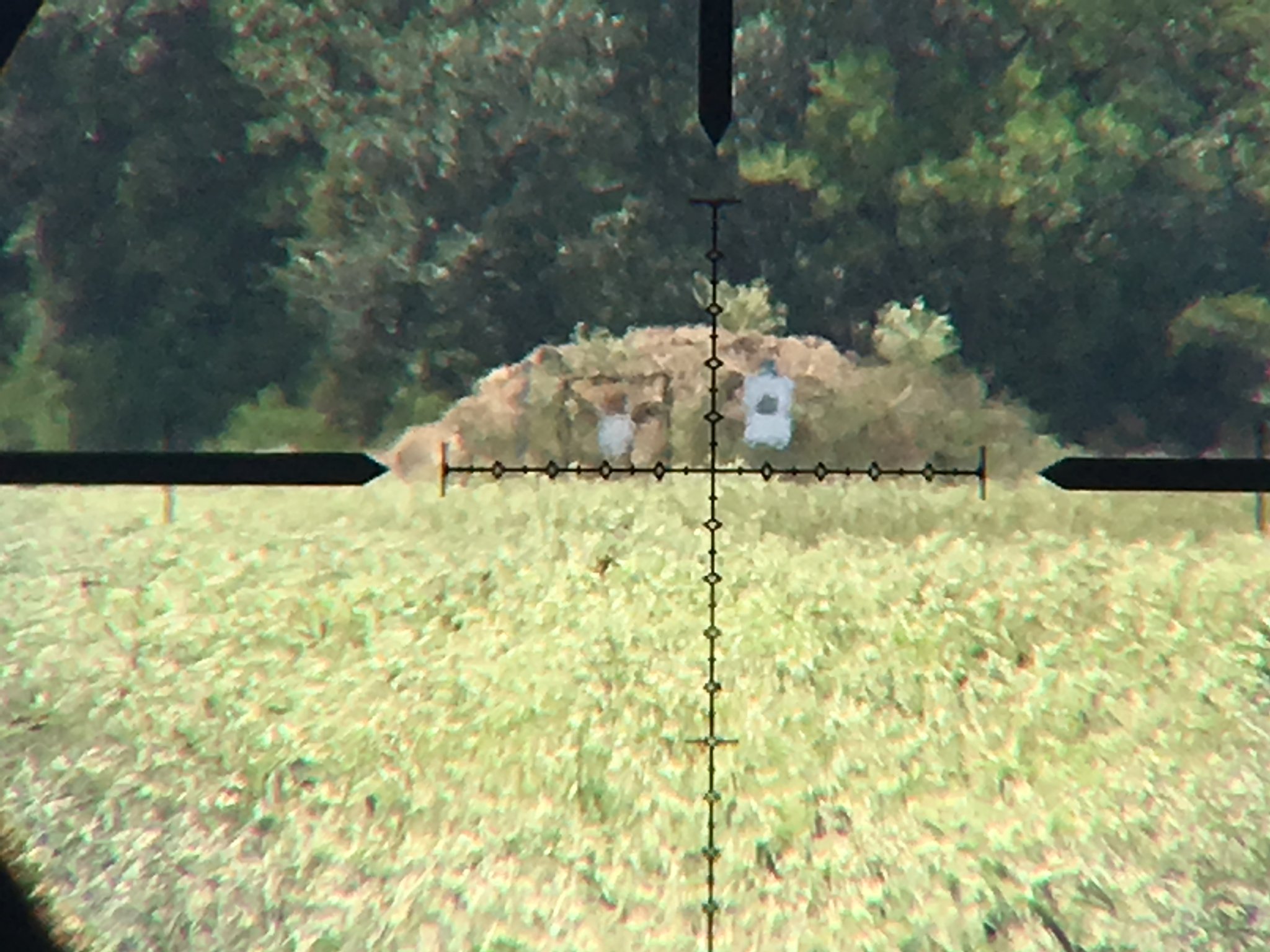

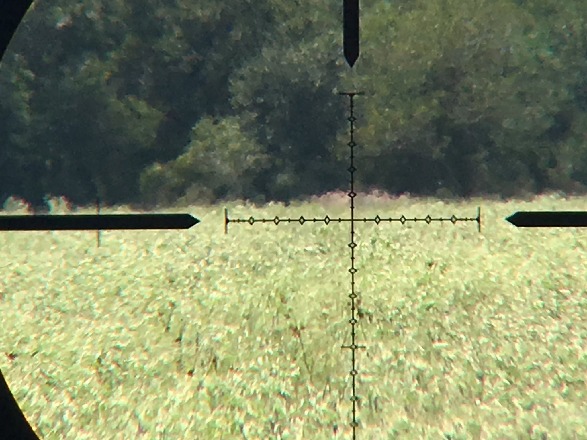

If you want to spot your shot, you better be dialed down.
Here are a few photos showing the mirage that us guys with the gulf coast humidity deal with. I have posted these before.
500 yards on 20x
500 yards on 10x
750 yards on 20x (you can’t see my plates)
Could you imagine making a shot on 20x at this relatively close range (750yds) much less any further or with more magnification. These are still images of course. In realtime, the only way to know you hit the plate is because of the sound but there isn’t really anything to shoot at. I won’t bother squeezing the trigger when its like this I limit to 500 yards.
