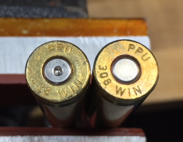

Hi gents,

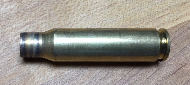

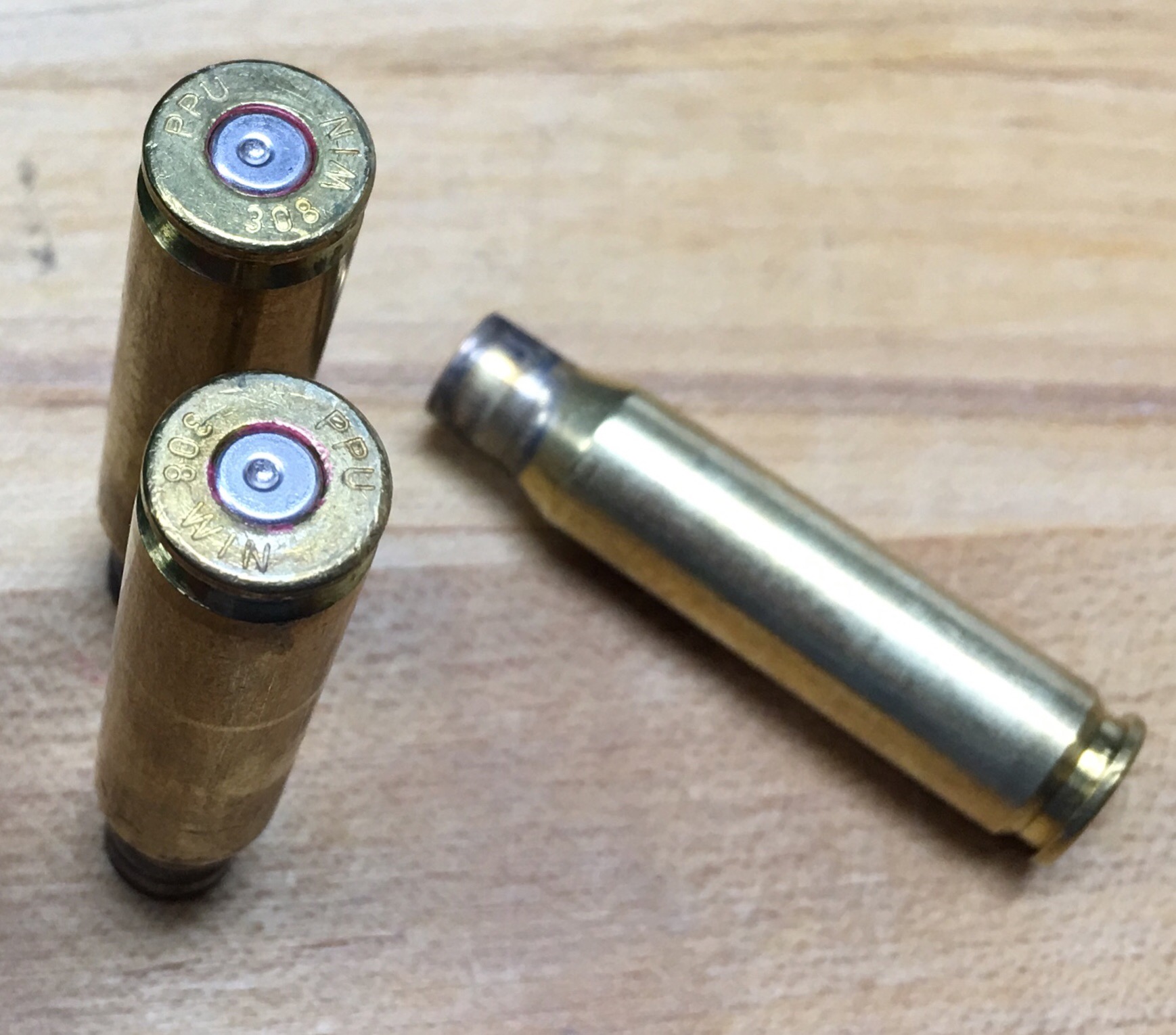

I'd like to hear your expert opinion on this sticky bolt issue I have. The rifle is Steyr Scout Elite in 308Win. I have no issue lifting the bolt, but have a hard time extracting bolt to the back. Brass was shot twice before. Brass is never full length resized, not even shoulder bumped, just half of the neck. The reason I did this is because the cartridge has no trouble chambering before, even now. I reload with 44.6gr of Varget (According to Lyman, the range is 41-45.7gr), CCI #200 primer, 168gr SMK, 0.02" off land. Grouping is decent at just under 1" at 100 yards. I shot about 20 of them before decide to quit it. I do not use or have Chrono, so I do not know its muzzle velocity.
Looking at the pictures below, do you think:
1. This is a case of over pressure? Is primer look flattened or normal?
2. If it is, is the spent brass safe to be reused again?
3. If it's not an over pressure, do you think brass just need to be full length resized?
4. Invest in Chrono?
Thank you.

Headstamp/primer look fine. Adjust Fl sizer for two thousandths shoulder bump, problem solved....Your case has no room for normal spring back with the half a neck size thing you're doing.

The brass should be safe as far as that goes. It's gonna be pretty hard on your extractor though if you have to beat the bolt back on every round of the ammo you still have loaded. PPU isn't exactly premium brass, if it was me I'd either pull the bullets & deprime what you had loaded (and then properly resize of course) or just toss it & chalk it up to a learning experience. Much better than beating the hell out of your bolt.
