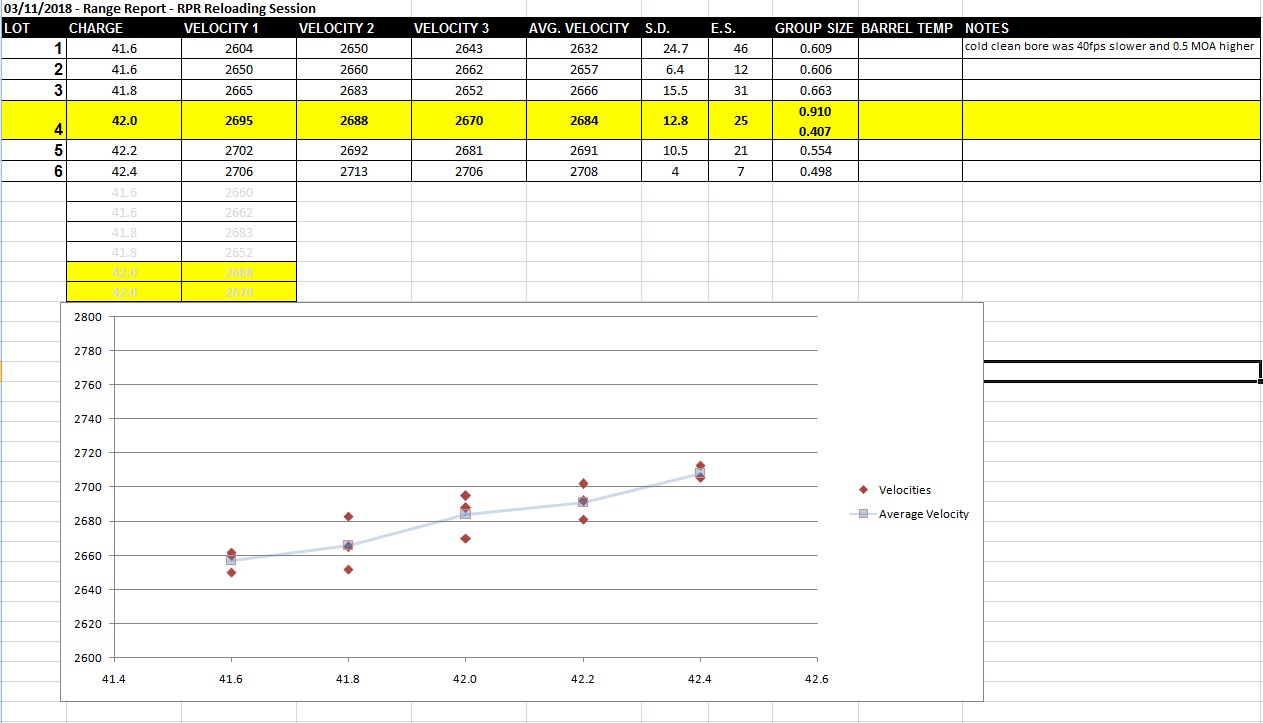

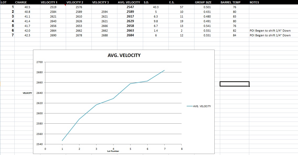

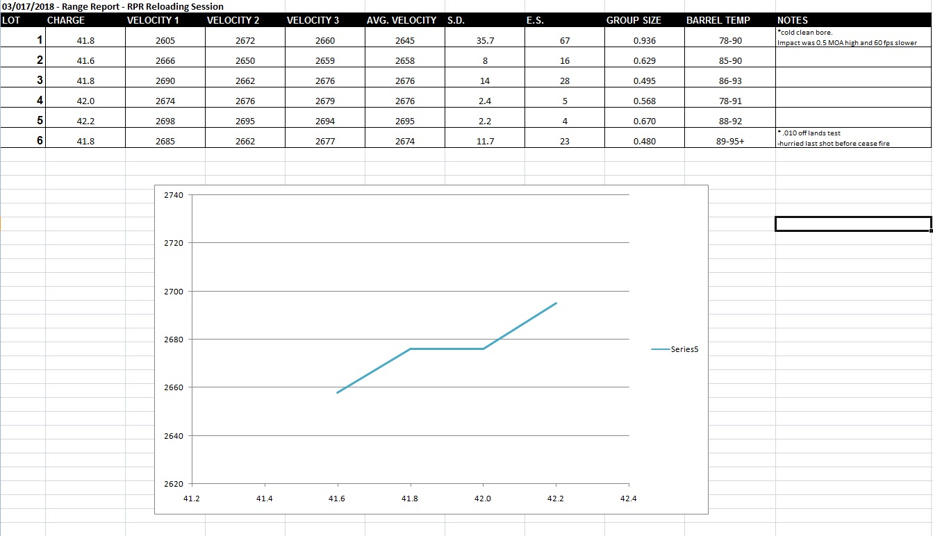

Update* (Starline Small Rifle Primer Brass vs. Hornady Large rifle Primer Brass Reloading Report)
Just got through with my first reloading session of the aforementioned Starline Brass. These are my results.
I also have Hornady brass reloading data I will post here for comparison for *@Cascade Precision. I suppose I should make a new thread for this in the reloading section as well. Feel free to add to my info! I'd love to gather some data from others with the same rifle/powder/bullet combo.
Rifle: Ruger Precision Rifle
6.5 Creedmoor / 1:8 Twist / 24" bbl
Powder: H4350
Bullet: 142gr Sierra Matchking
Location: Houston, TX
Altitude: 177ft
Avg Density Alt: 400-1400
STARLINE BRASS (Small Rifle Primer)
Weight - 161.5 +/- 0.6 grains
Primer Used: CCI 450
HORNADY BRASS (From Precision Hunter ELD-X Factory Ammo)
Weight - 145.5 +/- 3.0 grains
Primer Used: CCI BR2
HORNADY BRASS (from Match Ammo)
Weight - 151.5 +/- 1.0 grains *did not conduct tests w/ match ammo brass

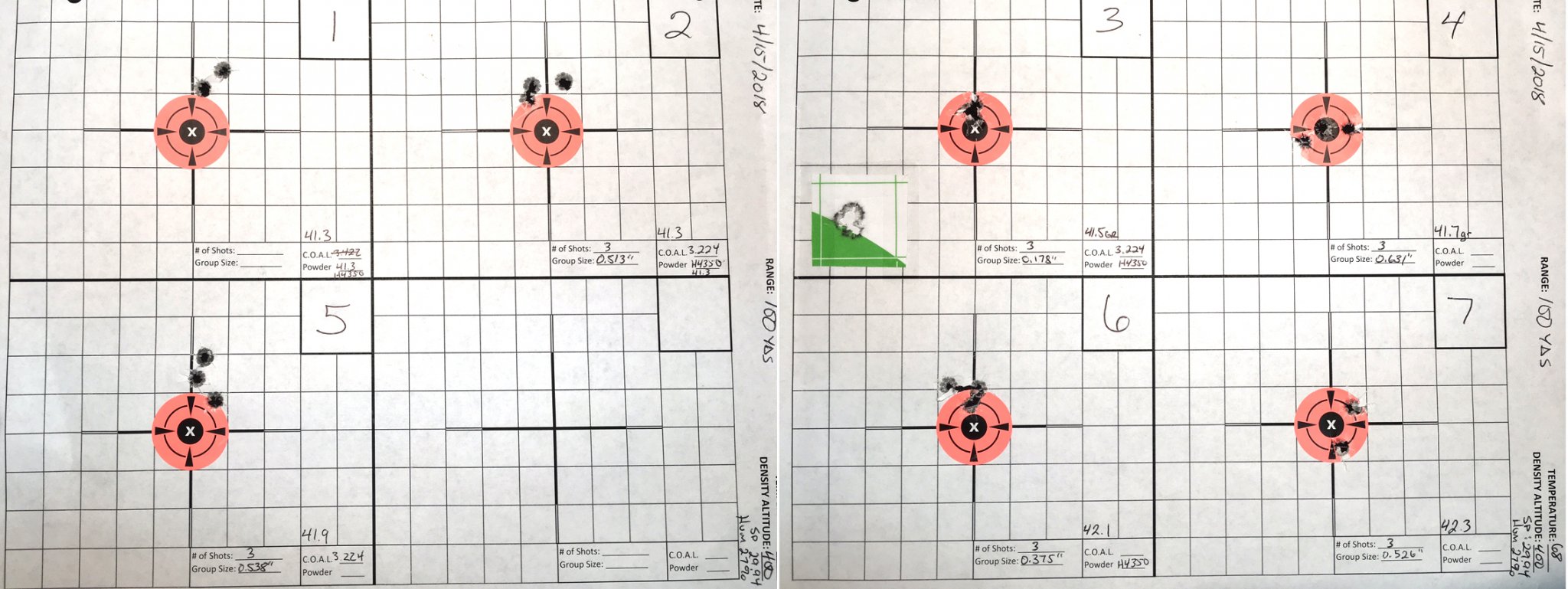

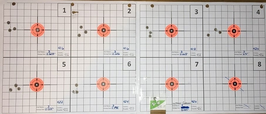

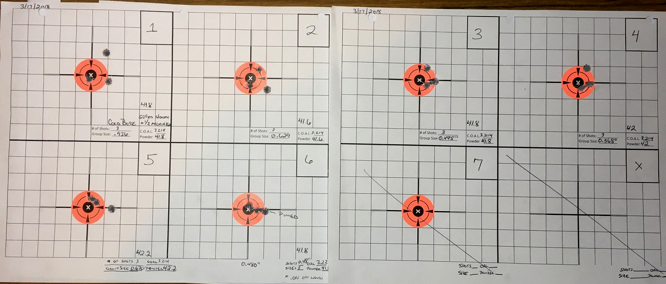

I have 1 reloading session w/ the Starline Brass (first image), and the remainder are Hornady Brass.

Conclusion: The Starline Brass is heavier, same charge weights yielded a higher velocity. I'm hoping to gain more firings w/ the Starline Small Rifle Primer Brass however, but time will tell.
