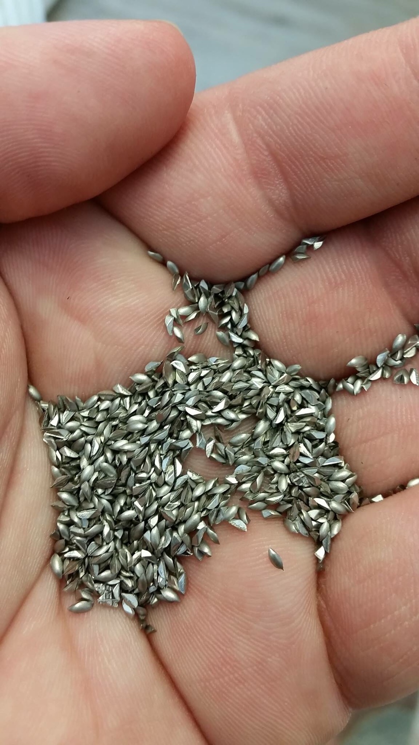

If you're concerned with pins in your brass, and you rightfully should be, I would recommend using different media. I use Southern Shine media and I've never had a pin stuck in the case, primer pocket, or flash hole. The Southern Shine media are stainless steel chips instead of pins and their shape and size keep them from getting stuck. When I'm rinsing my brass after tumbling, I just turn the brass mouth down while it's underwater and all the chips just pour out. His prices are reasonable I think I paid $25 or $28 for 5 lbs of chips, shipped, which is pretty cheap for peace of mind. He doesn't have a website, so you'll need to look him up on Facebook. https://www.facebook.com/southernshinetumblers/
Edit: Just checked and it's $26 for 5 lbs, shipped
@canezach, thanks for the lead on this media, I ordered some up and ran a few hundred cases through. Previously I was having an annoying amount of stuck pins necessitating manual (annoying) removal. With this southern shine media that task is now a thing of the past. Highly recommend this media, it works awesome plus no more stuck pins!!!
