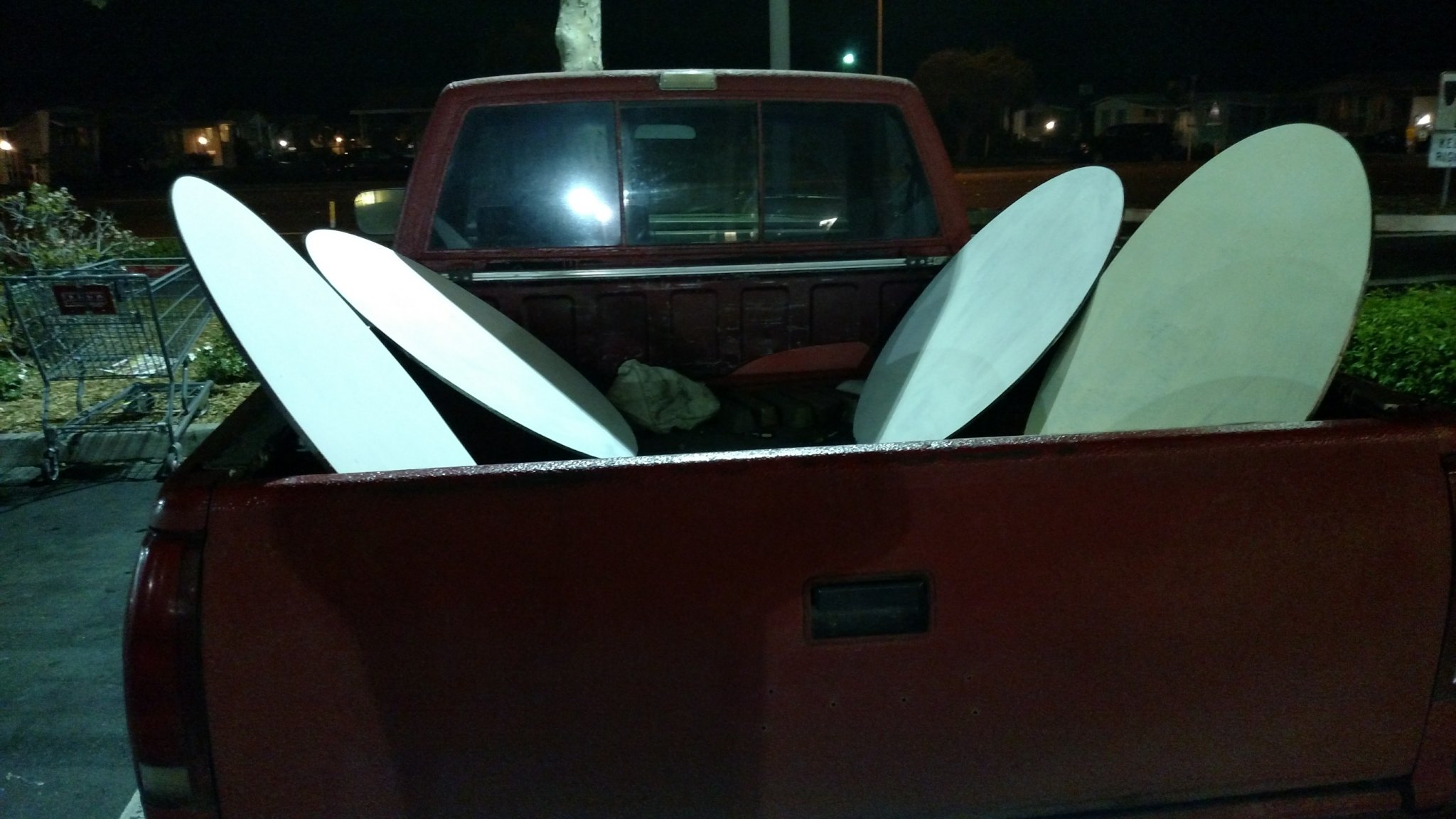

I run the NorCal matches and the gongs are 3/8 inch AR500 and have thousands of hits on them. Plenty of hits with 50 BMG 510DTC 416 Barrett and all the other heavy hitters.
So far we don't even have a dent or crater.
As to the corners missing we lose alot of shots right around the edges but after holding matches for 3 years now very few are won at our starting distance which is 2054 yards.
It generally takes 2586 yards to get a winner anymore.

URSA steel is 37" round to match the outer ring of IBS and NBRSA official 1000 yard (benchrest) paper targets. Why? So URSA events can be run using steel targets or standardized paper targets, paper targets available from multiple sources at fairly low cost.
