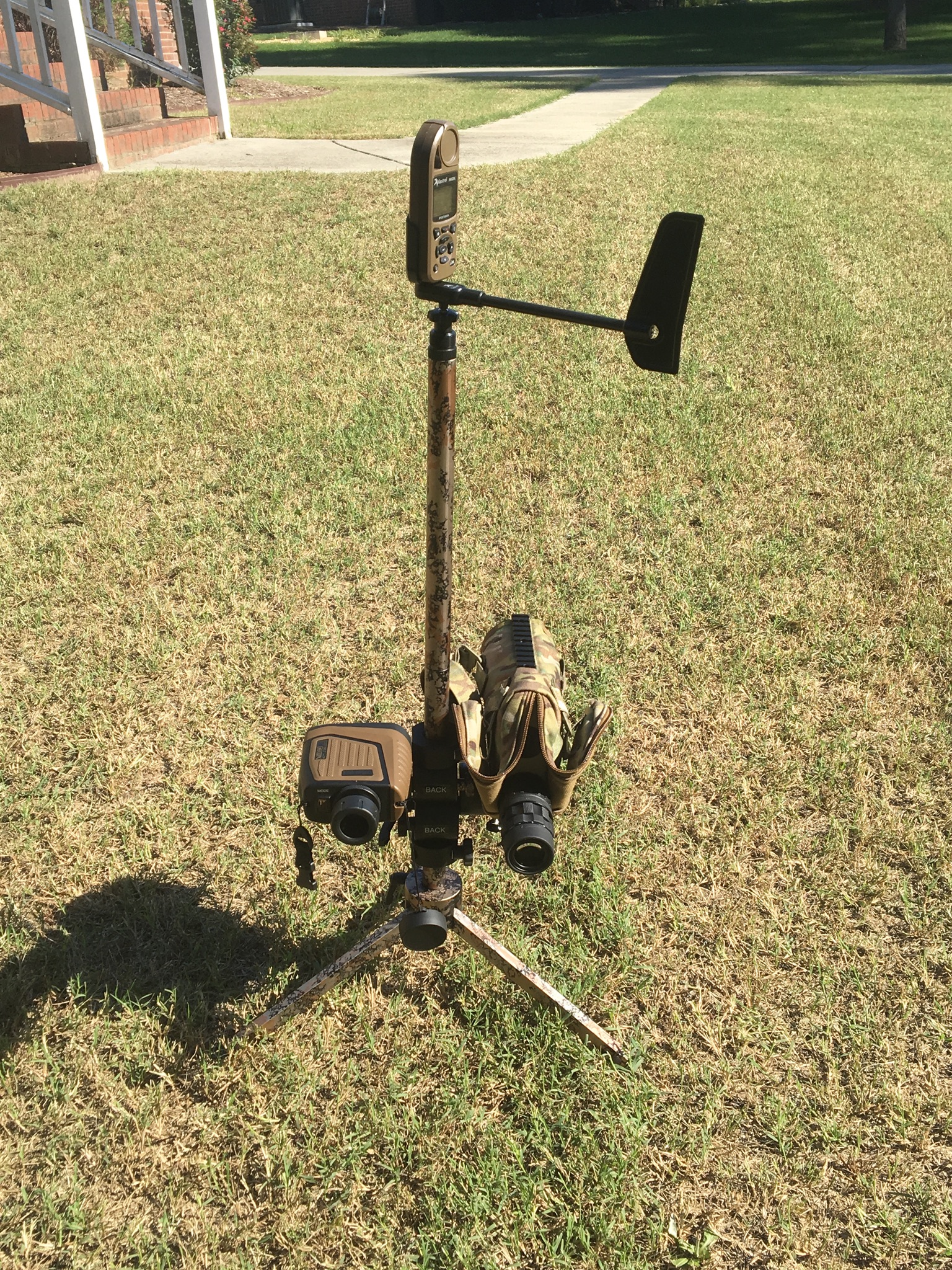

If you want to spend a bit extra, here is my setup for shooting alone.
You can lay place it right next to the rifle and don’t even have to break position to use the LRF or the spotter (which are cowitness). In addition with the use of a phone skope or similar you can use your phone to record or look through spotter.
How did you attach the LRF to the stand?
