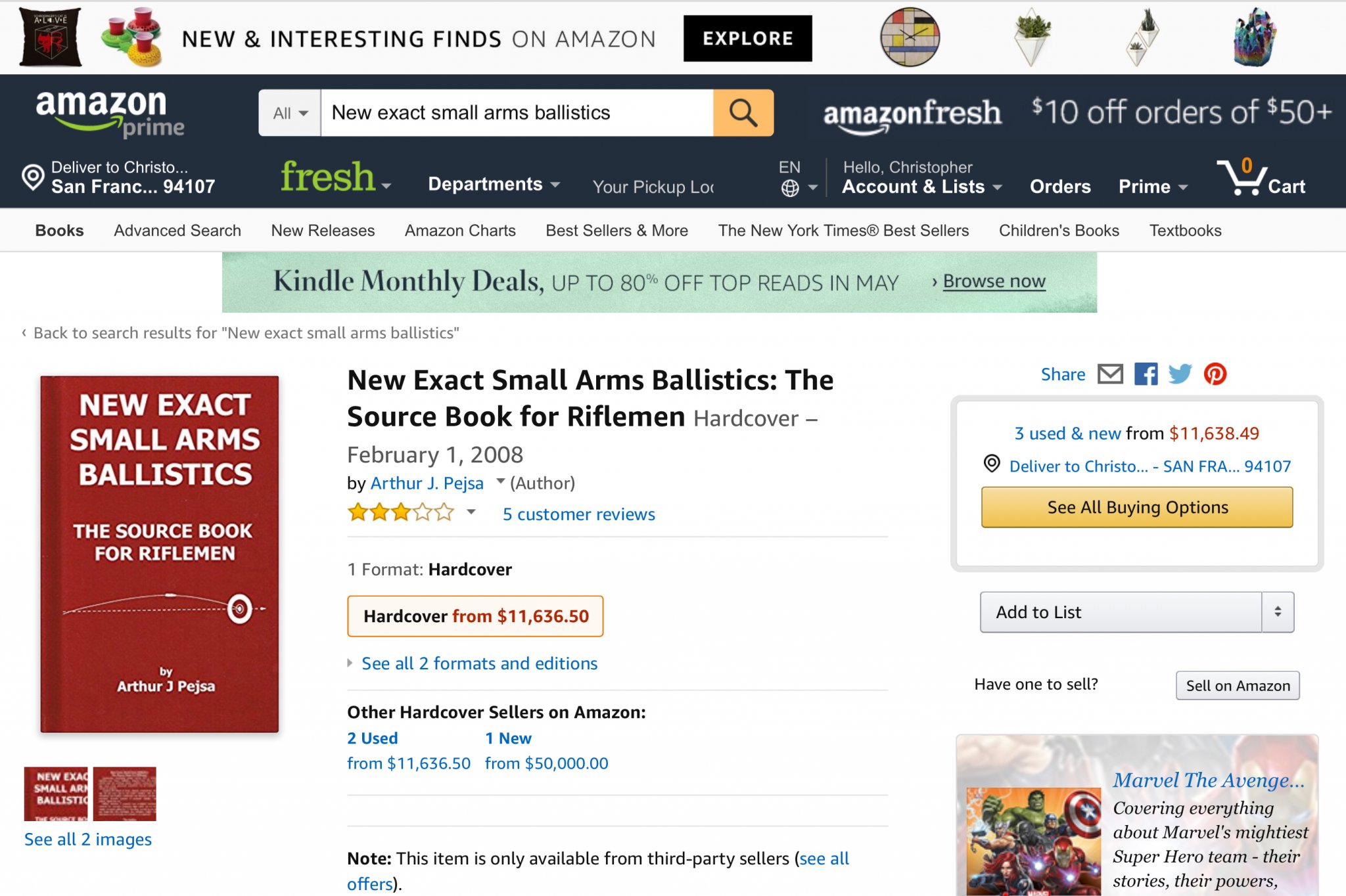

Damn, Frank. That’s quite the heirloom you have there.
You can get a copy for under a hundred bucks. Amazon is rife with scammers using it to legitimize stolen credit cards, people who would rather put a massive price on an item rather than show it out of stock, and probably more than a few algorithmic pricing programs that just don't work very well.
Search eBay too. I recently got a copy there for $34 USD shipped. (I just looked at eBay and do not see any listed currently)
