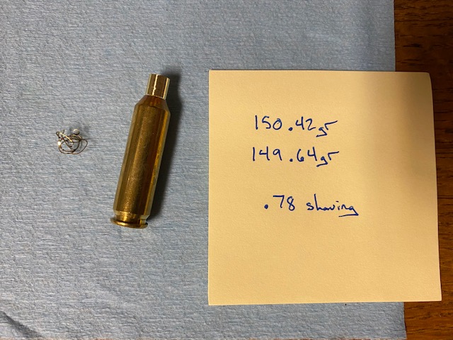

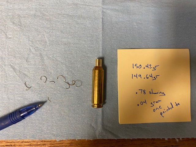

Try this: Measure length and weight one of your culled brand new cases.
Trim off ONE GRAIN from the neck.
How much did you take off?
Really. Give this a try. Tell us how much length you had to trim.
Oh, and what caliber/brand.
