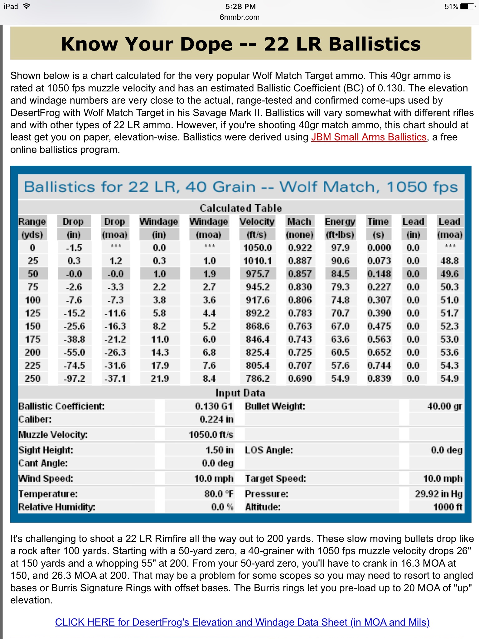

I use Wolf Match Target and found this chart and works for my set-up CZ455 VPT 16.5” barrel.
Thanks. I tried the Target and it was good ammo. I find the Extra produces fewer fliers so I have been focusing on that. I am going to use this BC value and see if the come-ups are matching the field data I have collected.
Thanks again
Reactions: DXT_Shooter
Thanks again
I have tried SK Standard Plus and Wolf Match Target I may try the Extra maybe even give Lapua a try just to see the differences.
Eventually I want to get a Lilja Barrel. Shooting 22lr is addicting 😀

Got a stock ruger 10/22, I'll drag that along as well and see how it stacks up against the Kidds, both locked and semi-auto mode.
Problem is, the data supports what I see in the field. It takes a lot more elevation for the semi-autos at distance vs the bolt guns. Semi auto needs 8.1- 8.3 for 200 yards, the bolt needs only 6.9-7.2 MILS
