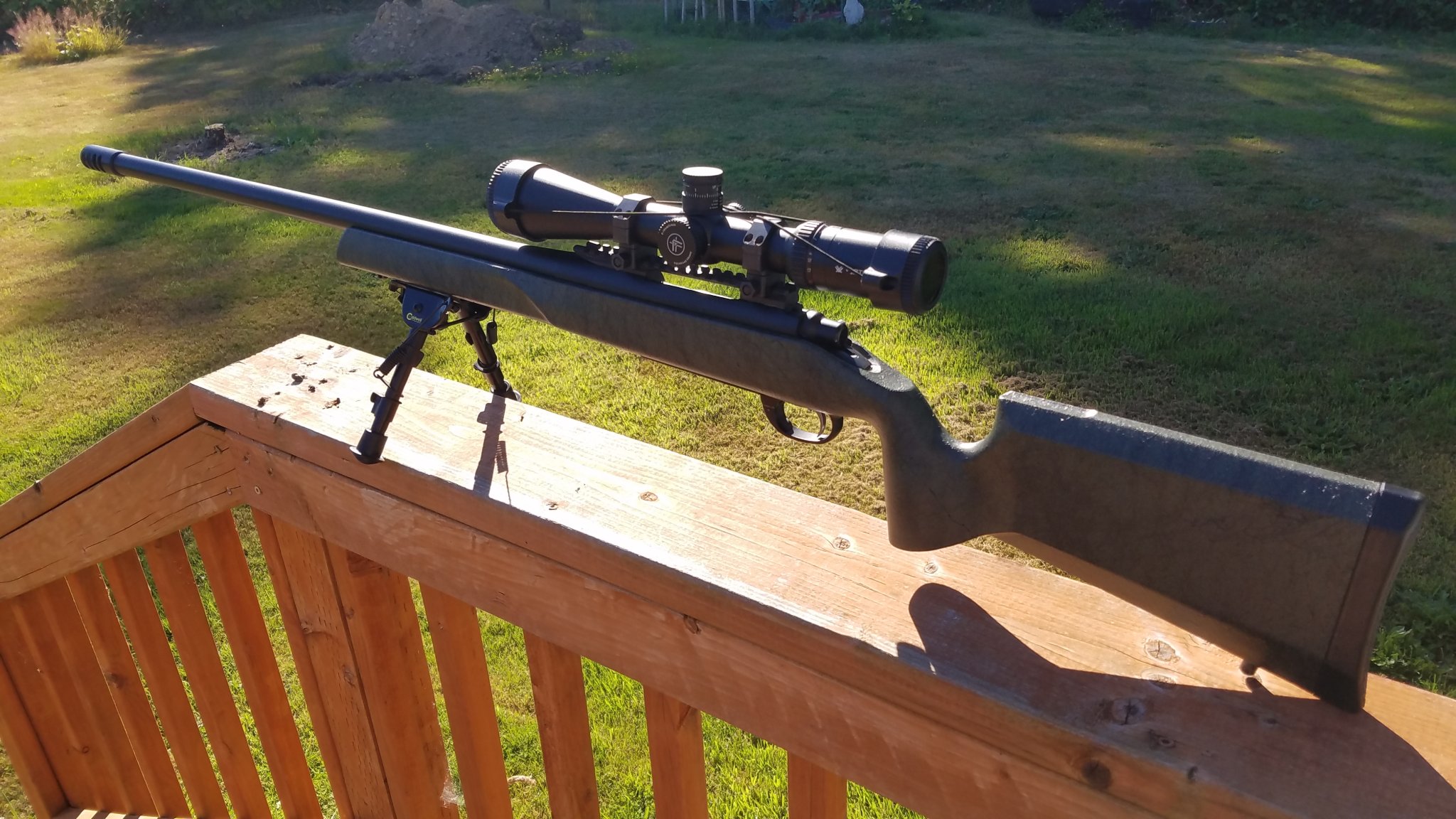

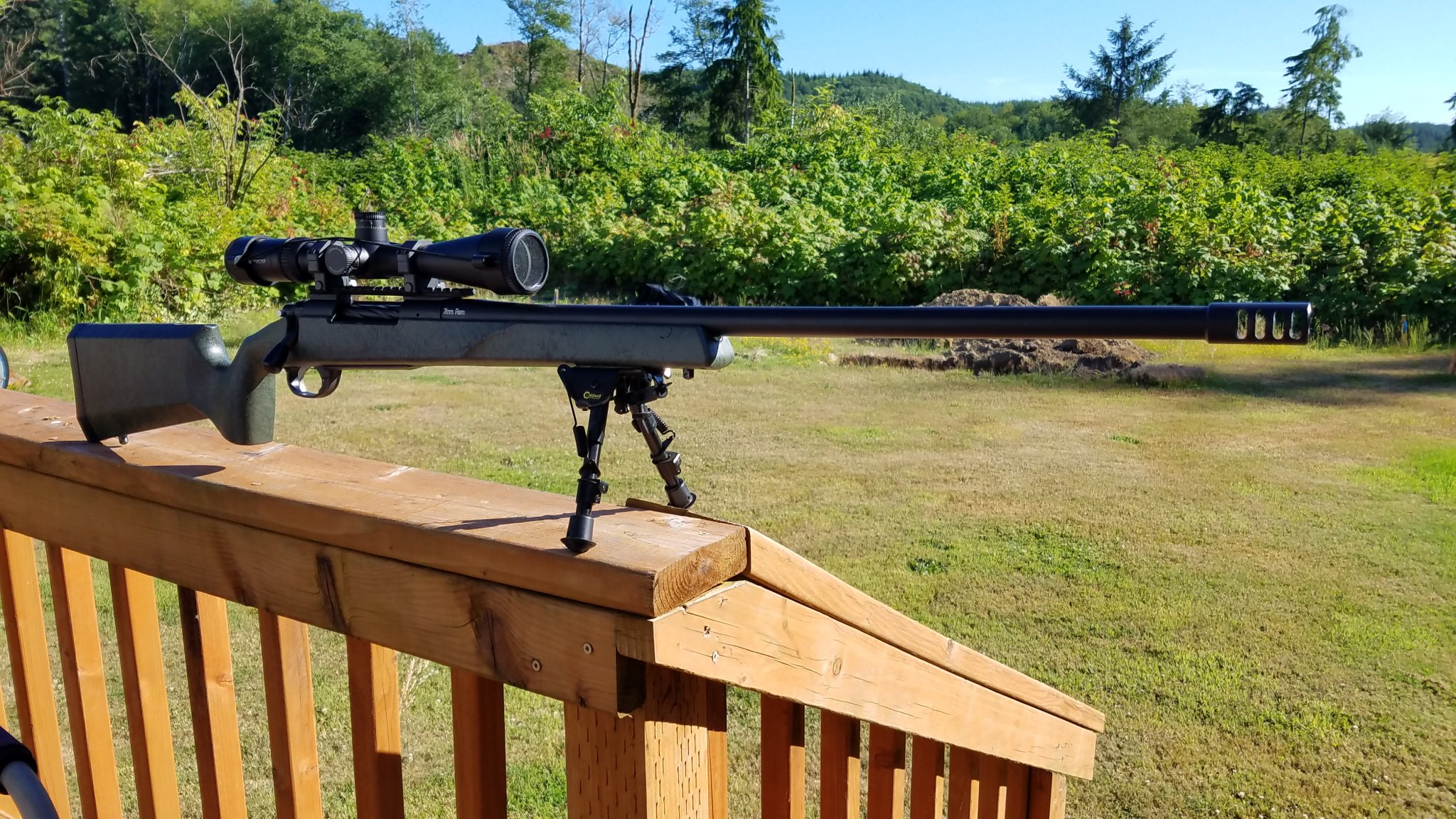

Uhm, it's here. And it's better than I thought. The new boom stick is ready to go. I did have to shim the bottom metal. Screws to long. Floor plate won't latch if ya drop it. Gonna have to grind my screws down a bit. But it's gonna live as a single fed gun anyhow so no biggy.

That looks awesome amigo! Not sure I understand....the mag’s not gonna work?
I got the Oberndorf bottom metal. It's a bit beefier than oem. But still the action screws are to long. Cranked down to 55 inch lbs the front/forward screw actually passes thru the action and pinches the bolt. So I shimmed it with 2 washers and fixed that but the floor plate will not snap shut after opening it. So something is off but the screws certainly need to be ground or just cut down.
Regardless, with or without the shims the floor plate fails to close.
Hmmmm........I think a call to Stocky’s might be in order to ask for a solution on how to fix that. It doesn’t get any more common than a 700 action so I have to believe they have an answer. Single feed is better than sitting on the shelf but that’s not what you paid for. Your our test mule dammit and this shit needs to work🤣🤣🤣 Let me know if you need me to call If you loose your shit and tell them what you really think😉 Don’t make me start an epic thread in 5 different forums to fix 1J’s shit😉🤣🤣🤣
Reactions: oneshot86 and 1J04
I will be calling but first I HAVE TO finish some quick test loads. Charge Master warming up right now! And thx for your input. I know ya got my back. ;)(y)(y)

U got to shim front and back equal height so fp stays flat as intended, to get the "twist/flex torque" (for lack of better word) out of it. Get it back flat as it was meant to be. But, always beware of shimming a fp, detach mag feed/fp can be dropped too low to pick up a round.
Best bet, cut screws to fit....
I wager that will fix....
Reactions: RNWRKNP and 1J04
I hear you and thank you for the input. I only have 2 washers rigjt now and town is outta the question right now as well. It needs the 2 up front to keep from piching the nolt thru the action. If I had 2 more I'd toss'm on the tang end, but no can do just yet. But I will try or just go grind the forward one down. But right now I'm chomping at the bit to pew. Maybe later today after it gets to hot. I'll report back. And I understand on the feeding issue. Thx for that as well. Been down this road before but never had the long screw issue. Well that's not 100% true. They called me either Lsrry the Legend or Larry Peso for a reason. :ROFLMAO:

Just a heads up ya deplorable scoundrels. Just got off the phone with Stocky's and this is not an unheard of issue regarding the floor plate issue and the front action screw being to long. Shimming seems to be the answer so they're spotting me a few more. In the meantime, I'm gonna run down, time permitting, to Ace Hardware and pick up a couple washers I think may help. I'm also going to order a couple sets of action screws, who couldn't use some spares?, and get them on the way because I'm gonna cut the one I got off after trying the shims. Even if the shims work I'm gonna cut down the screw and give that a go. Shimming this to correct it ain't giving me the warm fuzzy feeling I'm looking for. We'll see........
Mike Casselton
Trunk Monkey
Belligerents
Nov 25, 2007
2,696
2,788
219
Lithia, FL
Larry, those screws are 1/4×28 and 10x32.
The hardware store should have them in socket head cap screws.
Bring yours with you and buy new ones there.
The last one I had to modify was on a 17 Remington and it was binding the bolt like in your case.
