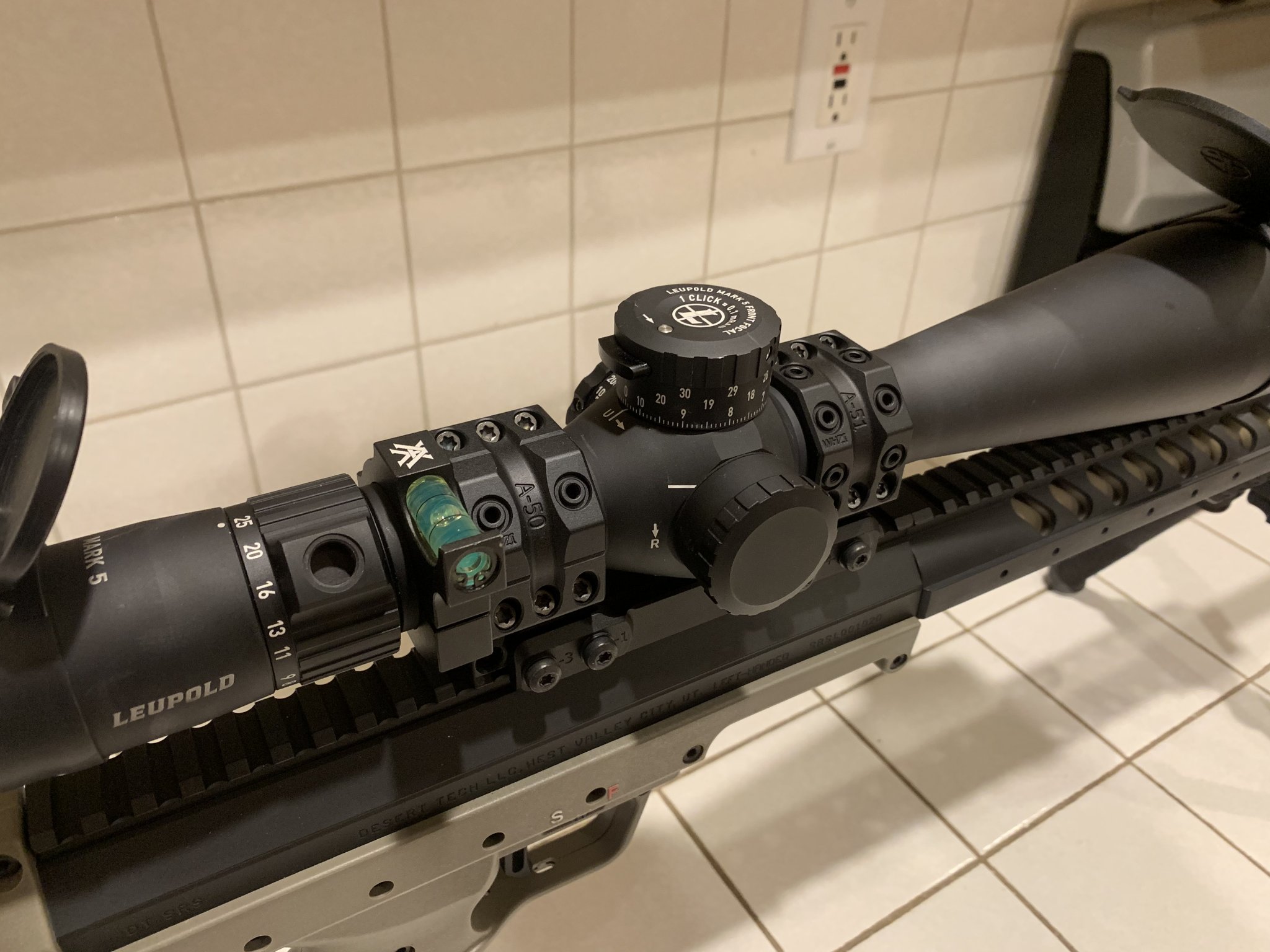

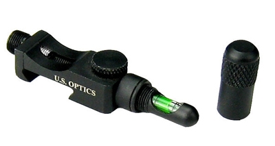

Could someone point me towards 35mm rings or a one piece mount with a built in cant of 20moa or more please?
I used Tier One rings, made in England. They have a bubble-level built in and make a model for the CZ 527 dovetail! They make picatinny and mono-mount types too, of course.
About the CZ dovetail: T1 calls refers to their size as 17mm, but people in the US refer to the 527 dovetail is 16mm. Those krazy Europeans measure that dovetail as 16mm, 16.5mm, or 17mm. Everybody picks a different spot to measure, it seems.
Tier 1 has the monomount which looks a lot like the spuhr & has all the same features like a leveling wedge & built in bubble. Their high mount is 1.3 inches tall & im comfortable with 1.5 inches on ar rails. Spuhr can make them up to 1.89 inches high & up to 60moa cant which is great for elr. Tier 1 makes quality mounts & similar to spuhr styles & prices. They have a wide variety too from thin to wide scope rings & unimounts.

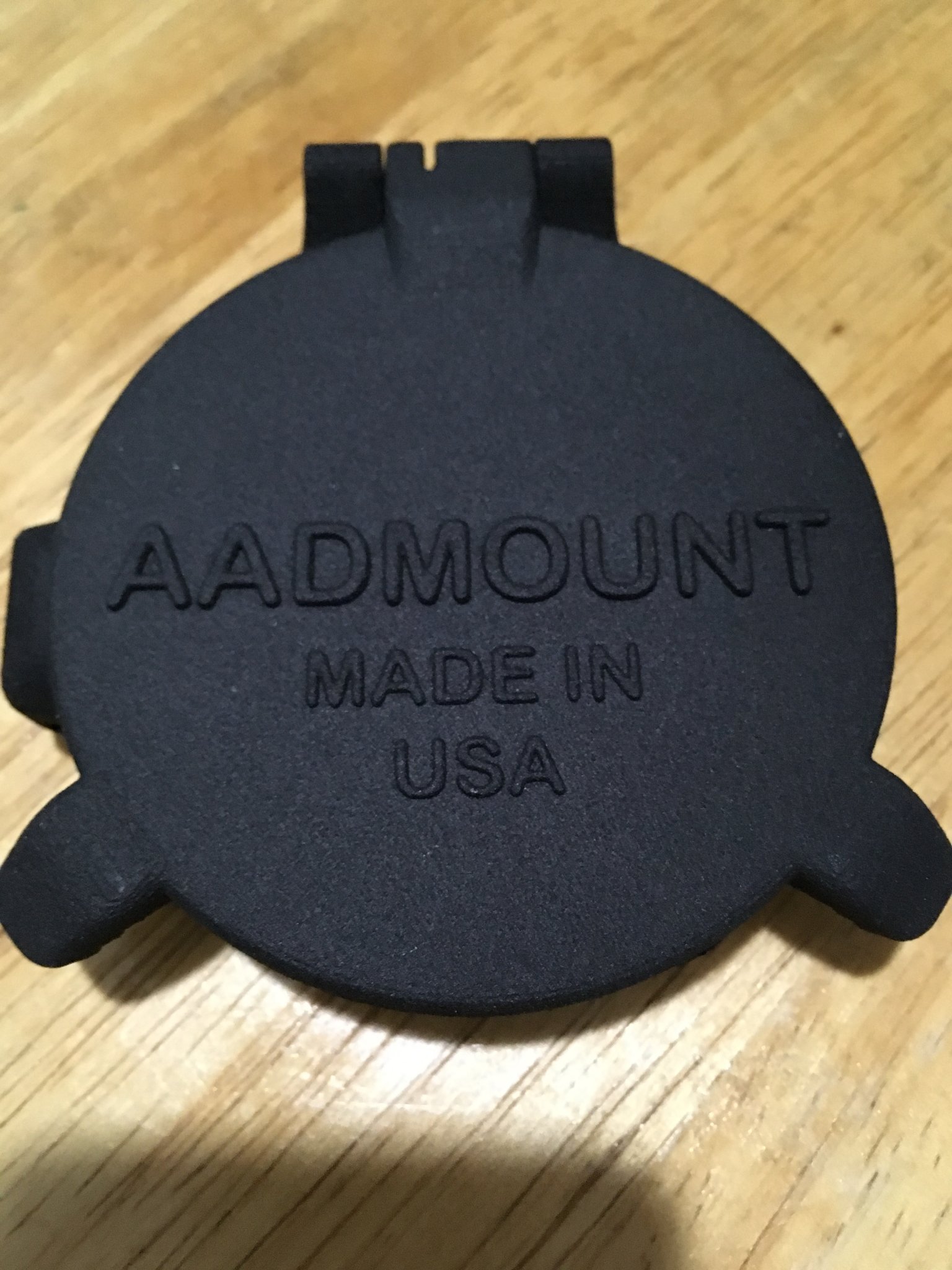

Now if I could find high quality lens covers for my M5, like tenebrex or similar
I think aadmount flip caps are the best, they make some for the mk8 56 mm, I was thinking about getting some. I don’t like how the alumina doesn’t open all the way, flat

The aadmount mk8 flip caps will fit the mk5, the leupold rep I talked to said he had those on his rifle. I like tenebrex but I like aadmount better

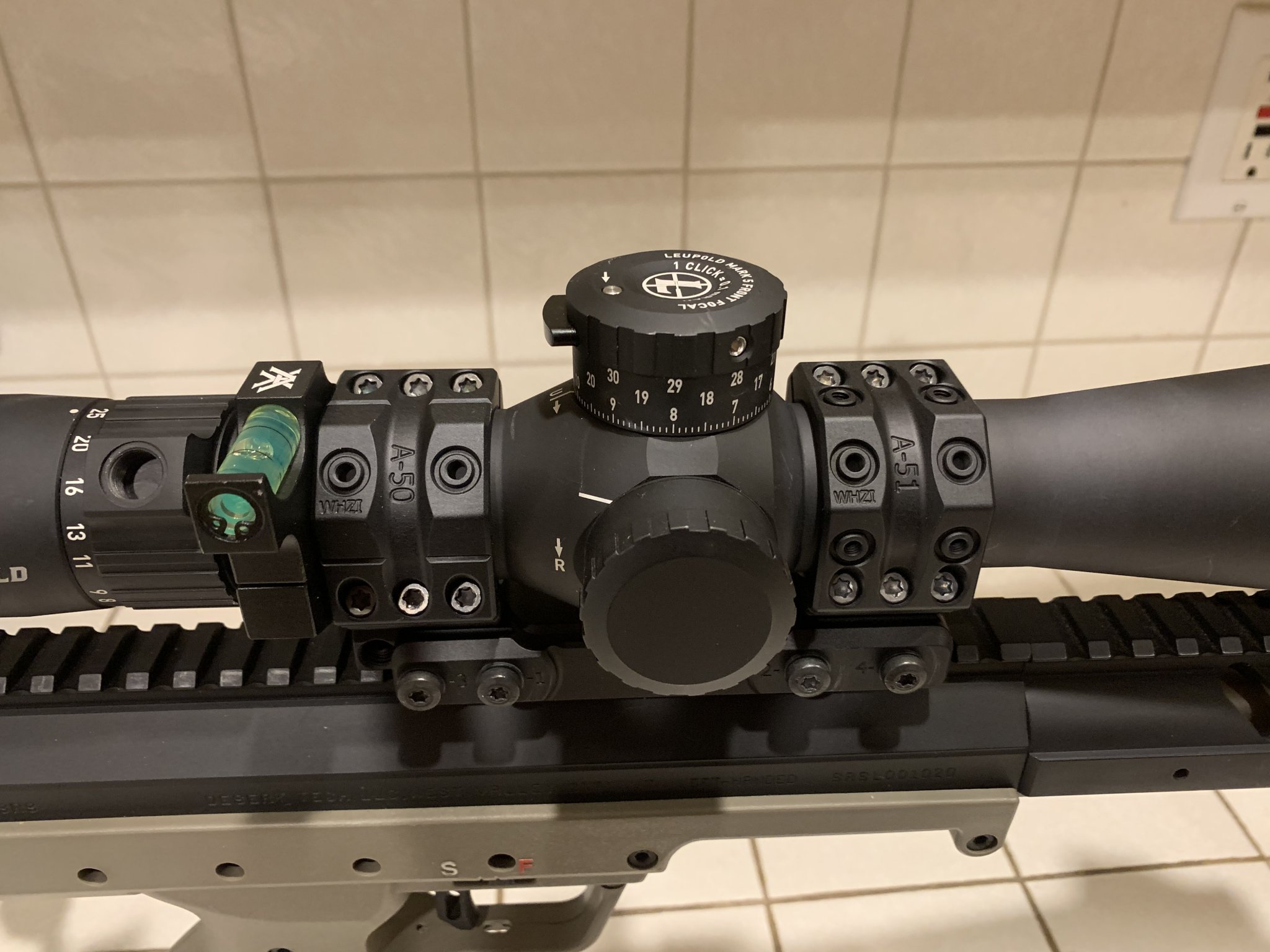

I just ordered leupold mark 4 35mm rings, I also previously used a spuhr mount (which all have integragted bubble levels), Bobro also makes a 35mm QD mount.
Also Badger makes a great 35mm mount.

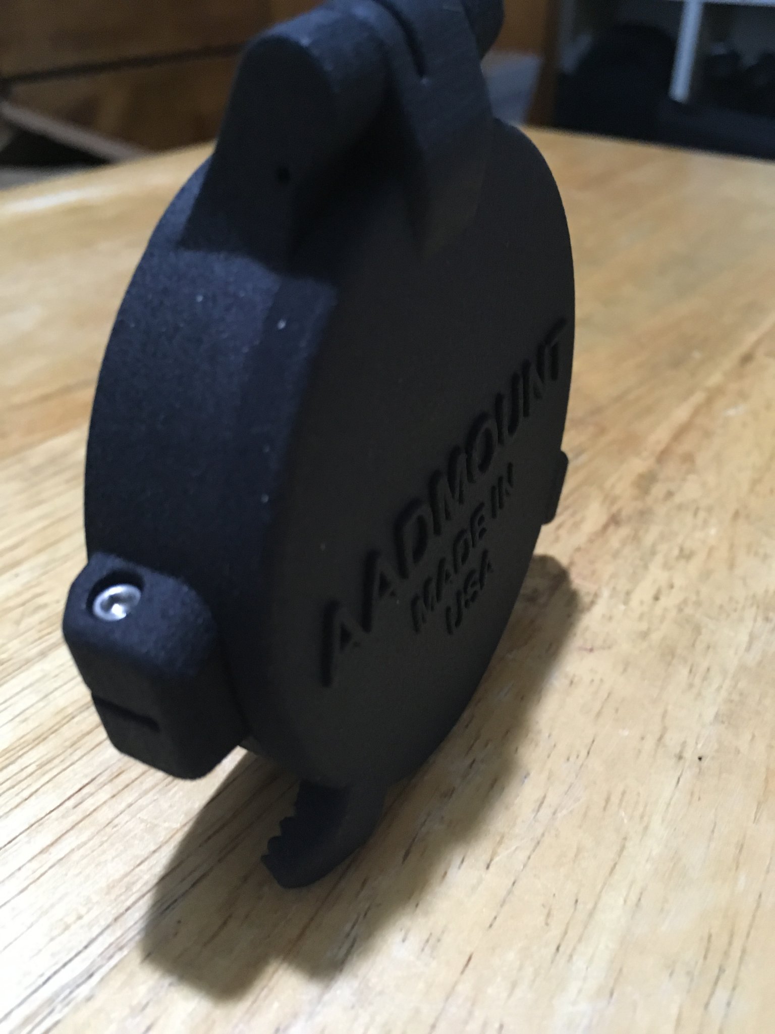

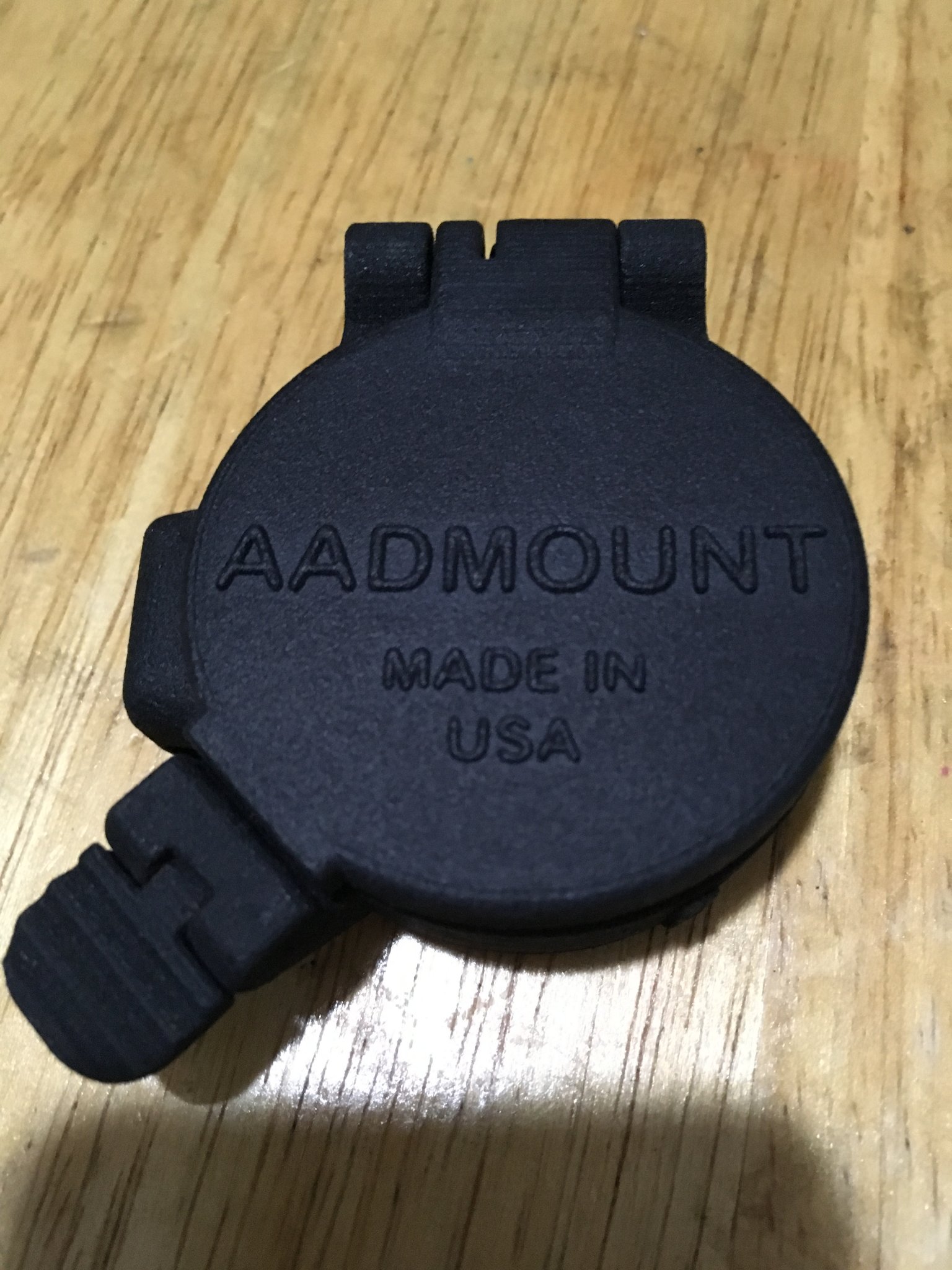

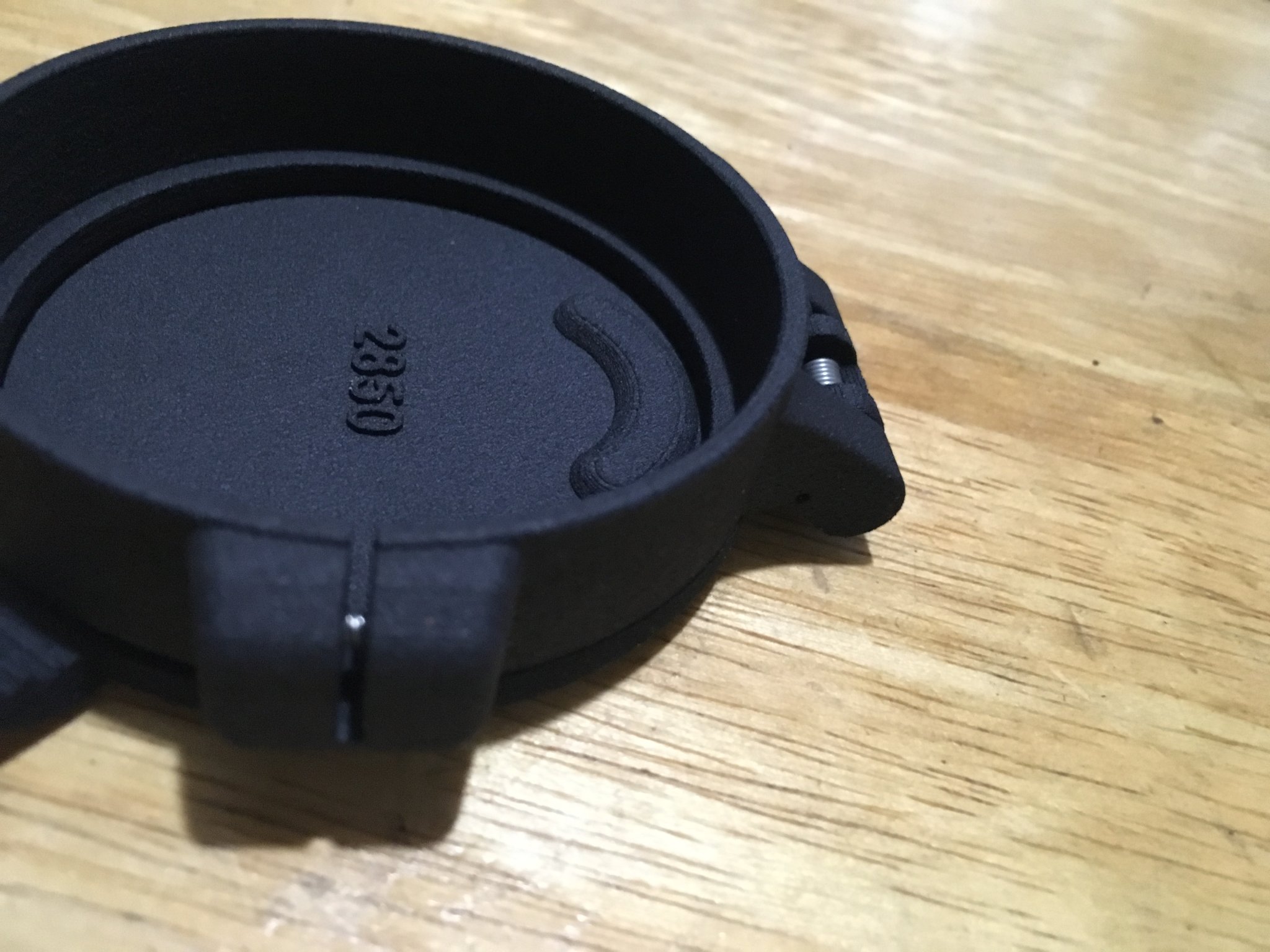

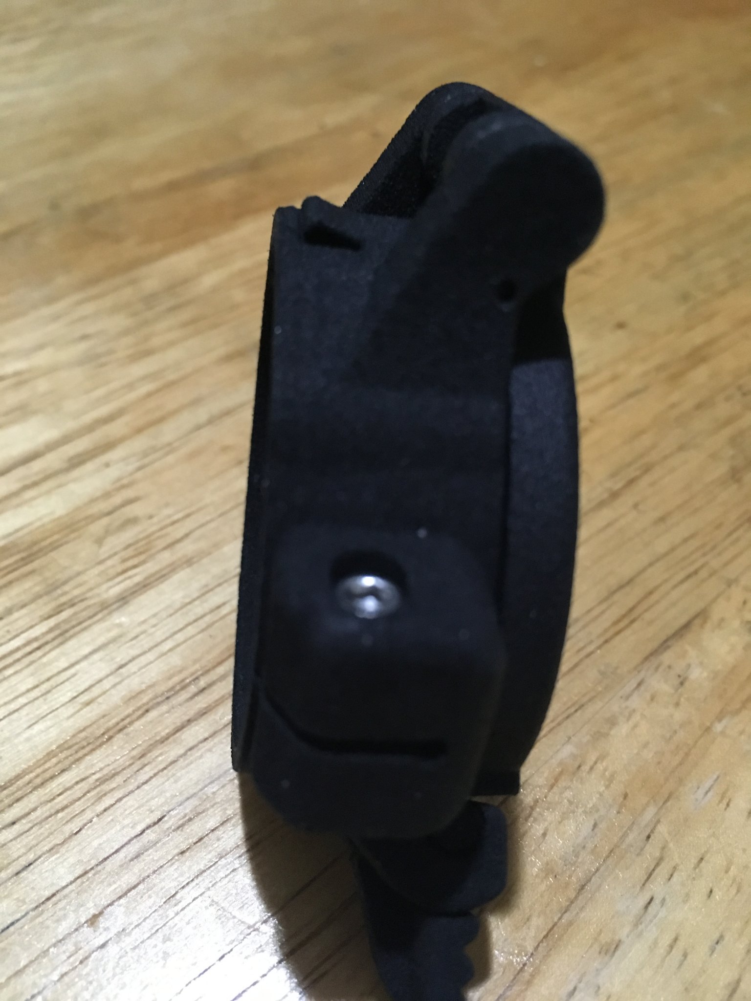

I got my aadmount flip caps & they did not fit but it’s not their fault they were designed for the mk8 56mm. Before I ordered them I called leupold & asked them if the mk8 56mm was the same size as the mk5 56mm & if the mk8 aadmount caps would fit & was told yes. They do not fit the mk5 but before I ordered them aadmount said I could send them back with the measurements of the mk5 56mm & they would take care of it. Maybe the leupold guy thought I was talking about scope rings & not flip caps but I thought I was clear about scope caps because I mentioned something about leupold caps not opening flat & the rep said he had some on his scope. Aadmount said will handle it. So if you are planning on getting nice caps maybe call aadmount first & give them the measurements. I measured 2.54 inches for the objective & 1.64 inches for the ocular
I had emailed Jon at Aadland to try to get confirmation the Mk8 caps would fit the Mark 5 but never got an answer. I'd really like a set for my Mark 5.

LAW-DOG
Belligerents
Dec 14, 2018
137
31
34
Jon told me if it didn’t fit to take some measurements & send them back if it didn’t fit. Maybe they will have some already the same size on another scope or he will make new ones to fit. Aadmount flip caps are very nice & built like a tank & I like how the Allen tightens the cap to the scope
Please let us know how the new caps work. I have a mark 5 5-25x56 I may get a set for

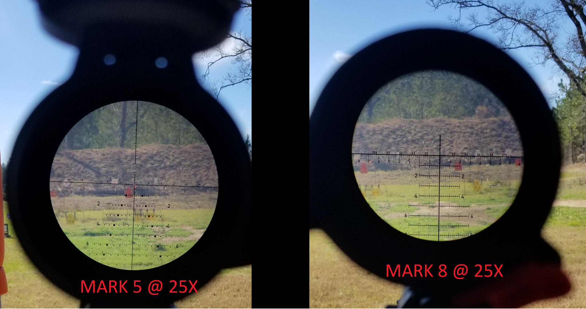

Looking for input on how the 3.6-18 does in low light. Looking for a lighter weight option than my big Razor 2 (Which is incredible). I'm in the southeast hunting pine thickets, so illumination is a must to squeeze every last minute out of the day.

I talked to a customer rep for leupold and he said the glass was the same as the vx5hd and vx6 hd. I haven’t looked through one at low light but the vxhd series get high praise for low light capability from what I’ve seen online.

To echo BGavin, most online reports I read prior to purchasing a Mk5 3.8 had very favorable comments regarding low light performance.
I should receive my Mk5 this week. .....so I'm going to find out pretty dang soon.

Unfortunately aadmount didn’t have any other scope caps that matched, so I took some measurements for Jon & he said he would start making them & they would be done by the end of the month.

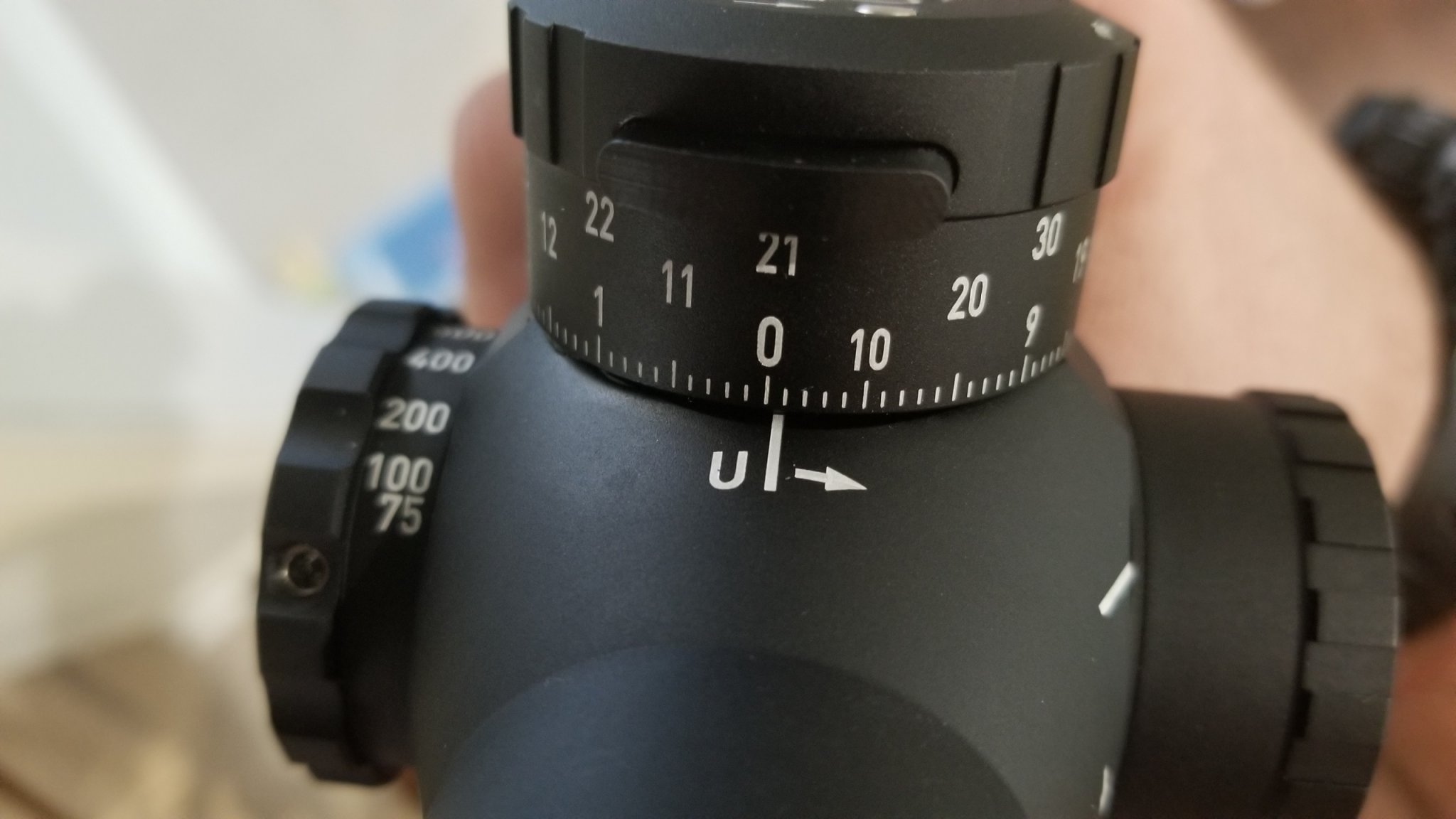

So my Mk5 3.6 arrived. Sharp looking rifle scope. Then I start to play with it.
Mushy clicks that don't line up evenly. But I can live with that if it will track.
Then, I get about 2 1/2 turns on the elevation dial then it stops. The indicator "button" on top also doesn't pop up.
It appears that Leupold's customer service department is going to get an opportunity to shine. I will not be a happy camper if they make me pay shipping for a brand new scope that was defective right out of the box.
This is my first ever Leupold scope. Not a good start.
Not a good start. I hope they make everything good. I almost went with a Mark 5 for my long range rig but I didn't have a warm & fuzzy about it. Ended up going with an Euro brand. I do have two SFP Leupolds that I use for whitetail hunting and they have been spot on.
I'm not sure about the mushy clicks- but the lines not matching up is due to where it is set at. Let me explain. you zero the turret by loosening two set screws, and lining up the zero (also the button that you will push) on the witness mark under the turret (it clicks into place). When it is in this little recess, there is some wiggle room. If the turret is not PERFECTLY lined up with the witness mark below the turret the lines will not match up from about 3-7 mils. Also, the little button is not supposed to pop up until the 3rd revolution. it will not just "pop" up, it will walk up as you turn the turret. Remember, you will likely have more adjustment than you think, due the the scope being factory "zeroed" roughly in the middle of it's elevation travel range.
If all of this was done correctly you may have a lemon, I would talk to their customer service, they should be able to walk you through this. Although they were unaware of the turret-lines-arent-lining-up-correctly-because-the-turret-is-not-perfectly-centered issue, and they just sent me a new turret.
Thank you for the detailed instruction. I will try to loosen up the set screws and see if I can get them aligned correctly. That may well fix that problem.
However, I am unable to get to the 3d revolution. I hit a stop after the second full revolution (plus another half turn) and the "button" is still completely flush with the turret. I cannot imagine this being normal. But I'll give the Leupold a call and see if it is user error.
Zero stop maybe?
