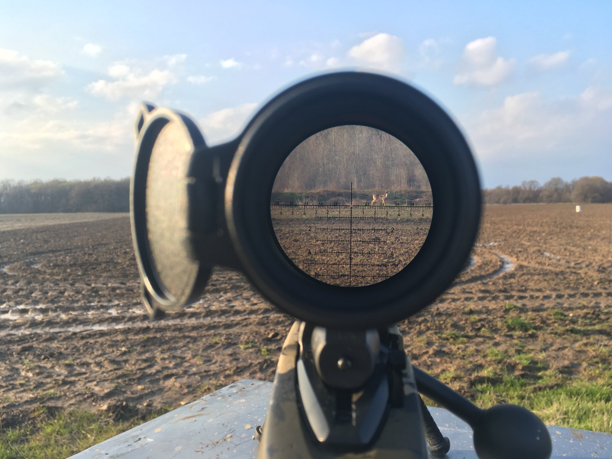

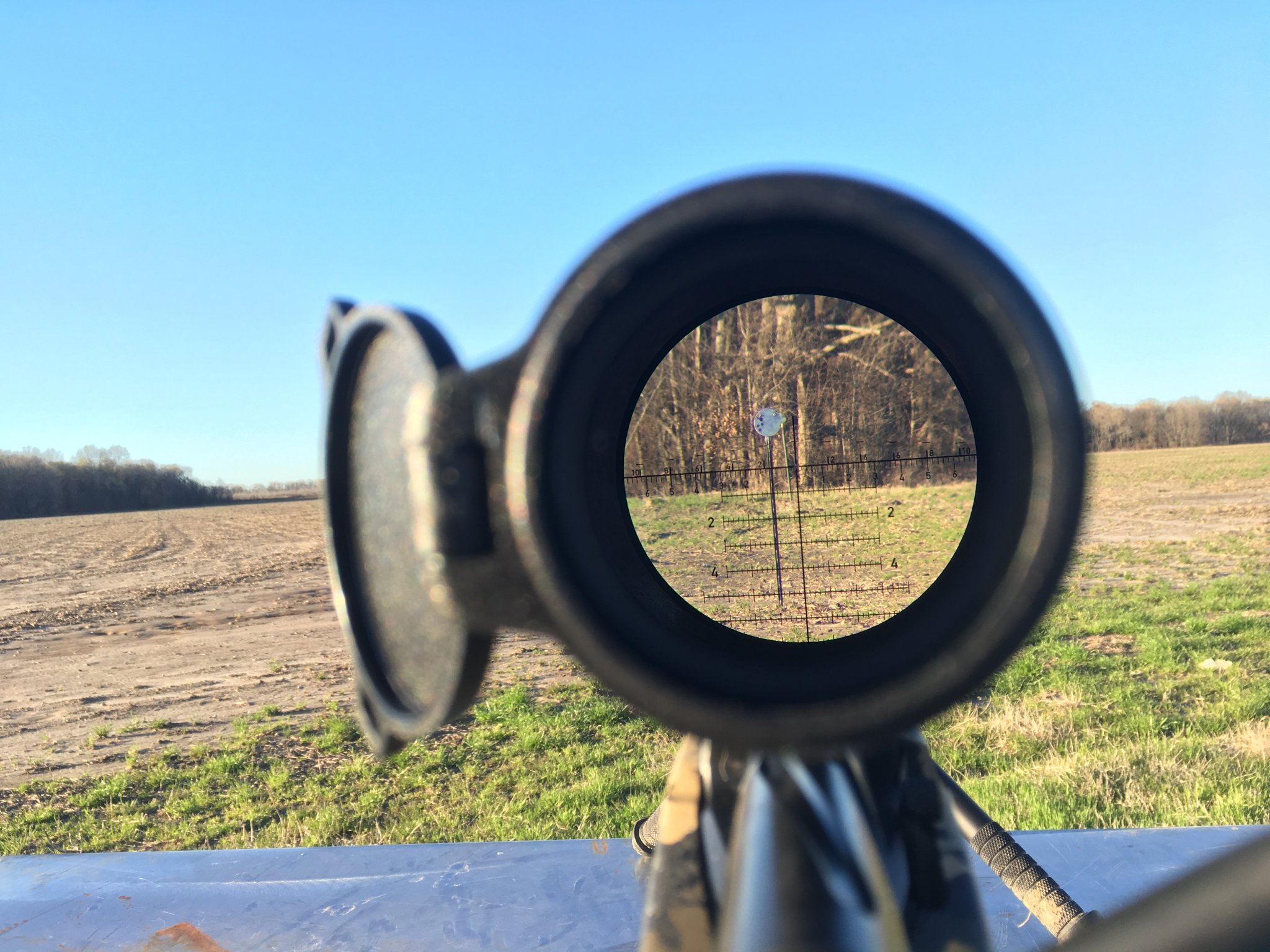

Well, I promised pics, so here are a few. Turns out it’s really difficult to get a good picture through this without a PhoneSkope. First, though, in no way do these pictures represent the clarity of the glass. The resolution is fantastic, and I can see (sharply) blades of grass and the twigs at the ends of the tree branches at over 350 yards (what you see in the picture). I can induce chromatic aberration if I go off center in the eyebox, but when I’m centered up, I have edge to edge clarity of both image and reticle, and I don’t notice any CA.
So the pictures: this is looking out my window. I couldn’t do this outside because it was ridiculously windy, and I couldn’t get the scope or camera to hold still. I took shots of a hillside in full sun with snow, rocks, grass, and a dead tree for lots of contrast and to to induce as much CA as I could. I was looking for detail in highlights and shadows, resolution, contrast, color fidelity, etc.
3.6x:
6x:
18x:
So, side by side with the XRS at 18x, the Mark 5 looked great. It seemed brighter somehow even with its 44mm objective, and the eyebox was much more forgiving. I had to move very slightly behind the XRS to get the edges of the image clear, but with the Leupold, the whole thing looks good at once. The colors are also a bit warmer and more natural with the Leupold, whereas the XRS gives everything a cool tint. The contrast is fantastic as well. I could see detail in the tree bark even though it looked very dark against the snow. The one thing that I thought was better in the XRS was that the picture in the scope seemed larger... I mean, it was the same field of view, but it was like looking at 2 TVs showing the same program, just one was a bit bigger than the other. I’m not sure how to explain that impression, but the Leupold was clearer than the XRS for sure, so I don’t think the “bigger” picture means very much. This was a tough scene and the Leupold handled it a lot better than the pictures indicate. Maybe the camera lens was tilted relative to the scope so the focal planes didn’t line up, or maybe the camera didn’t like the diopter setting for my right eye.

Looks like you have CA at 18x TBH. Artifact of the camera?
Yes indeed. Like I said, I can induce it if I move around the eyebox a lot, but centered up, I can’t see any. I couldn’t get it to completely go away with the camera, though. That picture was the best one; all the other ones had horrible purple and yellow mess all over them, hahaha. Trying to do too much with too many lenses, I guess. The scope is optimized for the lens system in your skull, and it seems to work just fine in that context.

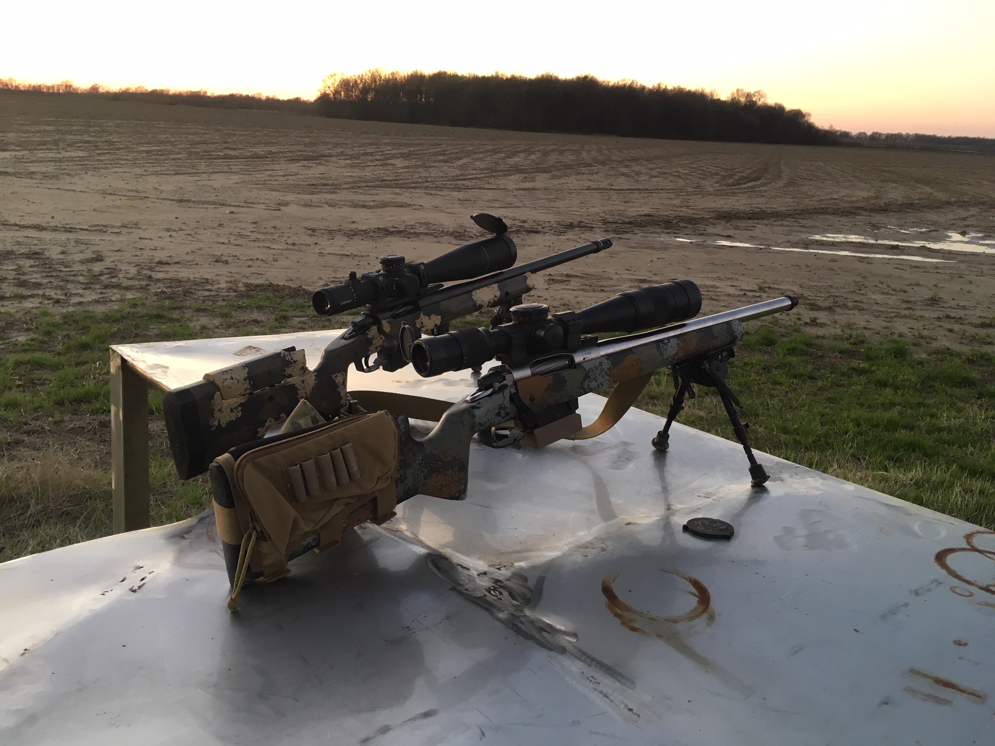

Got home a little late but had some time to take them out and compare them. I can finally say it's the first scope i've bought that does indeed have better glass than my USO SN-3. I had them both on 9x starting at sunset looking at the deer behind the IPSC which is 800yds away, i'm thinking roughly 1100yds or so. 23 minutes after sunset the Leupold edged it out. Which it should in this category given the specs. I could make out the entire silhouette with the Leupold and couldn't see her with my SN-3 until she started running down the CRP line and her tail was up.
I thought i might of caught a hint of CA at first but i'll give a more definite opinion tomorrow during the day. Eyebox is tight at 25x. Though i might have a bit of work to do on positioning the scope. Edge to edge clarity and resolution are up there for sure. My knobs also don't line up but i've never had an optic that did this perfectly from the factory and as long as i can get them lined up fiddling with it, i'll be fine. Next weekend i should be shooting in laurel at an F class match and put against an ATACR 5-25
Take the pics with a grain of salt as you all know, my iphone SE with me holding it mid air certainly isn't indication of the glass quality.

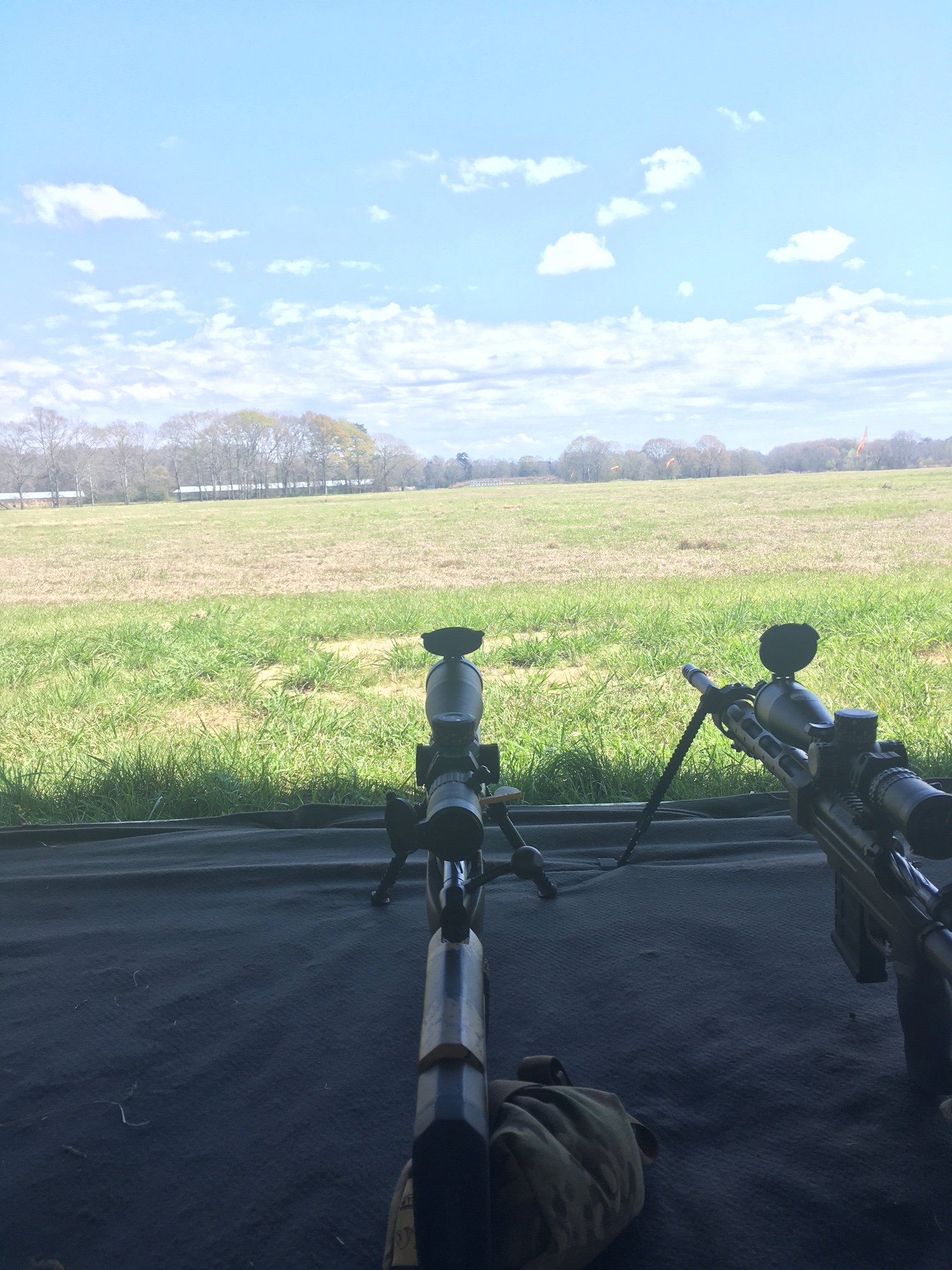

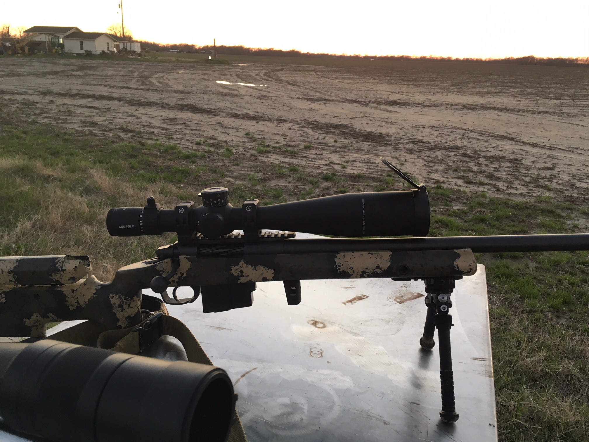

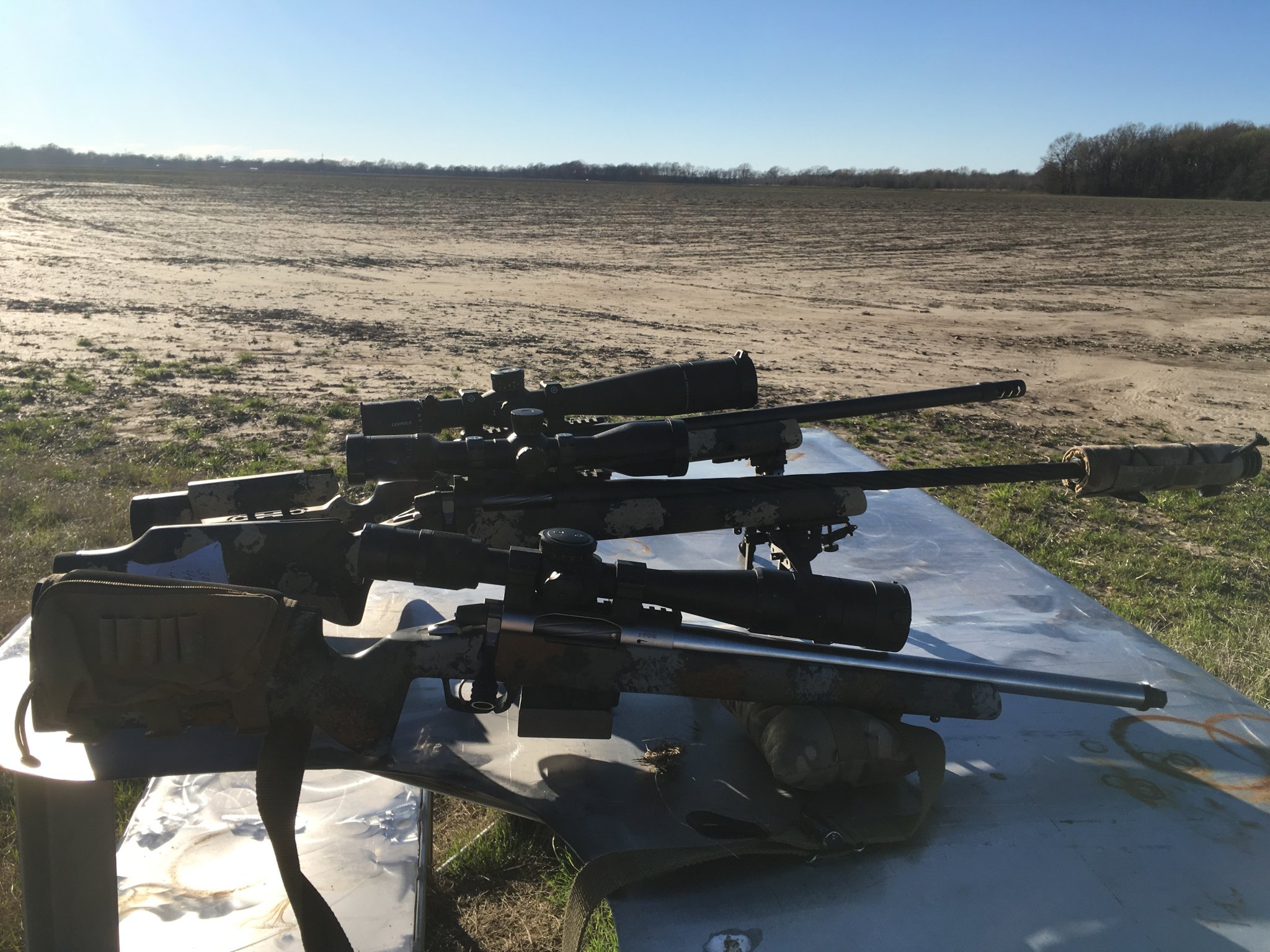

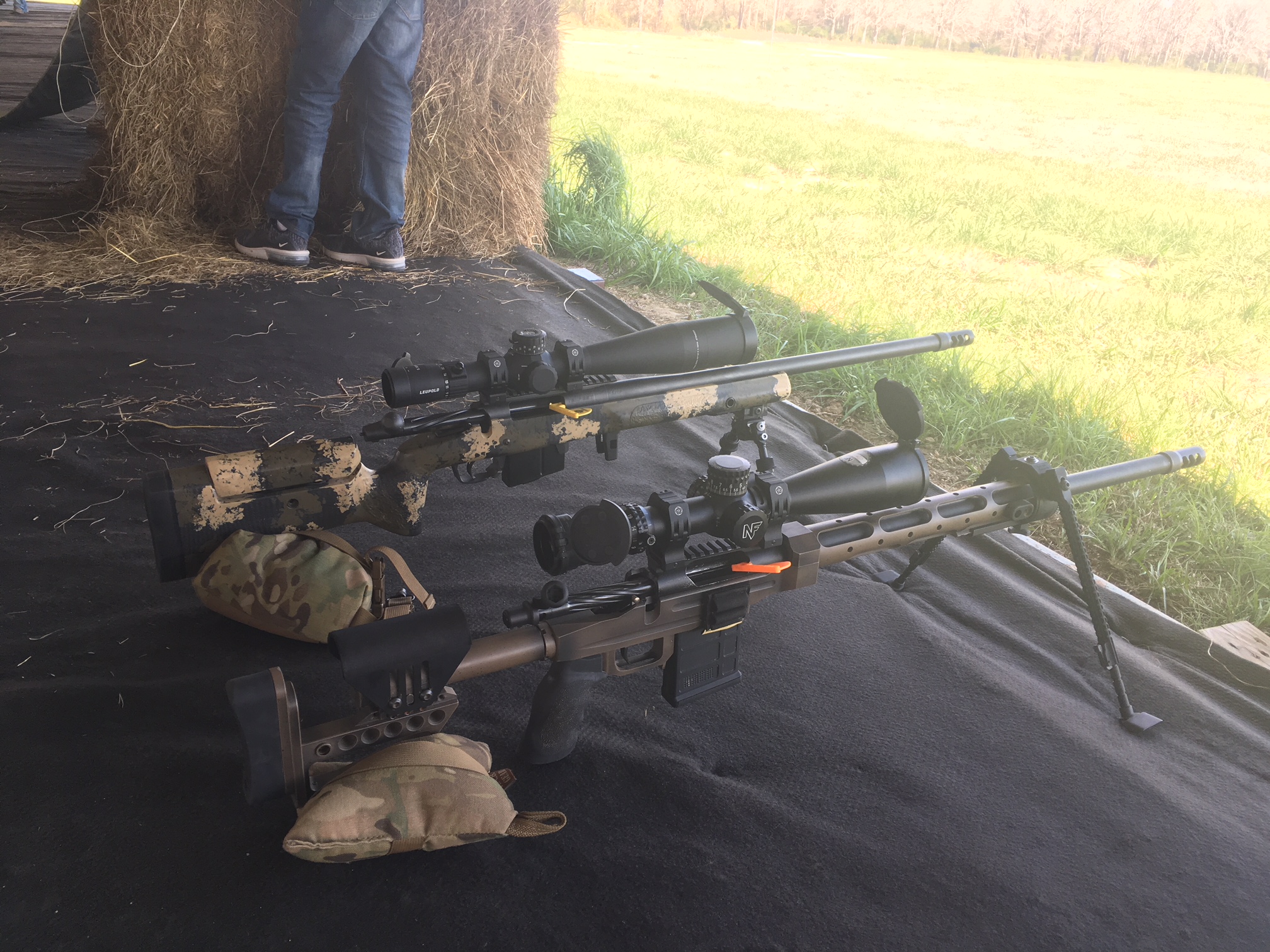

Alright so finally got to put it through it's paces...well to some degree. I didn't get to see if it was tracking because i chambered a round that was a bit rough to chamber with my Tempest, pulled it out and the case and powder came with it and the bullet stayed put. Didn't have a rod with me so needless to say my gun went down. I was having a hard time getting it zero'd but i'm putting that on myself, because to be frank, i was shooting terrible. Idk how some of you do it but if i'm absent from shooting for a couple of months i basically have to start over. Well it took three hours to calm down and i finally printed some decent groups with dad's 6.5 SAUM (unfortunately his Zeiss V6 isn't holding zero).
Anyhow enough of my rambling here are some updated pics. Scopes to compare it to where again my USO SN-3 and dad's Zeiss V6 3-18. Have to give Zeiss some credit for a scope that is nearly $600-1000 less than the two it's up against it really holds it's own. Though this is nothing new from Zeiss as my Conquest for the money is no slouch for it's price range.
Going back to the clicks while audible and pretty tactile just don't have enough resistance between them IMHO. Don't get me wrong it's not some detriment like the M5B2s were, they're solid knobs but could use a little work. Their windage is much stiffer. I didn't bring the hex allen key to set the zero stop and all either so it could change somewhat. My HDMR II felt better after i had set the zero stop. Though this is all personal preference and completely subjective, i do suggest getting your hands on one if you're considering it and are picky about turrets.
Parallax while smoother than i would prefer as i initially stated worked fine and was pretty generous from 500-800yds. No it doesn't line up quite perfect on the indicating yardage but that is nit picking to me. I've never really used the marking that much, rather i just turn it until the picture looks the clearest to my eye.
The first test was looking at paper at 100yds as i had to zero my rifle and shoot some groups with the 6.5 SAUM. No CA what so ever, again glass continues to impress me. I might have judged the eyebox prematurely while i wont say it's the most comfortable i've been behind it's not as bad as i originally thought. I've had to adjust my cheek weld and am still doing so to try and get it set so it's perfect.
After shooting finally got back to my range to see what it looked like on white steel with the sun beaming down on it. First and foremost maybe it's because i just haven't had a 56mm objective but the thing is ridiculously bright compared to what i'm used to. Very Gen II razor-esque. Colors pop and everything looks vibrant rather than warm like my USO. I set them all on 16x and kept going back and forth between targets to look for CA. This was from 200-800yds in 100yd increments, the Zeiss was the worst at controlling CA. Which was expected. The Leupold came in second, although it's a very close second. It's as mentioned before, almost dependent on cheek weld and where you are in reference behind the scope if you'll see CA. Some viewings i couldn't tell there was any, others i had the faintest smidge.. that is to be fair and honest completely unnoticeable less you were seriously looking for it. When i say faint i mean it's almost completely absent, it was practically unnoticed. Though the USO again has none what so ever, still makes me smile honestly. That scope is approaching 10 years old and it's just been a fabulous piece of glass to me. FWIW i really need a phone skope, what you see below is probably the best i can do holding the phone behind my rifle but good God it takes some patience.
All in all for the money, strictly speaking in terms of glass quality, it is competing above it's price range if you're just going on price alone for the non-illuminated models. Leupold really needs to work on getting the illumination down then i think many more people would consider this a very viable option for those that need illumination. I myself, don't find it necessary. Considering what you can pick up this particular model for at Mile High right now for $1955 it's truthfully the best scope i've been behind in a sub $2000 price bracket, bar none. Yes that includes the Cronus for what short time i spent behind one. I mean if we're being frank it was just a couple of years ago that the ERS was $1999 and there is absolutely no comparison between the two.
