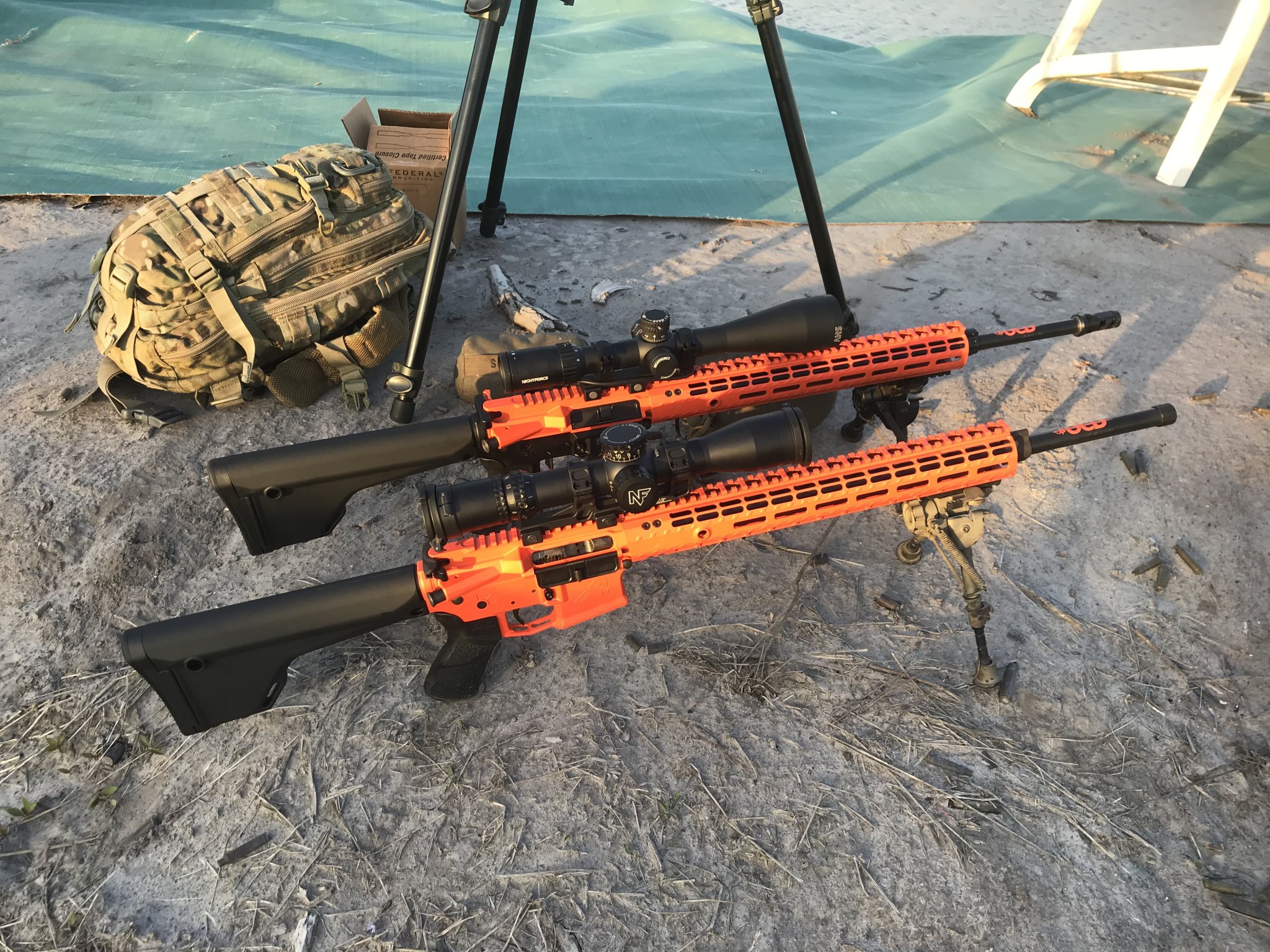

We shot them in a local match a couple weeks ago, out of 72 shooters we took first and second. So far it's working well, just understand it's not a Creedmoor. For time based targets under 600 it is hard to beat, and has the capability to do 1000+ out of a small frame AR. What's not to like?IMG_0761.JPG

These are 22" with +2 gas and 15" handguard. They have .750 gas blocks and a Remington varmint contour behind the gas block. I think they balance out pretty well.

While I don't disagree with the Grendel comments above, a few of us watched as one of the guys down here put three shots into roughly 4-1/2" at 1400 yards using a Grendel AR and factory Hornady match ammo, while the rest of us were using .338 LM, .375 CT and one 6.5 Creed. It was quite the sight to see.
This was last year, in Central Florida at roughly 35' ASL.
