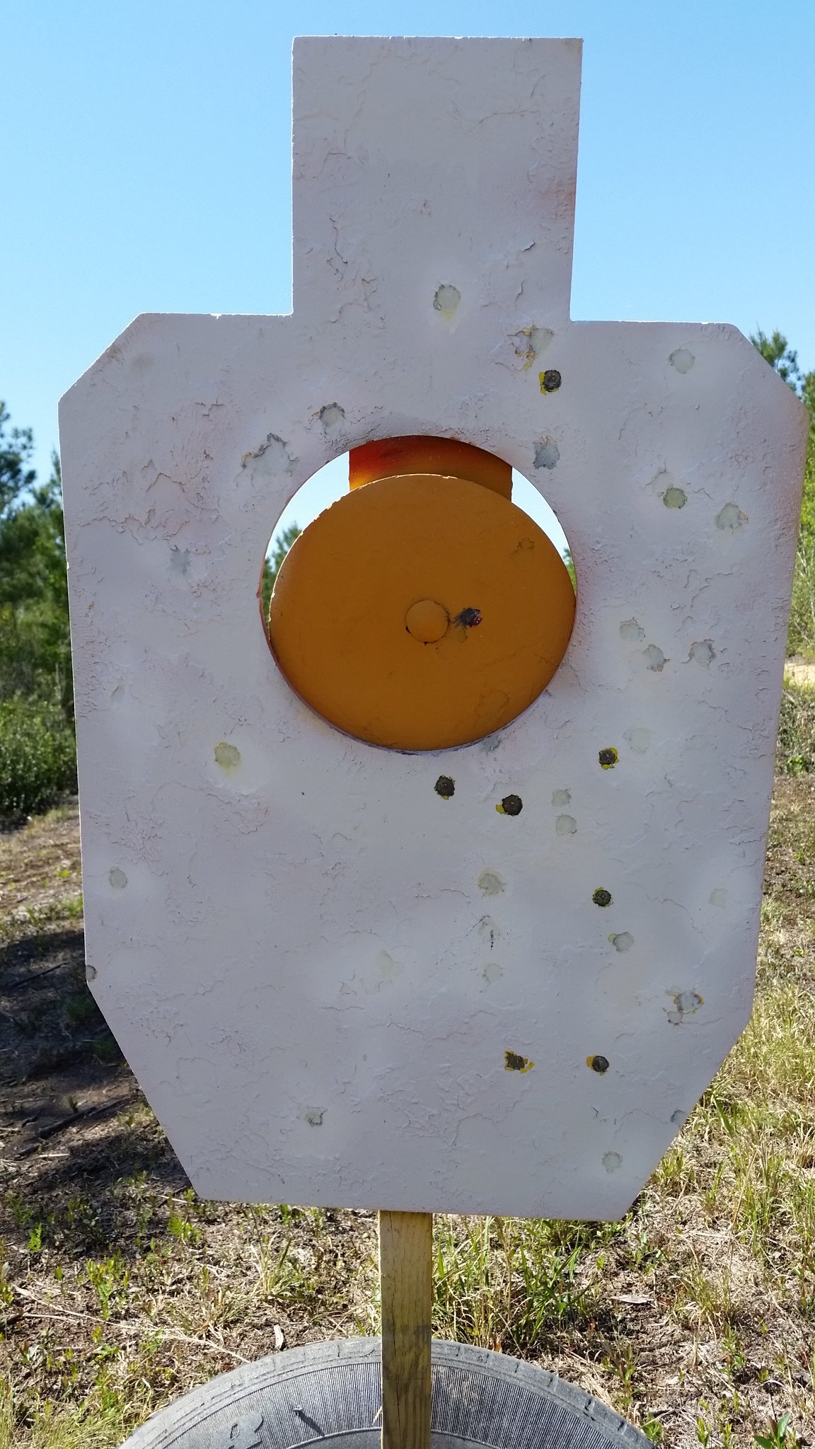

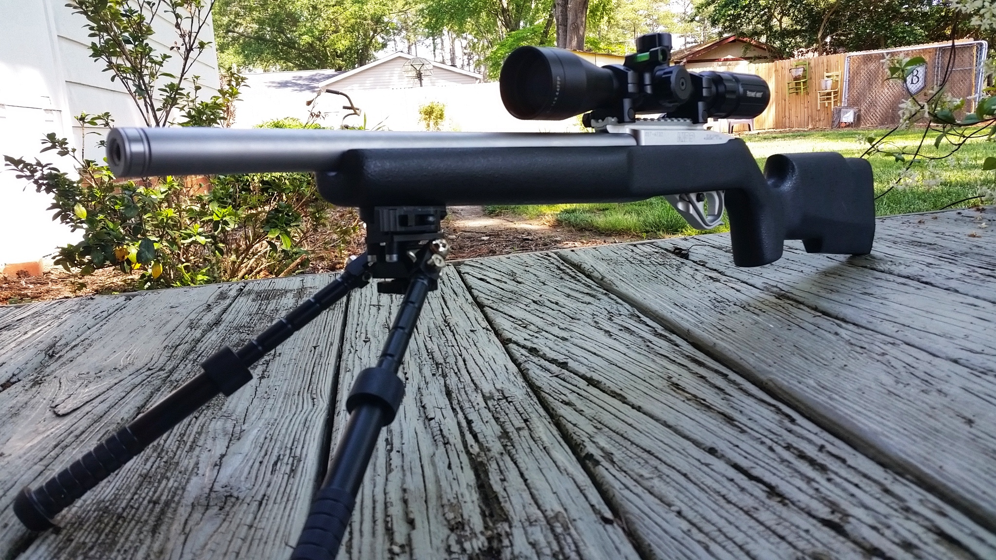

I saw those but wasn't sure if they were anything different outside of being labeled for semi autos.
Are you shooting from them a bolt gun?
for whatever reason, i just saw those the other day. i've spent my ammo budget for january, but they are on my list for february purchase.
are they working for you and what are your shooting them out of?
I have great results with my accurized Ruger American but my baby is a 16” Kidd. The Kidd is what I shot this spring out to 400 yards. The Contact was more consistent than any other ammo tried that day in the wind at the longer ranges.
At 50 yards they are under .300 if I am up to it , low .100s at 25.
The extra 2 grains helps them tremendously out yonder :cool:
I honestly like them over much more expensive Tenex and SK.

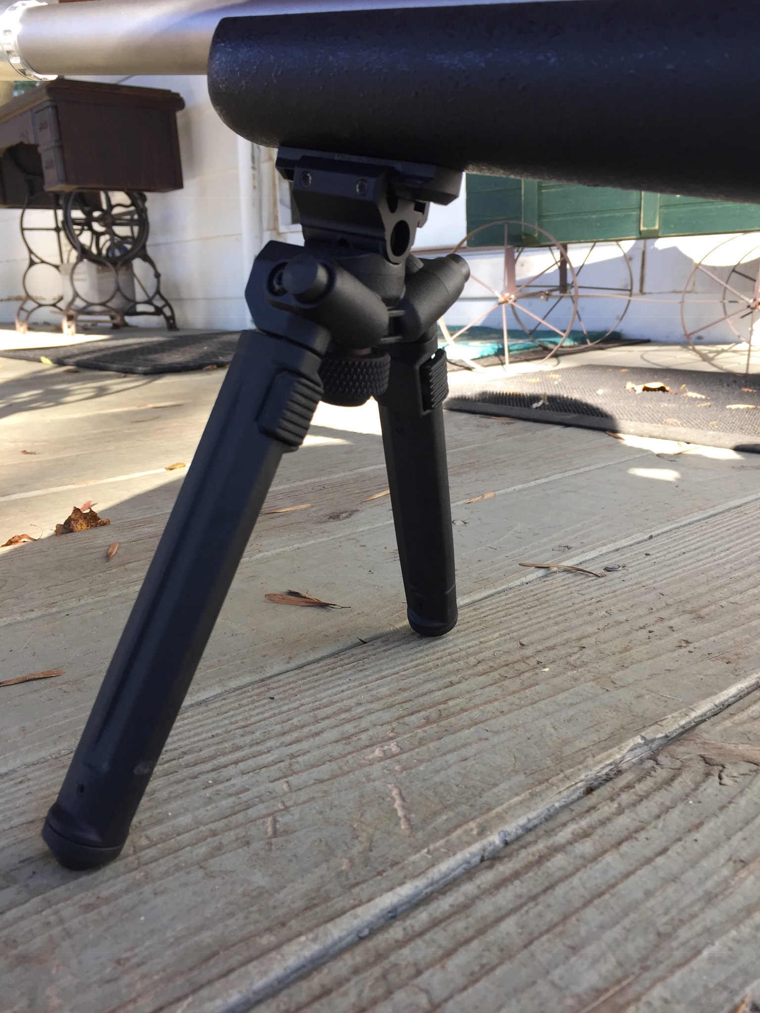

This rifle shot Federal bulk on steel well to 400 as well. It only took 19 or so mils where the Contact took around 23. It just is a fantastic rifle. You can see where I was walking it up once I made a hit.
Forgive the bipod, it has a Magpul on it now.
400 for 22 is incredibly fun and the wind will wreak havoc like shooting 308 at 1K. 06F59297-534D-4870-BC29-40836D57D4E0.jpeg
