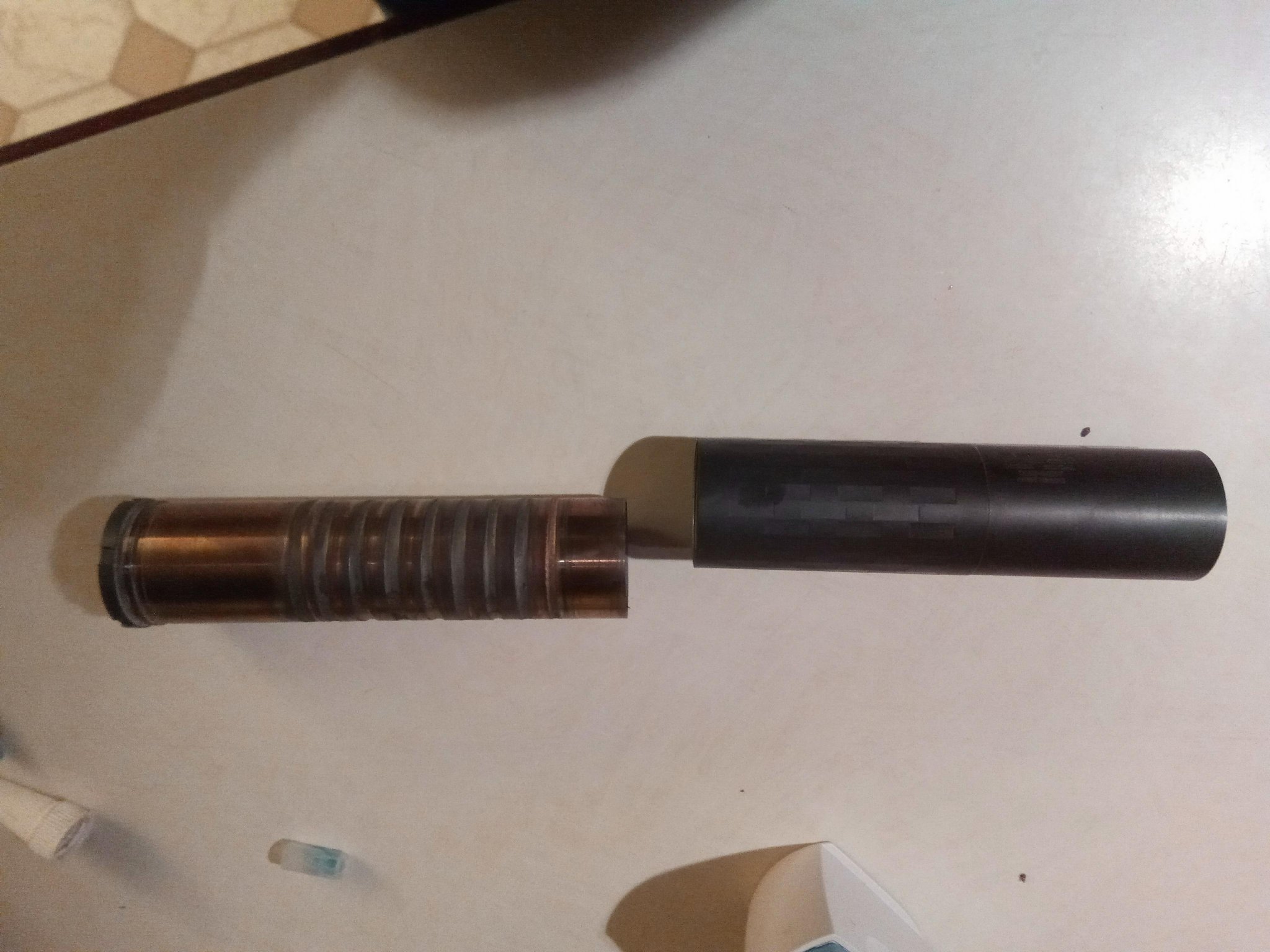

Is the Hybrid build in the same way as the Omega?
No it's not. Different baffle stack and material used. The outer sleeve on the hybrid is screwed on and held in place by the end cap so it's impossible for the sleeve too launch off.
